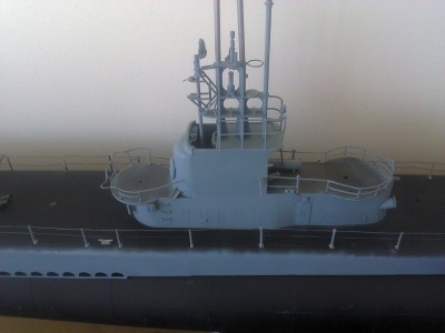

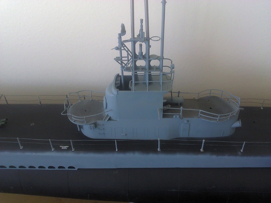

This is my 1/72 USS Hammerhead I have had in work for about 5 years lol. It is still only about 75 percent complete. I havent even started on my IBS 5 inch gun that goes with it. Mr. Grima was extremely helpful with pointing me in the right direction on what I needed for this build and a few of my 1/144 builds that are almost complete. Hopefully I will have this one completed soon. The main reason I selected the hammerhead is because it commisioned with the tall cut down fairwater, and with the few pictures of it i could find on navsource for the late war fit, this seems to be pretty close to the railing on the actual boat. Please be honest if you see anything else that needs to be tightend up. I know it still needs to be painted, and I still need some more putty in a couple of places.

Your not right, your getting confused. The revell kit is designed for the "Cobia" Fairwater, That is not a Modifed fairwater. It was the as launched fairwater. You are mistaking the early as built fairwater with the yard built fairwater of later boats. The very early Gato's with the As built tower(with windows) were cut down and modified, some eventually had the whole fairwater replaced. That is not the Revell tower. As the war progressed and from lessons learned Codia style towers had the upper part plateing removed, that is why the upper structure frame masts supports remained (like one the Flasher and Drum). Different yards also had their own influence into the mix.

I am having problem this morning logging on to navsource. I cannot log into your link. If you want to use the stock Cobia for a latter cut down Gato, you can. Leave the height of the bridge alone, There is no problem in the height. You only need to cut down the shield and shorten the bottom of the sail front piece( part #64). The mast support Part #65 leave alone. Also keep away from Govt yard boats, Their towers are much more different then the stock revell. Stay in within EB and Manitowac boats you will be fine. The problem that you will encounter is in the aft of the fairwater. The stock Revell has a round aft like the Cobia, some were round but some boats were pointy or blunt. I have the gizmos to change the aft from round to pointy if needed. Here are links I did for the USS Puffer. I cut the tower down and blunted the back of the fairwater. I hope this info helps you on way. Mario
