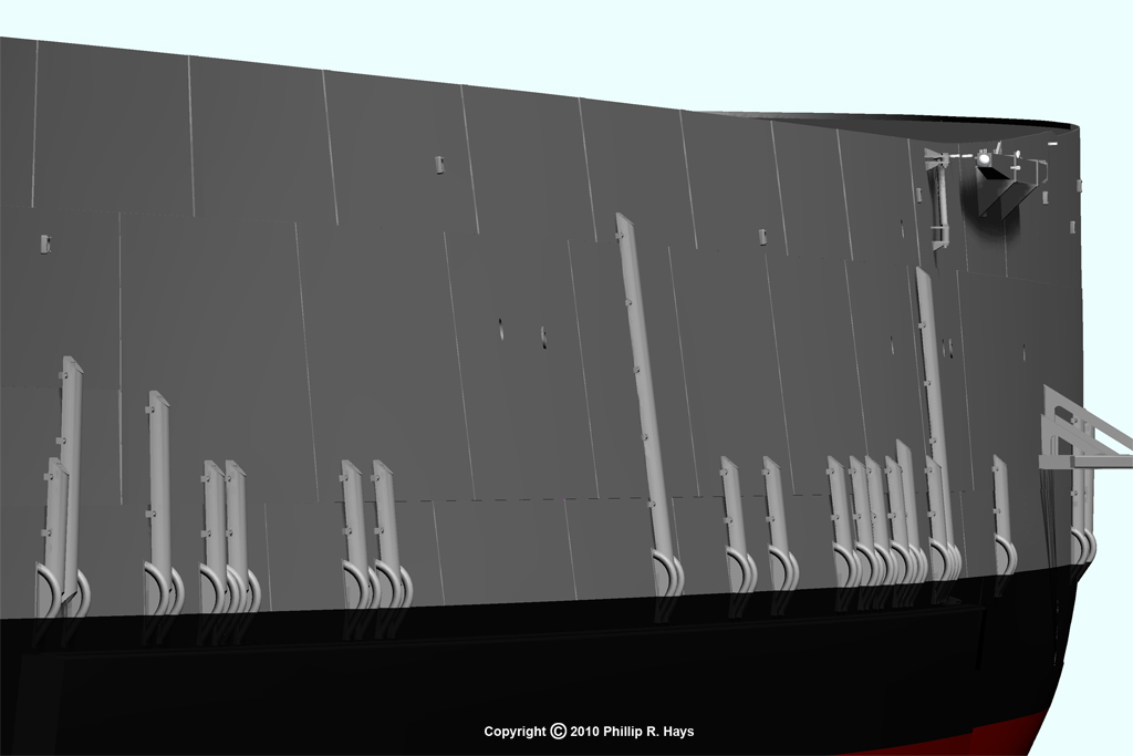

However. in the picture I do see "split pipe" drain covers and the associated "D" shaped pipe bumpers to protect them. See the attached picture. The drain covers were made of pipe split down the length and fastened to the side of the ship. This prevented overrboard discharges from spraying out onto docks or boats alongside.
These features were not on the USS Oklahoma City CL-91 during WWII, and I don't recall seeing them on any other WWII ships. They were added during the CLG conversion in the 1950s. So check the dates of the photos you are looking at to be sure they represent the date that you are modeling.

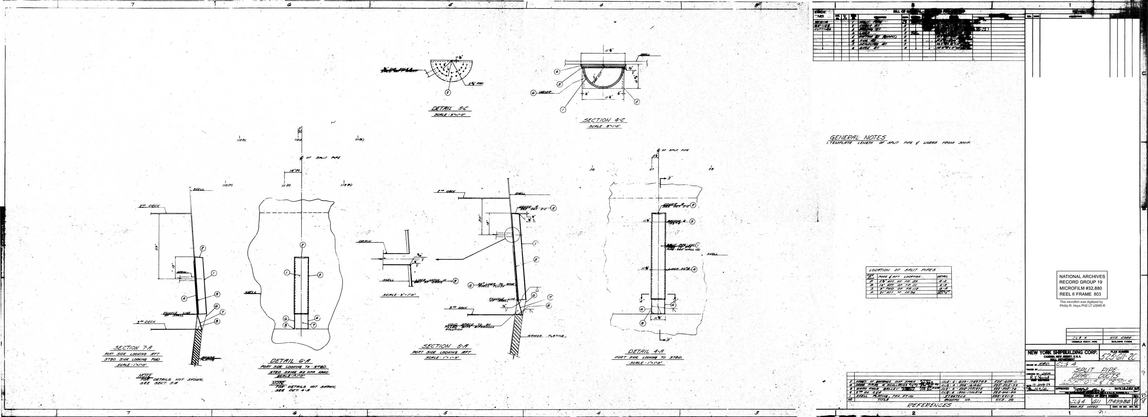

The blueprints say to split 10" pipe lengthwise to make the drain cover. A separate plate was welded to the open side of the pipe to make the "D" shape. The cover extended some distance above the drain opening in the hull. The pipe wall thickness was 0.365 inch.
They did take a beating over the years. We were frequently in typhoons with 40-60 foot swells. Sometimes the forward half of the hull would be submerged (up to 50-60 feet above the load water line) when we plowed into a swell, and I have wondered if the repeated stresses carried away some of the drain covers.
I have attached the blueprint. Unfortunately, I had to save it at very low resolution to meet the file size limits. But I think most of it is readable.
However, it does not show attachment to the hull plating as shown in the photos I posted.
