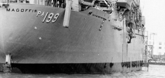

Then there there are these items. Looking more like something to attach nets or something else to rather than discharge pipes?

I'm not sure what "items" you are referring to.
However. in the picture I do see "split pipe" drain covers and the associated "D" shaped pipe bumpers to protect them. See the attached picture. The drain covers were made of pipe split down the length and fastened to the side of the ship. This prevented overrboard discharges from spraying out onto docks or boats alongside.
These features were not on the USS Oklahoma City CL-91 during WWII, and I don't recall seeing them on any other WWII ships. They were added during the CLG conversion in the 1950s. So check the dates of the photos you are looking at to be sure they represent the date that you are modeling.

Thanks Phil, that seems to clarify the D bumpers part. During the war the Haskell's from the photos I have seen were usually equipped with these pipes. From looking at the interior arrangements it would look as if much of the pipe must run along the interior of the ship and exit near the water line. Missouri has a few of these post war but have a longer exterior run to avoid piercing the armor belt.

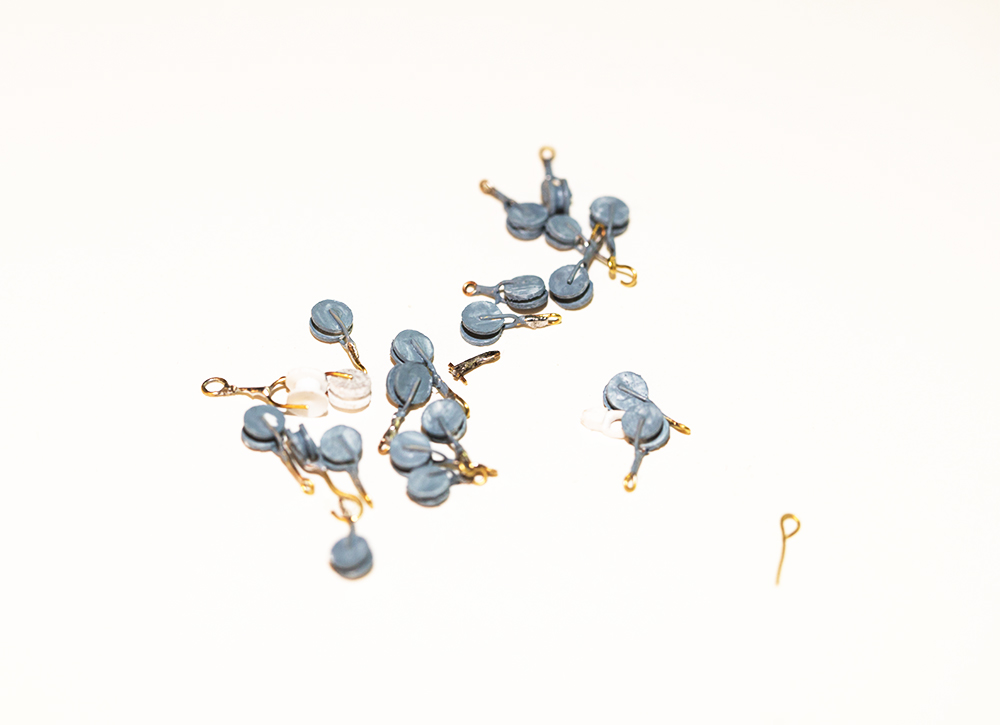

A start on the fiddly bits ( A technical term for standing and running rigging parts)

by BB62vet
Tom,
Nice "fiddly bits", btw!!!
I'm doing a bit of research on what those side pieces might be - will post if I find anything!
