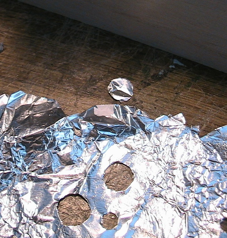

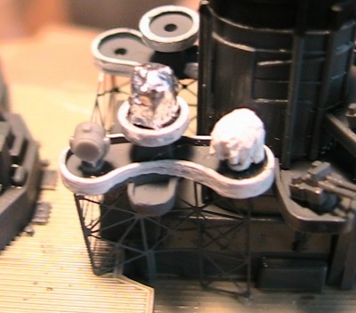

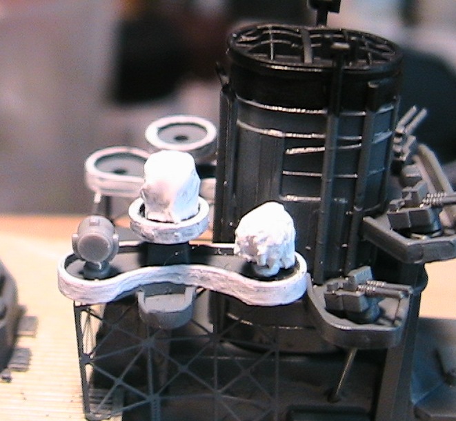

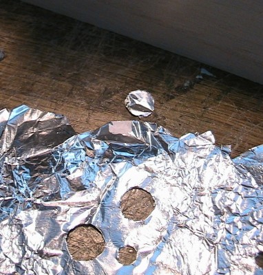

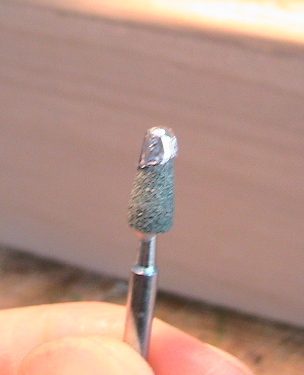

Here's how I do the wrappers for the searchlights:
1. Cut approximate circular sections of baking aluminum foil using a needle or the micro-cutter with a brand new tip, about half inch diameter (adjust accordingly depending on the size of the searchlight.
2. Press circular foil over a bullet shaped object --- I use worn out Dremel stone bits; make sure to have a neat and uniform look to the surface---this should make a deep cup
3. use a sharp razor to trim around the edges to get a straight hem-line
4. Apply some thick superglue inside the cup
5. Carefully position the wrapper onto the searchlight, lightly pressing it down without crushing the foil cup; leave to dry
6. use a toothpick or needle to "wrap" the corners and lower hemline tighter around base of searchlight to complete the shape
7. paint over with color of choice!

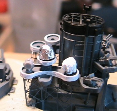

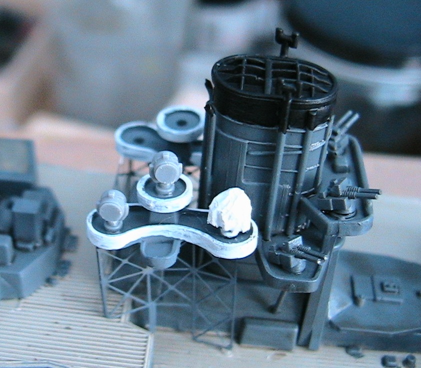

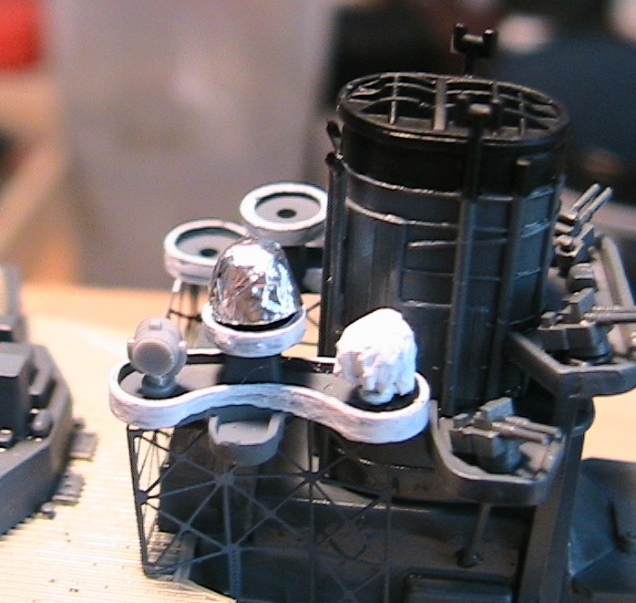

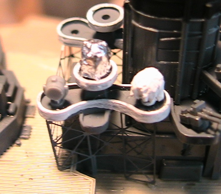

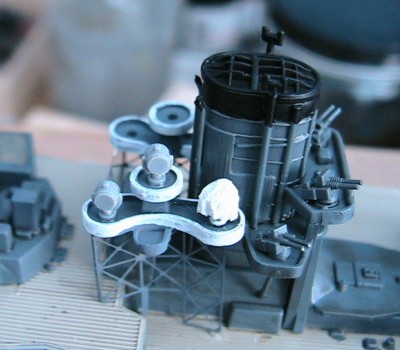

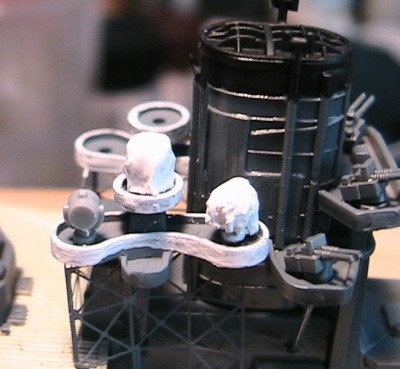

Continuation on wrapping searchlights...... patience carries the day!

I'd only wrap one or two lights for contrast because the kit lights look better than the wrapping.

ALL the main lights around the funnel were wrapped during the Battle off Samar. Only the ones on the bridge stack were not wrapped based on the reference material.

I like that idea of using aluminum foil paper Paul
, keep up the good work!

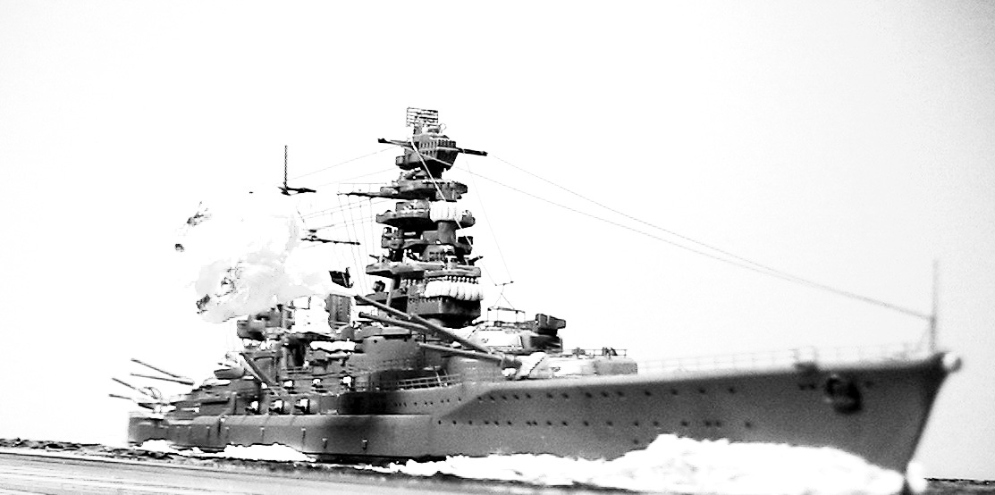

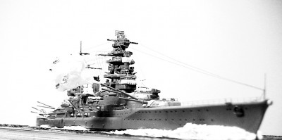

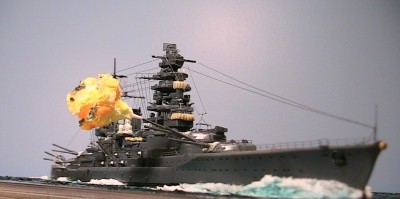

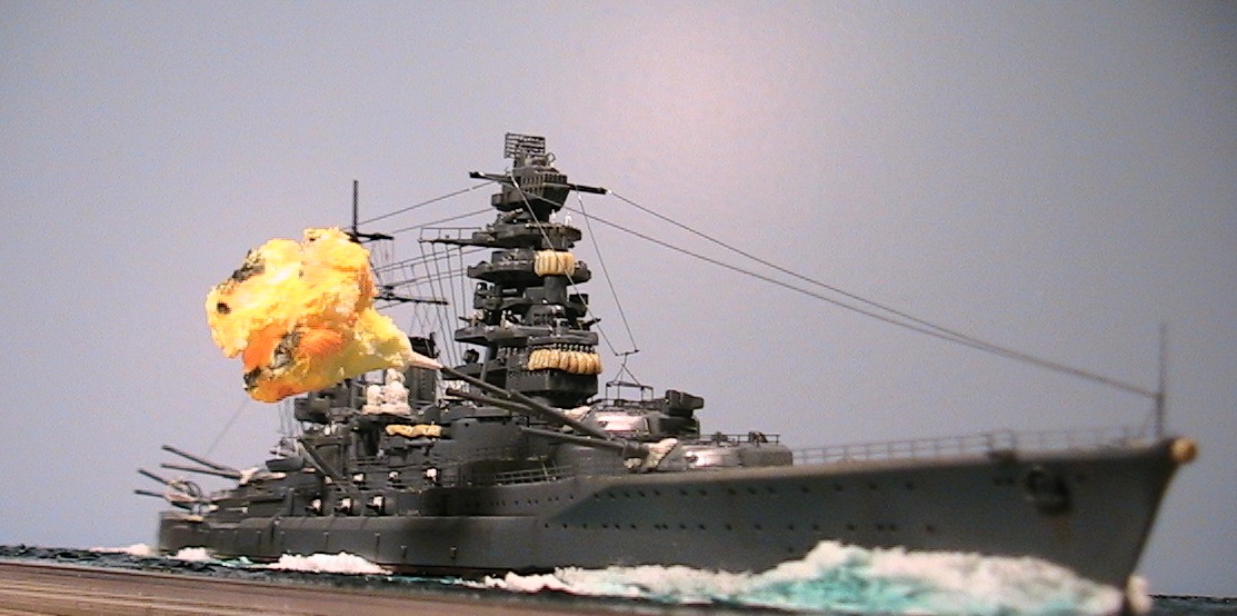

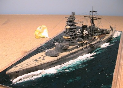

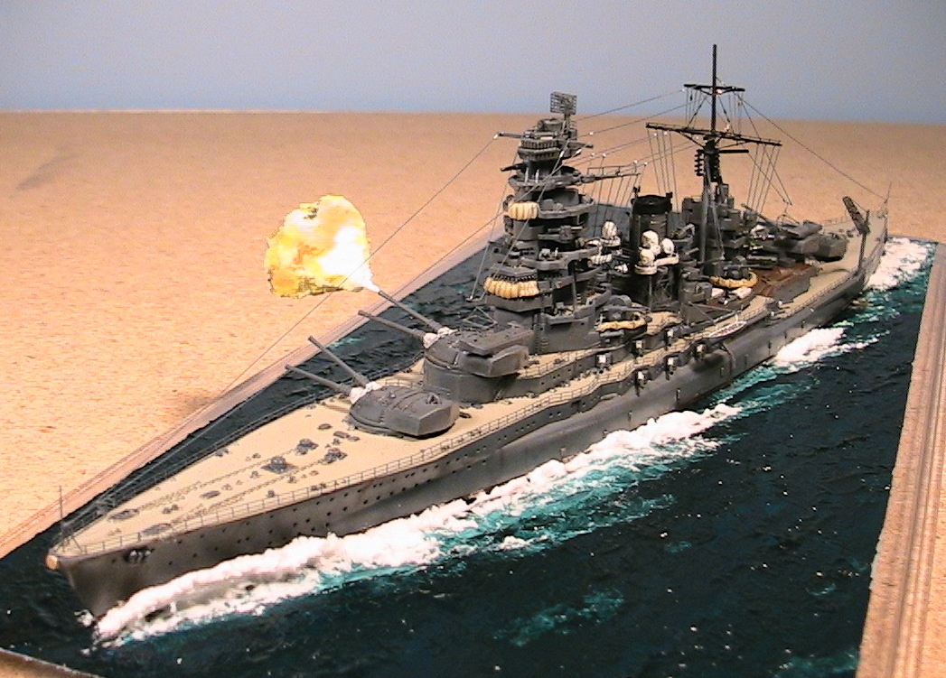

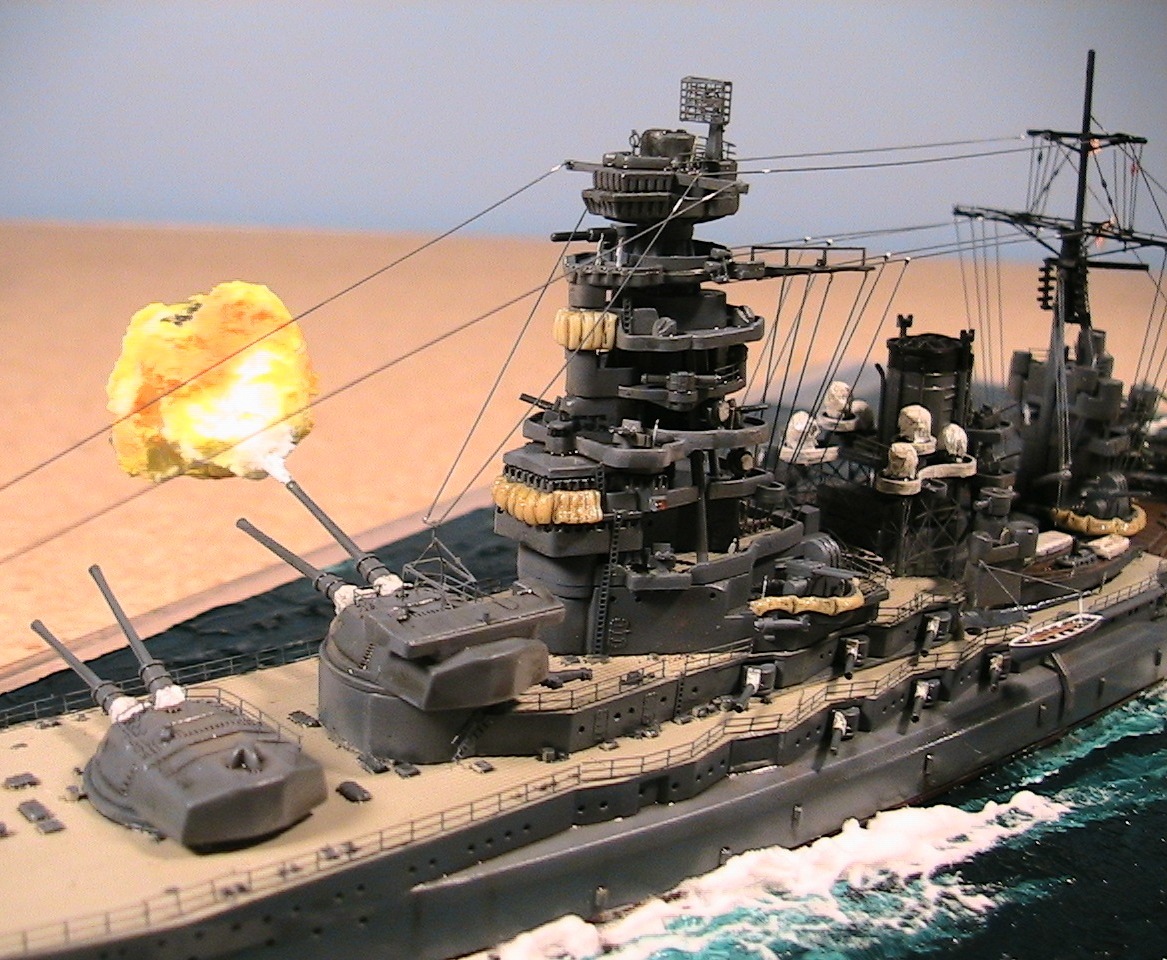

Hello everyone,

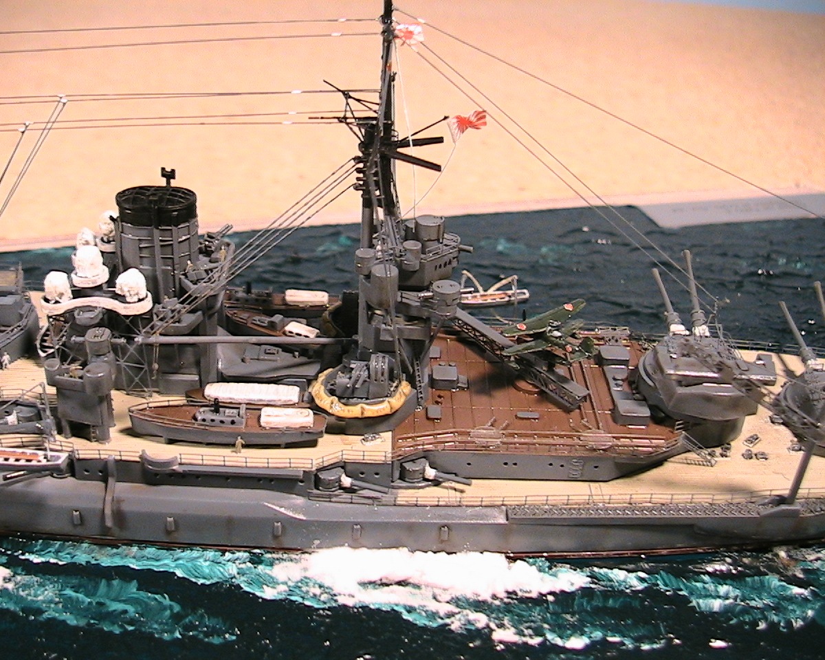

I've completed this project!
Finally mounted the ship and sculpted the waves. Also attached the "blast" cone onto Turret B showing IJN Nagato attacking Taffy 3 in October 1944 in the Battle off Samar. It was the first (and last?) time in her history that Nagato fired at a surface enemy in anger. Her gun fire was attributed with (depending on the source) damaging USS Samuel Roberts, St. Lo and Gambier Bay but there's also plenty of accounts that she did not stay long enough in the firing line to inflict that damage.
At any rate, Nagato typified the Japanese battleship at the end of the war....giants with huge guns, bristling with anti-aircraft guns but vulnerable in the face of overwhelming American airpower.
Enjoy the pictures. It's on to the Myoko but first, I will be taking a spring vacation to Japan (material sourcing and research!).

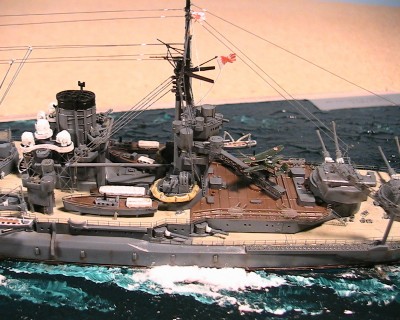

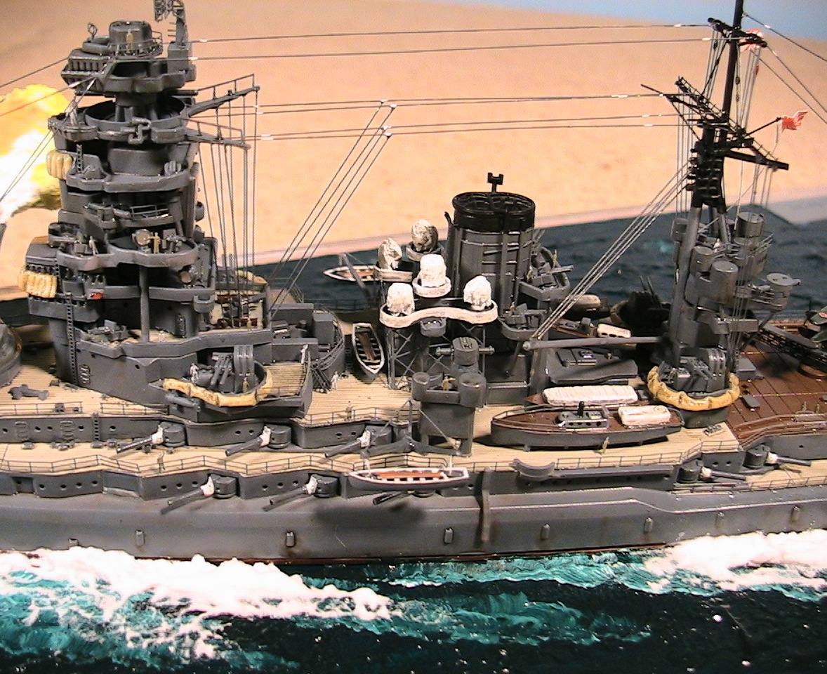

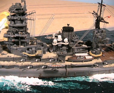

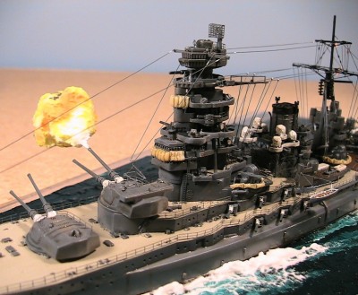

Close-ups of the deck details.

Absolutly love it! Excellent work!

Nice work, love the blast effect you did, really turned out nicely... looks beautiful...

Very, very impressive build!!!
