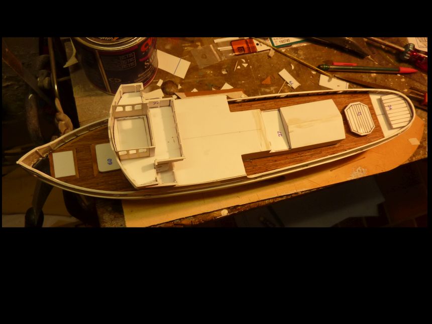

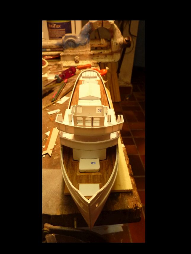

Sorry for my long absence, it�s been a bit busy in my job - and due to that little sideshow by Dean�s Marine, called "Seaman";-)
It�s an argument for my wife to join me at meetings at the pond with Renown and her mates...
More to come soon as I hope...

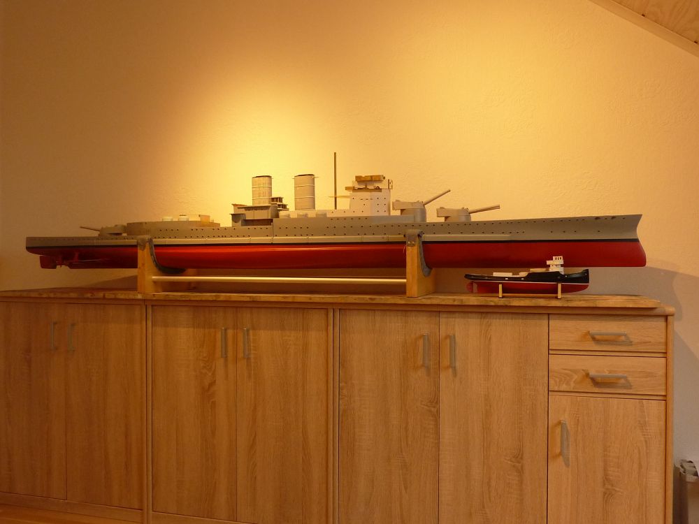

Renown has got a new home port / shipyard: M�nster.
My wife got a new job at M�nster University, so we all moved there including small and big ships.
In the meantime I have wasted my time with preparing the move and arguing with our Dortmund flat owner who wants his flat almost completly freshed up - what we already had done moving in 6 years ago. So there is still some more fun to come.
I hope I can post some real progress pictures after our very much longed for holidays onboard QM2 in early December!
Best regards, no more from Dortmund (as I hope :mad_1: )
Joachim
Mighty Servant Picasso :-)
Home Port M�nster, for Renown and her little helper

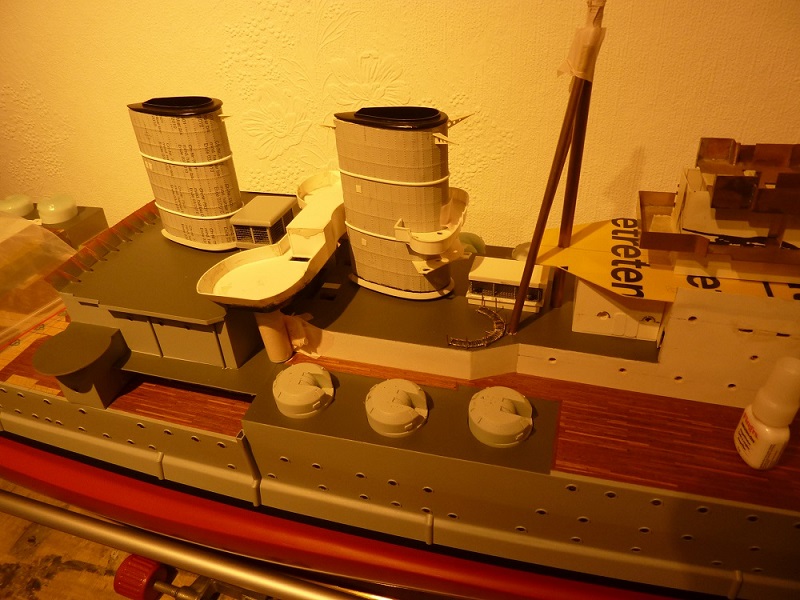

after a long period of silence, here is a little progress at my big project: I started works around the fore funnel with its platforms and the pompom platform. Hope to get a bit further here this year:-)
Best regards
Joachim

Just now back from holidays, work will start soon again - with Renown, too.
The hull is made of plywood frames and keel, the planking is 2 mm balsa with 2 layers of glassfibre inside and outside.
I decided to drop my plan with camouflage design - progress is even now much too slow.
The superstructure is (up to now) plywood basics, covered with 0.5 mm styrene or lithoplate. I copied the trick of late Ron Horabin (thank you very much, Ron!!!).
The Pompom platform is plywood basic, styrene bulwarks and tons of putty.
The turrets are one original (main artillery is styrene dummy, secondary is plywood and styrene details) and then copies of glassfibre.
I have no clue how to produce further details, some parts are bought at John.R.Haynes, some areto bedone scratch.
So some headscratching and you�ll get more photos, hopefully soon!

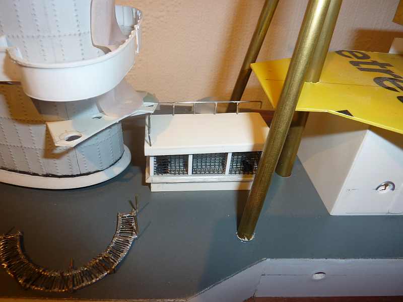

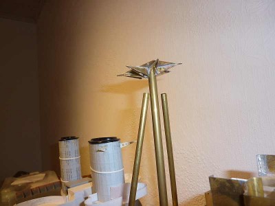

Dear Friends,

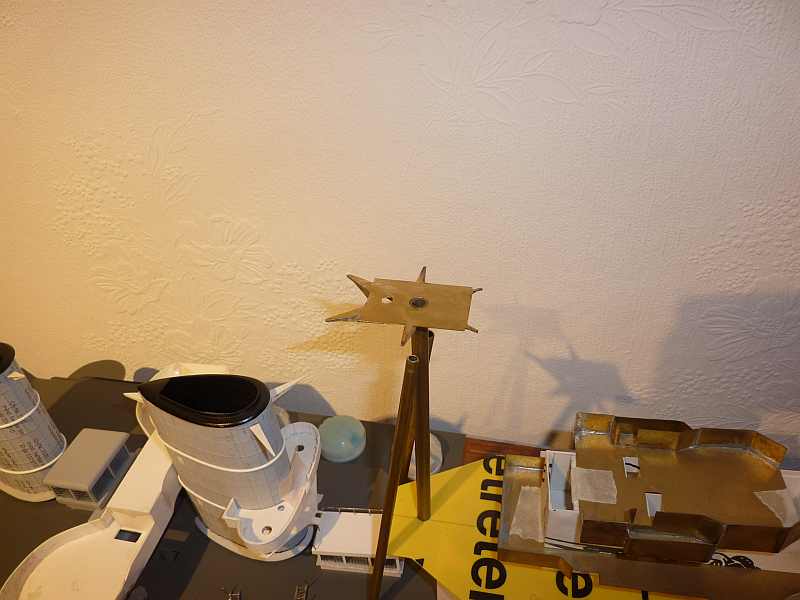

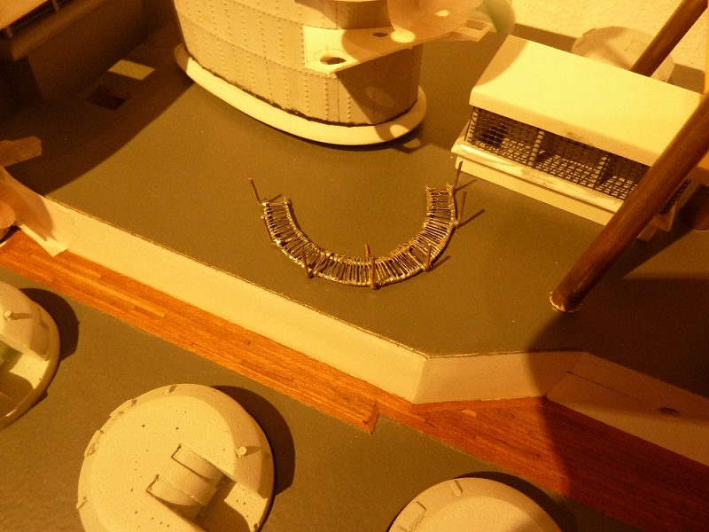

here comes a bit more brass soldering work, the starfish in it�s rough state by now. It�s not perfect, but not yet done completly.
Hope I can go on these days!
I have also added a railing from steel wire on the fore boiler room intake, also in a state as produced...
Thanks for watching!
Joachim

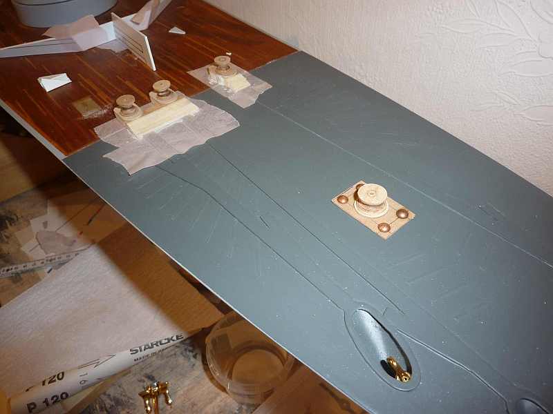

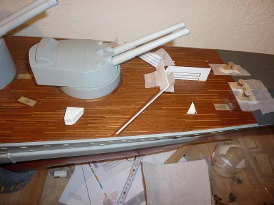

Joachim
Posts: 179
Joined: Sun Mar 09, 2008 6:21 am
Location: Wetzlar, Germany
Re: 1/100 HMS Renown (1942)
Post by Joachim »
Hello!

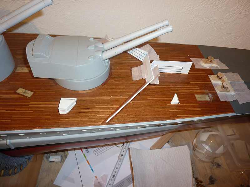

Some days off at the end of the year are pushing this year�s poor results at the shipyard.

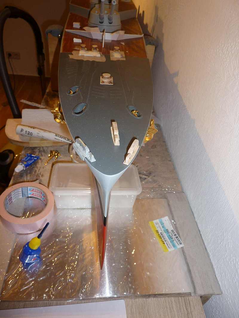

Startet the fairleads and breakwater - made it from styrene instead of brass, just to speed up a bit. Let�s see how far I can get these days!
Happy modelling!
Joachim
