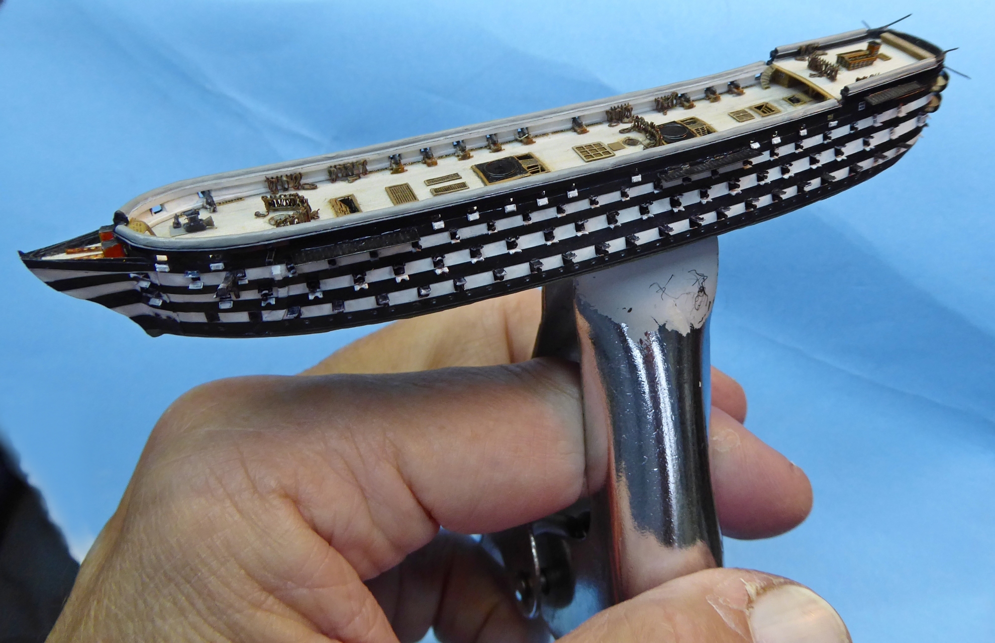

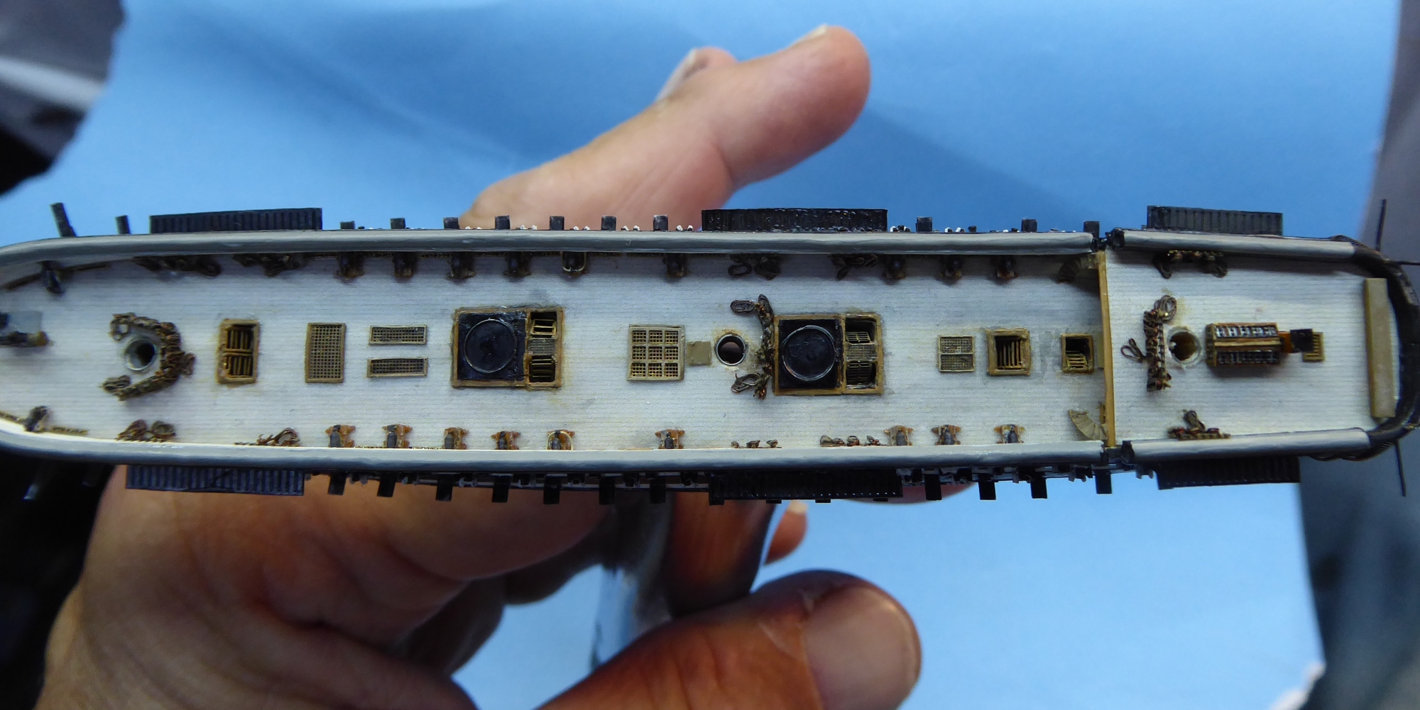

meanwhile-- I have been busy,.... the seeming never-ending Marathon of gun-port-lids eventually came to an end!
....the loss rate was .. epic !! ( I had a lot of spares...!)
The model is now very fragile to handle--it will be 'afloat' shortly!
levelling up the guns--alternating shell and conventional-- trying to the guns and lids level was quite a game... :Mad_6:
ahe yes... Breech lines....
The 18 x carronades on the upper deck were sanded , painted and installed
Handling these tiny 3-D printed items was tricky--the loss rate was, again.. epic!
I ended up painting the barrels first , when dry, plunging the barrels into Blu-tak to enable carving and painting of the carriage

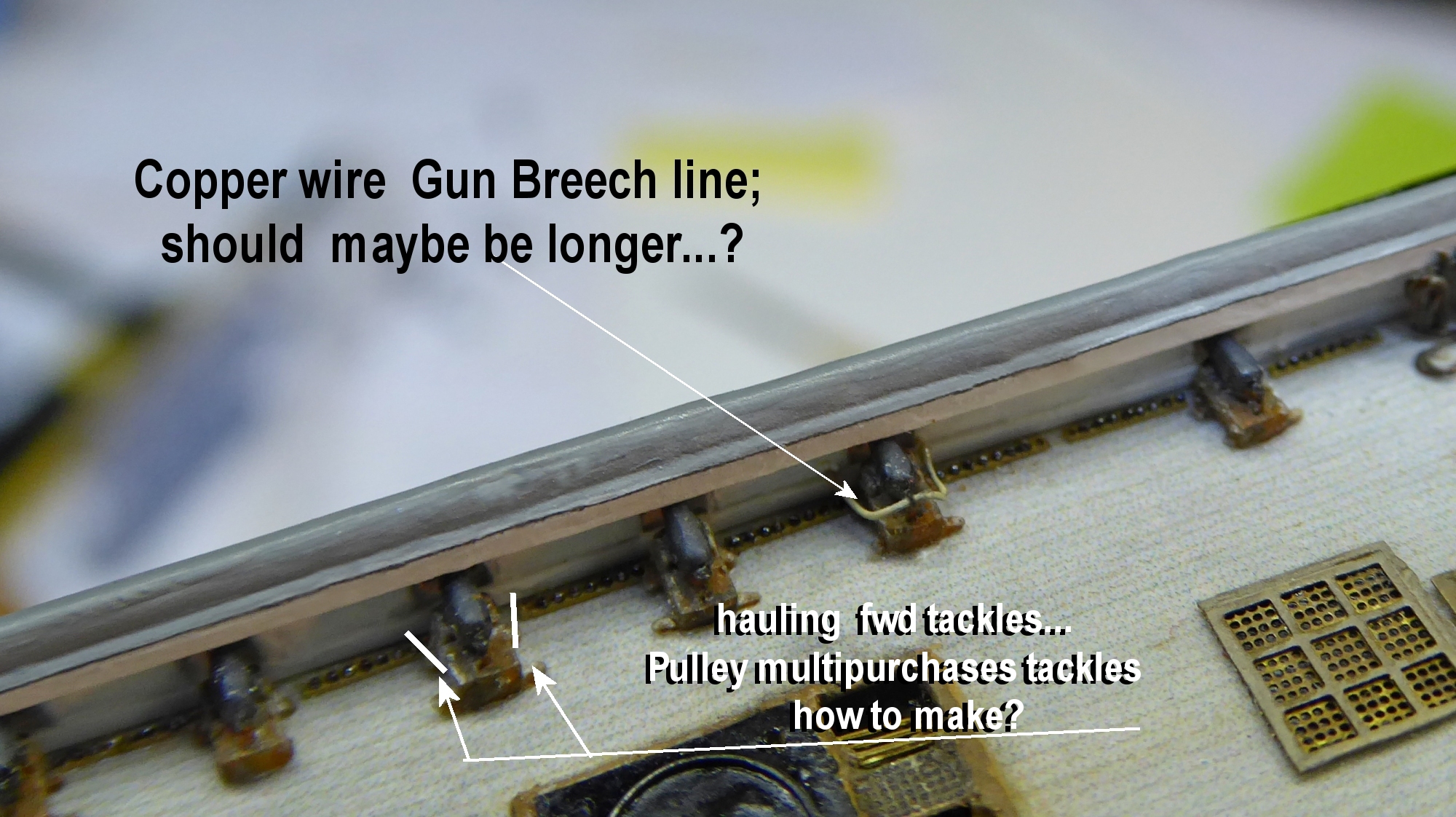

Breech ropes and other gun tackle
I experiment with breech ropes, tiny things to make and handle in copper wire
effect is OK ( once the ' rope' is toned down--but,... is it long enough>? these carronades have a stubby barrels
and I reckoned if that line was taut they could get the plungers et al --what do you guys think?
and then there is the conundrum how to make/ 'imply' the hauling tackles either side of the gun carriages...
any thoughts welcome
In 1/700 is really IS very small....

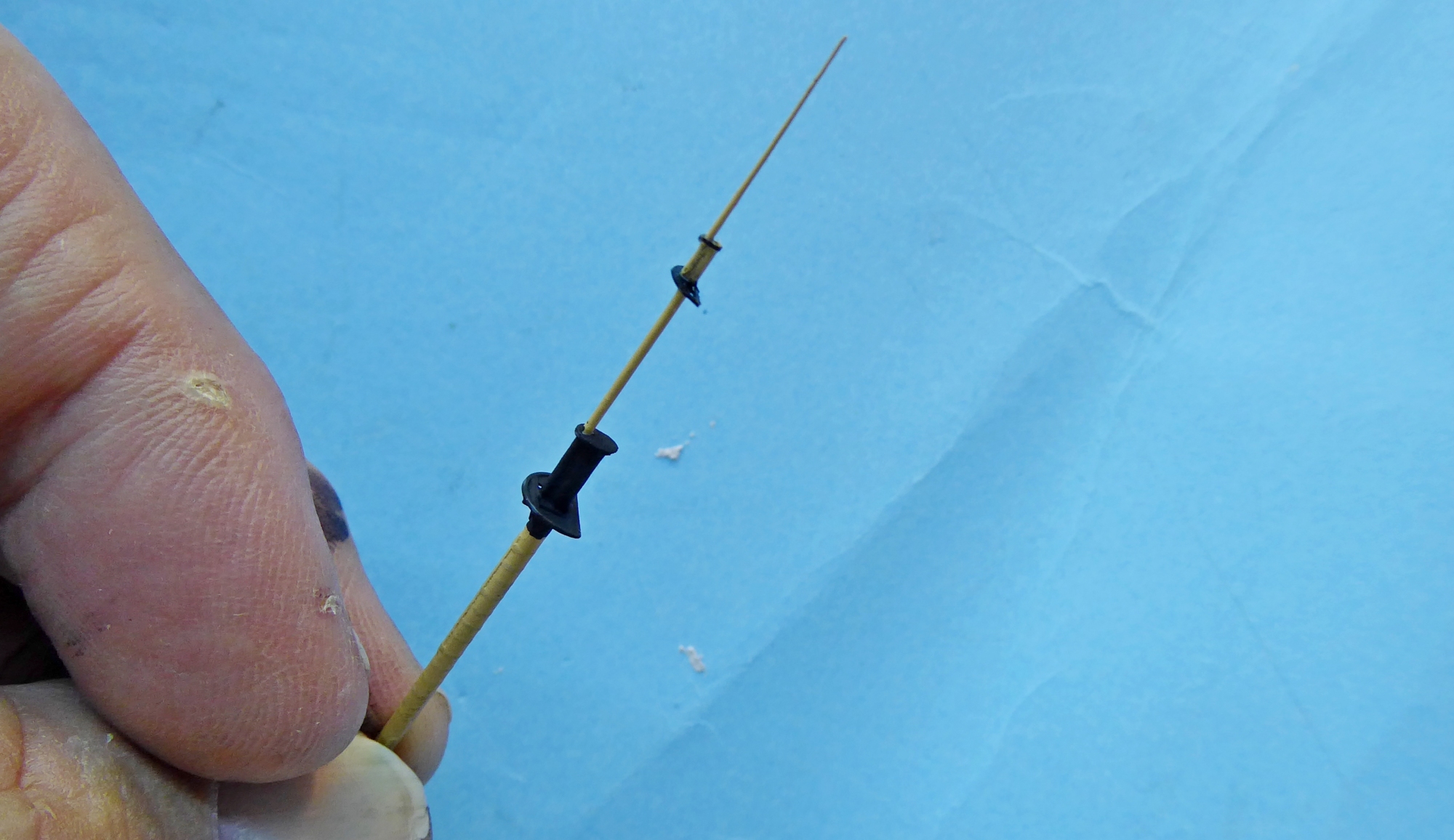

meanwhile-- I have been making masts
the gorgeous 3-D platforms ( which I could NOT scratch-build in 1/700 ANYWHERE near that well !!)
are mounted on the masts--with some trimming and adjustment
I think my masts may be a wee tiny bit thick--by about 5% maybe?
nayhow--to get the lovely upper spreader platform over the upper masts--I had to cut them longitudinally
and then reassemble around the mast in situ
---the images show / illustrate my get-around -the -problem- method

Our colleague @dafi printed gun-tackles and they looked very convincing, but this was in 1:96 scale. I don't think one can print ropes that thin.
What a about McCaffery's technique of paper-disc to represent the cheeks of blocks glued to an arrangement of twisted wires? Or at this scale perhap just tiny blobs of paint or white glue?

Soooo.....
............"back oi the conundrum how to make/ 'imply' the hauling tackles either side of the gun carriages......"....
Because it is soooo very small..... I did some lateral thinking....
bearing in mind that theses carronade mounts are not on any wheels-
just timber feet slides ,
and in that instance it appears from what I can see that the ' haul out' gun tackles they are mounted further aft
I also surmised that as my model of the vessel is at 'sea' forec 3-4 ( lightish winds in flattish sea)
the carronades would be secured -- but ready to deploy
hence the / my tackles are taut :smallsmile:
The images below should illustrate;

Your ability of re-purposing etched parts is quite amazaing. What's your strategy (apart from a perhaps very good memory) to find the right kind of fret in the myriad you must have?
Did the last picture show guns or carronades? When ready for sea, a lot of the tackles would be tied to the guns or unshipped (e.g. inhaul tackles that would impede communication along the decks).
Re: 1/700 Bretagne-1855 scratch The largest wooden wall wars
Posted: Mon Oct 21, 2024 8:31 am
by JIM BAUMANN
Hi Wedalck
They are carronades -there are no hauling back tackles fitted when not in action ( I believe...)
--but I may do some very small rings ( very small ! ) INBOARD of the carronades
any thoughts any other lines on the carronades to keep
the stowed outboard-../ ==..> stowed but ready to Deploy! :cool_2:

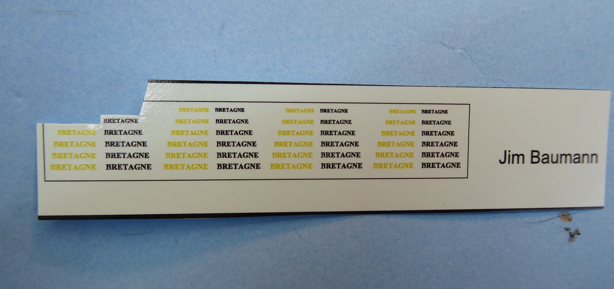

On the real Bretagne -when the ship was in build--there was a ( temporary ?) name on the stern--very small indeed
The name script in that images is very small by any standards ... especially for the flagship.
This appears to be borne out by the two following images- as far as one can
( no photos of the stern...!!

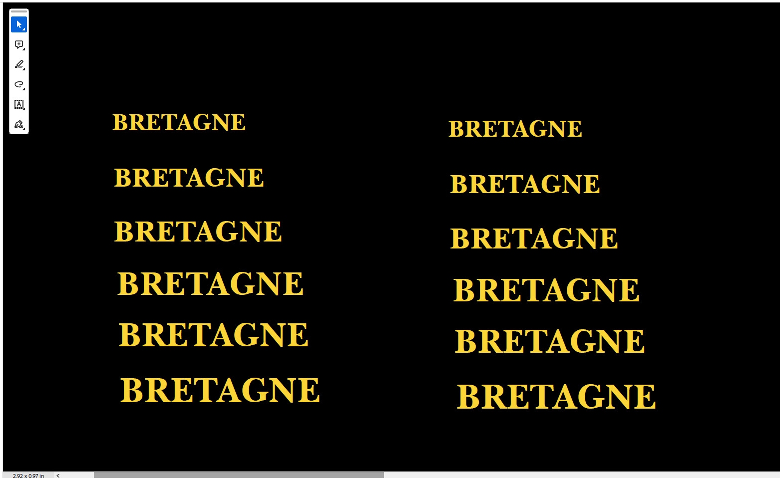

I had a script drawn up in the correct font and size to produce a decal from a pdf
but the gold did not print well on clear decal paper( no opacity )
( and 2 decals on top of each other seemed like it might get clunky )
so what I have done in the past-- is get the script on a black background --and print on white decal paper :cool_1:
to gain the density for the gold script decal
this has worked really well in the past ....-for a number of ship projects, alas both the printing & the decal process went quite wrong ,
the liquid decal film ( microscale) making quite the mess
A friend tried to print it with a laser printer
catastrophe! :big_grin: :wave_1:
I threw in the towel and asked around for a short run / one off decal printing service
it was suggested by a few people ( thanks Rui Matos) to use the German firm http://www.decalprint.de
The print came back ( looking good too ) 2 x small sheets @ euro 7;50 including postage
and after waiting an agonising 8 minutes(!) for the decal to lift off the backing paper....

there were a couple of gun port lid casualties ( :Mad_5: ) as a result of handling the model
easily fixed and replaced-- for now I am happt that the ship is muuuuch less vulnerable to
knocking things off now the large seabase( 6 mm aluminium) and the paper over sticks sea will protect it!
ensuring that the intended angle of heel remains while the slow setting white glue hardenss....needed a 'Heath-Robinson' solution

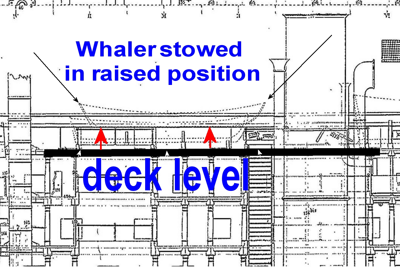

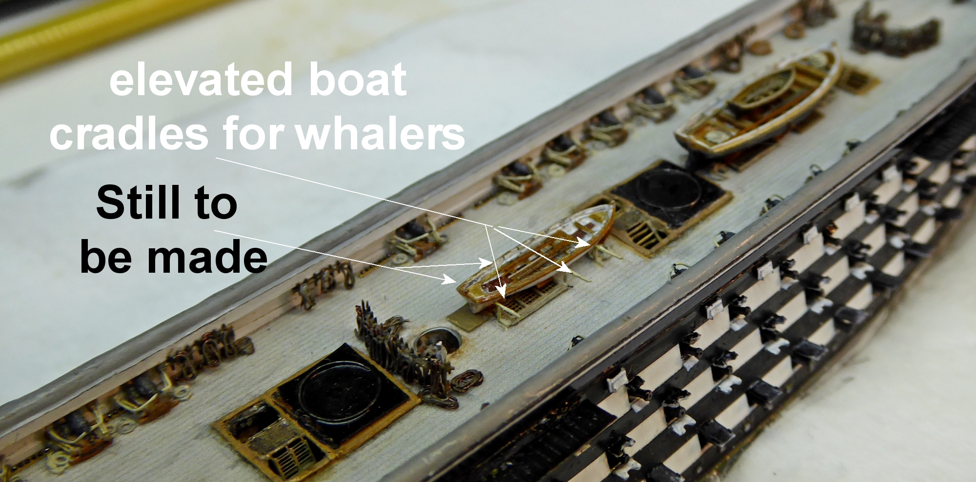

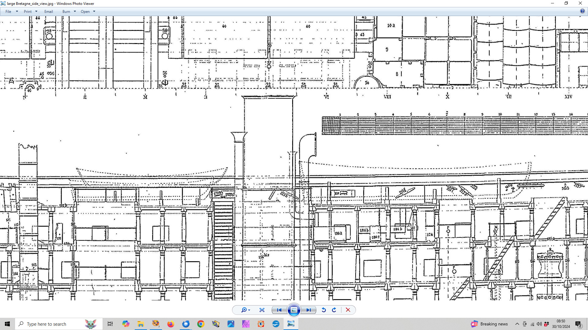

I have a query--have also asked my closer contacts-- but someone may know...?
The distribution of ships boats is listed ( 13 boats )
and position of these are a small mystery ; 4 whalers -(2 each side on aft davits,) 1 boat ( captains gig ) on stern davit = 5
2 x whalers midships and 9 meter or so gig between them = 3
1 x 12.5 m large rowing obat forward centre Total 9 boats.... where do the other x 4 find a home?
hence thinking about nesting a smaller on on the big boat and 2 dinghies ( 14 ft)..." elsewhere "
Positions of these are only quite vaguely indicated on the plans--- but I can draw conclusions by scaling the plan to length of boat and placement
happy enough with that
so question 1
when nesting boats-- do-you think they removed the ( if removable ) the Thwarts? to lower the height of the upper boat into the larger below ?
Question 2 ....
in your plans / book of Napoleon Amis de muse de marine, ( if anyone of you you have it...? )
can you see any indication of a steam launch having been carried?
Napolon being a close contemporary of Bretagne would have similar practices...

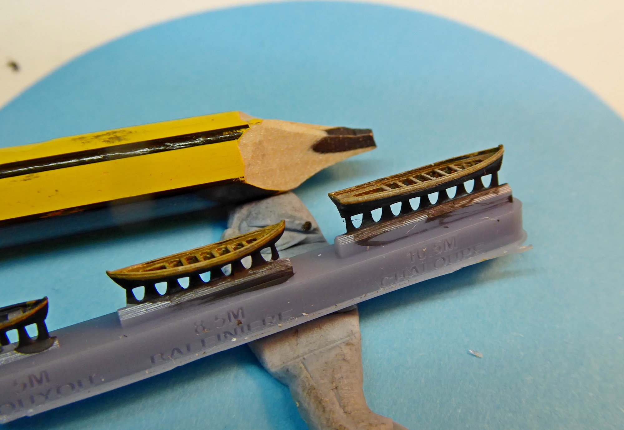

small update; ships boats....
I did not think I would live long enough (!!!) to scratch-build the numerous - and various boats
==> to a standard I would be satisfied with - and maintain the momentum of the build...
These boats were 3-D printed for me by my French Friend Bruno
They are based on the boats of SOLFERINO ( 1861)
which carried a near identical complement of vessels
Bretagne seems to have carried 6 x whalers, as such I received numerous duplicates
The boats were beautiful--timber strakes , undercut thwarts, knees etc
Alas the ( my ! ) painting diluted the delicacy a little-
-but still a quantum leap from the usual ships boats seen in resin or plastic.
SOLFERINO - being and ironclad and whilst carrying a full sailing rig was already more of a
steamer than BRETAGNE --- hence she definitely carried a steam launch;
This conviction does not seem extend to Bretagne , who it appears was less likely to have had a steam launch ( nor it seems did her contemporary NAPOLEON )
Nevertheless I splashed some paint on mine ! :big_grin:
but this may be used at a future date on a future model!
and painted numerous versions of all of the below;
The very large pulling boat ( 41 feet !)
Captains gig ( hence white )
27 ft whalers and 34 ft pulling boats
copious whalers !
All the boats were then furnished with oars, made of beige stretched sprue
Oar blades width for boats are approximately 7 inches wide( or narrower )
hence in 1/700 that translates as 0.25 mm ( which is very small !)
-hence I did not flatten the blades) as that would look over-scale in my view
On deck- -like many large sailing ships, she carried spares, 3 x spars and a topmast section
These were stowed midships adjacent to the central gratings
The deck stowed whalers were stowed in a raised position
to allow the spars to be stowed underneath
This presented a bit of a conundrum-- How did they do it?
plans are not sufficiently clear to show this...
study of photos of near contemporary preserved ships ( HMS Warrior, Jylland )
show the cradles consisting of a ( removable ?) central mono-posts with cradle -- with removable padded side props...
It was important to me for these to be structurally sound in 1/700 , as opposed to exact scale fidelity;
anyhow--with the boats on--only a 1/700 ' Matelot could actually see what is going on underneath!
so a compromise solution was to cut a C shaped pieces of brass....( from old overscale handrail )
this looked -- without boat like this
when whale boat is on board this gives correct height and space for the spare spars to be stowed underneath
I will add side legs of wire after the spars are in place to make it look more convincing !
Oh yes-- and I did remove the name and replace it with a smaller one...
its a little bit bright at the moment--a gentle dark wash should mitigate that I think
