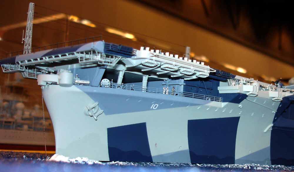

Hi Tracy, hi all guys,
well,... a picture is worth a thousand words (especially words by a non-native speaker).
This photo of Keith's build illustrates well what I was thinking of doing (and Keith actually did) under the flight deck, at the bow.
Please look below the supports: Keith added a gallery deck level there.
The same idea came to me when considering the catwalks archways.
There were some located forward near the bow, where did they get to ?
So I tought may be the gallery deck extended past the foremost hangar bay bulkhead.
Or may be the archways near the bow just connected external to internal catwalks.
If I made myself clear in my last post (I seriously doubt it) and then if (another if) I got Tracy's explanation right, it may well be a mix of the two (some enclosed structure + some catwalk - may be even different from ship to ship ?).

Luca Bevilacqua wrote:This photo of Keith's build illustrates well what I was thinking of doing (and Keith actually did) under the flight deck, at the bow.
Your link goes to the main gallery page and not the direct picture; do you mean this image?

Luca Bevilacqua wrote:Please look below the supports: Keith added a gallery deck level there.
According to drawings I have of CV-9 and CV-16 (Alan Raven's Essex Class book) and CV-11 ("Anatomy of the ship Intrepid") Essex and Intrepid didn't have anything like what Keith did. The drawings for Lex are inconclusive. They had some catwalks underneath and transverse beams, but no enclosed structure.
Luca Bevilacqua wrote:The same idea came to me when considering the catwalks archways. There were some located forward near the bow, where did they get to ?
To catwalks mainly. If you look at photo 80-G-242616 on Navource's CV-12 page (10 down) you can see catwalks at the corners that extend back. There were also some compartments inboard; there were usually clipping rooms near the 20mm galleries so you might see an open space and then a boxed off area.

Tracy wrote:
Your link goes to the main gallery page and not the direct picture; do you mean this image?[
Yes Tracy, sorry for the mistake, that is the picture I meant to link to.
