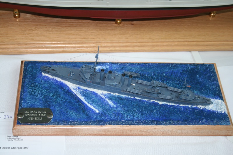

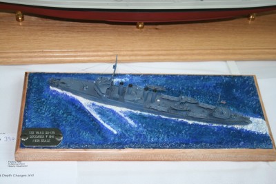

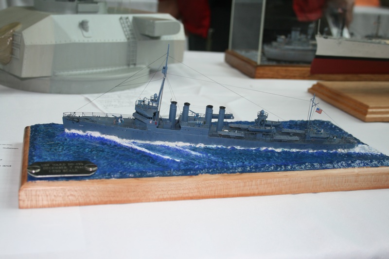

Finally! I completed the Ward last week and here is a couple of completed shots from the OHMS show in Micminnville,OR last weekend. I will post some more here shortly and get some submitted to the gallery.

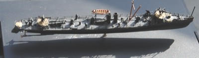

That's a beautiful 4 stacker you have there, Matt!

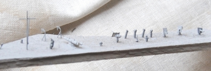

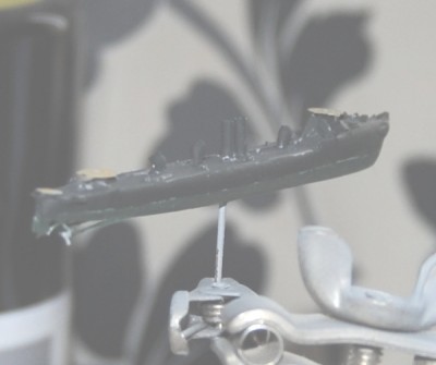

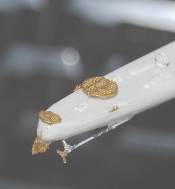

I have a small update. The rudder has been made from two spare parts from the WEM 1/700 aircraft set. I have made the prop shafts + brackets in .3mm steel and build up the thicker parts in Micro Kristal Klear. Likewise the propellers are WEM aircraft propellers cut down to 4mm in diameter and fattened out with Kristal Klear. Now I still have to add the propeller guards (also WEM) and it's off to the basement for priming.

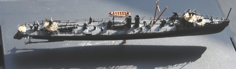

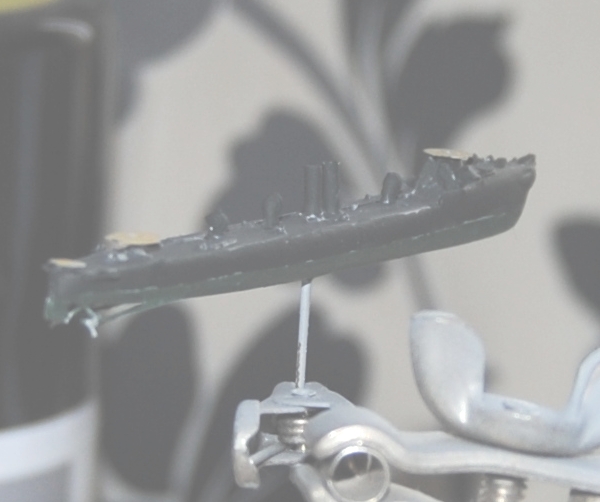

More progress. One of the nicer things of working to a deadline is the fact that I had to stop making small parts and details at a certain point and start painting them. This works against developing advance modeler syndrome but it also means I'm not overcrowding this 83*10mm piece of styrene. So these are the small parts I will still add to Havock, 'frozen' by the need to have them primed and painted by the weekend as I'll be away most of next week . Railings will be from my GMM IJN superfine stash which are already primed and painted.
And my first attempt at painting the hull:

Nice work, fellas. Matt, I especially like your Ward.

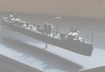

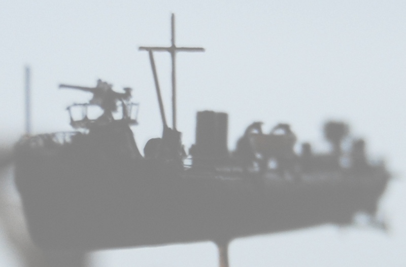

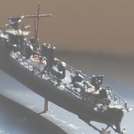

I took a quick picture of Havock yesterday before dullcoating. Will post pictures the finished Havock later today.

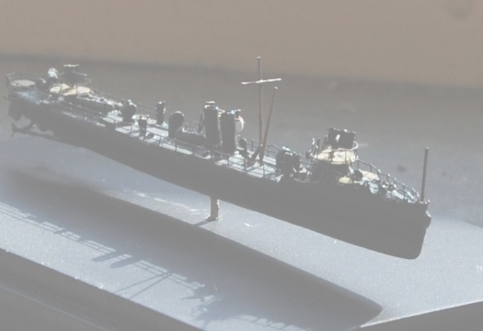

Finished. The brass rod which supported the hull in a third hand was partially cut off, painted in Vallejo white gold and placed in pre-drilled hole in the (trumpeter) small base set and that's it. All in all it was about 60 hours of work, I didn't count the parts. Total cost of materials: about 20 euros, mainly the PE and the base. I really liked being part of this group build and this is actually the first project I've managed to complete in 2010...If I'm not careful I will start to like deadlines.
