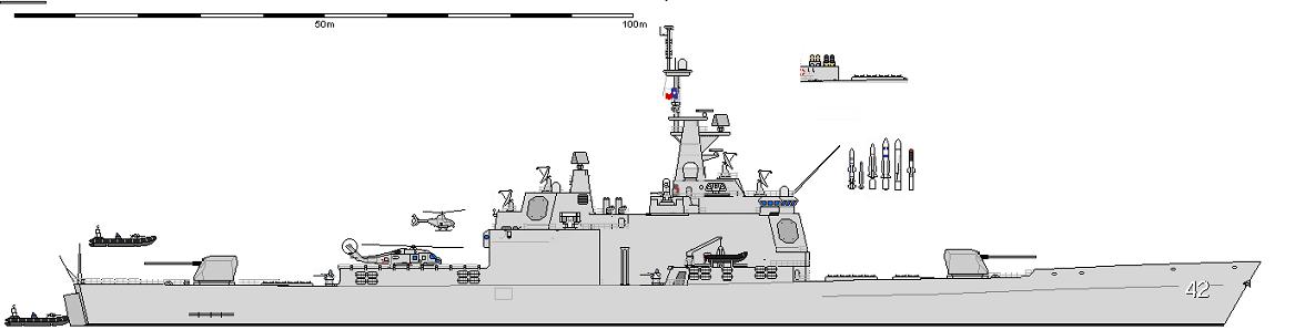

Hey, guys,

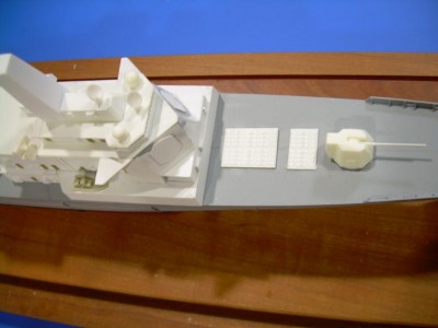

I have made a lot of progress on CGN-42, and I will be posting some pictures very soon. In the mean time, here is a shipbucket manipulation with about 80% of the details really nailed down.
As I will explain a little later, I will construct 2 optional fits between the super structure and Mk71. One is to have the Harpoon missile tub forward for 16 Harpoons and one 64-cell VLS or one 64-cell VLS and one 32-cell.
Needing continued refinement is the mast configuration.
:thumbs_up_1:

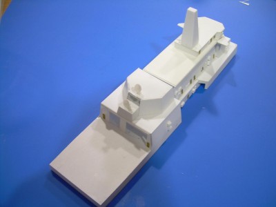

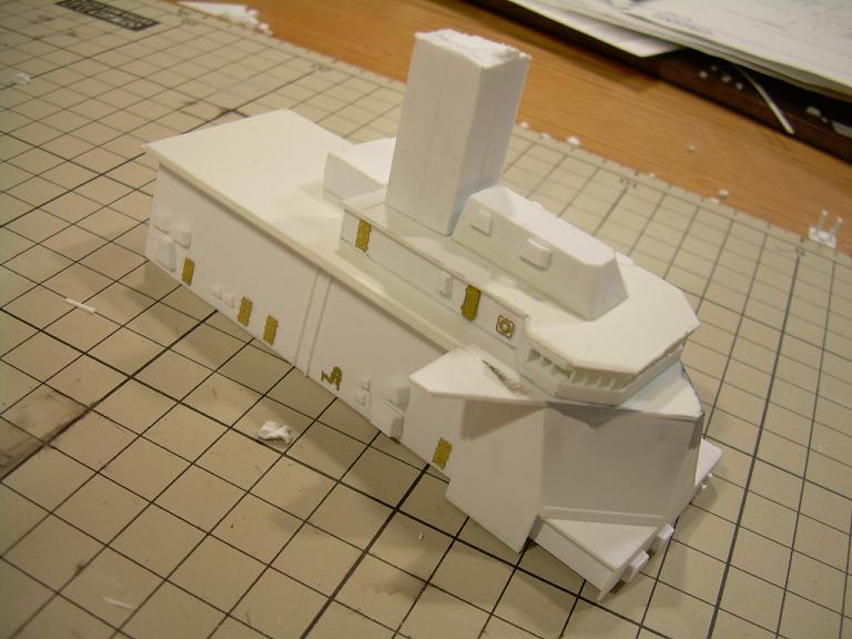

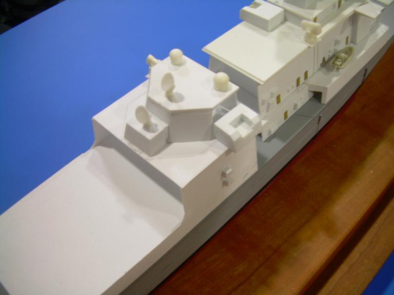

SO LOOOOOOOONG since my last update! I am so sorry!!!
My partner in this project must be pulling his hair out saying, "what is taking this goofball so long?!" Well, work amongst other things...but here is progress!

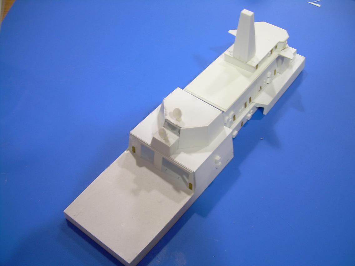

Here we have an over-view of the recent work in general. I rebuilt the aft radar deckhouse. The hanger is done...

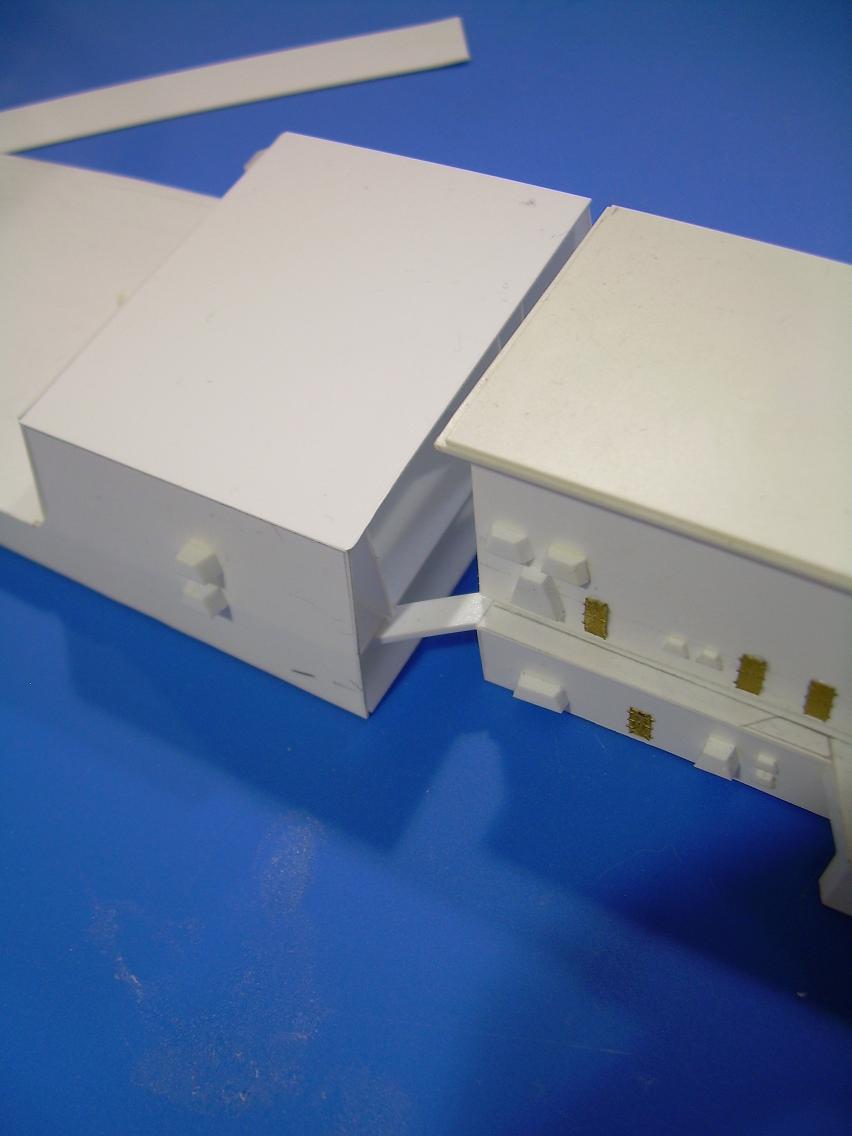

...and now I just have to figure out how to properly join the forward and aft super structures together. Of course it will have to be done with sheet styrene, but the execution is a little difficult!
If there are any suggestions for how to build these structures together, they are very welcome! :big_grin:
Thanks, guys! I look forward to your suggestions and getting it done!

Why join them? You can exploit the gap to place the ras stations and other equipment.... After all, the main corridor should be a deck below, in the hull... :thumbs_up_1:
NIKOS (NICK)
SumGui
Posts: 484
Re: CGN-42
Post by SumGui »
The gap would be a great place for an expansion joint.

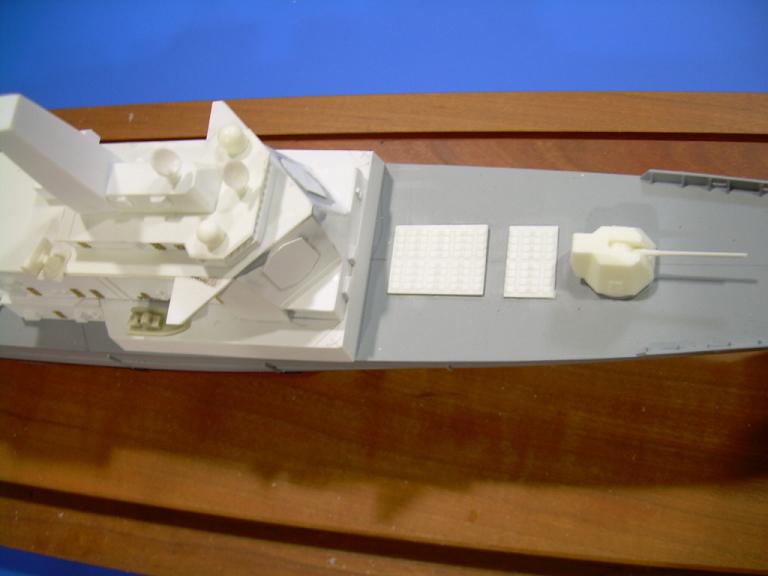

Not letting the joint hold me up, I am moving to build up the SPY-3 portion of the AMDR arrays. As you can tell I already have the large SPY volume search radar (VSR). Now I need to build up the horizon search SPY-3 deck houses.
The general shape of the SPY-3 deckhouse can be seen in this Lockheed AMDR-S video. While it's built on a Flight IIA re-start bridge, I can adapt it to fit CGN-42's super structures pretty easily.
http://www.youtube.com/watch?feature=pl ... DofE#t=77s
So, there are two ways to build this deck house. I can either cut base and roof pieces out of sheet styrene and then build up a little structure with many little angled pieces (which I may very well do) or build up some blocks of styrene and sand them down to the appropriate shapes.

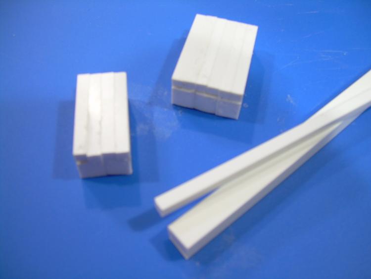

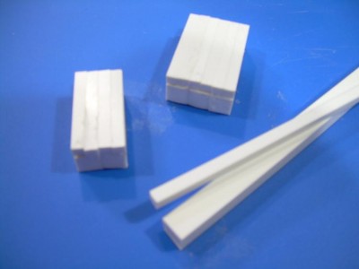

I have begun with sanding down the styrene shapes. So to start that I began with two different sizes of block building up to the approximate deckhouse height.
Then some good gluing with Plastruct's Bondene cement. This stuff HOLDS styrene together. My gosh, when they talk about "welding" plastic...this stuff actually does it.

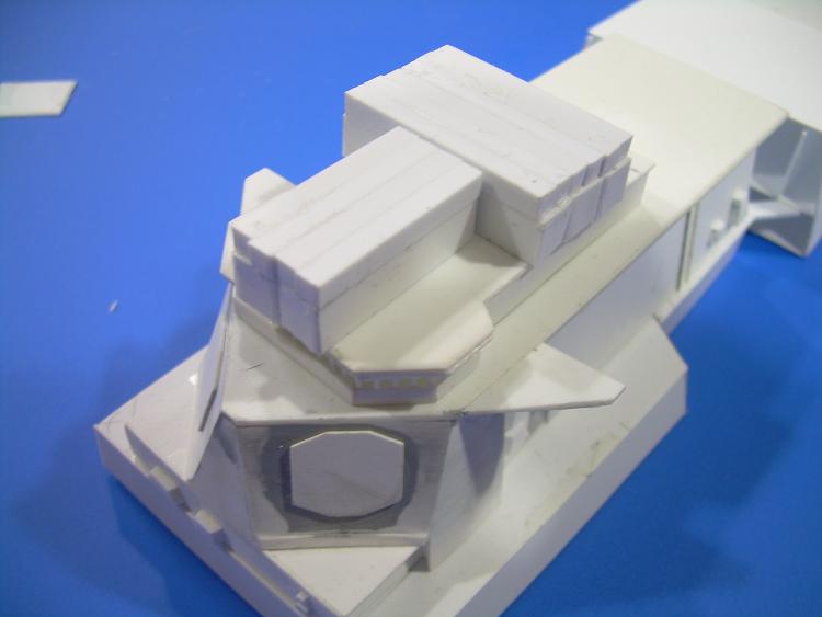

Now that the pieces are roughly cut to the right lengths and placed on top of the structure just to block out the general shape.
I am going to mess around with sanding these pieces down, but having spent about 30 minutes working with it already (and getting a bunch of plastic dust all over my keyboard) I think the way this is going to really be successful is by building it up with styrene sheet.
