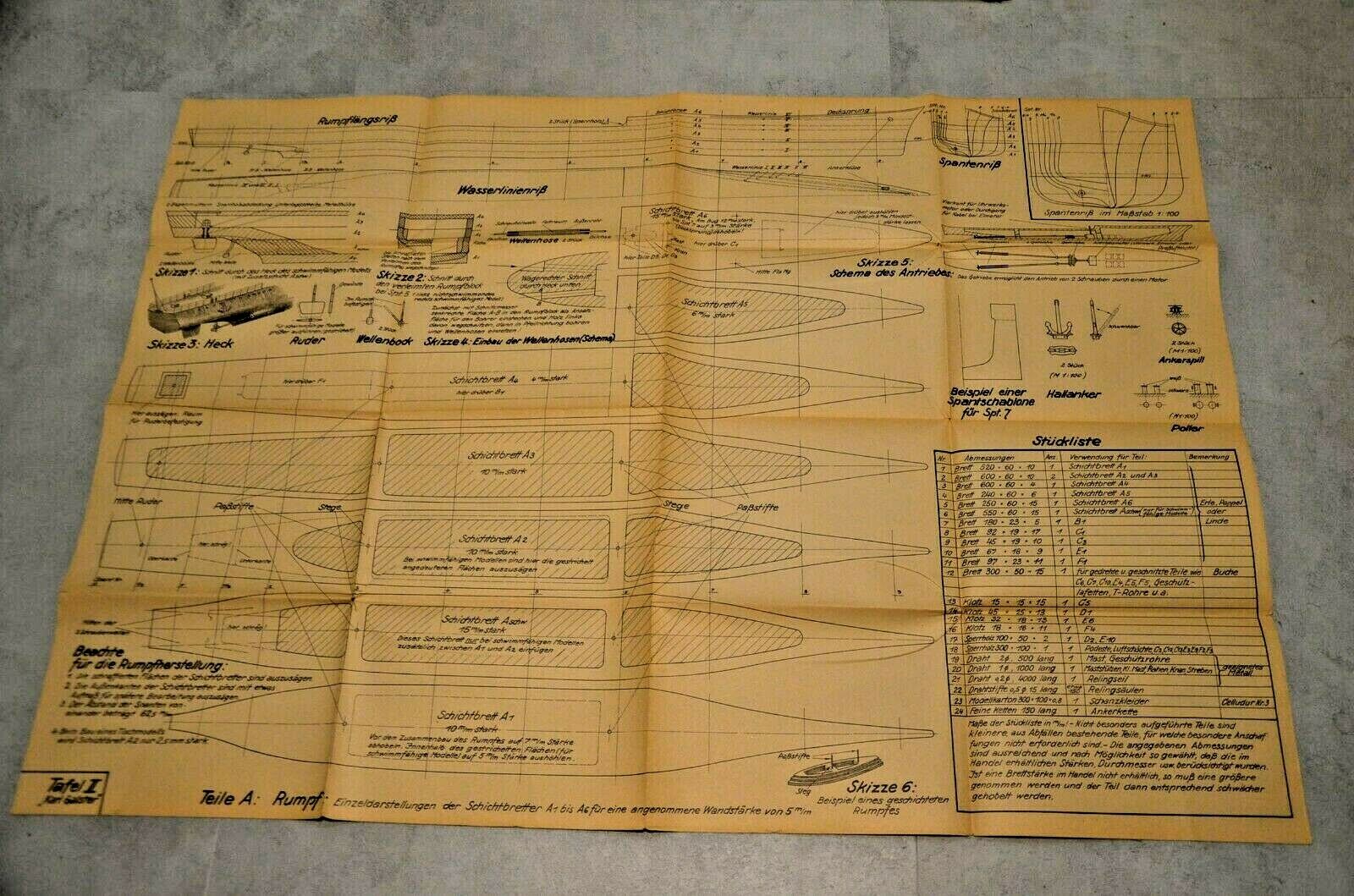

brooksbz,
Thanks. That gave my naval German a "work-out!" The colour scheme described on the drawings appears to describe GEORGE THIELE's peace-time scheme; which Eric Gr�ner's work describes as "'96er Grau."
German aficionados note: there are no RAL numbers given, which may seem a little odd.
