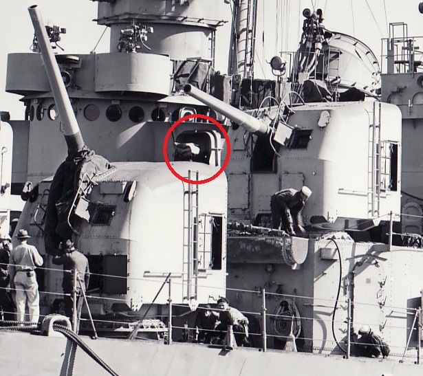

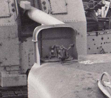

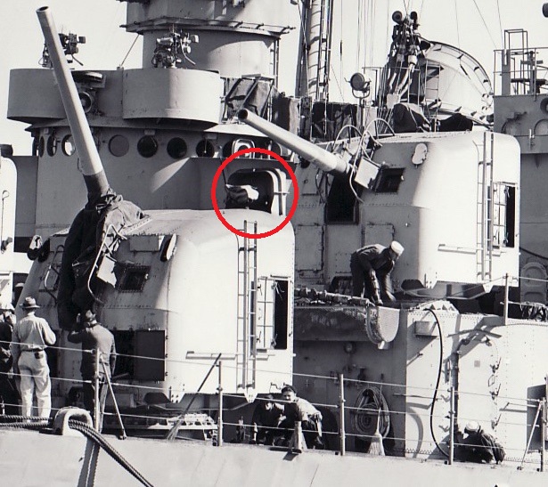

I am modeling a Fletcher Class destroyer USS KIDD . My plans (Blue Jacket) show a "knob" on the aft part of the roof of turret 51 and 55. The plans are not clear as to what this is. Any help would be appreciated.
- Posts: 3871
Irv,
I'm unsure of the time frame you are modeling USS KIDD and what feature you are seeing, but it sounds like you are referring to the hood over Gun Captain's hatch on the 5-in 51 and 55 gun mounts. The hood protected the Gun Captain from the blast of the superimposed 5-in gun mount. Also, in front of the Gun Captain's hatch was a "local control" gun sight used to aim the gun when needed. Often was used in close support of troops during an island assault.
Irv
- Posts: 3
- Joined: Fri Jun 08, 2018 2:03 pm
First thank you for your response as I am a first timer here on this forum. I had not thought of the time frame but my plans show only one set of torpedo tubes. Many of the photos I see show 2 sets. My plans show a pair of 40mm (Quad) mounts and a director tower in that location between the stacks. I am having trouble seeing the structures you are referring to in the photo you sent. There is a lot of Structure showing and I am still trying to separate the various components...Irv
- Posts: 12437
Irv
- Posts: 3
GOT IT !!! Thanks for the clarification ! Irv
- Posts: 3871
Irv,

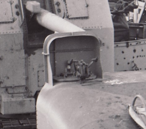

The configuration you are describing is called the Anti-Kamikaze Mod. This was the configuration that USS KIDD was modified to during the repairs to her battle damage during the summer of 1945. The USS KIDD museum people are trying to return her to this configuration from her 1950's configuration.
Here is a closer view of a "typical" Gun Captain's Hatch and Hood. The only difference with the Gun Captain's Hatch and Hood on USS KIDD, is that KIDD had a "lefty" and not a "righty" on 51 mount. AKA the hatch was on the left side of the mount looking from the rear.
