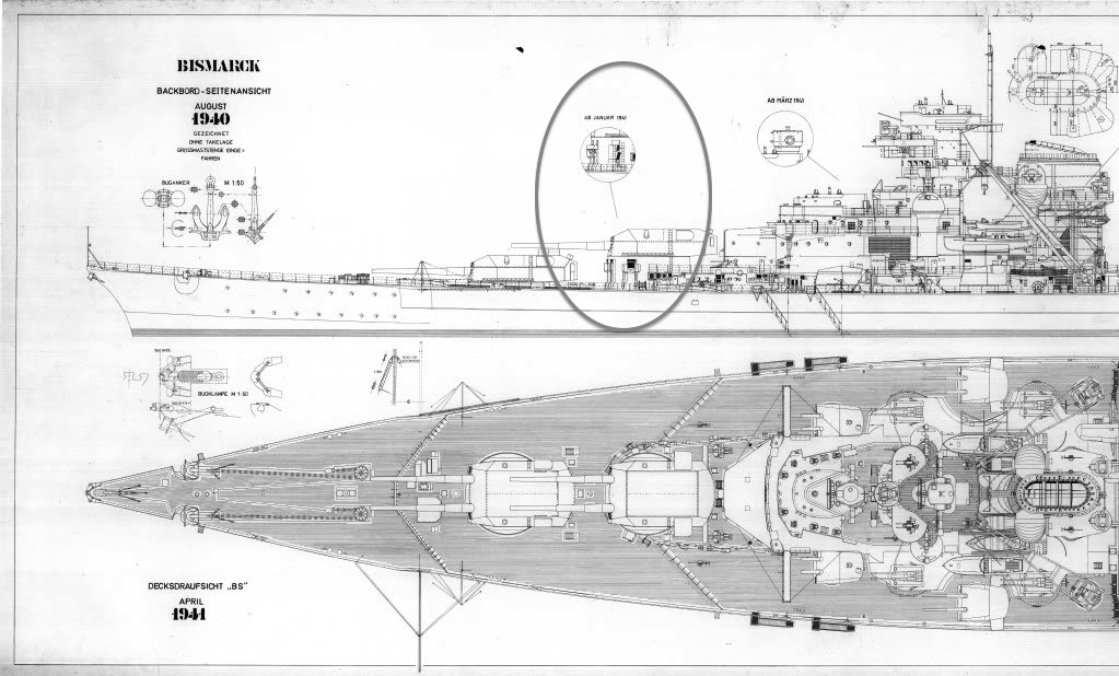

those also which yep just as easily leave the part off, but i meant these vents on the Bruno barbette.

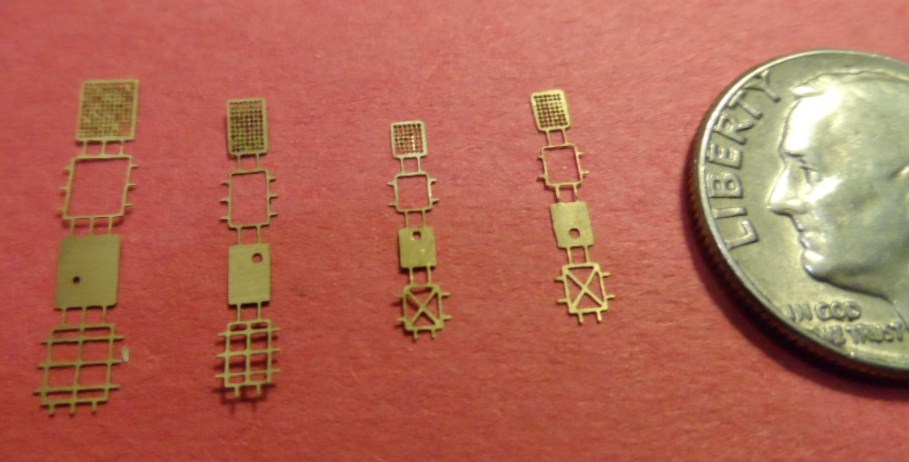

Been working on odds and ends. Like you Channel, Ive been working mostly on portholes and the hull. Did some PE runs, but still need to dial some stuff in to look better.

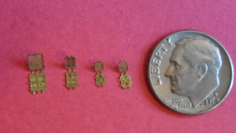

Your PE is looking fantastic! That's just not a skill I have, though I'd like to learn someday. Keep us updated with your progress!Plastic Habit wrote:Been working on odds and ends. Like you Channel, Ive been working mostly on portholes and the hull. Did some PE runs, but still need to dial some stuff in to look better.

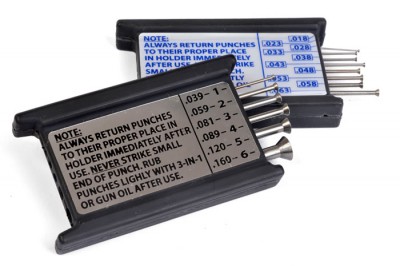

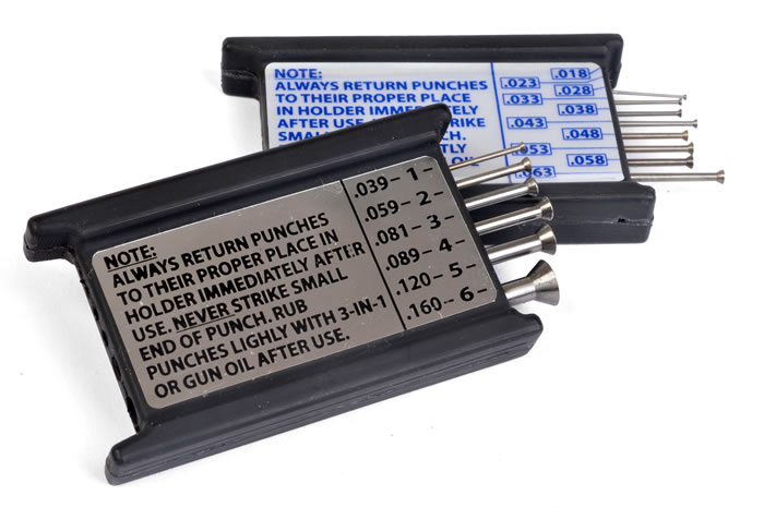

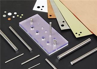

Jason:
I admire your courage and skill in cutting, modifying, and sanding plastic! I'm not up to that level of performance, so I seek a "safer," but effective approach.
First, what is a "porthole" or "sidescuttle"? It is a heavily framed circular opening, holding glass up to 2 inches thick, that can be opened or closed, (to admit light and/or air) and sometimes covered by a circular steel storm plate (shutter).
I believe that the Trumpy kit portholes can be "worked" to an acceptable artistic degree by careful backfilling with clear acrylic cement covered by a flat acetate disk. The discs are produced with a micro punch and die set. Waldron sets have been popular for years to build model aircraft instrument lenses, but, as I understand it Waldron is now out of business. I just purchased a used Waldron set in E-bay for $49. Another source of these micro punch and die sets is Micromark http://www.micromark.com/Micro-Punch-Set,8603.html
If my shortcut works, it would save a ton of body work. One would only need to drill open and thin the plastic for a few open portholes. Bismarck on the high seas or in battle may have been heavily shuttered against seawater or shell splinters. But, I've never seen a shuttered Bismarck model or painting.
- Micromark micro punch and die set $59.95 plus shipping
- 83513_R.jpg (13.62 KiB) Viewed 1999 times

Bill, thanks for posting the link, that is a excellent solution. I will definitely do it this way. I'm too scared to cut the hull.

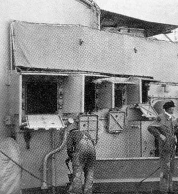

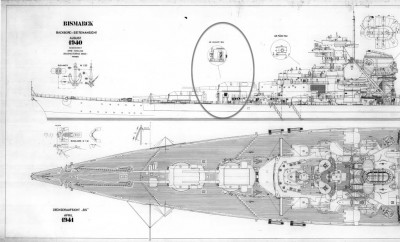

Not sure, It looks to me as though you're going to have to cut the upper half of that part off as the bottom is still there.Channell wrote:You mean the hood over these vents, right?Perth_shipyard wrote:You're correct Jason, as delivered she didn't have any rangefinders fitted but the aft and center were added in December 1940. She still had no stripes and just her normal german two-tone colouring. One thing you will also have to change is the aft most vents on the Bruno barbette - port side closest to the superstructure. On the kit the vents face aft. These were changed in Kiel as when built they faced directly out and where effected by weather. The two vents on the front of Bruno barbette also didn't have the hood which covered the open vents. This is on the kit but a seperate part do you can easily leave them off but will have to make the actual vent grills.
This pic shows the Bruno barbette port side and you can see the vent which is closest to the forward superstructure faces out and the next two- forward on the barbette doesn't have the hood over them.

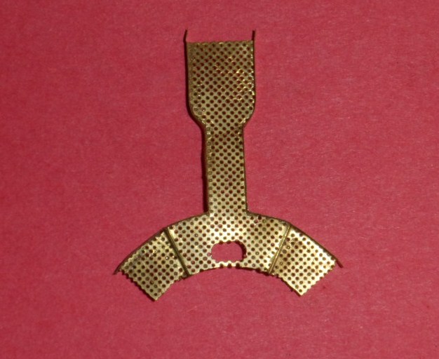

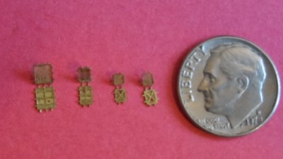

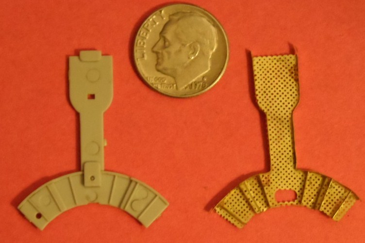

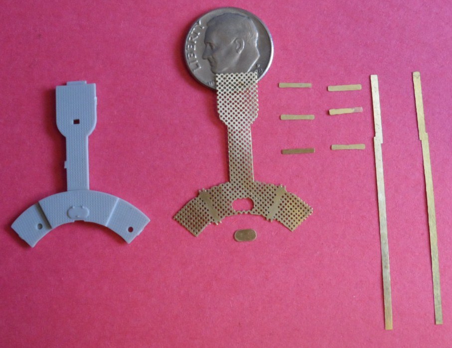

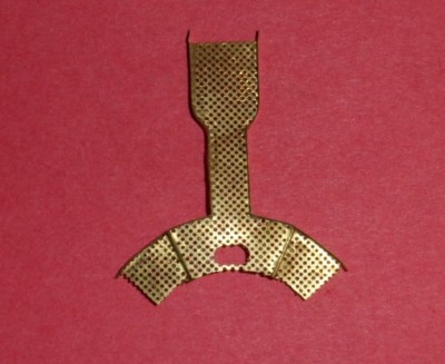

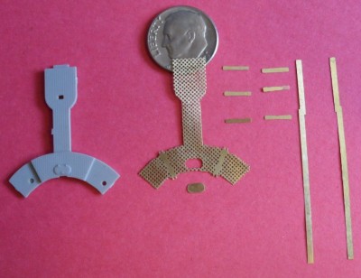

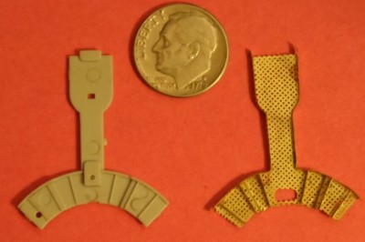

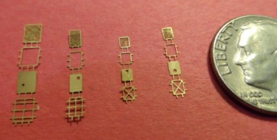

Well, in between sanding and more porthole work, I managed to get a piece of PE done. Its the small bridge between the funnel catwalk and the admirals bridge.

that looks amazing, which PE set is it from?

I think he's making his own PE? It does look good! Plastic Habit, you really should do a build log of your own so we can admire all your work in 1 place!Goran wrote:that looks amazing, which PE set is it from?

Second that!Channell wrote:I think he's making his own PE? It does look good! Plastic Habit, you really should do a build log of your own so we can admire all your work in 1 place!
