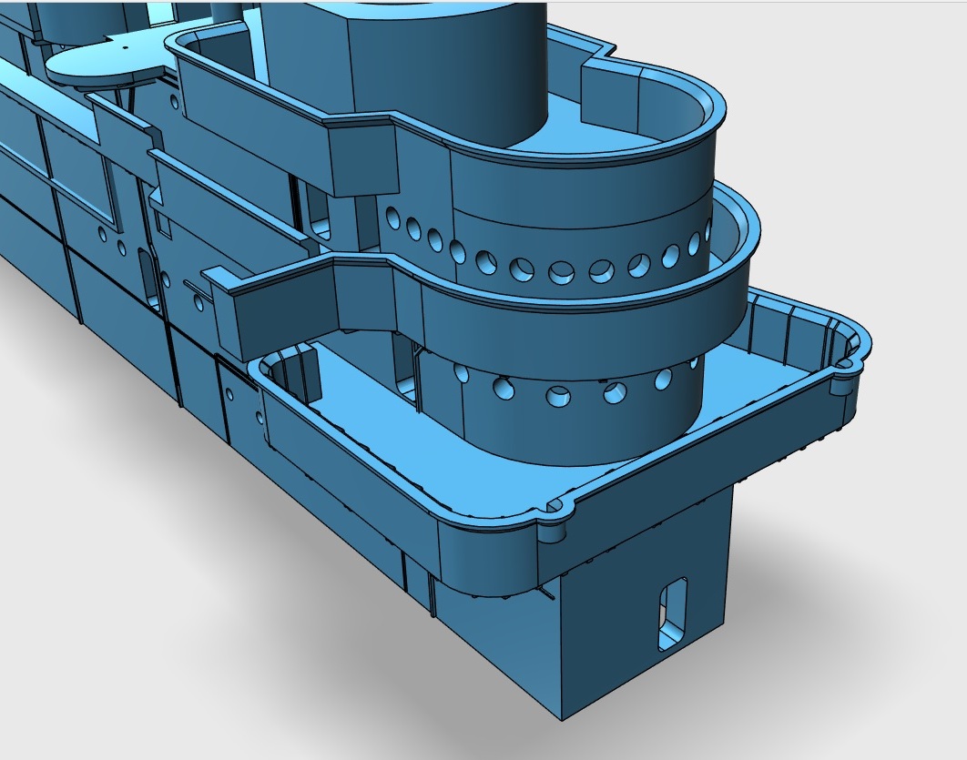

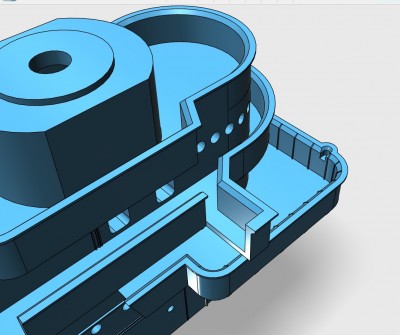

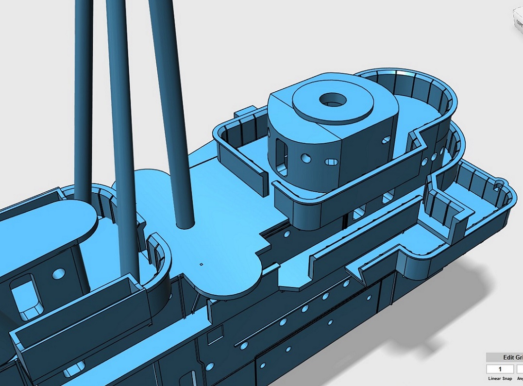

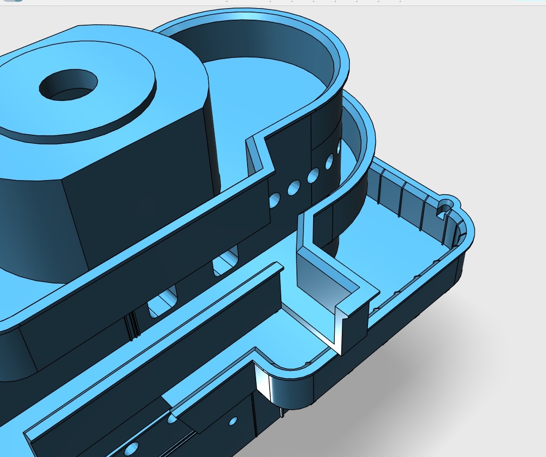

You mean these little ol' thangs? Keep in mind that in order for the splinter shielding to be printable by Shapeways, it has to be designed thicker than actual scale without the handhold pipe on the top. But I think this is a very good representation and will look great in 1/350 and 1/700. The rangefinder "bumps" are to-scale on the exterior, but the interior is a bit small due to splinter shield thickness.John W. wrote:Steve -
Don't forget those little pockets on the front of the Flag Bridge bulwark - I think they are for a portable rangefinder or binoculars.....These were added after commissioning, or certainly after the blueprints were drawn. They are hard to scratchbuild, so thanks.

Steve -
Yes, those! A little file work if necessary is a whole lot better than grafting those boys in later since the plastic is kinda brittle.

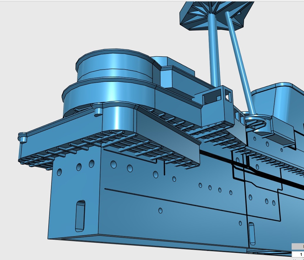

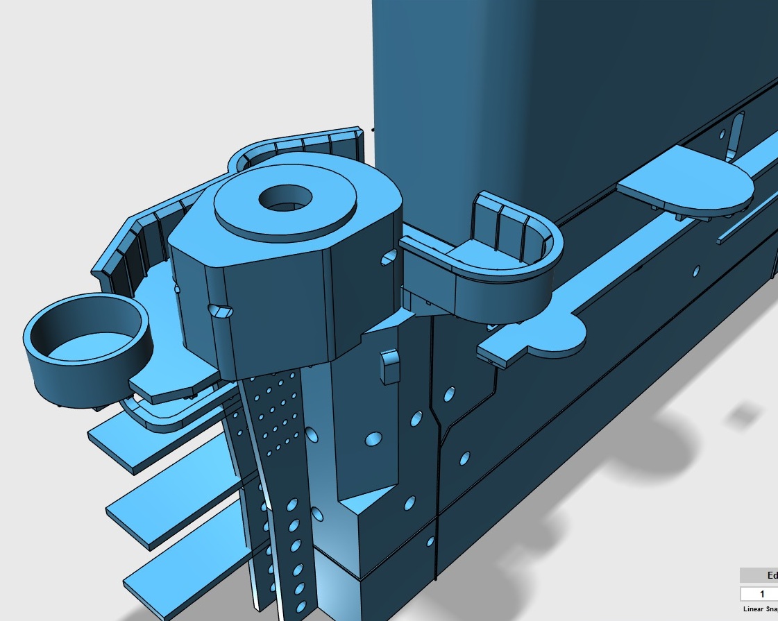

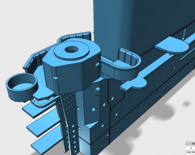

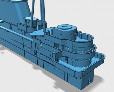

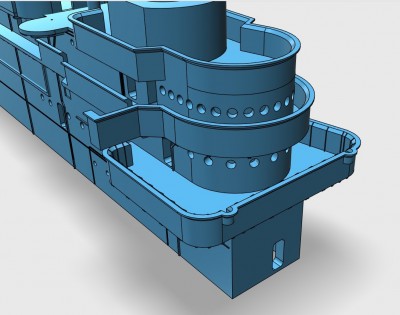

85%. Detailing continues. Next big effort is the fighting top.

Looks AWESOME!!!! Definitely looking forward to a 700/487/350 versions of these!! Very nice work indeed, Steve!!!

It's not in the shop because the design is only at 85% complete. It's not done yet.
Yep, the Trumpeter Hornet is the one with the bow that is too thick. This island is intended for those with the Merit Yorktown or Enterprise kit who want to convert theirs to Hornet.
Hope this helps!

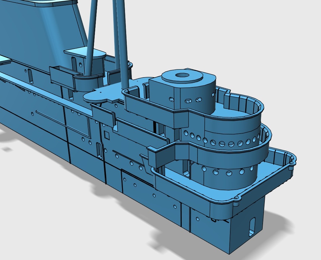

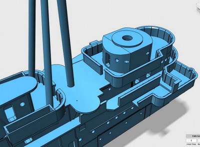

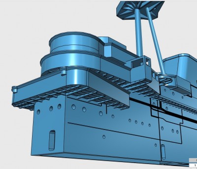

The design for Hornet's island as it appeared in 1942 is complete in 1/350 scale. It will be available in other scales soon (thicknesses of certain features have to be adjusted before rescaling the design).
Some adjustments were made and certain features will appear a bit differently than they do in the above renderings.

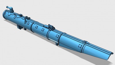

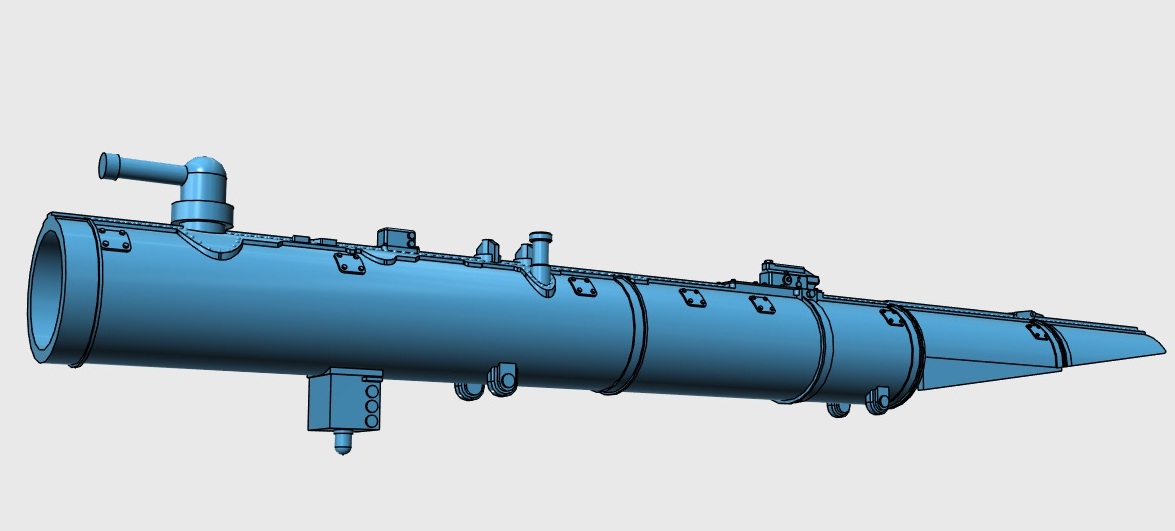

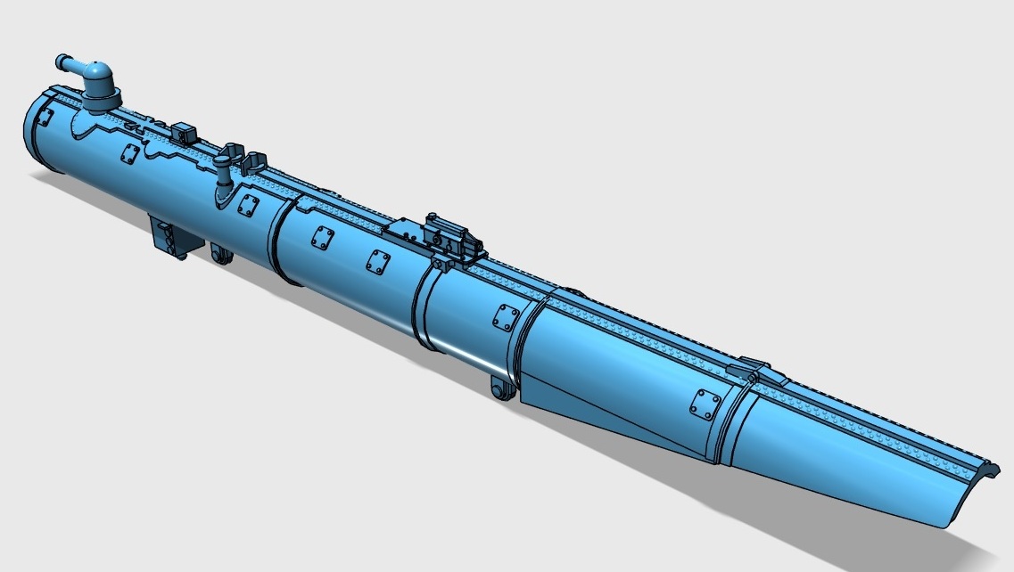

WWII US Navy destroyer fans might like to see what's coming next, highly detailed, perfectly scaled Quintuple Torpedo Mounts.
Here are a couple views of one of the tubes. The design for the whole mount is about 40% complete.

If you do the Quint TTs (and some Quads as well, for the earlier 1,500 tonner DDs), then I will need a LOT of those in 1/700 scale (if they work out in that scale) for my Benson/Gleaves ships (which I have 8 I am doing).

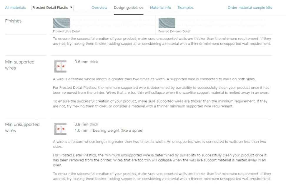

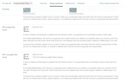

Since several other 3D designers are already producing Oerlikons and Bofors in large scales, I have abandoned those designs - no market.
The torpedo mounts cannot be printed in 1/350 or smaller.
Now having said all that, you both might try contacting Carl Allsop at 3D Modelparts.com. He uses an entirely different technology and may be able to print these items and be willing to design them.
Unfortunately, 3D-printed versions in 1/350 or smaller are unprintable by Shapeways.John W. wrote:...Since you are on the torpedo tube clusters, another DD and DE weapon that I have never seen done well (in 1/350th or smaller) would be a Hedgehog launcher. I have seen representations that look like a box of pipes or sticks. I have seen P/E replacements for the sticks, but they become flat sticks in that representation...
Unfortunately, Shapeways is not able to print Oerlikons or Bofors in 1/350 or smaller. The smallest Shapeways-printable outer diameter of a barrel is 0.6mm, 0.8mm, way overscale.robertmelvin wrote:Steve, any chance that you could produce twin Oerlikons in 1/350? That is one need that as far as I am aware is not being met in anything but PE, and look terribly one two dimensional at their best. I'm sure there would be a demand for these weapons in other scales as well...Bob M.
