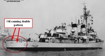

On the other hand, the two pics of USS Ammen are of particular value, as they show clearly what the pattern for the oil canning is in the stern areas, with sections differing in length:
This is backed by one of the few pictures that I had previously found, that shows not only severe oil canning effect, but the very same thing in sections length:
USS Ammen pics also confirms the oil canning pattern of the Fletcher class that can be seen in this pic of Velox showing again severe oil canning effect, along with the absence of it on the 1/2" plates around the machine and boiler rooms --as it has been already discussed in this thread-- and also under the screw defenses.

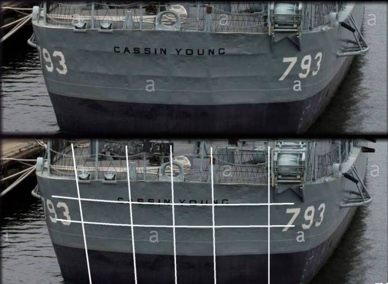

After the study of the Fletcher�s transom using the pictures of USS Cassin Young and USS Ammen, I decided to use this kind of grid, displaying five horizontal sections:
Once this was done, I came across this other picture of Velos, the former USS Charrette. Even if very blurr, it is invaluable to show that the oil canning grid in the stern parts of the ship is way more complicated than I had noticed before. This is what I mean:
This led to a further research, and I found more evidence:
I have to say that I was not sure at all about the vertical thinner section highlighted in the pictures, and supposed at first that it would be an effect of oil canning, but USS Ammen has got it too in the same position, confirmed by other pictures of other ships, and this solves all doubts:
This other picture of good old Velos/USS Charrette shows again that the transition from boards to transom is again more complicated than it seemed at first:
I was really surprised at first of the high freeboard of Velos and USS Cassing Young, until I realized that they are museum ships, with no ammo, fuel or water on board.
With all the info gathered, I think this is what has to be done, the bigger sections being 11.0x4.5 mm. and the smaller ones reduced accordingly. Some of the fore sections will also be doubled:

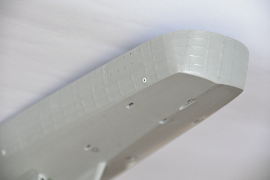

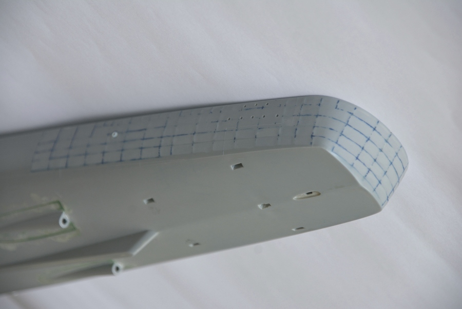

The oil canning of the stern was much more time consuming, and much more complicated to do because of the difficult position in which I had to place my hand, what did not benefit precision either.
This was the first step:
Once the lines were deleted, the thing is lie this:
The transom was even more difficult to do, and some mistakes were unavoidable:
Some of these mistakes are easy to mend, but even with some others here and there, the difference with the original hull is so huge that what has been done can be accepted for the service.
I am not going to do much more in the flat bottom, other than some details in different places --more or less what can be seen on deck in the last picture-- as according to the pictorial evidence, there is virtually no oil canning to do in this area.
I hope you like it, and very best regards from this side,
