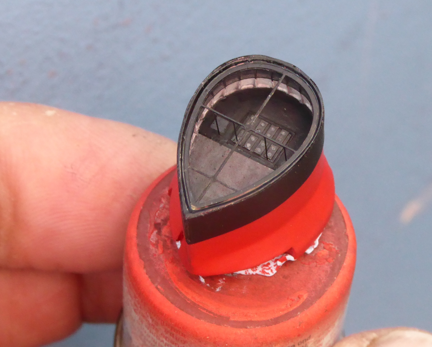

For a bit more gratifying fun, I started work on the funnels again
as they had to be completed sooner or later!
The Funnel tops were a rather nice piece of PE ( from the kit !)
The aft funnel was a dummy--( no smoke uptakes ) used fro ventilation uptakes and exhaust--
as well as dog kennels...
You will have noted that I have not yet fitted the PE top...
that is because it all looked a bit empty....
I reckoned there had to be more--not much though it seems
The plans suggest this rather large array of skylights and a ( access I guess) hatch...
Lets see how this will turn out... as I have to make this
more soon!

so the empty aft funnel bothered me rather--and ever I went and obsessed about it !! :big_grin:
all photos of the aft funnel are ;
either at shallow angles or a long way off or at too oblique an angle
a few of the poor photos from which I sort of garnered the conclusion I reached.
This image " clearly " shows the fwd portion of the aft dummy funnel deck to be a dark colour- probably dark grey/ black
another 'confirmatory' image thereof--
this angled view ( I guess confirm ?!) what on the plans...(?!! ) but darker fwd-
(though the image had been lightened and colourised)
which also shows the need to add the diagonal bracing inside the funnel
so the fwd skylights--based on the plans dimensions
made from generic perforated beam PE I had from another model..)( Northstar )
I used thinned matt varnish on a sliver of black paper to
practise aligning the bits of PE- I had quite a few attempts-- tricky!
Once painted and inside the funnel ( a few short hours later....!!! )
It all started to look a bit better--
interesting to note how different t looks with differing light levels
meanwhile the other two funnels had the small gaps
( in scale --quite huge actually !! )
' twixt uptake and PE filled with white glue
ah well !
more soon
JIM B

Those stacks look georgeous Jim!
I think it adds interest that the aft stack is different from the others. Luckily now it also looks suitably busy.
btw, did you paint the red with an airbrush?
