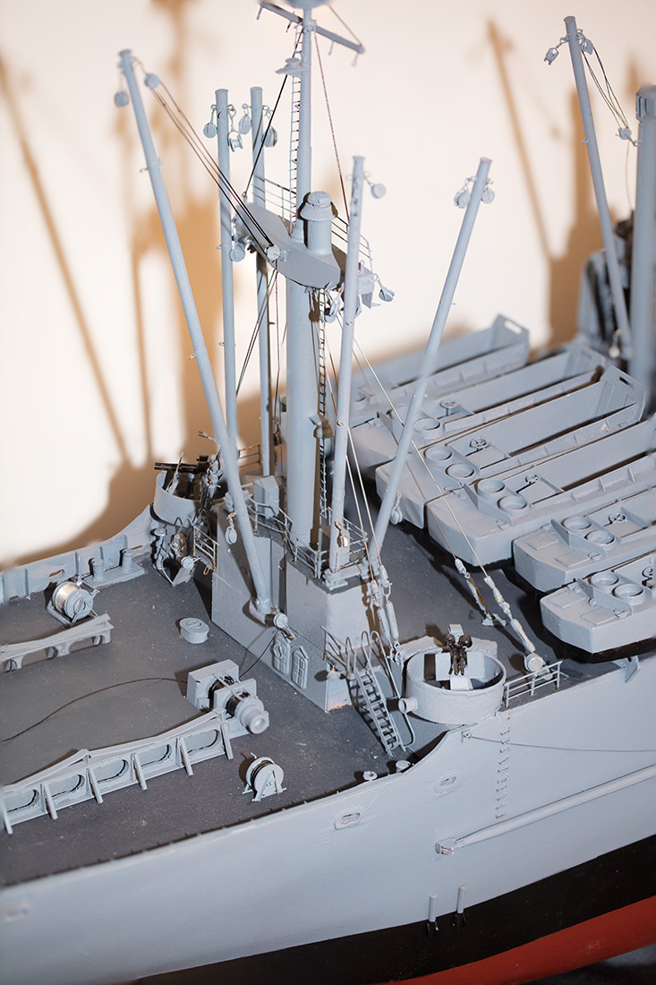

Re: APA project
Posted: Tue Jun 30, 2020 6:37 pm
by Fliger747
Slow progress. Two forward stays added to the Main Mast. Three more to go for each side. Need to make some more turnbuckles, shackles and pad eyes.
Re: APA project
Posted: Mon Jul 06, 2020 8:07 pm
by Fliger747
Beginning to work on the aft mast first with standing and running rigging.
Re: APA project
Posted: Tue Jul 07, 2020 8:10 am
by BB62vet
Tom,
Very nice work, as usual!! Can't wait to see the rigging completed on all these booms!
Re: APA project
Posted: Tue Jul 07, 2020 10:40 am
by Fliger747
Well me too! Rigging is a real PITA, especially booms which in a model don't have enough weight to stretch the rigging out. there has been some step forward and a couple of steps backwards.
Cheers! Tom
