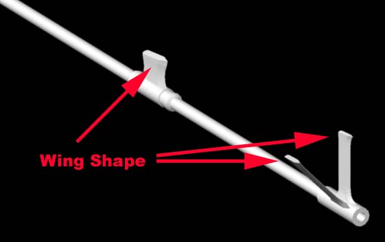

Were the propeller shaft struts tapered on the leading edge (and the trailing edge too) on the Buchanan and less specifically all Gleaves class DD? Just looking at those parts C7 and C8 and seeing the squared off thick strut arm makes me think that in true 1:1 scale that would cause a lot of drag and turbulence. Anyone looked at pictures of DDs in drydock in that area?

Yes they were. The ones in the kit are better than most. A few minutes with a sanding stick and you should be good to go. Here is a link to photo of Kidd's (DD-661) struts - no real difference. http://farm3.static.flickr.com/2345/186 ... bb.jpg?v=0

For what it's worth, the struts were designed from the start to be wing shaped. However they were overly simplified for the molding process. As I look at the way the parts came out I am a little disappointed as I spent a lot of time on that feature.

Those struts look great, even though they didn't make it to production!
