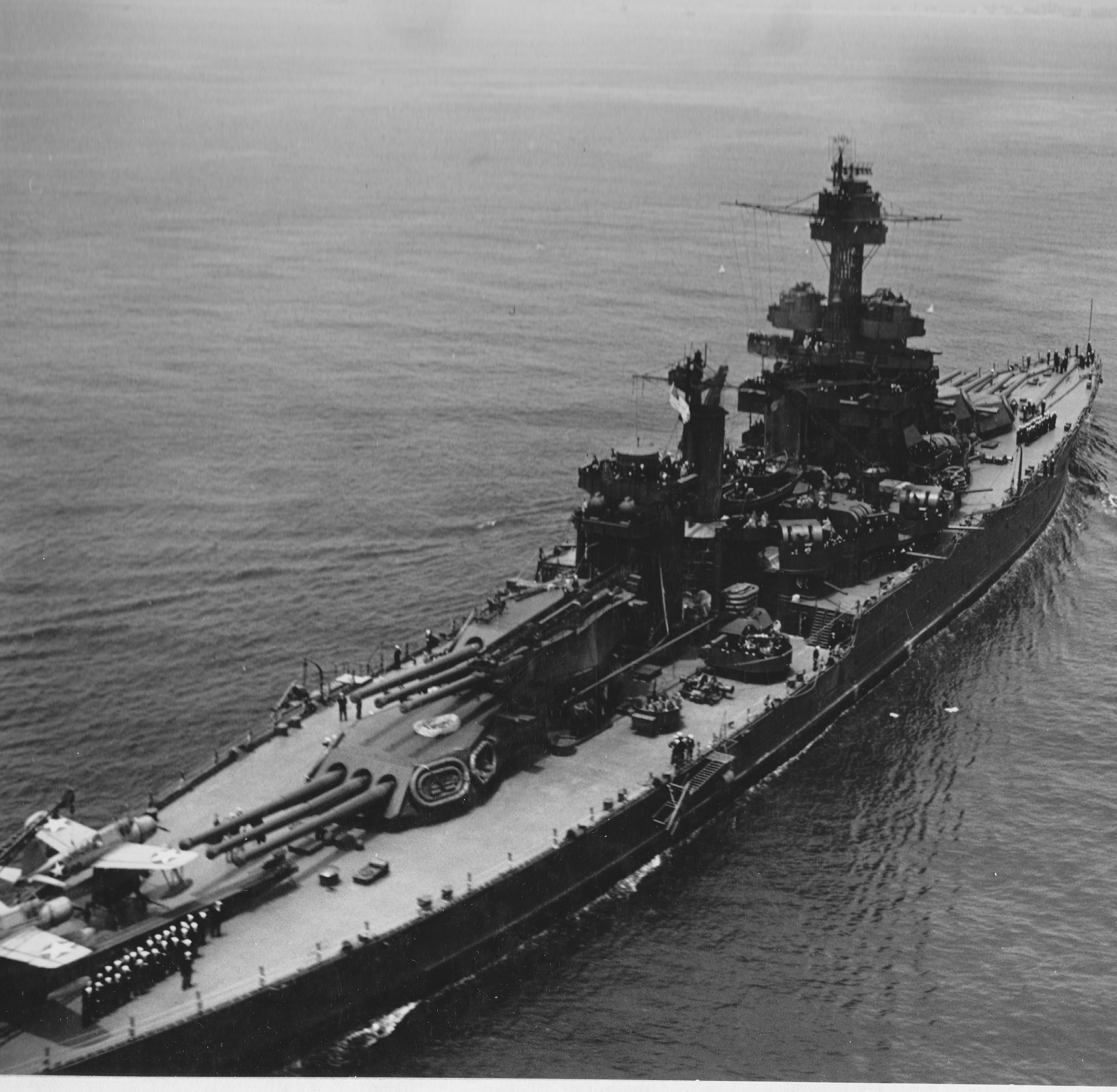

The Tennessee 1941 kit is the best starting point, as it has the correct smooth (that is, not ribbed as on other Big 5 ships) splinter shields for the 5" AA guns and an un-bulged hull. The Pit Road version of the kit lacks the forward superstructure AA tubs; I thought I heard someone mention that the Trumpeter issue might have included an errata for them - can anyone confirm this?
One very notable issue is the aft structure - Tennessee got her mainmast removed completely and replaced with a box structure right away, unlike the stump that was left on Maryland for some time. You'll need to scratchbuild it, grab one from a late-war Colorado kit and modify it as-needed, or talk Model Monkey into 3-D printing one.
Note that they did remove the center anchor, with its scrape plate and capstan. Shaving it off and adding deck planking detail in its place will likely be difficult. (On my already-build Dec. '41 Maryland, I hadn't known about that piece of information or I would have made the alteration to the kit part. Though I now know it's inaccurate, I really don't want to try this surgery on a finished, and otherwise rather good-looking model.)
A couple good photos for your target time period:
http://navsource.org/archives/01/043/014312.jpg
http://www.navsource.org/archives/01/014308.jpg
- Sean F.

SeanF
Posts: 795
Location: Downey, California
Re: Calling all rebuilt "Big 5" (TN/MD class) fans
Post by SeanF »
No on the Pennsylvania (and '44 Colorado) aft structure.
Tennessee's is much simpler in shape. This photo has bad glare, but is probably the best illustration of it:
http://navsource.org/archives/01/043/014311.jpg
See also this side view:
http://www.navsource.org/archives/01/014376.jpg
Now, Pennsylvania's is more involved. It still looks like they recycled part of the original top, but it's much more complex and the parts fromt he original top have a decided overhang toward the front of the ship. See:
http://navsource.org/archives/01/038/013805d.jpg
The 1:700 Dragon kit parts are simplified from this, but are still far from the correct shape. See the ModelWarships review at:
http://www.modelwarships.com/reviews/sh ... eview.html
Note the parts on sprue A and step 5 in the instructions.
The Colorado kit's aft tower is better detailed and not as clunky as the Dragon Penn., but is essentially similar in its overall concept and not even close to Tenn.
Honestly, I think that making it yourself is actually quite simple - much simpler than trying to re-shape the other kits' parts. Take the top two levels (including the MG platform) from the mainmast top and scratchbuild an octagonal, slab-sided tower symmetrically under it, and add a rounded-corner, rectangular searchlight platform fore and aft. You might even be able to do it by buying a thick rectangular piece of Evergreen plastic with the right length and width, sand the corners to the correct facets, cut to height, and make yourself a solid plastic tower.
In fact, this thing has such a simple shape you just might be able to talk ModelMonkey into wedging this into his design schedule. 3D print just the tower and searchlight platforms, and use the kit's top for the rest.
- Sean F.
