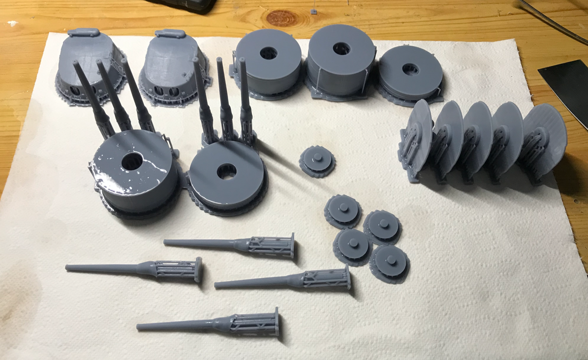

Printed and glued section 3 a few days ago, then sanded the joints until I couldn't feel anything with my fingertips at the glued sections.
Printing of the last section N�4. It fits perfectly, it's not glued yet, I have some cleaning to do before and I have to put the Rhodoid of the portholes inside, because it won't be accessible once glued.
I've opened the deck at the level of the gun barbettes to be able to glue the rear 140 mm guns in casemate, not easy but it's ok. �

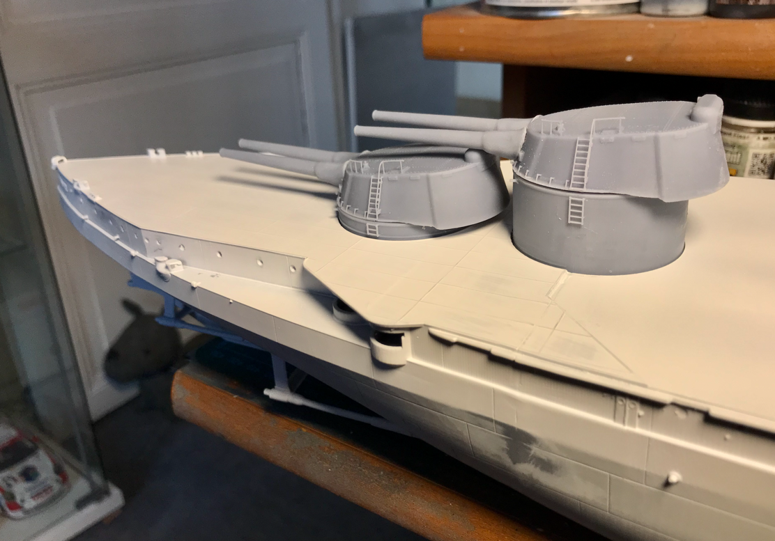

Section 4 was very easy to assemble and glue, little sanding.
It's starting to take a turn in this case...
The hull weighs 663 grams for the moment. A weight roughly equivalent to what would be its weight in injected plastic.
But much more rigid because of its design and material.

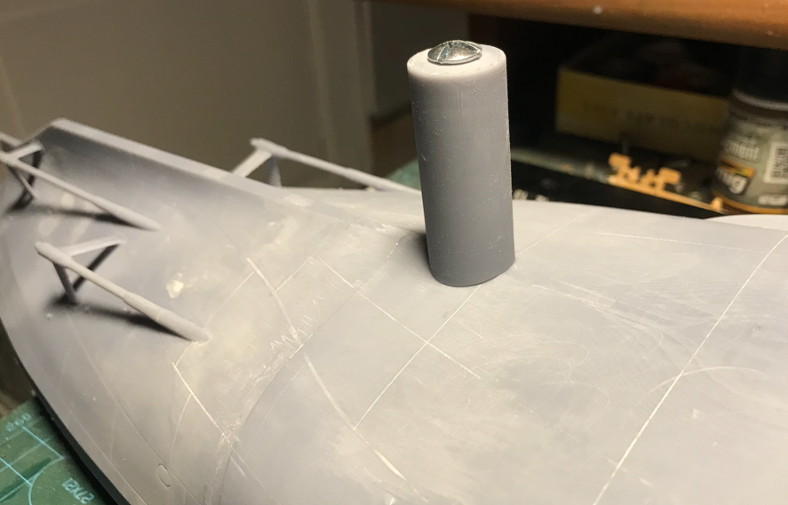

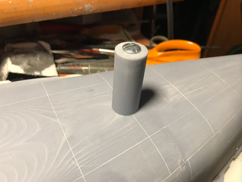

Printing the 2 pillars of the base in the same style as my Bismarck at 1/200. The advantage of 3D is that it fits perfectly the hull.
viewtopic.php?f=59&t=314096
The resin is easily scratched, but this is very superficial in fact, once painted it is not visible.
You can see the links of the sections that have been sanded. I still have to apply a primer to check if everything is perfect. At this level some of the sheet metal lines have been re-engraved with Trumpeter's "engraver" which is usually used for my model aircraft. I will also use it to clean the sheet metal lines loaded with sanding dust.
I didn't do any embedding on this deck. I only made 2 holes for the 140mm barrels at the front to do a test.
With resin I'm a bit wary of precision. You always have to "play" a little. For deck 2, there are some recesses planned, I'll see what it gives visually, I'll decide if I should leave them or not. Deck 2 is easier to reprint than a hull or a section of hull.
As for the linoleum plates, you can see them perfectly without seeing them too much either, just fine, as I like, it's discreet.
Here there is just a micro-coat of spray primer to see what it does to the moir� surface of the deck. I want to know if I need to sand to 1000 again. I have a second coat to put on to see if it covers well, by finger, by not feeling anything..

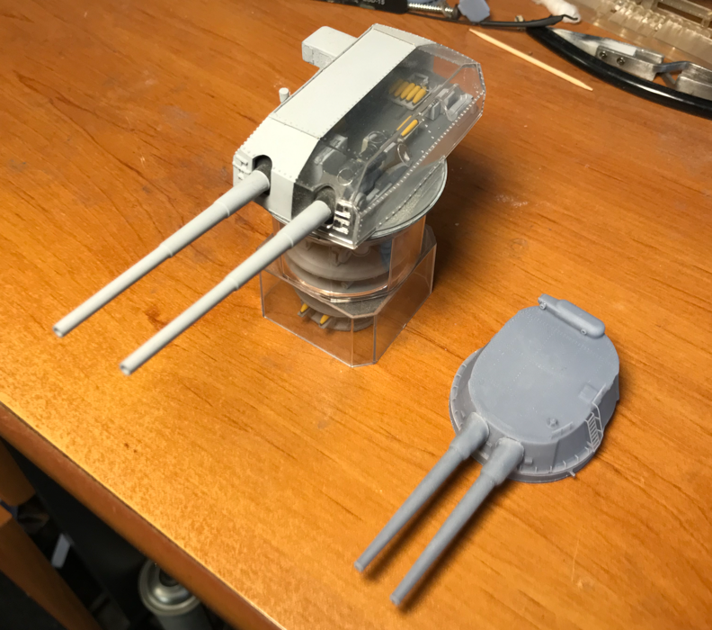

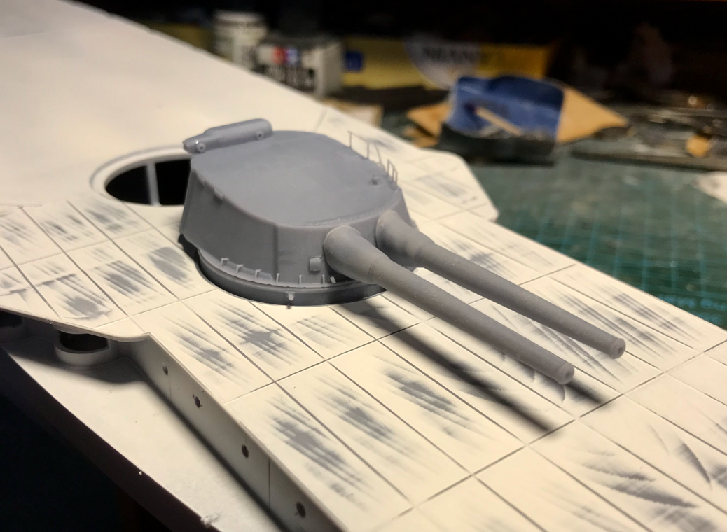

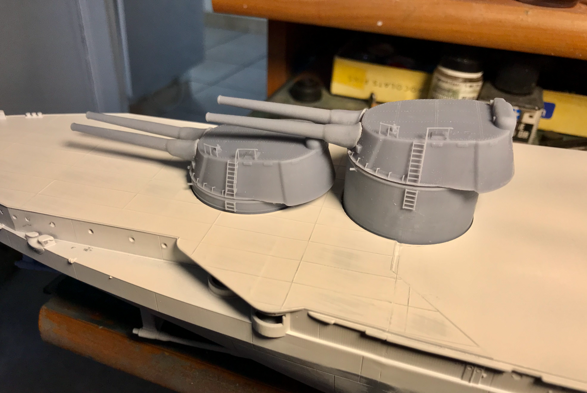

Printing of a 340 mm prototype turret, there is not much to review, it is rather good. The assembly is well done respecting the tolerances of the resin 0.3 mm.
The printing is very fine thanks to the Photon Ultra, especially the padding and riveting.
I printed with 30 micron layers, but I'll test again at 20 microns.
I chipped the sealing skirt a bit when I was removing the paint, it's very thin there. No problem, it's a test. Otherwise it runs well with the system.
I've primed the hull, and sanding and repairing the little dings is in progress.

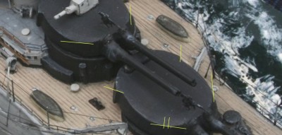

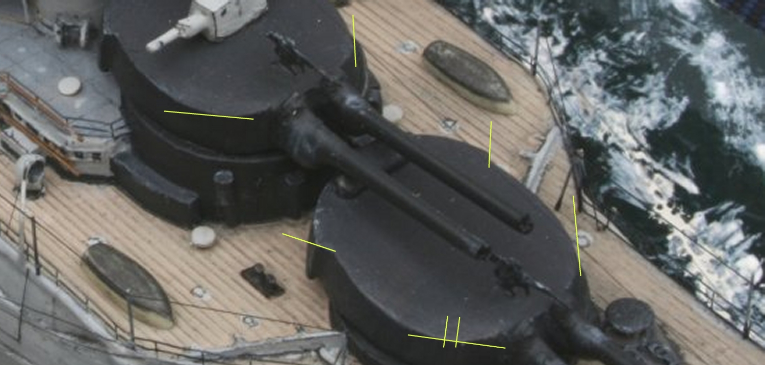

questions ;-- I note that on many images of the black turret era ( my favourite!! )
( I am paying attention !! ) and in the photos
the ' black' is certainly lighter than one thinks
But there is a lighter stripe section- seems--painted -
I have never noticed this before .
was that a fleet identifier ? -or another purpose?
this is one of your images from BM

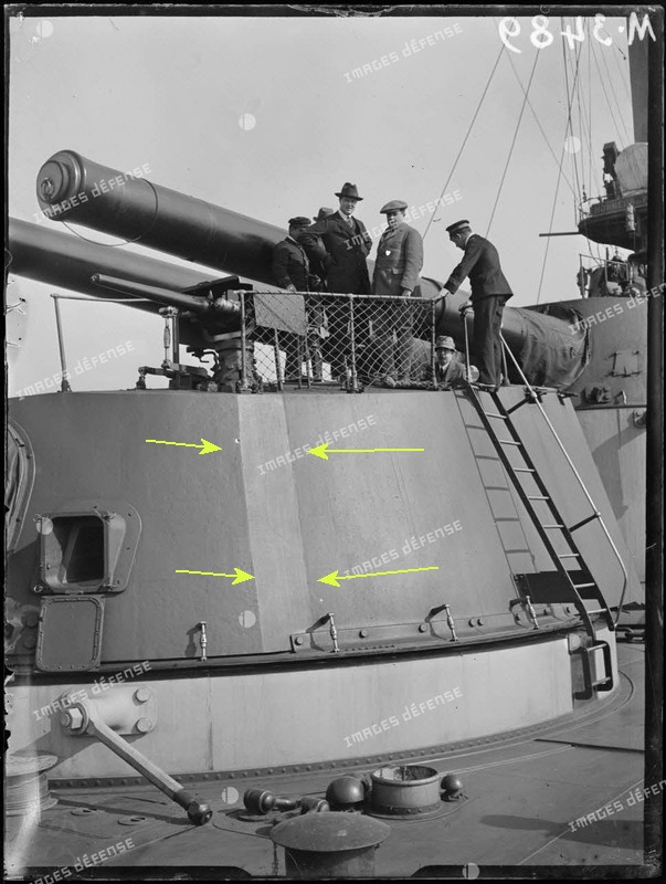

@Jim; These lighter lines come from the rather complicated shape of the turret, there are 4 facets on each. The light reflects differently.
Like what we can be misled sometimes by the interpretation of a photo. :cool_2:
The black dye would not last long, like a polished shoe. The bare and grey steel was to reappear as time went by.

had I looked PROPERLY--at the the images of your printed turrets... (!) I would have seen that...( I like to think..!! )
I must say-in defence of my non-observant self...!
that in the photo it did look like a stripe--and you are right-it is sooooo easy to misinterpret BW photos
That will teach me I hope ... :scratch: :scratch:

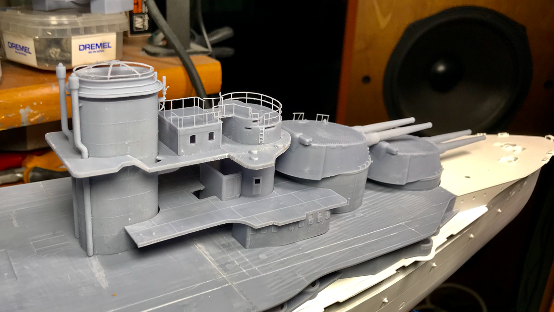

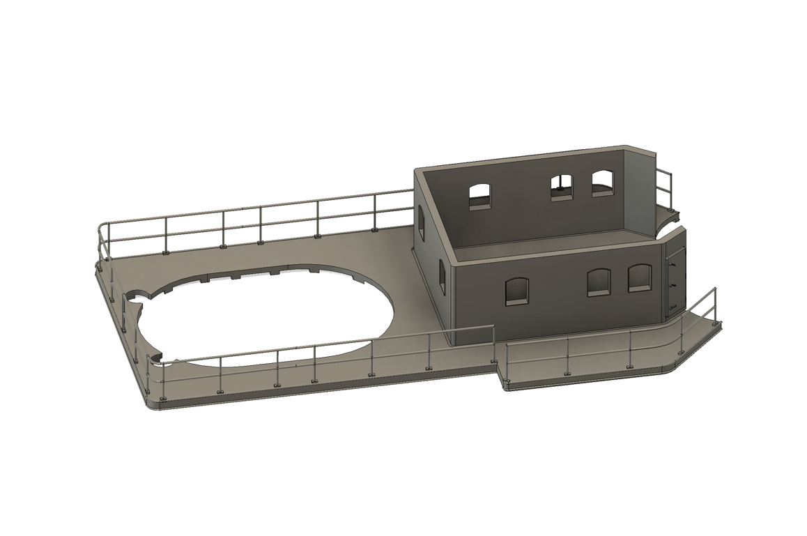

Printing of the bridge deck ( Deck 5 ), chart room, bridge "blockhouse". Nothing is glued and not really cleaned of course.
I decided to print the railings, it's not bad at all.
Deck 4 of the superstructures with its railings is being printed.
The other railings will be printed separately, too complex in terms of media to print in one block.
The different elements and the way they are divided to be printed easily. It works well.
