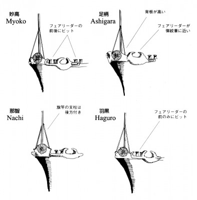

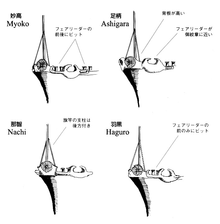

ok back to myoko, Got my ashigara last week, doing it side by side with my Myoko, but im doing the earlier configuration. The thing im wondering, is how close were the hulls on these two ships. It seems like other than the extra parts for the taller mast for Ashigara, that all of the rest of the parts are identical. All I have for reference is the shipcraft book, and the little osprey IJN heavy crusiers vook.
- Posts: 9093
Re: Calling all IJN Myoko Class Fans!
Well, for starters, the main turrets differ slightly between sisters. See p.6 of this thread........
- Posts: 9093
Speaking strictly about the hull, the lower row of scuttles extended further forward towards the bow in Myoko and Ashigara than Nachi and Haguro. Just forward of the breakwater in the first pair vs. even with the end of the muzzles in turret #1 in the latter pair.
Plus this...
Plus this...

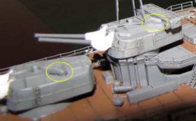

I have the Aoshima 1/350 Nachi in my stash and would like to inquire if there are any errors in this kit that need correction.
On page 8, it has been mentioned that the range finder of turret #1 should be cut down to remove the overhang and that the exercise aiming devices from all the turret tops must be removed.
Aside from these two errors, are there any other issues that I should address?
Thanks very much in advance.

Besides those, no. But maybe you will find that some heavy AA or light AA might look inaccurate or a bit off scale, but that's small details. Aoshima kit in 1/350 is a nice kit.rdsaplala wrote:Hi guys,
On the exercise aiming device, ALL model manufactures ignore this feature, all Imperial Japanese Heavy Cruiser's exercise aiming device where removed by 1943(only IJN Mogami class never had on her 20 cm main turrets, only the 15,5 cm version of IJN Mogami class had exercise aiming device).

Very interesting picture Dan, good for those who want to super detail the IJN Myoko class.Dan K wrote:Speaking strictly about the hull, the lower row of scuttles extended further forward towards the bow in Myoko and Ashigara than Nachi and Haguro. Just forward of the breakwater in the first pair vs. even with the end of the muzzles in turret #1 in the latter pair.
Plus this...

Cool! Thanks very much AtmaAtma wrote:Besides those, no. But maybe you will find that some heavy AA or light AA might look inaccurate or a bit off scale, but that's small details. Aoshima kit in 1/350 is a nice kit.rdsaplala wrote:Hi guys,
Just a follow up question: Are these the exercise aiming devices you that you mentioned?
-Aldo
