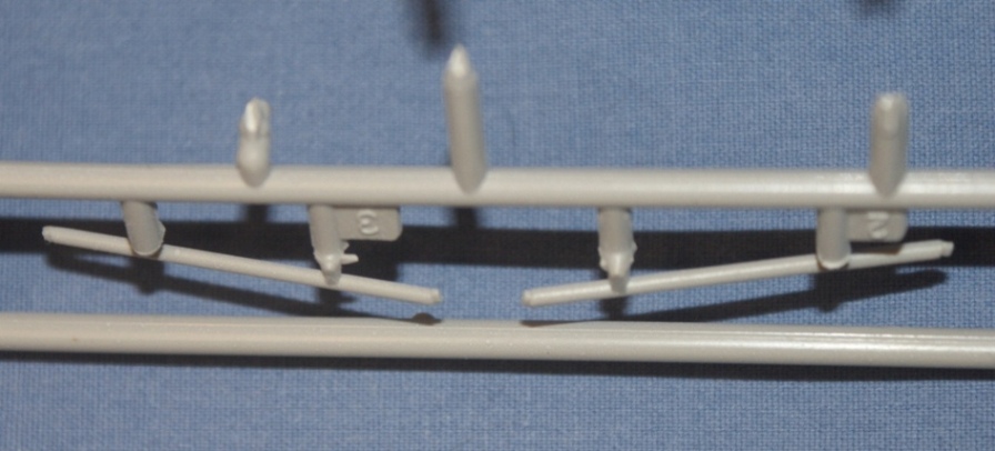

Mast Question...
Hey All,
I'm thinking ahead a bit but I've been giving a little more thought to the main mast. Since I am doing rigging and putting signal flags on the halyards, I know I need to beef up the mast, so I was thinking I would replace the main mast with some 0.062" music wire that I have.
My question is, do you think that I need to replace the two side support masts as well?
It seems to me that all the force is on the main mast and the music wire is pretty stout stuff, so I don't think it will flex fom the force of the rigging and flags, but I'm not certain. The reason I ask is that if I need to do the side ones too, it seems that it would greatly complicate the assembly due to the difficulty I think I would have in getting the angles, lengths and alignment spot on.
Any and all comments will be appreciated!

Seen allot of guys use brass rod.Rdutnell wrote:Mast Question...
Hey All,

Re: Calling all WWII Essex Class Carrier Fans!
Thanks Dennis,
I saw brass rod when I got the music wire. It was abot 3 times as expensive, which is why I ended up with the music wire. It should work, I just don't know if I need to do all 3 supports or just the main one. And although I didn't ask in the post, I also wonder about the yard arms. I'm sure that they will need beefing up some.

DennisJP
Yes, I understand you. Well, want to use something that looks in scale but does not droop and that all depends on the scale your building and the amount of detail you want. How about plastic rod from Evergreen? If you use to much metal then it might be a maintenance problem latter. I have never used it so don't know if it would rust on you.
Yeah, I don't know either. I don't think rust will be an issue, as it will be painted and covered with a dull coat. Then it will be enclosed in a glass case. But, I have NO experience with longevity of models, my oldest one still being less than a year old, and I have read about issues like railing and other PE popping off if CA was used to attach it, yellowing of various finishes over time, and deformation of masts from the attached rigging. Because I have no experience I have been asking a lot of questions on this forum (as you know if you follow it) to try to keep from doing something I will regret sooner or later. I don't always get a response, and some times I get conflicting advice, but most often I get the answer to my question.
As for the rigging issue, I rigged the only 2 ships I've ever built using the kit masts and nylon sewing thread (which I would not use again) with out any problems, at least not so far. But adding the flags, even though light in weight, is a considerable increase in weight percentage wise. And again, since I have only very limited experience it only seems wise to ask those who do.
Another question I haven't addressed yet is the solderabilty of the music wire. It seems like you should be able to solder it, but I haven't actually tried yet. Of course, this only matters if I need to do the side support masts in something stouter than plastic, and if it isn't solderable (I think I'm making up words all over the place), I could always use CA glue, but from what I have read, soldering is preferable and longer lasting.
Anyway, I appreciate the comments.

I'll try this again,
I would go with metal for the mast.
Your yard arm is on your PE fret in three pieces, The center piece has all the antenna and "pulleys" for the signal halyards. You laminate this with the two slim pieces, one on each side of the center piece. This could be done with either CA or soldering paste. Instructions on how the solder method works is on the Alliance Model works site. Being laminated, you should have good vertical strength and a little less fore and aft.
Now for the rear supports, you could go either way. In metal this would be achieved by measuring the distance between the feet of the supports as they will sit on the model. Making the legs the same length as the plastic kit pieces. lay the metal legs on your soldering surface with the bottom ends held the measured distance apart, while bringing the upper ends together and soldering.
Radar platform above the yard arm could also be metal, sheet brass. Use the plastic piece as a template for size and shape and then cut it out.
The PE yardarm should then be soldered to the mast, but I don't know if a bi-metal joint would have a corrosive effect. I know copper and steel/iron do not play well together, but I don't know about music wire and brass.
Don't know whhat you'll use for rigging. Caenis thread is most true to scale for both signal halyards and the long wire radio antennas. I would attach the halyards to the yard arm before mounting (stepping) the mast on the model, leaving the lower ends loose. Then, after the mast structure and all PE under it are in place, attach the loose ends to the flag bags.
You Rock Russ!
You hit every question I had, even ones I don't think I asked yet.
As for metal for the mast, everything I read suggests it if you are going to do rigging, so I think you are right. I also think to avoid the potential for bi-metal corrosion, I think I will switch to the brass. The problem with both the music wire and the brass rods is that they come in packs of four that are 3 feet long, so I have to pay for 12 feet of the %%^&%$
when I don't even need 12". If I built 3 models a year for the rest of my life, there would still be some left over.
The method you describe is pretty much as Griffith described and what I was thinking, but my concerns are 1) getting accurate enough measurements of the spacing, because I would think that at this small scale, a small error would show up dramatically and 2) soldering the pieces together so it looks decent. I think if I could get an accurate measurement I could get a jig to hold them the right distance apart while I solder them, and I guess I will have plenty of rod to experiment with.
I was thinking the same as you described for the yardarms as far as the strength provided by laminating, which I think I will just do with CA.
I also like your idea of attaching the halyards to the yardarm first. A while back capt652 recommended that I layout the halyard horizontally and then attach the flags in the layout and spacing I want and this would be followed by doing as you say and attaching the completed halyards to the yardarm.
All of this answers the question I haven't asked yet, that being whether or not to completely build the mast with all of the radar before attaching it to the island. I've seen people do it this way and my main concern is not screwing it up when I am handling it to attach it. I have the same concern for the island, which following more advice from russ652, I have mounted to a piece of wood. I didn't however do as he suggested and screw it in, I tacked it with glue and will have to remove it, and then attach it, and the prospect of handling all of that delicate PE that I will have applied with much effort is pretty intimidating. But then, so is the alternative, so i think this is the way I will do it, or at least I'll get the brass and try it. Now I have 3 models to work on the ship, the island and the mast.
THANKS RUSS!!!
THANKS RUSS!!!

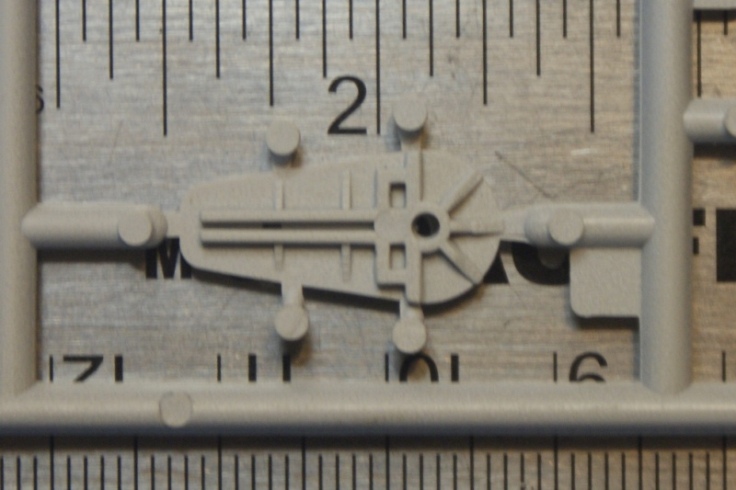

Oops!
The last post I said, "... I have the same concern for the island, which following more advice from russ652, I have mounted to a piece of wood." It should have been capt652 instead of russ652. Sorry Timm, and thanks again for the advice.
On this same note, I went to the hobby store and swapped out the music wire for brass, and actually came out ahead. Since I only got one size, I got almost $2 back, and the brass comes in a clear plastic �� tube that may also serve as scratch build material at some point in the future.
So, this morning I decided to start making my mast, and immediately remembered why I was considering using the plastic for the aft/side support masts. Here are pictures of the island, aft/side masts, and radar platform, respectively. The center mast is no problem, because the attachment points are simply round holes that the rod slips right in, with a little urging. The aft/side mounts however aren�t so simple. The attachment points on the radar platform are rectangular and oddly shaped, not quite rectangular, and not quite oval on the island. The masts have similar shapes cut at angles to the axis of the mast.
So, to get the rods to fit, even if I have the bases measured and set at the correct positions, it seems that I have two choices. I can either try to shape the ends of the rods correctly, or drill out the island and platform. Neither of these is particularly appealing. Shaping the mast ends is safer but seems like it would be more difficult. Of course, I have plenty of rod, so I could either use trial and error or build like 4 or 5 of them and pick the best one. Drilling would be easier, but there is a greater risk of screwing something up.
Any thoughts?
Any thoughts?

Brass is so much more rigid than plastic that I bet you'd be fine just with the center being brass and retaining the plastic angled ones. If something happens to apply enough force that you need the side ones to be stronger you're probably going to have major damage anyway.....
Russ2146
- Posts: 2126
Ok, given the configuration of the radar platform, I would go with the kit legs. However, I would still go with the brass mast, measuring carefully to make it long enough, mark where the mast disappears into the platform hole, and then solder your PE yardarm onto the mast at and below the mark. you might want to flatten the mast at the attachment point a little bit with a needle file, as it provides a greater contact area and if you're not soldering, more surface for CA.
After the yardarm is attached, you can attach the radar platform, then the halyards,and finally the legs.

IKES! Sulphuric and hydrochloric acid? You are right Russ, corrosive is an understatement. I'll bet that duty wasn't a favored one. Good stuff!
Yeah! You guys gave me the news I was hoping to hear. I think I can pull off the brass center pole, but I was concerned that my modeling skills weren't good enough to do the whole thing in brass.

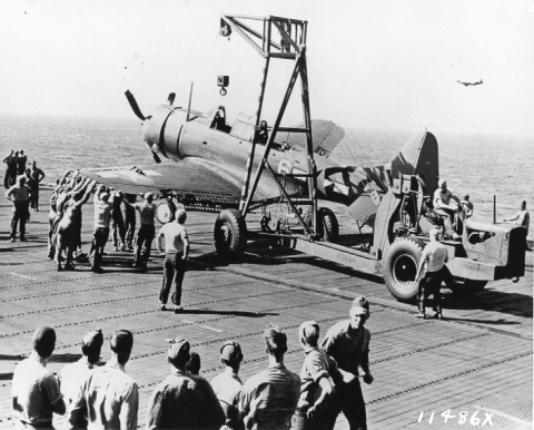

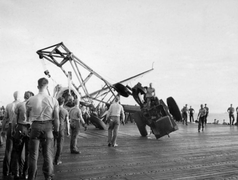

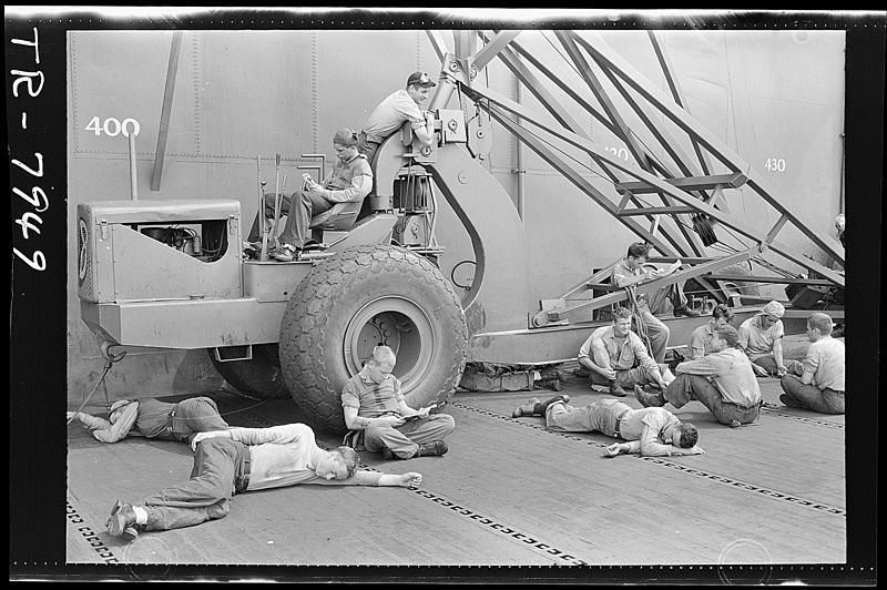

I ran across this photo while searching something for Carl M.
This is the LeTourneau crash crane. I found the picture on the website of LeTourneau University Museaum, which is in Texas.
The caption for the photo says: "All U.S. aircraft carriers were equipped with LeTourneau crash cranes."
With that lead, searching LeTourneau crash crane yielded:
OOOOOOPS, Shoulda kept it perpendicular to the load!!!
