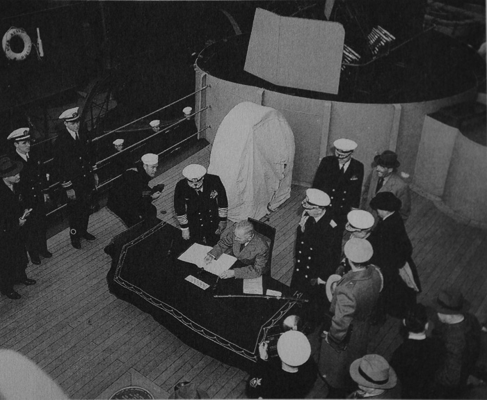

As you can see the cupola reaches the deck! On Missouri the Tubs were removed prior to Jan 1 1945 and probably just after shakedown, though possibly in either in San Francisco or Pearl Harbor in late 1944. The bottles on the bulkhead apparently persisted through July 1945.

This is a great photo - where do you find these? I spend an inordinate amount of time - time which I would much rather spend creating actual models - on thinking up ways to search, then combing thru the results for usable data (I suspect all of us fall into this trap), and I have never seen this photo.
Posts: 5068
Re: Calling all USS Iowa class fans
Post by Fliger747 »
Photo was out of a Stillwell Mo Book. Many of the more interesting photos are in these books. One just has to plow through them, though a memory sometimes leads one to the right book.
Cheers. Tom

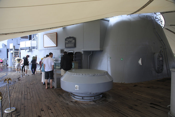

Nice work! A couple of observations. The acetaline tanks sit on a rack, roughly a foot off the deck. Not sure about the ladder you have coming up from the main deck aft of the vent. The forward ladders from the main deck to the 01 level are all exterior to the superstructure. The one in your isometric appears to come up from the interior of the main deck structure.
Bill
Posts: 5068
Post by Fliger747 »
There is indeed a hatchway on the "surrender deck" though the coming must be something like 10-12" high and all the way around. The ladder comes off passage A103L stbd side just fwd of the wardroom and inboard of the exec officers office. The hatch below on the main deck has a quick acting scuttle, the one on the main deck did not. The ladder rails do not protrude through the hatches though I am looking for a photo of the exact arrangement.
Posts: 5068
Post by Fliger747 »
Currently on BB63 this hatch has been boxed over and a display case installed above. Probably so some turon won't trip and do a nose dive over it.
T
