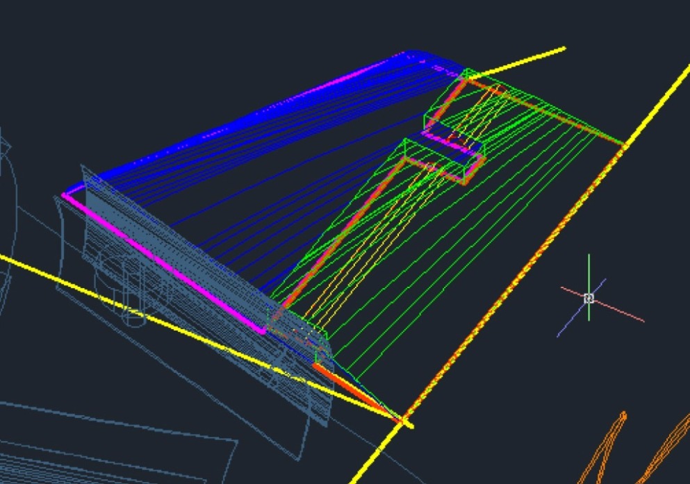

I decided to show the steps it takes to rebuild the diving plane and stern assembly in AutoCad, for those of you who may be interested. So, here goes�
First, I copied the 2-D work to the file I�m doing the 3-D model on. I could have done it on the 2-D file I was using, but I prefer to keep separate files for my 2-D work and 3-D work. The drawing is now a 2-D drawing on the x-y plane.
Now, I go to an isometric view to better see what�s going on.
Although the plane will eventually be two pieces, I start by building it as one piece, so I have to create single polylines out of each of the cross-sections.
Now the cross sections have to be rotated to be perpendicular to the longitudinal axis. I do this by rotating them 90 degrees around the x-axis.
I create a solid by using the �Loft� command between the 3 cross-sections. In 3D wire-frame visual style it looks like this:
In 3D realistic visual style it looks like this:
Note that most of the lines disappeared because they are hidden by the �solid�. Next we have to slice it to shape.
So the diving plane is now the correct size, and only needs to be separated into the two pieces, but not in this post.

At this point I move the piece t o where it is supposed to be and double check that the alignment is good on all 3 planes.
Looking at it in wire frame, you can see that the match with the plans is much better.
Next I slice it along the center following the plan to allow for the aft part to rotate. I changed the color of the back part to green to better distinguish them.
Next is drilling the holes for the shaft. Since I know everything is lined up on the other side I drilled the shaft by tracing the end circle on the existing part and extruded it.
This extruded tube is then subtracted from the rear section.
I want the planes to be able to move, so the holes on the forward part have to be larger so that the shaft can spin freely. The same procedure is repeated using the larger diameter holes, and the extra drawing lines are removed.
The next thing is to round off the studs on the forward piece and the front of the aft piece. It is way more complicated than I remember it so I�ll spare the details. The good news is that I finally finished it and was able to attach it to the hull that I had already started adding detail to.

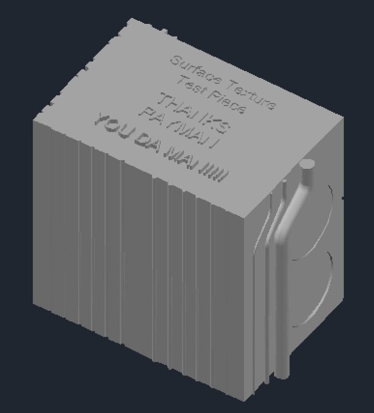

Anyway, Christmas came early guys! The test pieces we made arrived and it is so cool holding a part like that, that you made. I liked the pictures my buddy had previously sent, but being able to hold it and turn it around and look at it from different angles, like I did the AutoCad model was really cool and kind of like d�j� vu. It seemed like I had seen it before. :smallsmile:
It arrived when I was eating and when I finished eating I asked my wife if she had a paper clip handy. Well, there are all sorts of paper clips of various sizes, but as fortune has it the one she had was a perfect fit for the shafts. It went in the holes with a snug fit, which is perfect, they will be able to rotate, but not freely. This is encouraging!

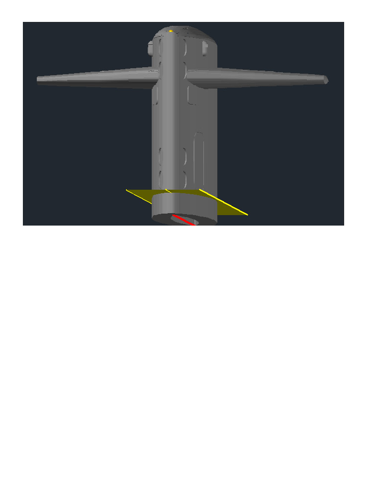

I have made pretty good progress on detailing the sail and thought I would share.
Technically, I didn�t start with the sail as I realized that I hadn�t scribed the anti-skid outline, so I did that first.
I don�t even have plans for the sail, so obviously I have no details on where the anti-skid outline should be, so I just made it up using Thresher/Permit plans as a basis for the scribe locations. I just increased my part numbers by one, because the left and right planes are no longer mirror images, so instead of using one file to print two parts I need separate files for each part.
After completing the planes and saving them, I started detailing the sail itself. I�ve already scribed more access covers than I did on the rest of the ship (8). I also put an access door on the port side, port and starboard navigation lights and the identification light. These items may be clearly seen in the first two images, showing the front and port sides, respectively.
The yellow surface and line at the bottom is where the top of the hull will be.
As you may know, I have decided to try to put LED chips in for the lights. The green �light� above is just a cut out. The green is the 0.1� thick divider I put down the middle of the sail to split it so that the lights don�t bleed over where they are not wanted. This divider may be seen in the image below. Also observable in the image is the hole for the amber signal light.
In the next image, showing the starboard side, the �light� is red because I changed the color of the divider before snapping the image.
The last 2 images show the amber light. I have given a lot of thought on how to do the lights, because even the LED chips, which are as small as it gets, require a 0.063� clearance. This is too big for the lights at this scale, however, from my experience the lights are super bright and it seems to me that they don�t have to actually protrude from the surface to emit light. If I get them close, I think they will still put out a bright enough light.
In the second image of the identification beacon, you can see that the light is separate from the rest of the part. What you can�t see is that the larger 0.063� hole stops 0.02� below the surface. The OD of the gray part of the �light� is 0.03� and goes to about 0.015� below the surface. The ID, and the diameter of the yellow part of the �light� is 0.024� and this hole goes all the way through the hull.
Here is where a big unknown comes in, the clear plastic that the parts will be. It occurs to me that this can be a good thing or a bad thing. The potential bad thing is that the clear plastic will allow light through, even if painted. The good thing though is that I may be able to put this to my advantage. Since the plastic is clear, I could either make the light a part of the hull and mask it off when I paint it, or have it be a separate part and paint just the base, and leave the yellow part clear. Another thought that I had if light is an issue, is to fill the inside up with black paint, or even dunk the whole part. I guess I have a long time to think about it since the parts are even made yet.
