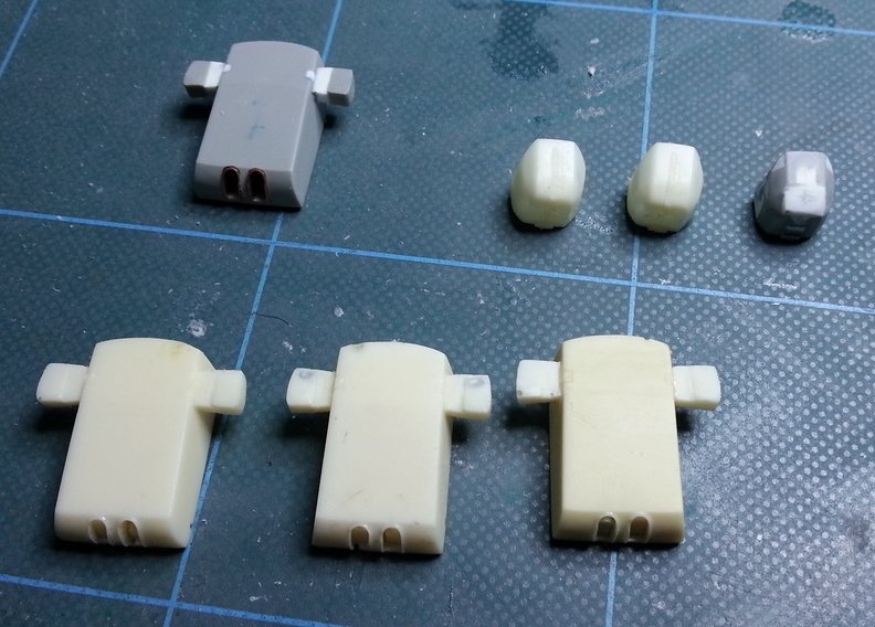

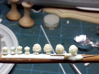

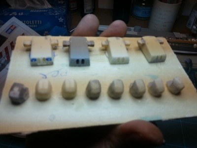

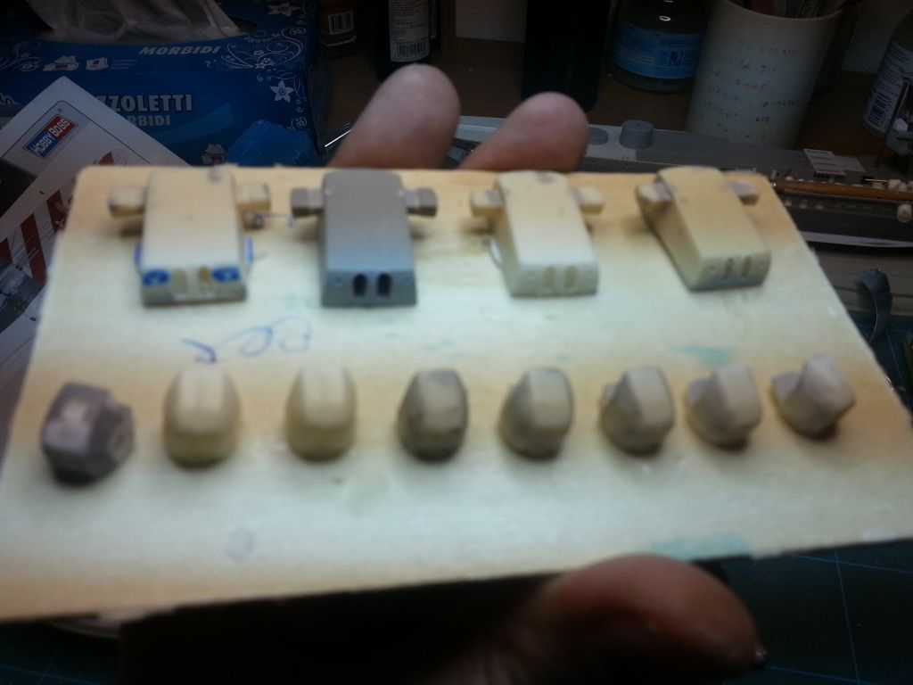

New creepy slow update.
I'm Casting the damn turret one by one: it took three mould to get a decent usable one and I get on average one right every two casting. It takes about an hour to get this horrible stuff fully polymerized inside the mould so that I can check out if it's OK and there is a lot of secondary turret shield to cast (8 in total).
BTW I really hate casting resin stuff because it's dirty and slow. I hope to finish with this phase asap and go on with the actual model.
Here is a pic of some of the stuff I'm casting.
Some of the main turrets and a couple of secondary shields with the masters

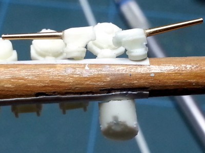

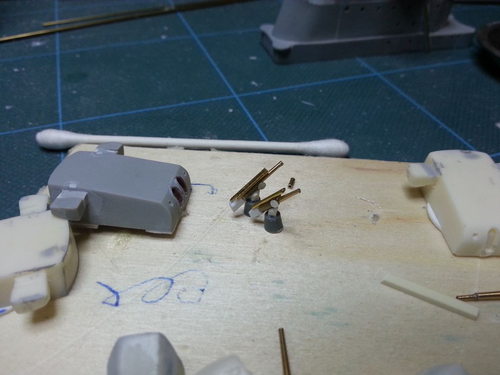

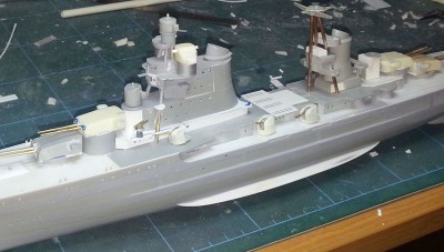

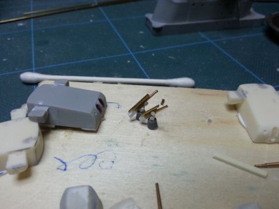

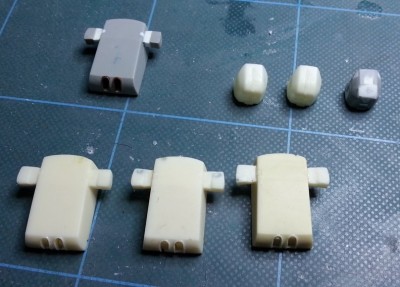

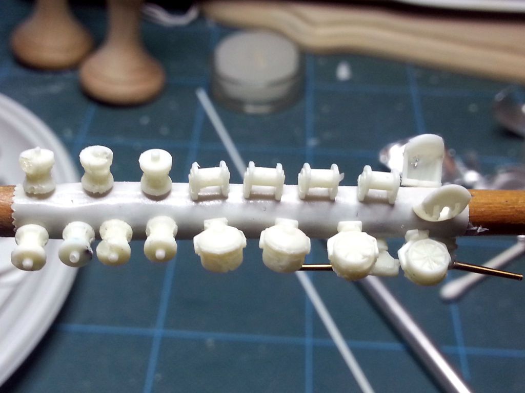

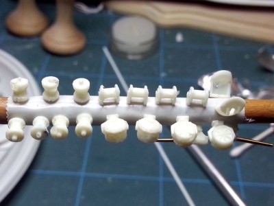

I finally managed to cast all the small stuff I need (so far) in resin: Main gun turret and secondary gun shields were modified form the original stuff in the kit, with almost every aspect of them reshaped. The small stuff like the winches the spotlights and the absent 120/40 guns were cast using the equivalent present in the Trumpeter RM Roma 1/350 kit. The actual gun, other then the gun mount was taken cutting out the forward part of two brass 155mm gun I had in spare.
In the meanwhile between casting and hardening for the resin, I modelled some detail in plastic like several hatches on the main deck and like the protruding trees around the main bridgewhich will be assembled later on for fear of breaking them while handling the ship.
Spotlights and winches
Other winches with the two 120/40 gunshields

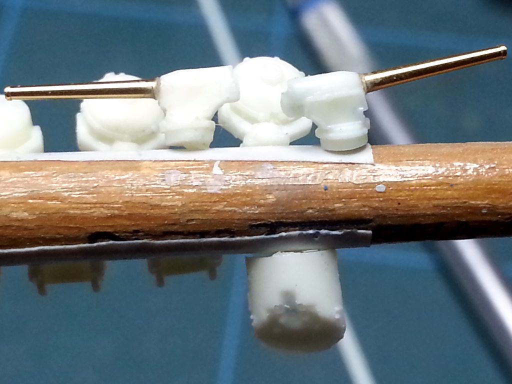

120/40 flare guns
120/40 flare guns

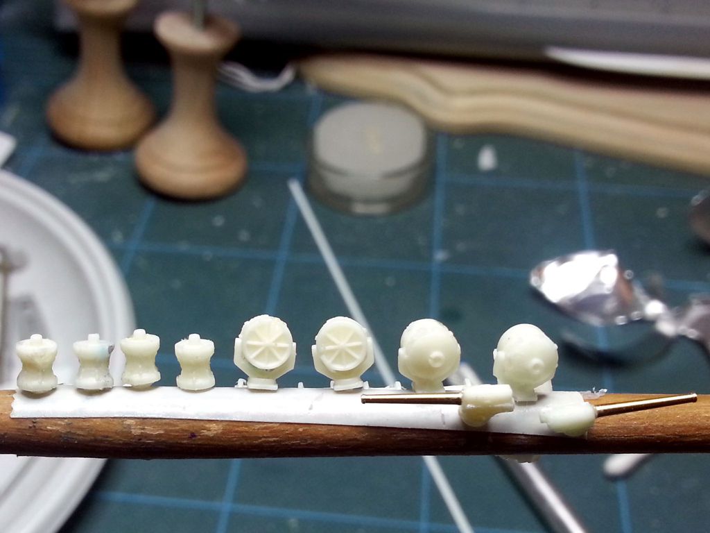

Gun turret and shields

Stop! Zara class cruisers didn't have the converted 120/40 gun for starshells, this was a solution unique to the Vittorio Veneto class.
Pola had the purpose-built 120/17 howitzer, called "Obice da 120/17 per granate illuminanti", a completely different gun

You are probably be right: from the photos I have it's somehow different form the 120/40 on the Vittorio Veneto, albeit the gun itself looks a bit more slender then the 120/17. Something that puzzles me is that, on the "Associazione Navimodellisti Bolognesi" site it's said it was the even shorter 120/15 that seems to be employed on the Zara Class.
I'm hating this ship with all the lack of references... :mad_2:
(BTW, the pic you linked is that of a 120/15)
Anybody has documentation about starlight guns on the Zara class? :scratch:

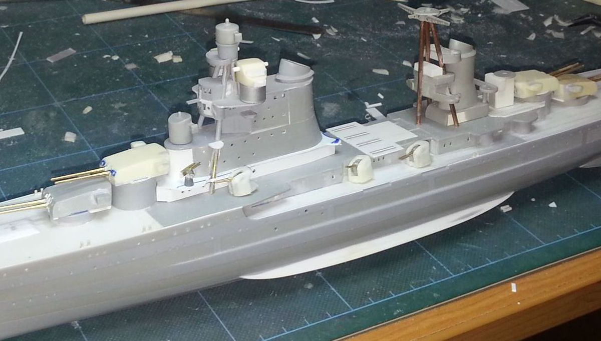

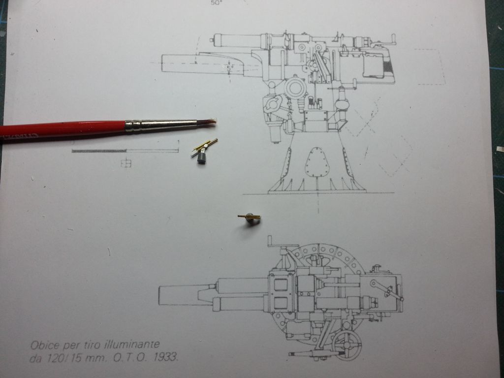

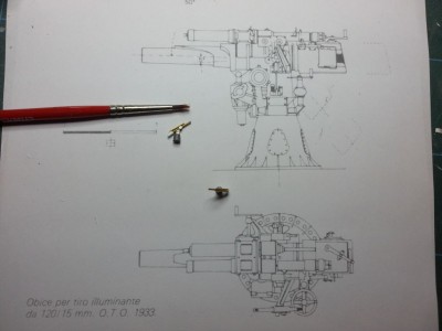

Here some Update: I checked as far as I could and Finally came to the conclusion that the Illuminating guns on the Pola were indeed 120/15. The 120/17 seem to have existed as a prototype only, superseded by the much superior 120/40 installed on the Vittorio Veneto and Duilio Class.
I did my best to scratch build something passable, but in this scale is truly a pain in the a*s: I don't know If it's decent but It will do for me: too much time and efforts poured on such a small detail. I built up a lot of respect for the nameless Umpa Lumpas sculpting this stuff for the model kit manufacturers and doing that much better then I seems able to do.
Meanwhile I ordered some photoetched stuff from Giampiero too: I'll get Portholes (clearly visible on the central hull sides of the Pola), some door to replace the horrible ones on the kit, Ladders and handrails. I already have the trumpeter ones for the Roma which I was planning to adopt but I absolutely needed good vertical and step ladders and they come together in a single sheet. I also got a set of Ro-37 which seems to be very nice and a whole bunch of USA Sailors from North Star Models which can be easily painted as Italians on this small scale.
I also have a never built Richelieu 1:400 in my "Davis Mountain" which comes out with a lot of very handy stuff to use for the Pola Kit (Anchors), Observation binoculars, and some boats which seems fit the Pola better then the ones out of the box.
The Two 120/15 Starlight on the Pola
The Guns and the Plans

Hi Ramaja,
Your's 120/15 guns looks very good for me :thumbs_up_1: , we don't can to expect soo much from little details in this scale.

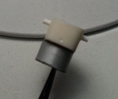

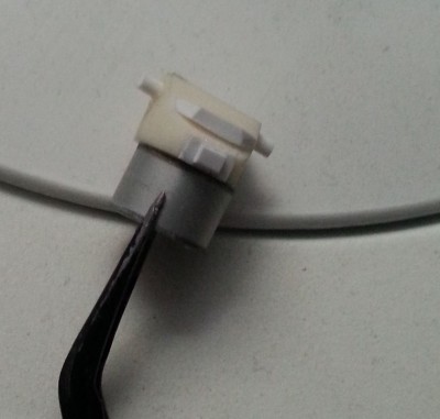

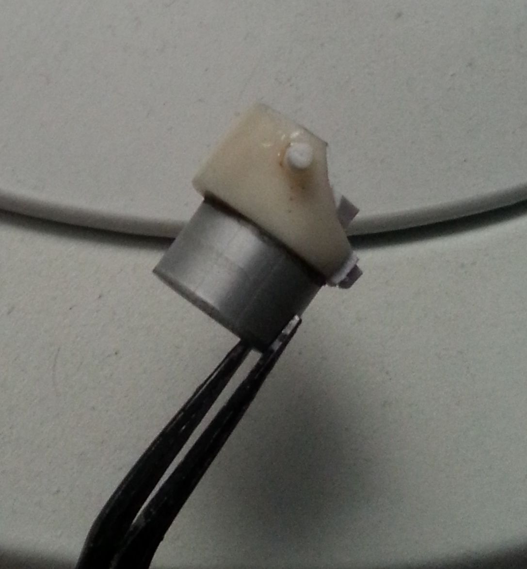

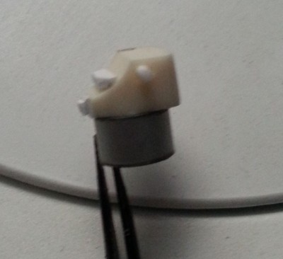

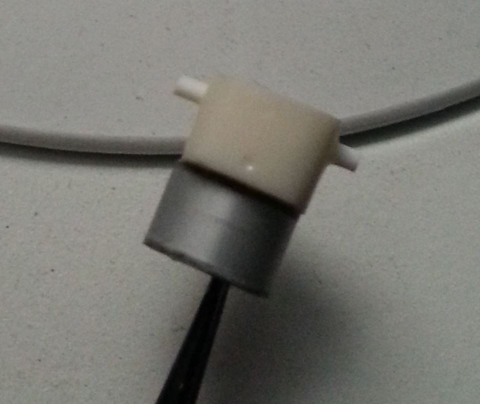

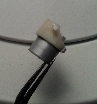

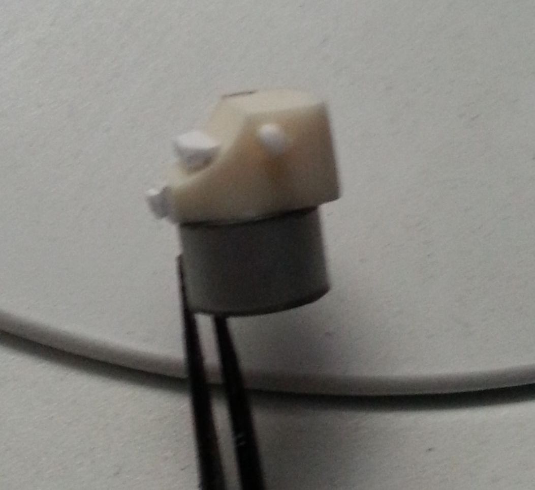

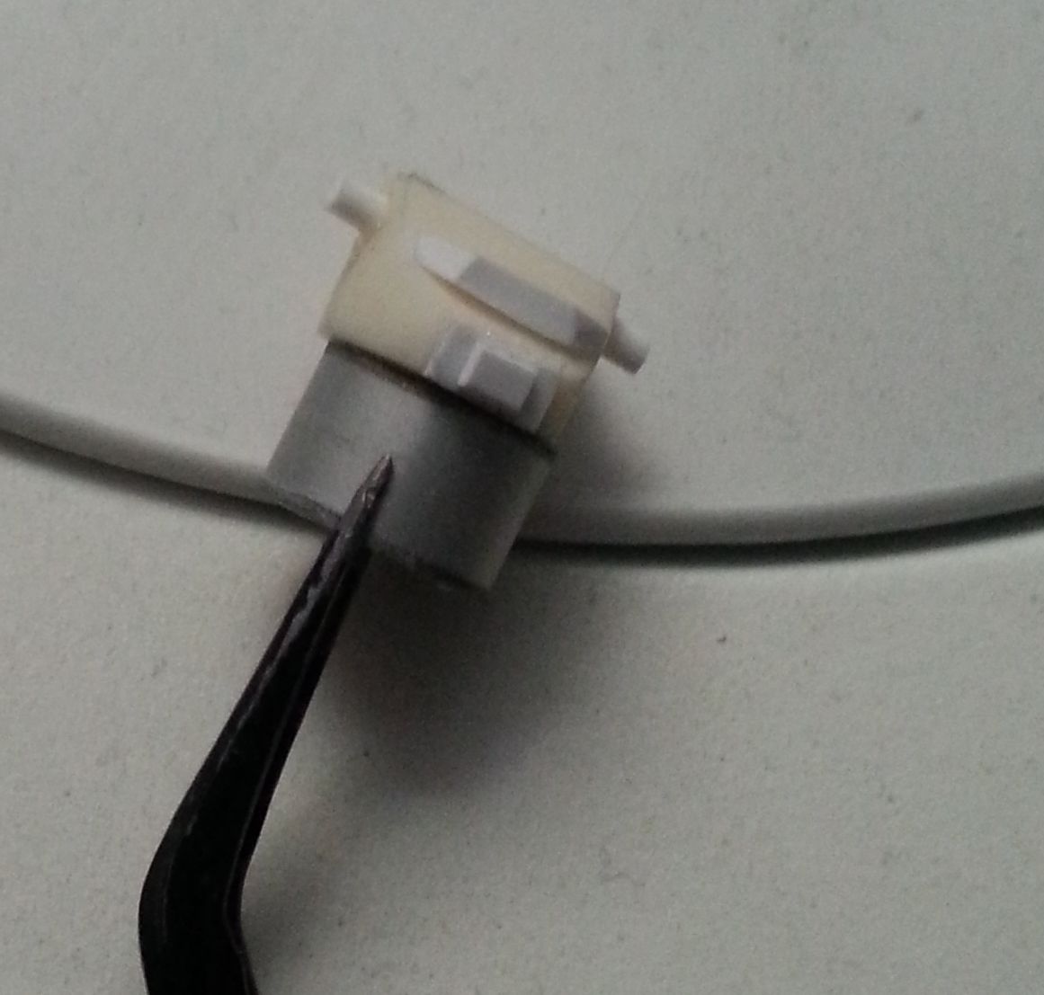

Some close pics (bad ones) of the range finders, of which I'm not overly satisfied

Hi Gianluigi,
Yes, it looks a good interpretation, but may be it can be improved. Now I'm searching new pictures in a new source I posted at my topic. May be I'll find a picture that aid us here too. For now my only observation is that in some pictures seems to me AA fire director body looks to be less larger than its cilindrical base.
And a good lateral close up from AA director in it's initial shape I had use to did my sketches.

Post by Ramaja »
I think I need to rebuild my range finders: as they are they're not convincing me.
The back plate has angles instead of blending in the sides, the Barbette at the base should be probably enlarged even more out of the shape of the range finder itself, the front welded object seems the only thing which has a different angle instead of blending with the inclined upper plate, which IMO hasn't any convexity in it's shape: the inclined plan seems just a plate with no complex shape except for the embedded parapet.
Here are some plans and 3D modelling I guessed form the Pics I found and drawn in 1/350 scale. The only thing I'm not convinced of yet in the actual thickness of the front welded object which may be between 1.5 and 2mm but in that, changing the angling of the oblique plate. Overall the shape looks pretty convincing, especially rotating the actual 3D model on perspectives similar the the ones observable in the real photos.
NB: the two rear windows may be positioned slightly lower.
The black object above the RF main platform looks to be some kind of canvas, so I didn't include it
Some small detail could be inaccurate: better double check with references at hand.
The top element visible in the 1035 pic from R.Ricardo, doesn't always seem to be there, so I'm not really sure what it might be; probably something like a hatch or a movable element of some kind. Also check the "Ears" of the RF in the last two Pics form R.Ricardo: at the Base of the Ear in the second one seems to be some sort of "door" or something protruding up to half the outward. In the second pic the detail looks completely absent albeit being the same ship. I don't know what to do with that... :eyes_spinning:
