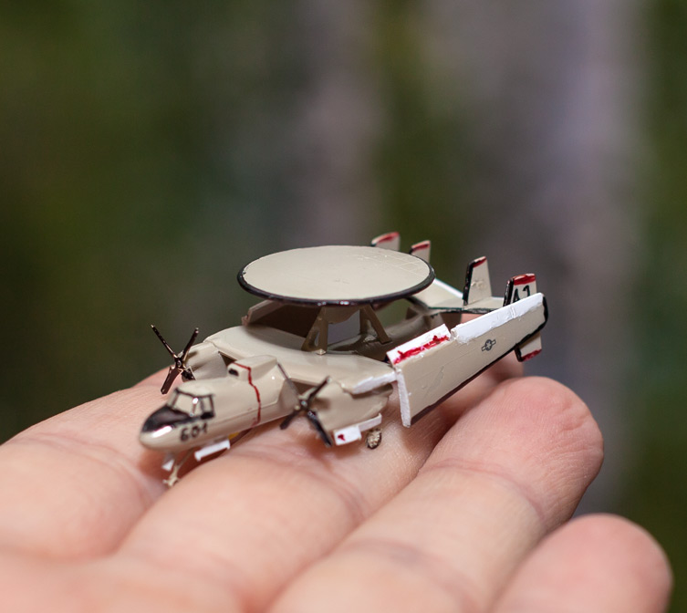

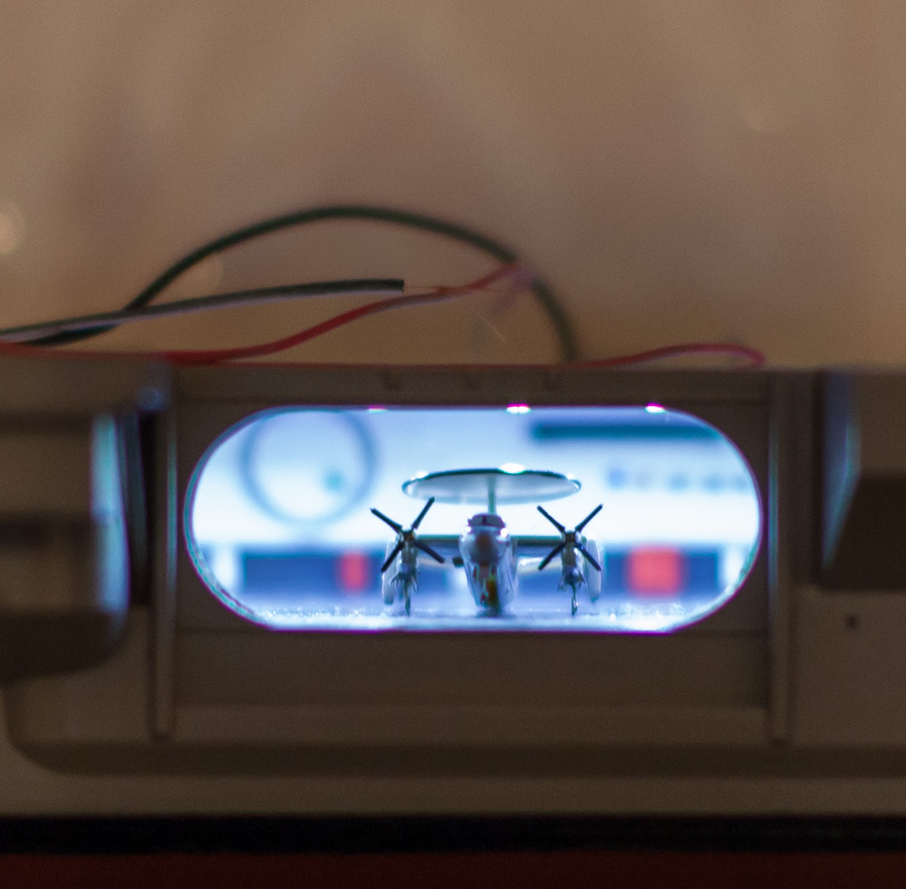

Thank you. First aircraft (Tamiya's fuselage). I will glue it to the hangar deck, don't know what else to put to nose, piece of lead is not enough.

Re: Trumpeter 1/350 Nimitz
Yeah, not much you can do as they are tail heavy. Little blob of glue on the nose gear and you're good to go. I haven't yet glued mine down. Hangar deck looks fantastic

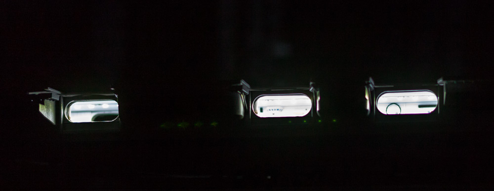

Nice job on that hangar. Your lighting is just right. Make sure you use white glue when gluing your aircraft to the deck, gives you freedom to make last second position changes and it dries super strong.
Beautiful hawkeye at this scale. The propellers came with the kit or are PE ones?

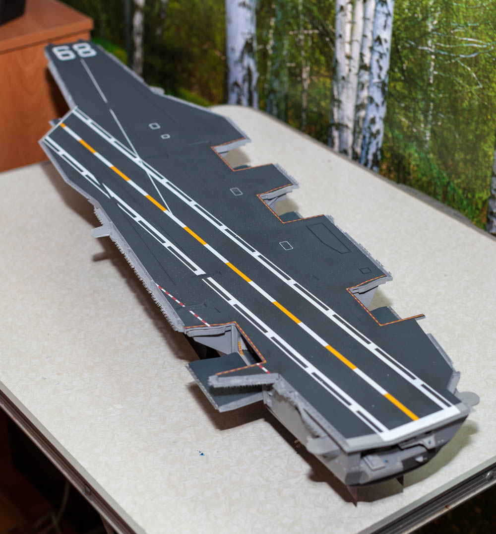

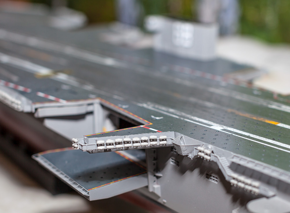

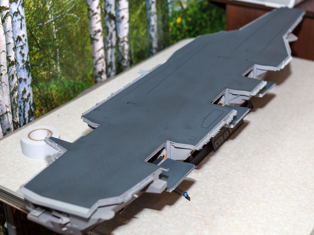

Flight deck is ready for 75%, not glued yet (still awaiting for PE from WEM, still no work on hangar and aircraft). Catwalks from GMM set 350-29 (extra), Tom's Modelworks Flotation Racks (105 pieces, 210 floats to be glued...omg...) were applied .
I used kit's decals+acrylic paints, also gonna apply self made decals instead of GMM's one (no at all anywhere). Some work with airbrush required.
For my Tamiya Hawkeyes i CA some Lead into them to weig teh nose down As there was a groove in the bottom of teh fuselage i placed in and pained white - hard to see

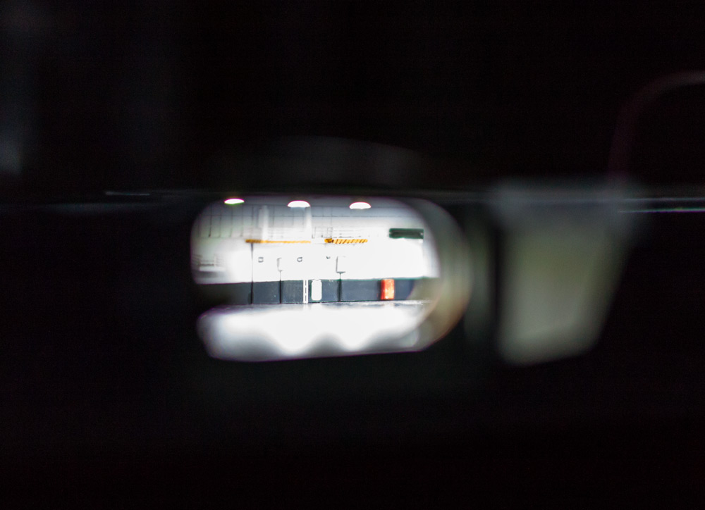

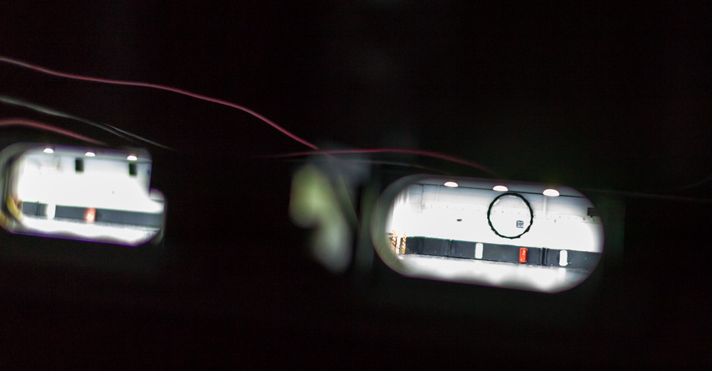

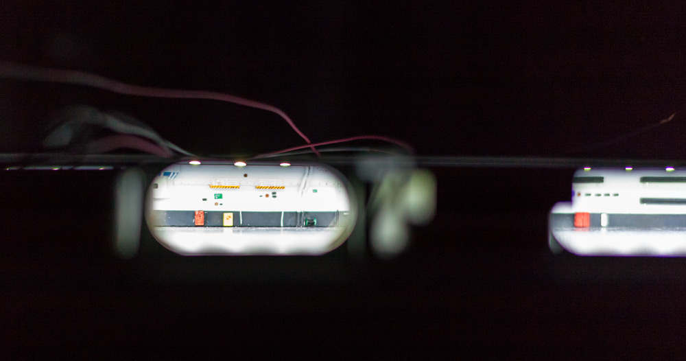

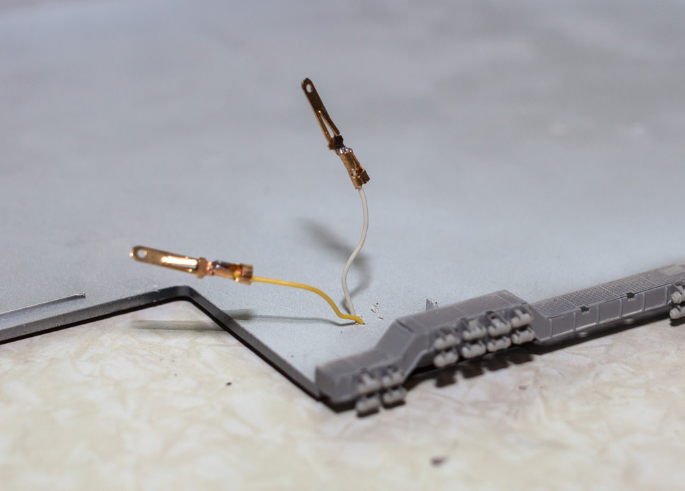

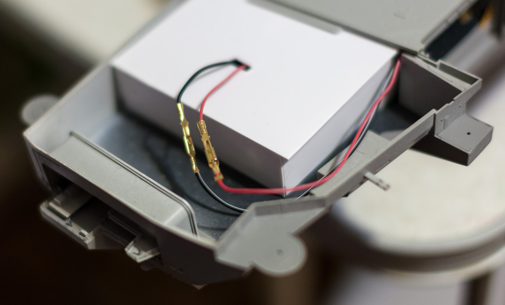

Well, details about lighting promised yesterday.
Island (low part) is not yet glued, just assembled, painted and aligned. LED strips are organized but also not yet glued - I have to finish all on flight deck.

Nothing special today - just completed all of the 210 life rafts.

looking good, where did you get the life raft racks (Toms?)
maksim2020
Here it is: http://cgi.ebay.com/ws/eBayISAPI.dll?Vi ... OC:US:3160
They also have such racks for Enterprise - much better than for Nimitz.

That's what I thought, first time I've seen them used
