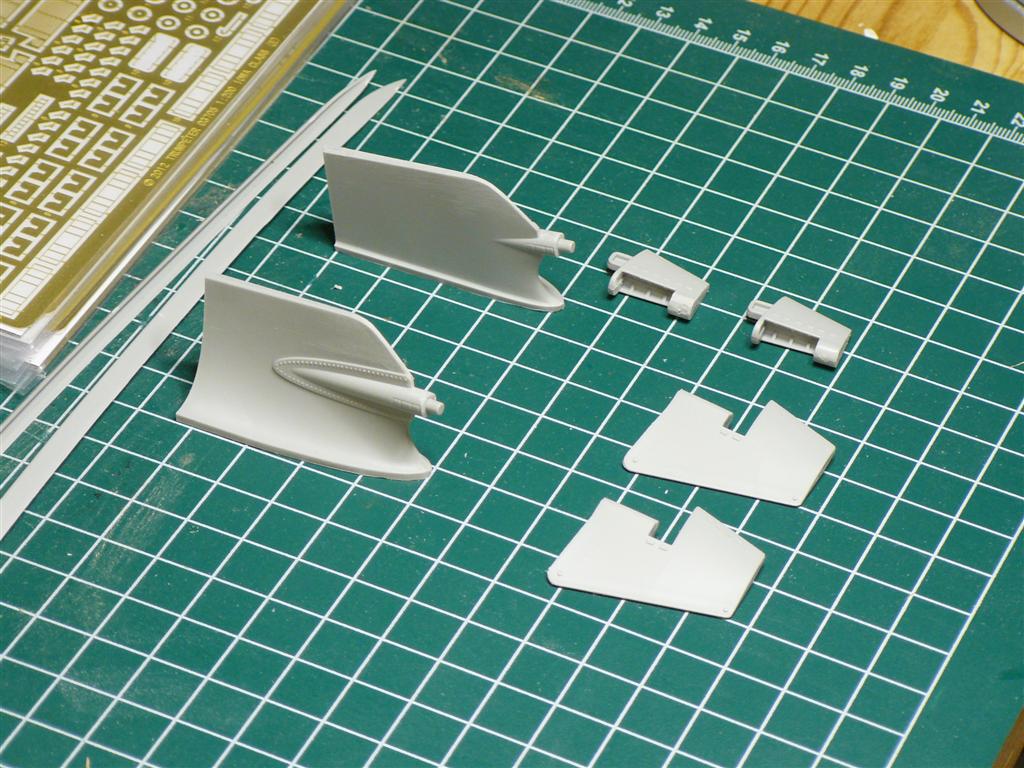

I did shaft my rudders and linked them via a control horn. The idea was to RC this at one point, but the ex wife disposed of the RC stuff many years ago. Wasn't of much use to her! It is interesting to look at some of the internal structure plans for the Iowa's, one can see where the internal structure is setup to support the weight. The structure supporting the internal inclined belt carries to the bottom and is probably the location of the outer blocks. the inner blocks appear to follow the structural line that emanates fed from the skegs. Be interesting to see the plan! Some of the Bismarck guys have been super detailing the hull fittings, including the quite bizarre large condenser inlets at the turn of the bilge. One guy is mounting it on top of a mirror....

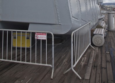

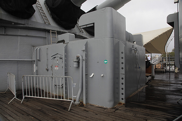

A not so great photo of the loading scuttle under the #1 turret. As far as I can tell there are six of these though three of the six on BB63 are currently covered with junk.
- Posts: 5068
Re: 1:200 USS NEW JERSEY (BB-62) 68-69 (Trumpeter MISSOURI k
Loading scuttle at the base of Turret 2

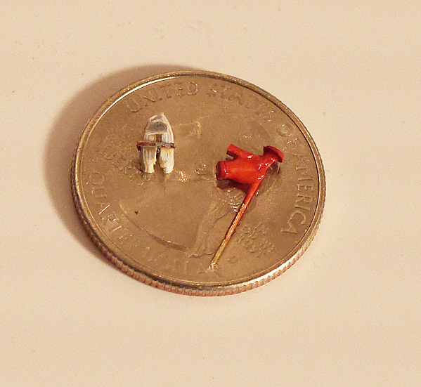

- Posts: 5068
Hank:
My pass at scratch building the wiley fire fighting gear at 1:200. I think this could be refined a bit, but it is only a small part of the ship.
Regards: Tom
Tom,
Very nice work - at 1:200 who would know that it was not manufactured? And thanks also for the pix of the scuttles. I believe NJs were in the same location, but the pictures will tell me so!

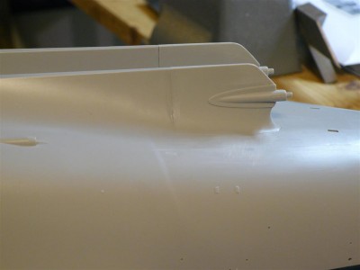

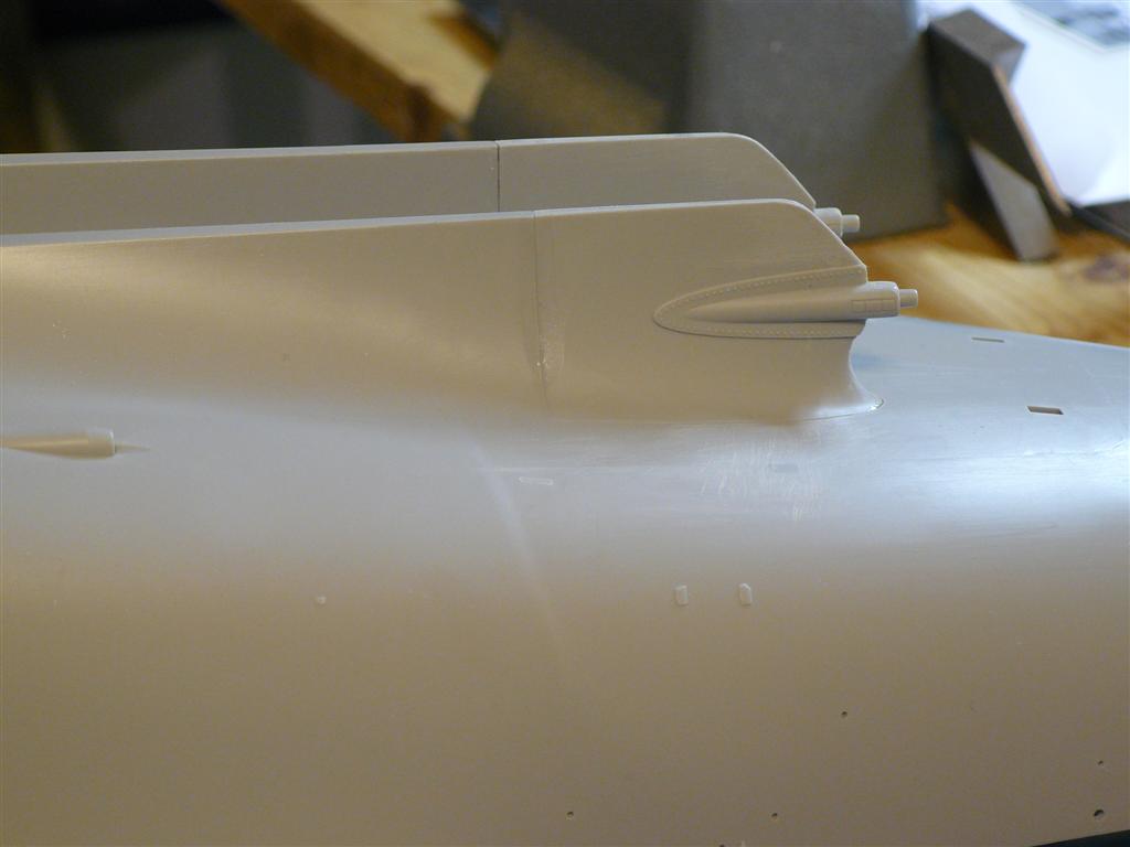

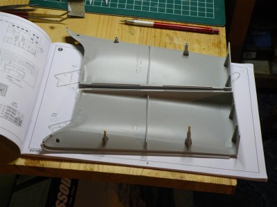

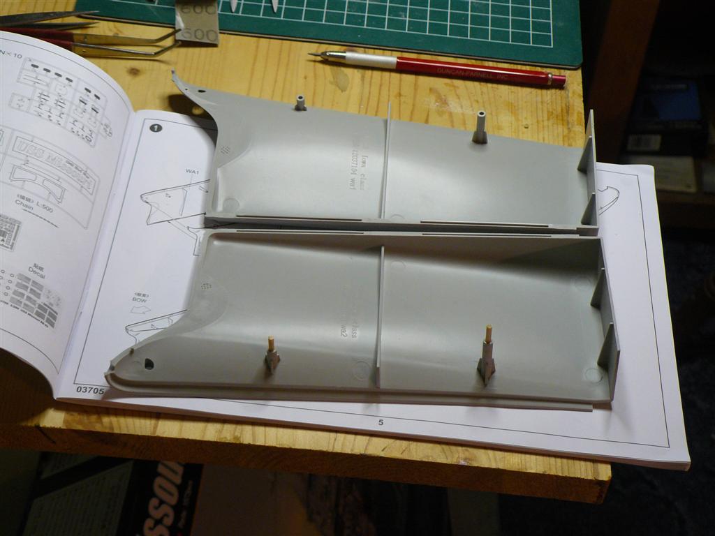

Last night was more shop area cleanup and so actual model work was off the table. Tonight (Tues.) I hope to get the bow area assembled with putty and then continue with my main deck CAD drafting.
Here are a few shots of the pieces that make up the hull & main deck:
Thanks for the photos, Hank.
Now I'm curious as to why Trumpeter would provide the main deck as a single piece and yet divide up the hull. Mould limitations perhaps? Or maybe that's the only way they could figure out how to do such a big hull without that infamous banana shape. I suppose even so-called "professional" modeling companies have to go through a learning curve.
Sean,
Thanks for the comments. Re. the main deck:
The main deck is not in one piece - it is two pieces. See where the superstructure opening occurs? the wide piece of plastic from side to side is the split between the fore and after deck sections. They do fit nicely, without any distortion.
Hope this clarifies it for you!

Ah, I see now. Thank you, Hank.

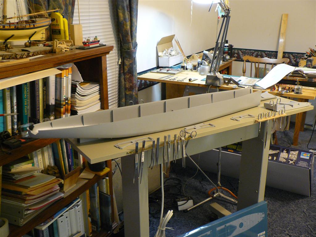

- Posts: 5068
Nice work area, especially the building ways! A little bit interesting to shaft the rudders and hopefully link them up. May take some precise drilling. As far as the deck goes, around the hatches etc the deck will be cutout to slip over them? Would require very accurate measuring!
Without the bow attached it looks a lot like Kentucky when the lopped the front off.
I tried using to smallest I beam for the Stantions on the 01 level but they are a bit over scale. Not sure yet what the optimal solution is. Something square might be about the best one can do. I presume the waterway is deep enough to make a good anchor for PE rails

- BB62vet
- Posts: 3174
- Location: Mocksville, NC
Tom,
Thanks for the nice comments!
The table the hull is sitting on is one I made from the HP plotter leg assemblies. Works very nice, indeed. I hadn't thought about connecting the two rudders, but that is a possibility - if only to keep them in sync.
I will probably take my first printout of the main deck, cut it out and all the openings, and see it it actually fits or I need further CAD work on it. I want to get it correct before I start on the 01-04 level drawings.
Yea, I was thinking the same thing about KY - now there's a project that wouldn't take any time at all!!!

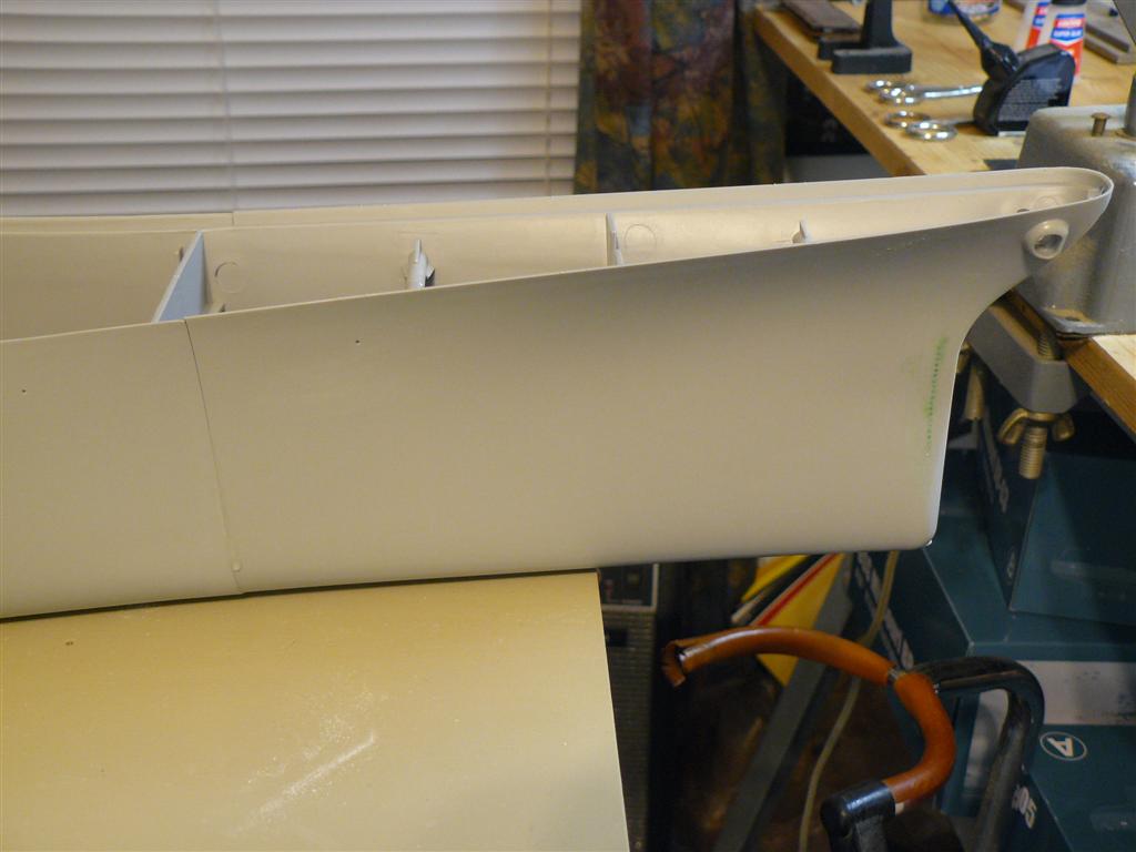

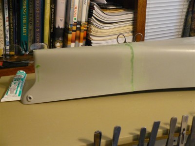

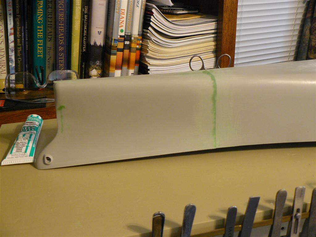

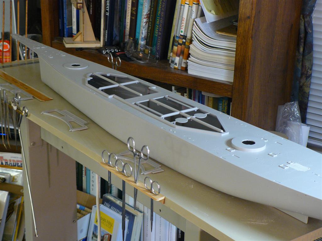

Progress on model -
After cutting out the forward part of my main deck plan, I had to make quite a few adjustments in opening locations, etc. I've reconciled 2/3 of the plan and hope to fiinish checking/redrawing the stern section tonight. I've re-printed it and will go recheck tonight - hopefully with better results.
With the bow sections mated, I filled in the minute holes in the bow and the seams w/Green Stuff and later sanded, etc. The bow section is now mated to the hull and tonight I will apply Green Stuff to hide the seam. Hopefully, I will post pictures tomorrow - I forgot to download them from the camera.
At 1:200 this would be a 1/4" high piece - possibly something that could be resin cast with care.
I'm thinking that the lifelines were used at the fantail, not the netting. I've also noticed that the crane control module was modified and relocated in NJs 67-69 configuration. I think that the Pontos PE for that will still work, perhaps with minor modifications.
Bridge deck gratings - we only had them on the after end of the bridge at the signal bags. It's possible that the grating could be purchased from one of the model lumber vendors or Model Expo (depending on the grating size). Actually, that's some information Cliffy B could provide from a field trip - i.e., the grating opening sizes and thickness.
Progress on model -
I can't get shots of Turret 1 or 2's loading hatches on BB-64 as they're sealed up and covered. However Turret 3's is visible so here goes (Starboard side).
Some inspirational shots. I love the end of a Winter day

- Posts: 5068
Thanks Cliffy, much clearer shots. Around the turrets seem to,be collecting areas for various junk on board...
Last night I basically completed the hull assembly and puttied various areas. I still have the shaft housings to putty and will get to that in Jan. 14. I'm away from the shop for the next 2 weeks.
