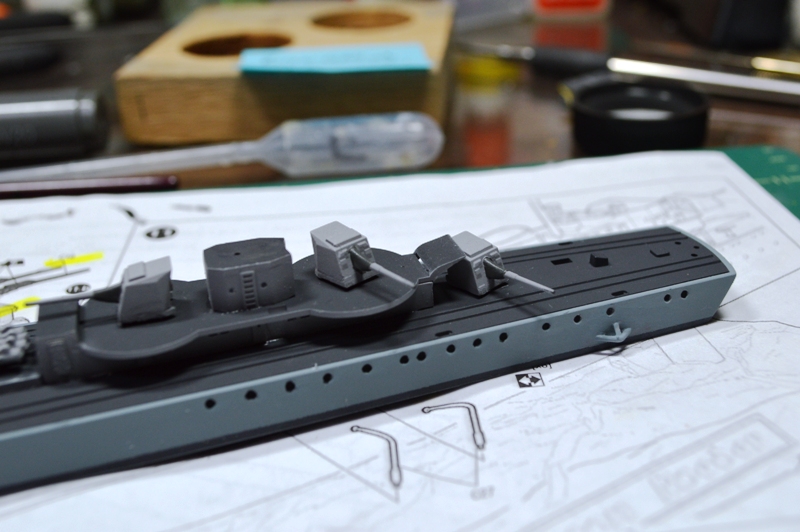

First part glued to the hull!

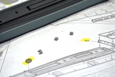

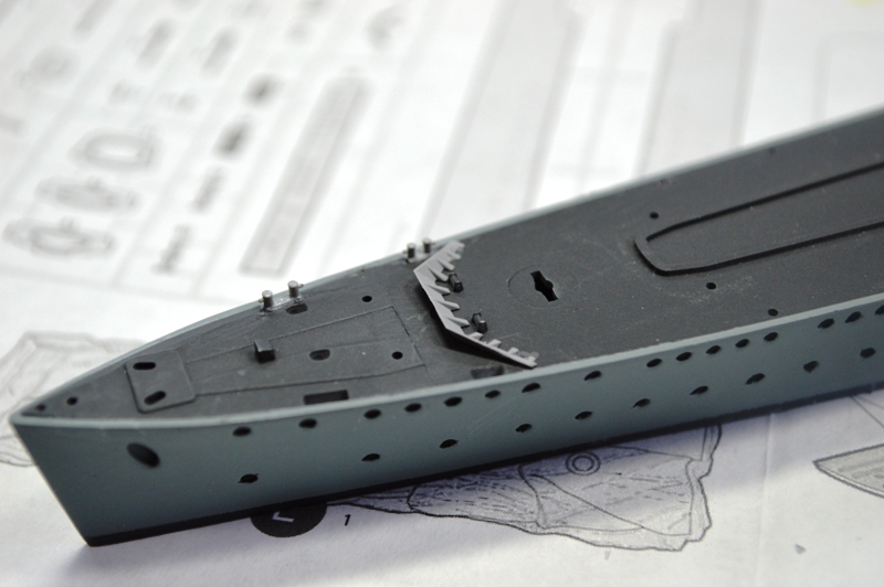

Not sure what the Germans called bollards...

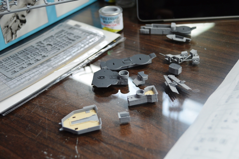

Some of the parts that were airbrushed...
Breakwater and some of the bollards added

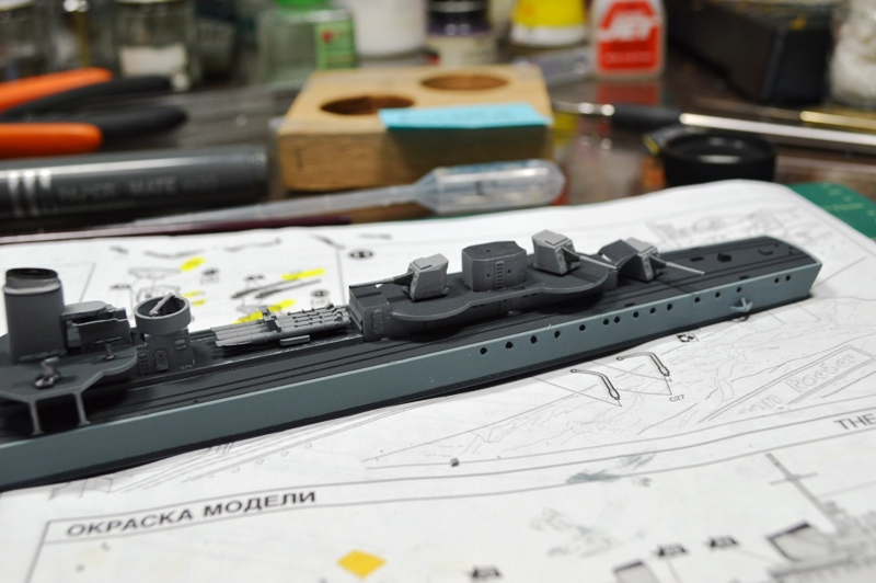

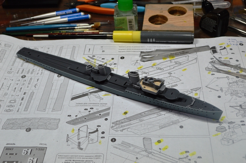

Superstructure dry fitted to the hull, so the bridge deck can dry properly to the forward superstructure

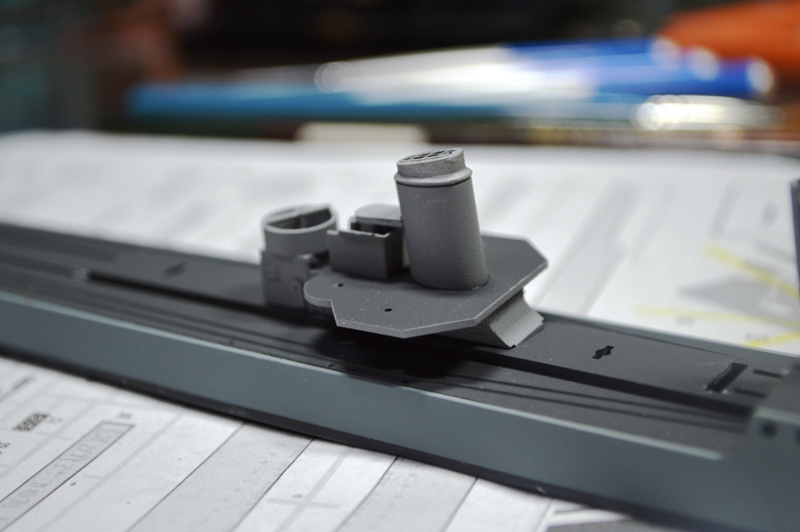

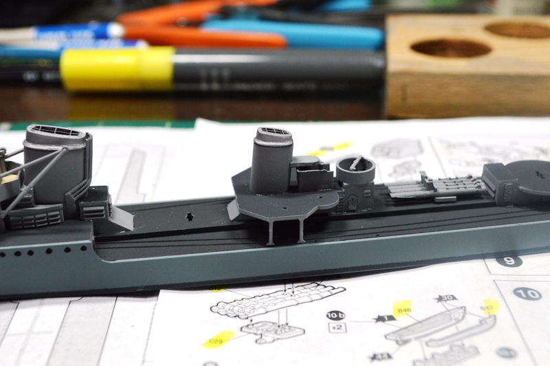

Middle superstructure dry fitted to hull

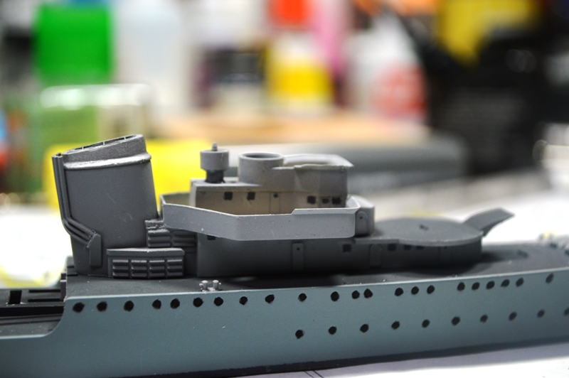

Here is where I ran into my first fit problems - the bridge wings didn't want to sit flat on the forward superstructure.

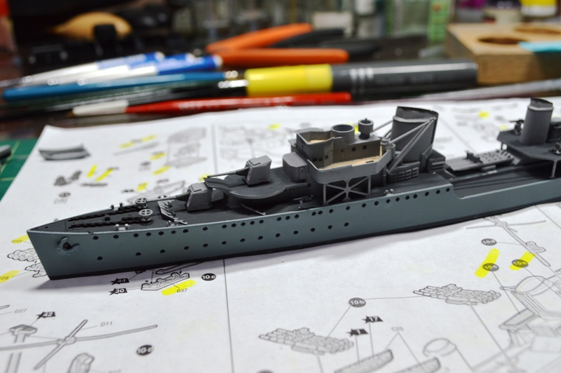

Thanks guys, appreciate the comments.

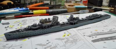

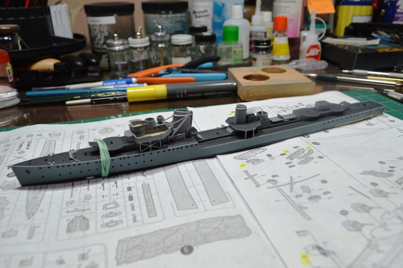

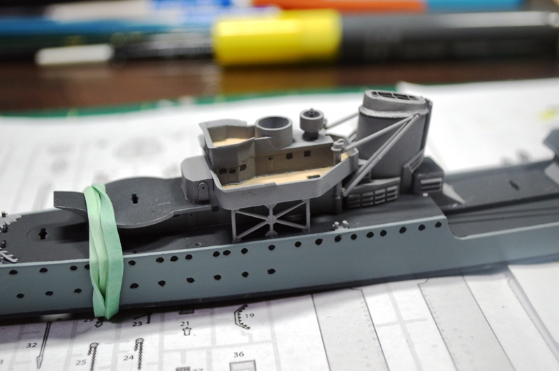

Work is moving along, I've got all the superstructure decks in place. And, as the other day, I ran into some minor fit issues. It seems once I wanted to permanently attach the deck houses, the forward two didn't fit as well as when I dry-fitted them. I attribute that to the support pillars on either side. With a little maneuvering and some judicious use of Tamiya Extra Thin Cement (and rubber bands), I got the parts to sit pretty much flush. The small "vent" that sits behind the forward funnel and straddles the break in the fo'c'sle and the main deck also gave me some grief, but I think I got that to behave, after some persuasion, as well.
As you see her now, most of the major construction is done. What's left is add the guns, one torpedo launcher, the masts and the boats. Plus the always needed touch up - starting with the area around the prop guards which needs to be repainted Dunkelgrau 51.

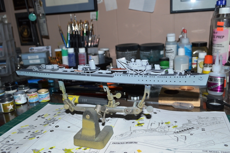

Some more progress. Just about everything is on except the ships boats, some bridge equipment, masts, jack staff and flag staff. I noticed too late that the two lumps just aft of the breakwater are cable reels. If I had realized that earlier, I would have shaved them off and replaced them with photo-etch versions. Not sure I want to take a chance at wrecking the deck at this late date.
The last thing I did last night was some touch up painting - have to do some more so I can then airbrush the hull with future ahead of applying the penant number decals.

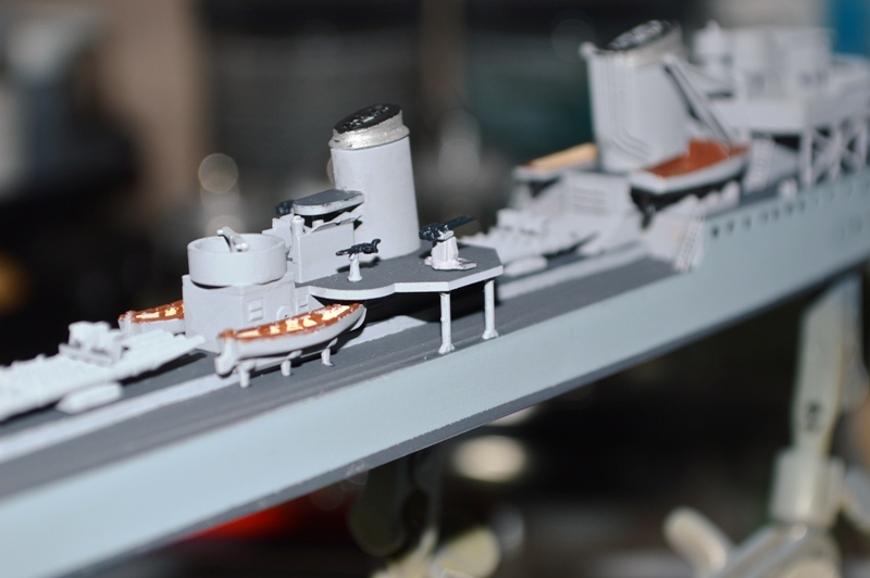

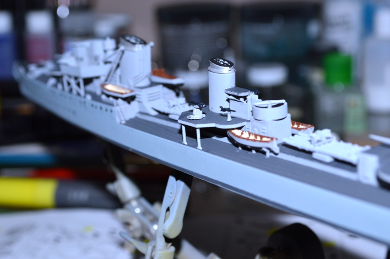

With a late meeting at work last night, by the time I got home, I didn't have the time or enthusiasm to work on Z-17, which means I won't have her done by our club Group Build deadline of this Friday night. But, that's okay - I see areas that need touching up before I airbrush her with future in preparation of adding the pennant numbers and doing a wash, so I'd rather do her right than rush.

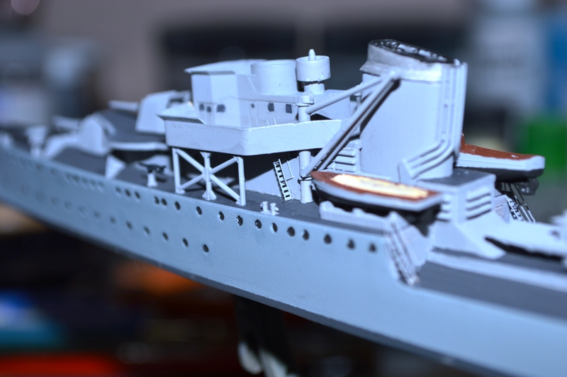

Here's some photos from tonight's work. I used the inclined ladders from the Trumpeter Z-25, four of which had to be cut to fit properly. The Trumpeter set leaves me an inclined ladder short, but a buddy is giving me his Z-25 PE set, as he's going to go the aftermarket route, so I'll have the proper amount of ladders. I also added the ships boats (one of the things that needs touching up).
The mines are painted and ready to be added. I'm going to fill the holes in the deck where the jack and flag staff goes, and make them - as well as some of the masts - from brass.

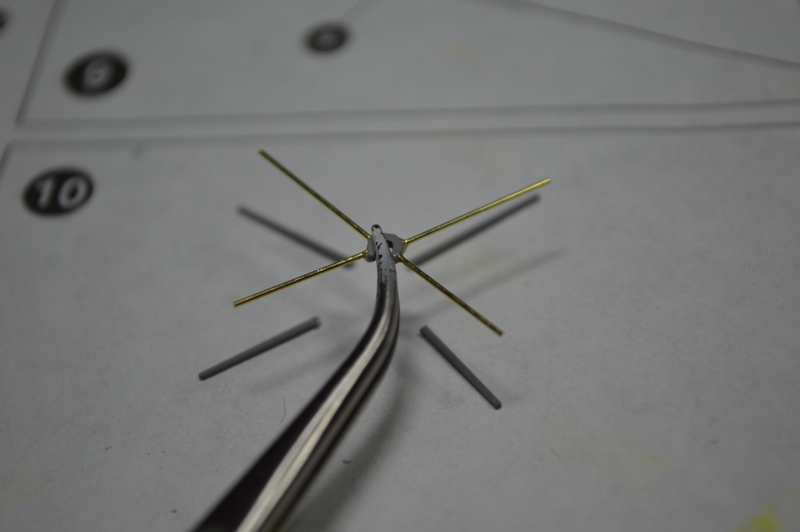

I worked on the masts and the jack/flag staffs last night...
I didn't like the look of the braces on the foremast, so I cut them off and replaced them with brass rod

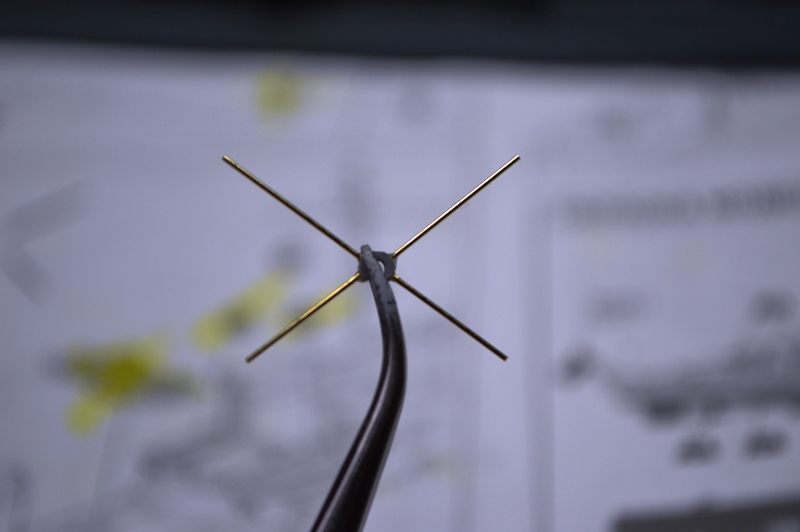

Replaced the aft mast with brass and added a yard, which is visible in photos.

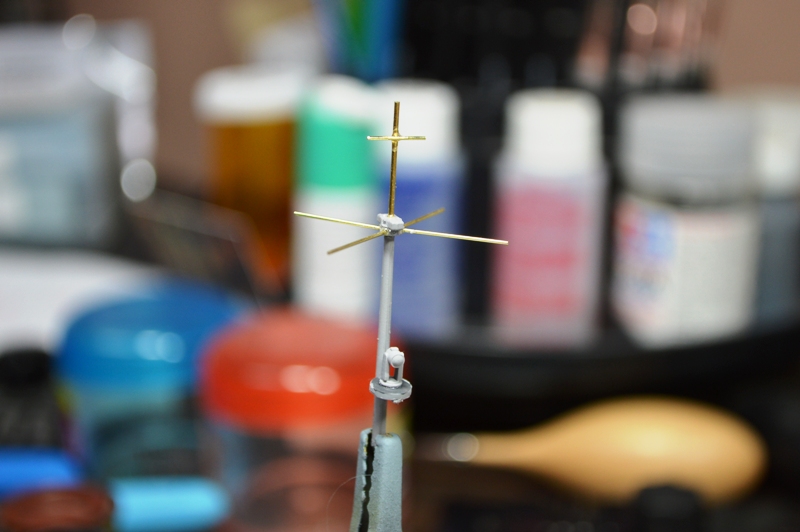

Foremast with kit topmast

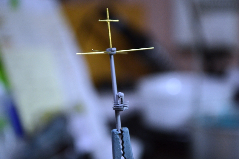

New topmast made from brass

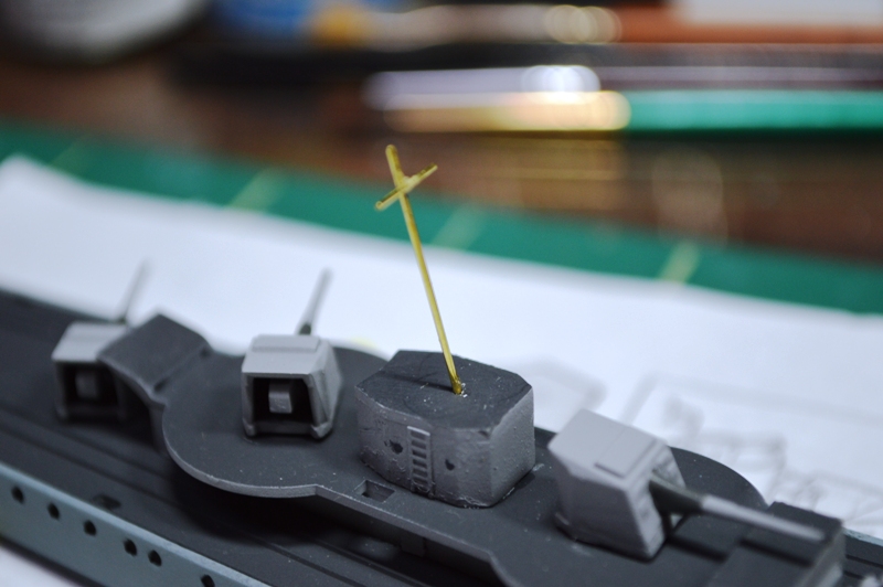

New flag staff
New flag staff

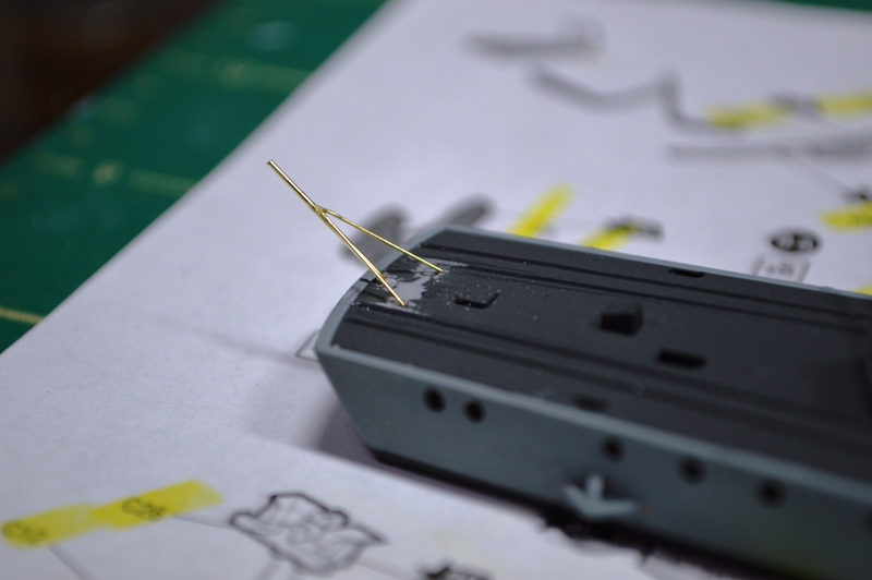

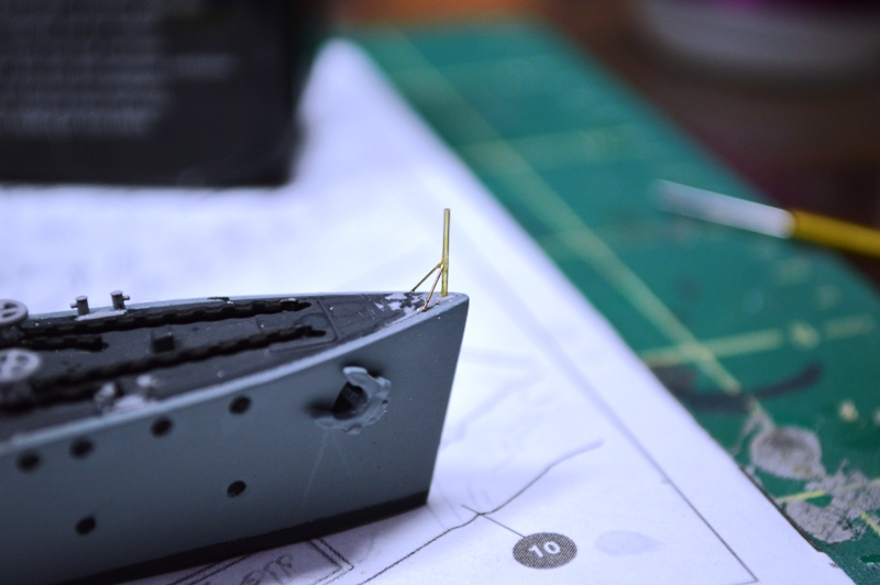

New jack staff
New jack staff

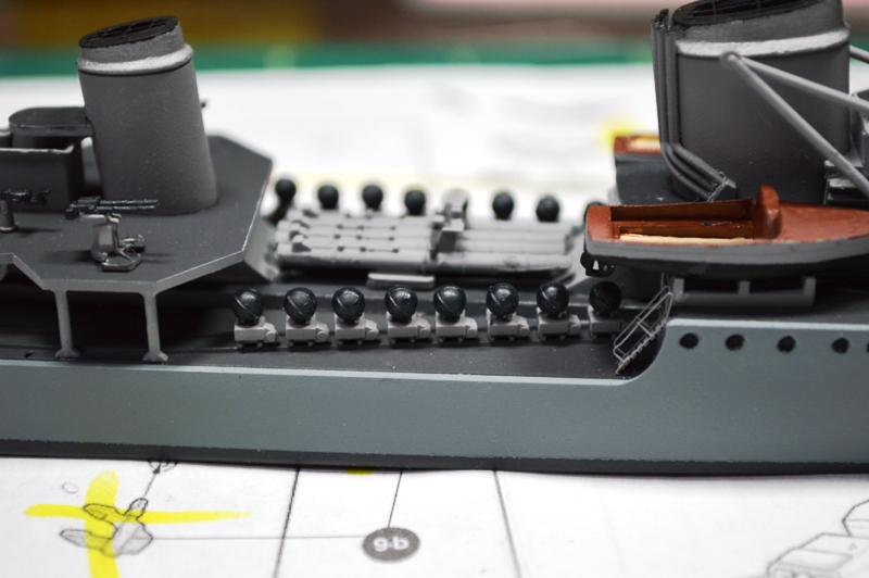

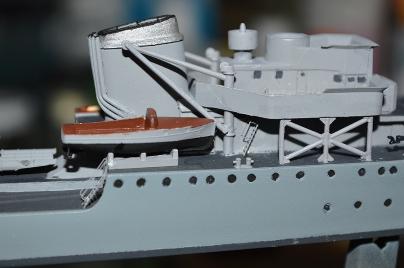

Random photo of the midships area with the mines in place.  The inclined ladder from the Trumpy Z-25, and had to be cut to fit properly.
I've got the mast set aside to repaint. Once the mast is painted and installed, I'm going to start adding the railings.
