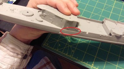

I also found a solution to the seam under the 5" splinter shields. Flyhawk makes the porthole pieces. I will simply sand off the existing ones and replace them all. Now I can get to the seam with no issues.

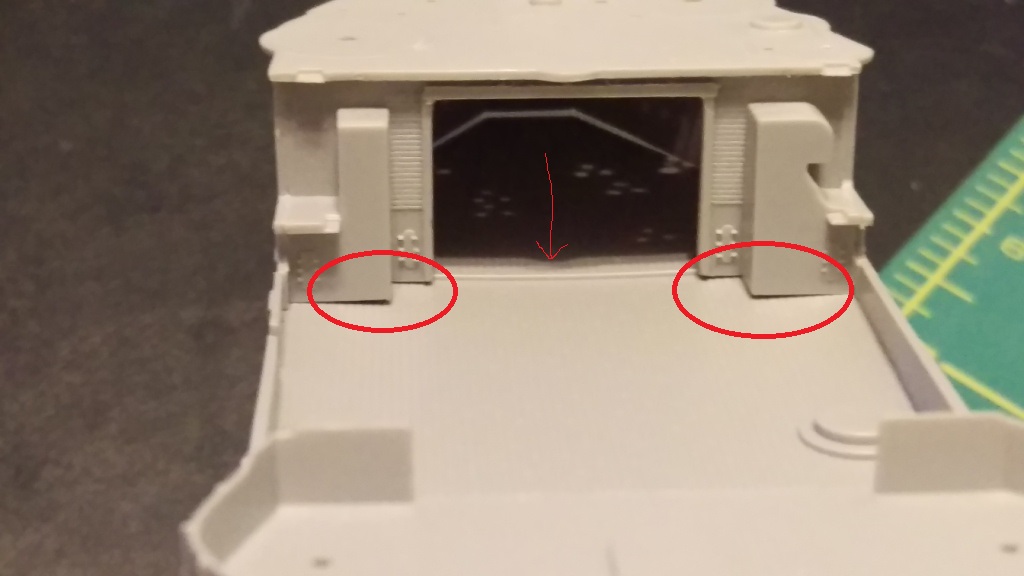

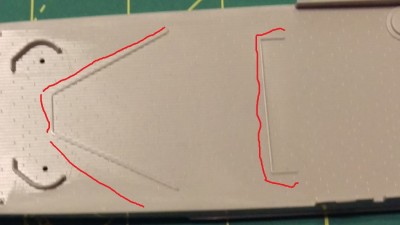

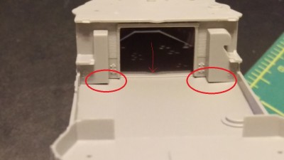

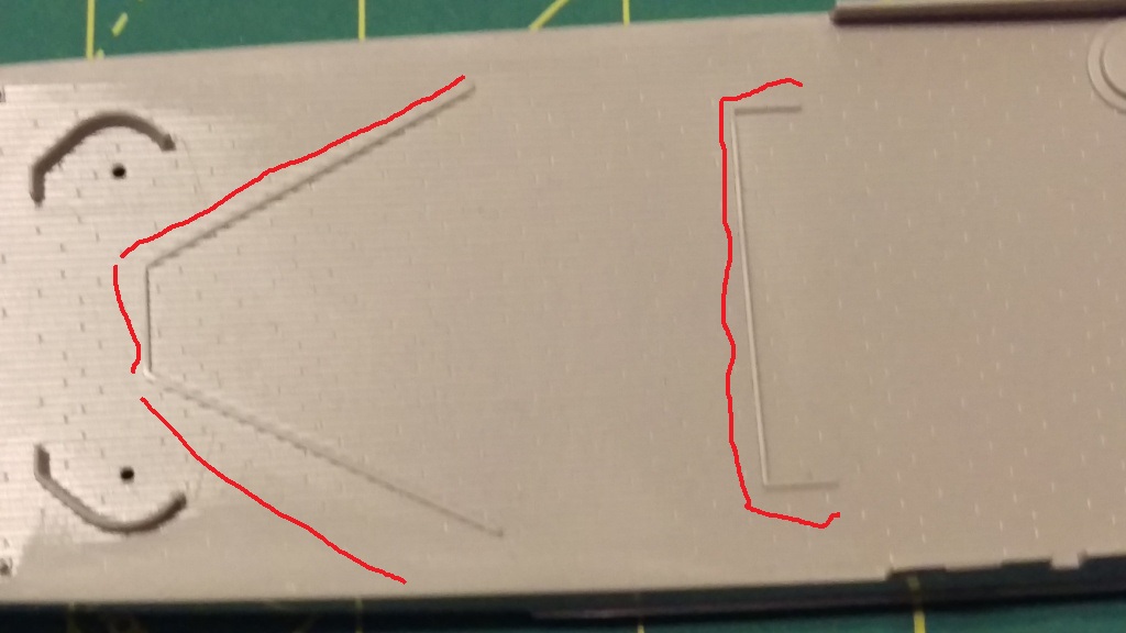

I have run into an issue and need some advise. Trying to fit the aft most structure on the deck I have run into an issue of fit that I cannot seem to solve.
You can see the guide marks for the structure on the deck here (kind of outlined in red) When you put the structure on you see the deck is curved at this one area The sides of the structure in all photos appear to be flush with the hull below it. Circled here you can see it tapers with the gap getting bigger the farther aft you go. And finally on the back side of the structure it does not sit flush against the deck. If you force it down it causes the front corners to overhang the hull. Any suggestions are most welcome!

Styrene strip shims. Yes, a P-I-T-A.

That would solve most of the issues I think but what about the issue on the third picture? I am not sure shims will work there.

I came up with a fix for that seam under the 5"/25s earlier in the thread although I might not have explained it very well. Once I found that Flyhawk makes the porthole covers in 1/350 I elected to sand off all the porthole covers on the ship which I will replace later. This allowed me to access the seam much more easily. I am not sure if there is a solution in 1/700 though.MatthewB wrote:Wow!

Another set of issues you will find with the aft deck section is that if you follow the guide lines it will sink below the top of the hull. The deck should sit flush. So you will need to raise it up. The building that faces into the plane handling area is also a tad short. The top of it should sit flush with the upper deck where the funnels are.
I might need to do something drastic like drill into the water plate and add something like brass rods to act like support stanchions under the area of the deck that is sagging. Do you guys think something like that would work?
This still does not solve my issue with hangar bulkheads tapering in away from the hull though....

A concave deck is a bit of a surprise, for sure. If anything, it should have some camber to it.
Yeah, a couple of inserts will work; you just have to file it/them down at an incline at the ends to match the gap. It will take a lot of intermittent sanding and test fitting.
