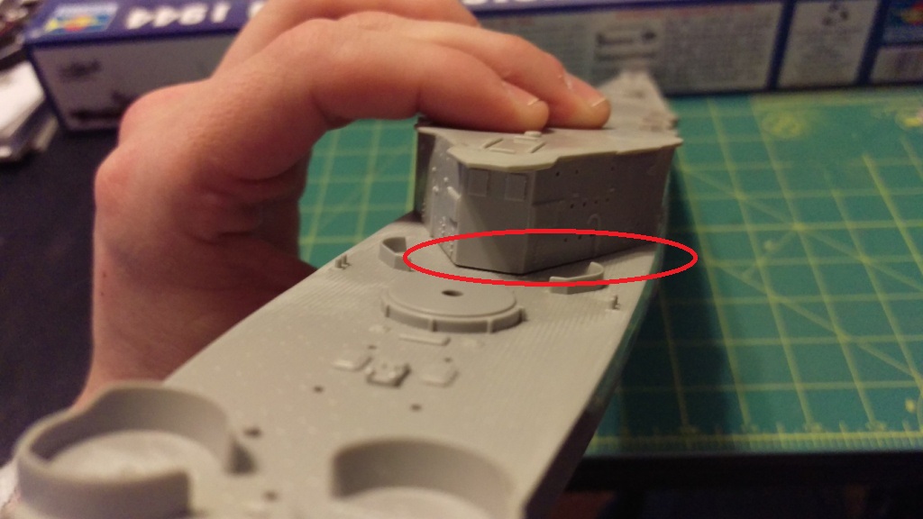

I have run into an issue and need some advise. Trying to fit the aft most structure on the deck I have run into an issue of fit that I cannot seem to solve.
You can see the guide marks for the structure on the deck here (kind of outlined in red)
When you put the structure on you see the deck is curved at this one area
The sides of the structure in all photos appear to be flush with the hull below it. Circled here you can see it tapers with the gap getting bigger the farther aft you go.
And finally on the back side of the structure it does not sit flush against the deck. If you force it down it causes the front corners to overhang the hull.
Any suggestions are most welcome!
Re: CA-38 Diorama
Posted: Wed Jan 13, 2016 10:43 pm
by Dan K
Styrene strip shims. Yes, a P-I-T-A.
Re: CA-38 Diorama
Posted: Wed Jan 13, 2016 10:47 pm
by Angeliccypher
That would solve most of the issues I think but what about the issue on the third picture? I am not sure shims will work there.
Re: CA-38 Diorama
Posted: Thu Jan 14, 2016 1:46 am
by MatthewB
Wow!
The 1/700 kit has the EXACT SAME ISSUES as the 1/350 Trumpter Kit.
I imagine they just scaled down the parts from what it looks like.
The forward deck, with the gap between the 5"/25 splinter shields and the portholes... I am flummoxed over what to do about that gap as well.
For one thing, it will drastically alter the way that I build the ship (not adding the baseplate till MUCH LATER so that I can glue the decks down to assemble the superstructure prior to mounting the guns, priming, and painting.
MB
Re: CA-38 Diorama
Posted: Thu Jan 14, 2016 6:21 am
by Angeliccypher
MatthewB wrote:Wow!
MB
I came up with a fix for that seam under the 5"/25s earlier in the thread although I might not have explained it very well. Once I found that Flyhawk makes the porthole covers in 1/350 I elected to sand off all the porthole covers on the ship which I will replace later. This allowed me to access the seam much more easily. I am not sure if there is a solution in 1/700 though.
Another set of issues you will find with the aft deck section is that if you follow the guide lines it will sink below the top of the hull. The deck should sit flush. So you will need to raise it up. The building that faces into the plane handling area is also a tad short. The top of it should sit flush with the upper deck where the funnels are.
I might need to do something drastic like drill into the water plate and add something like brass rods to act like support stanchions under the area of the deck that is sagging. Do you guys think something like that would work?
This still does not solve my issue with hangar bulkheads tapering in away from the hull though....

Greeeaaat... The deck is supposed to sit flush with the hull?
Yet another thing I screwed up on my 1/700 build (that needs to be corrected on the future build).
And another reason to change the order of the build from the instructions.
MB
Re: CA-38 Diorama
Posted: Thu Jan 14, 2016 8:12 am
by Angeliccypher
I could be wrong, but inside pictures I have seen it looks flush to me.

Re: CA-38 Diorama
Posted: Thu Jan 14, 2016 2:00 pm
by Dan K
A concave deck is a bit of a surprise, for sure. If anything, it should have some camber to it.
Yeah, a couple of inserts will work; you just have to file it/them down at an incline at the ends to match the gap. It will take a lot of intermittent sanding and test fitting.
