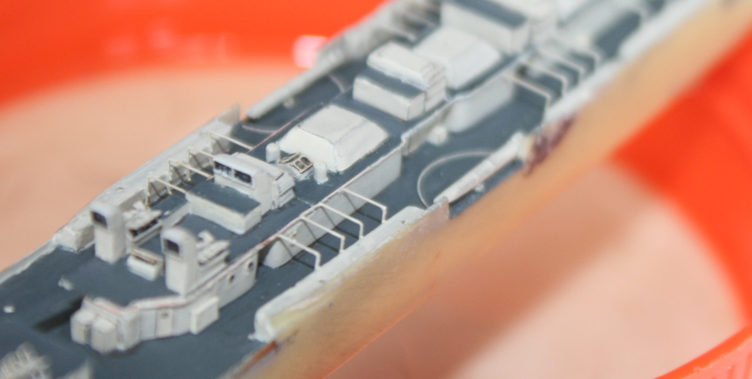

the bridge level castings were crude and chunky and incorrect in plan view as well as side elevation
The rear of the pilot-house was very " soft " in outline--as well as being under-size
so the remedy was to use brass strip for thin walls as well as sharpness of outline

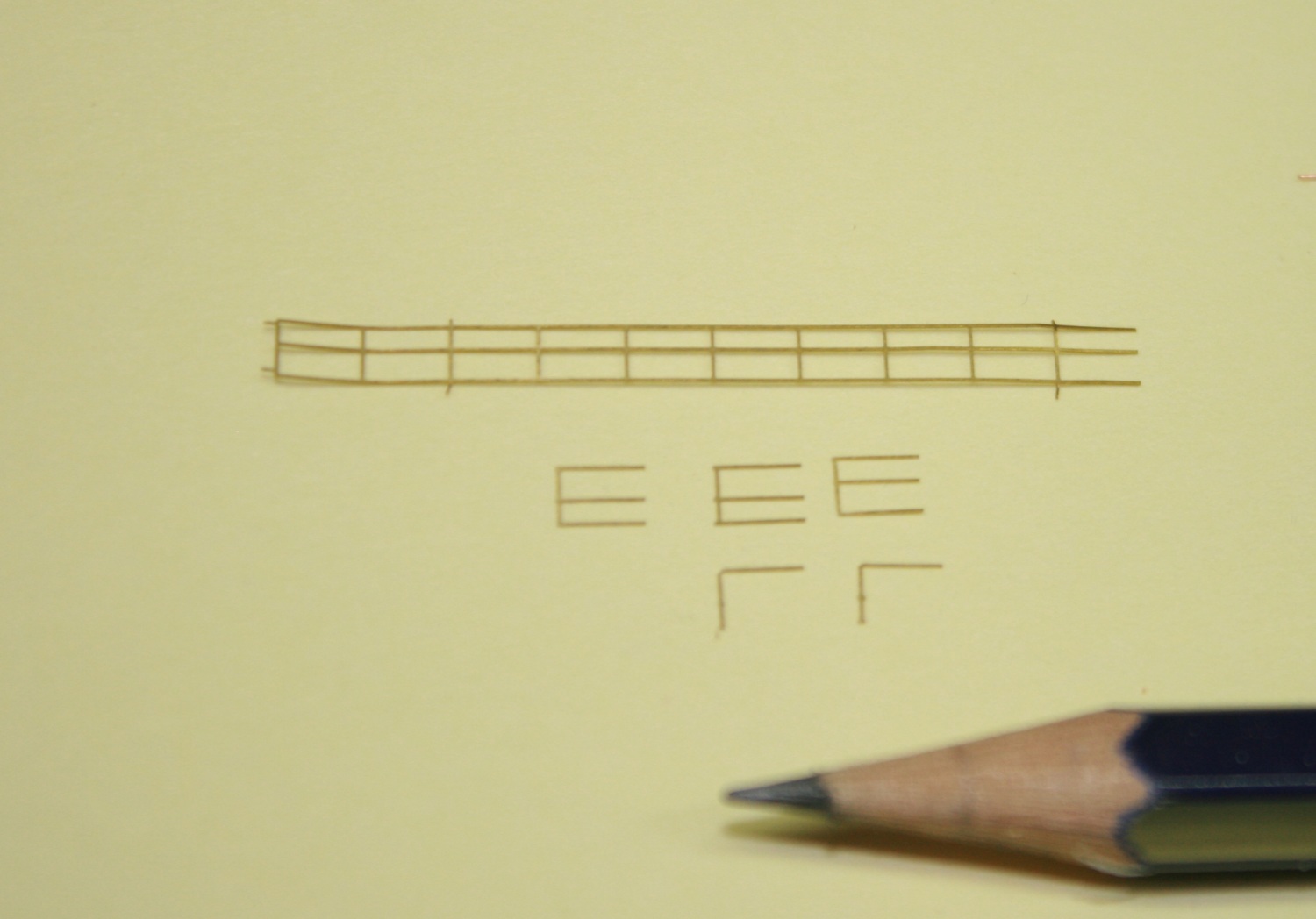

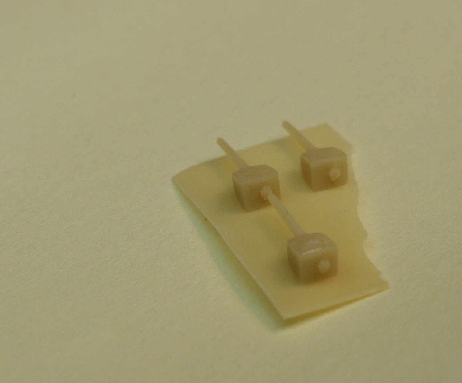

Having cut out and created the torpedo tube apertures
I made the tube track of very thin copper-wire flattened between two Stanley blades in a vice
and then made the tubes utilising some old plastic IJN T-tubes--
I may yet re-make these in metal as I would like them to be sharper ! :cool_2:

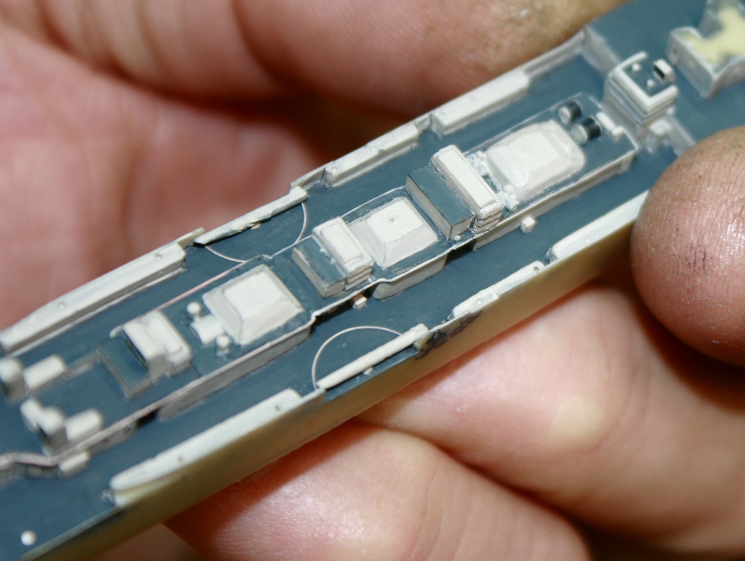

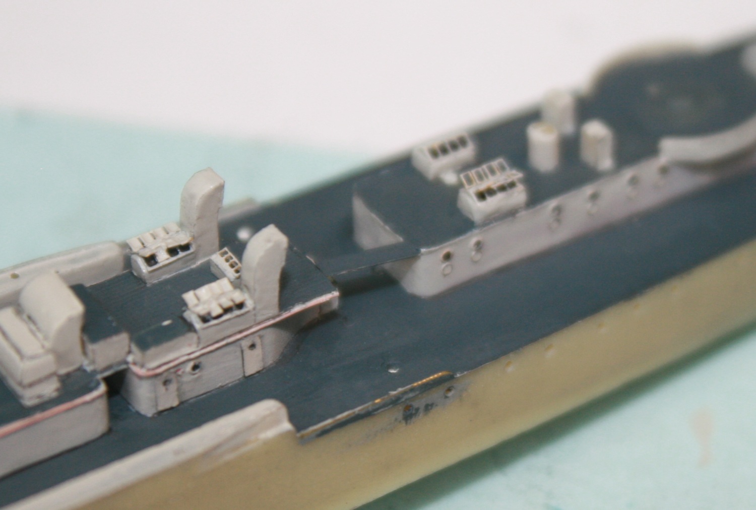

The aft vent boxes were cast solid ( and crooked) and devoid of any detail...
I simulated the outlines of the apertures using some ladder stock from GMM
and made the hatches using a slightly smaller ladder stock from WEM

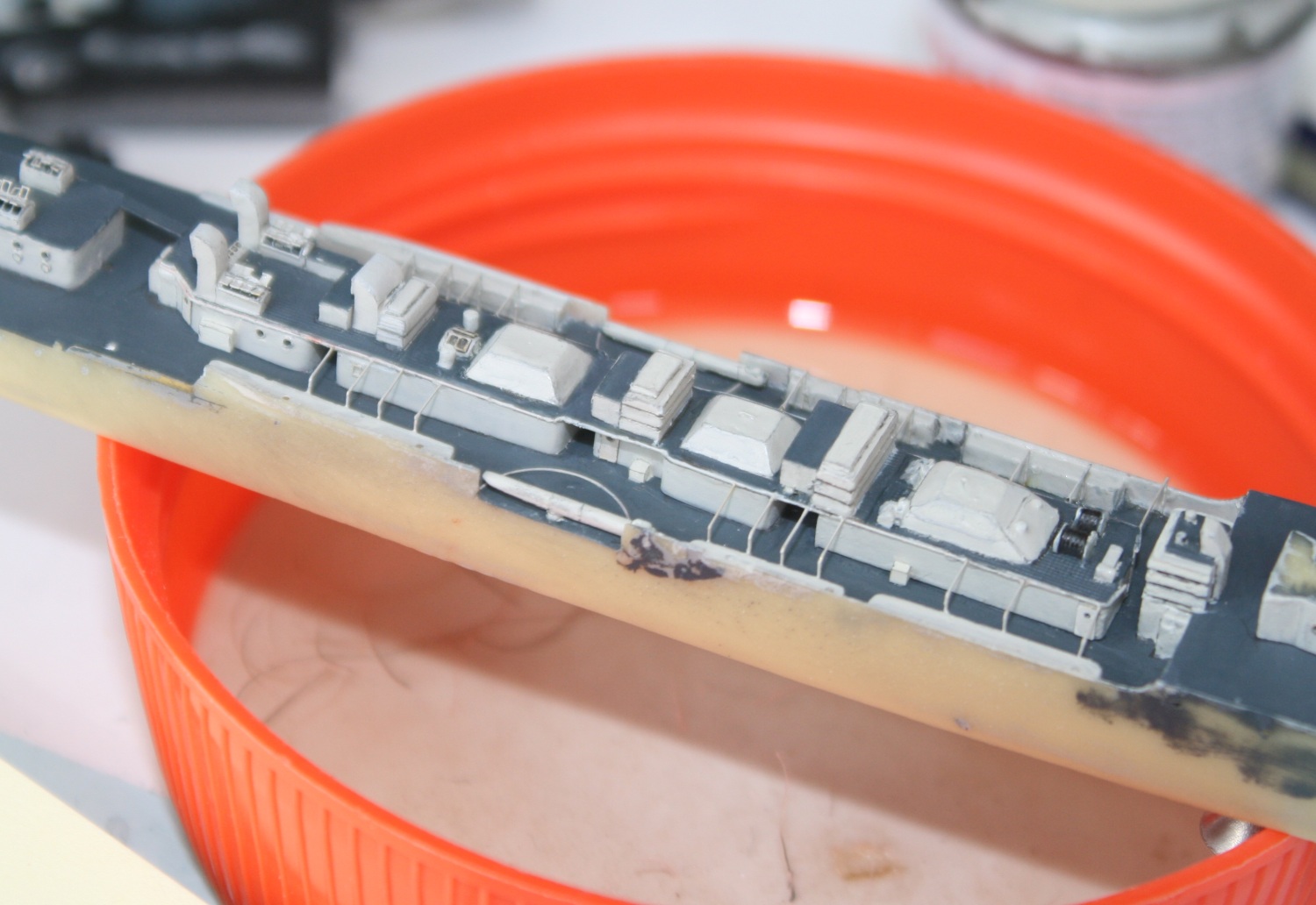

progress is slow--but steady-- mainly because almost everything from the kit is either wrong or coarse
so all replacements have to be constructed from scratch or adapted ...
the boat support skids were made of 1/350 handrail adapted and cut--with the sharp corners being clipped -so that when painted it gives an impression of the out-board corner having a small round on it.

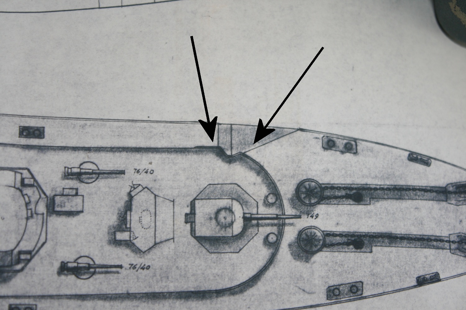

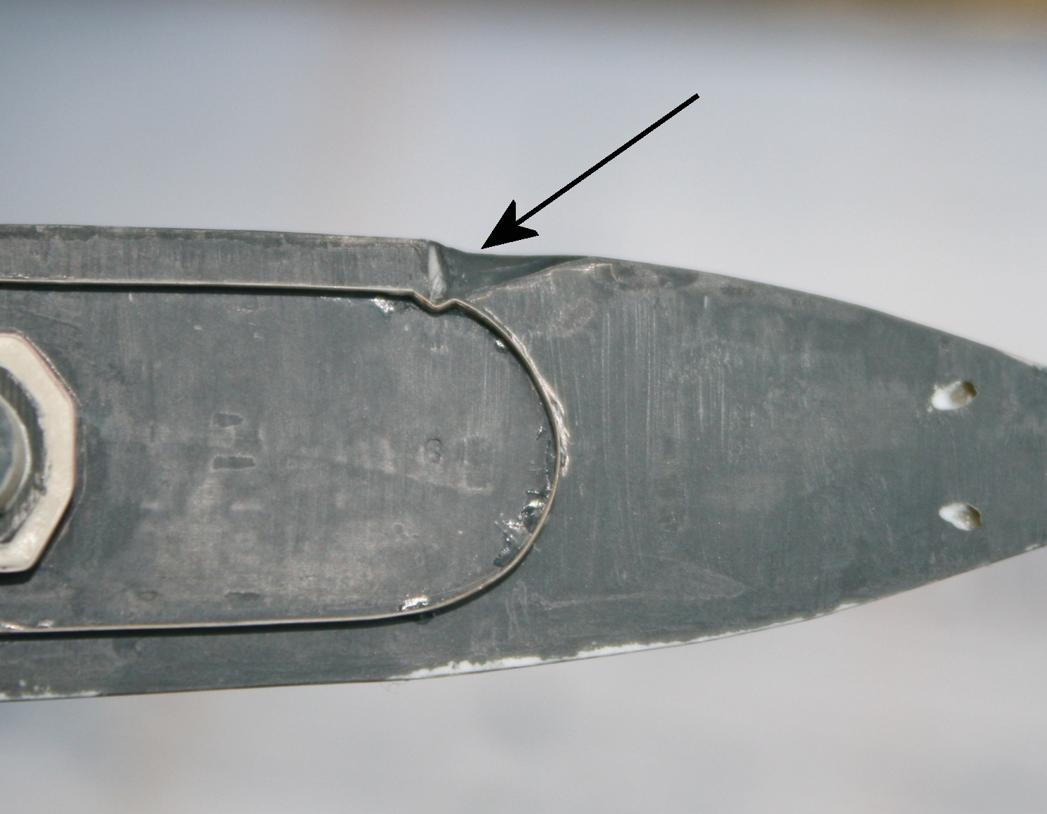

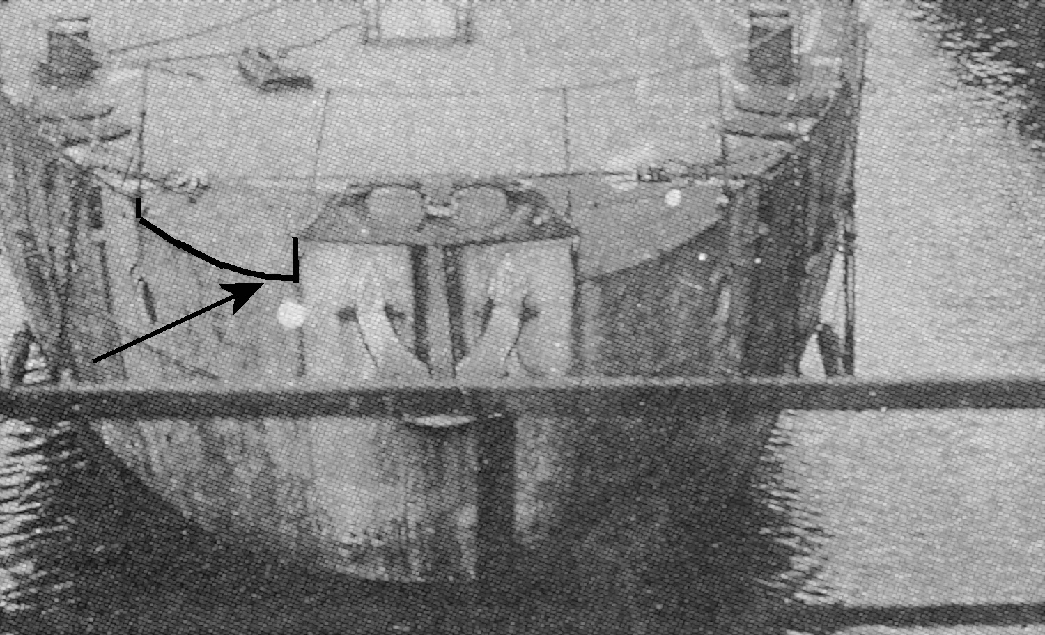

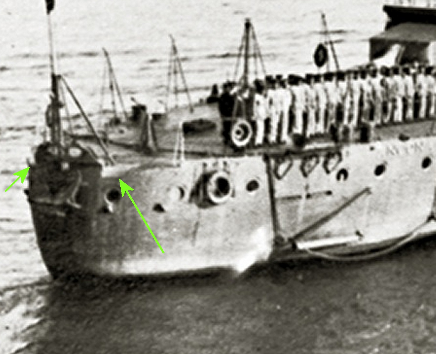

at the stern there is a tall central fairlead with the sides of the aft deck being cut away downwards
--tricky to read off the drawings
but can be seen in photos
I clipped these out using a blade

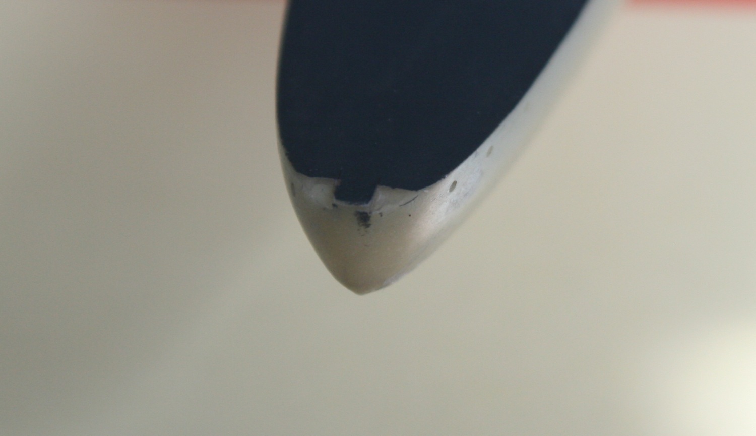

once the ship is mounted I shall install a stern anchor and create a false hawsepipe lead and plate the area below the fairlead
I also cut and shut my lovingly constructed brass breakwater so as to accommodate the port side bow cutout

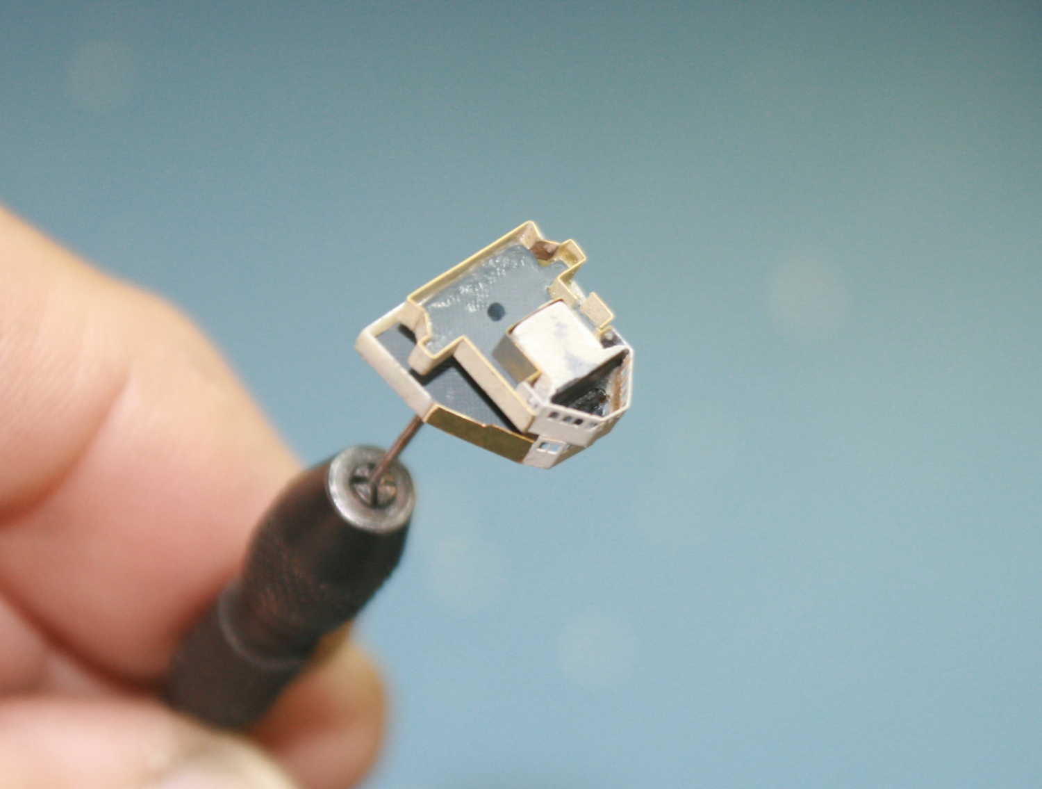

The guns in the kit are nothing short of un-usable... being solid--when they should be hollow steelplate
PE would be ideal in this instance...
perhaps in an attempt at mitigation on their part... :big_grin: ...
--in German service the turrets often had a canvas sheet on them covering up the back...
but still...!...
infuriatingly they are reasonably correct in outline-albeit a bit low-
- leaving on the casting carrier film and cutting around them pretty much corrected this
so the only feasible way of making these reasonably acceptable was to hollow out with a small motor-drill .
and the only way I could fathom to this by clamping them securely was to hold the turrets tight using a squishy but firm medium so as not to collapse the the then thin and fragile resin walls...
was by holding tightly in my thumb and forefinger of left hand-- !!! -- a couple of punctures from the drill bit in the skin of these digits seemed a fair price to pay for 8 x hollow turrets....(?!)
BEFORE
with a hollowed out turret as comparison
Once the bleeding stops I will update further! :big_grin:

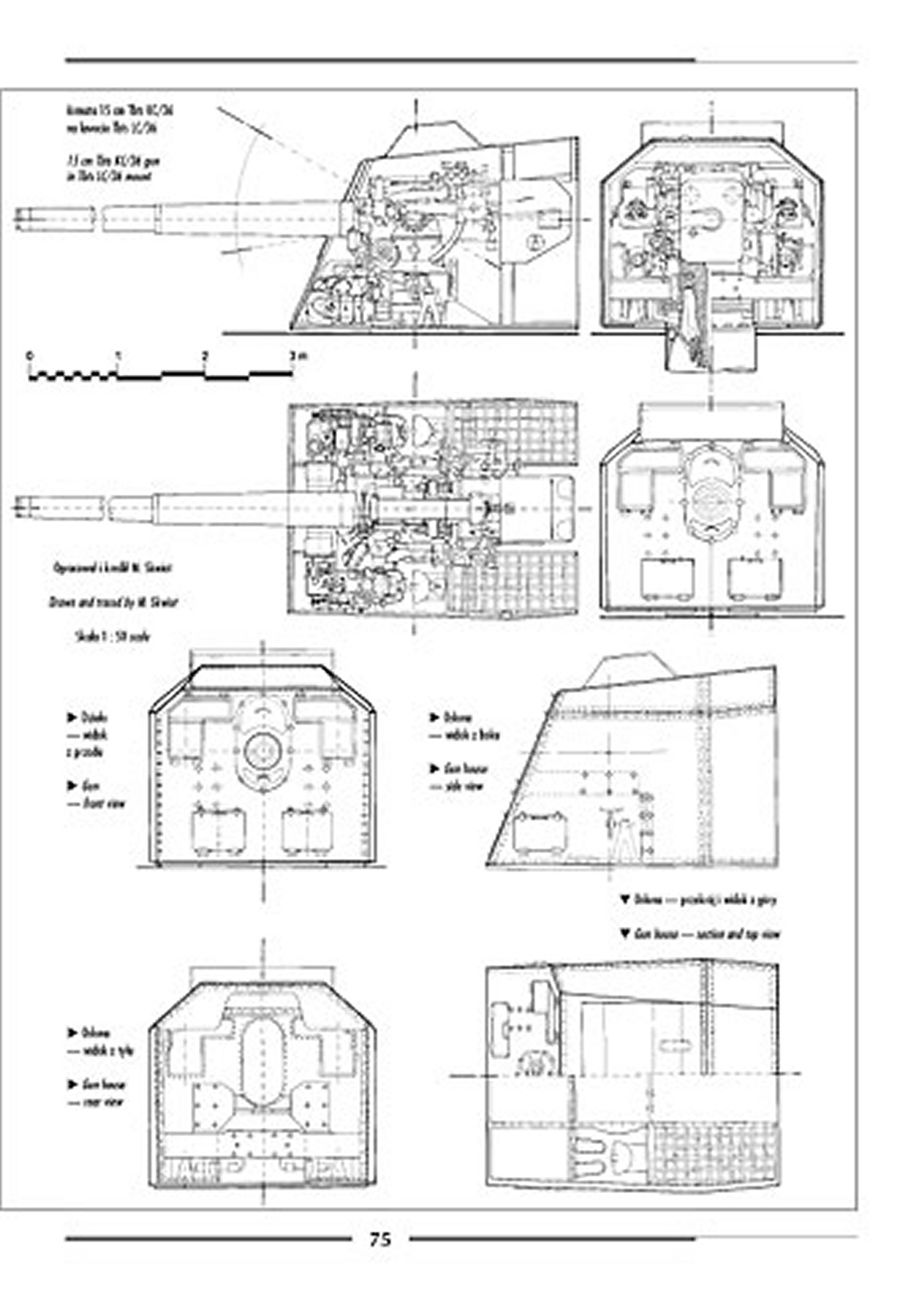

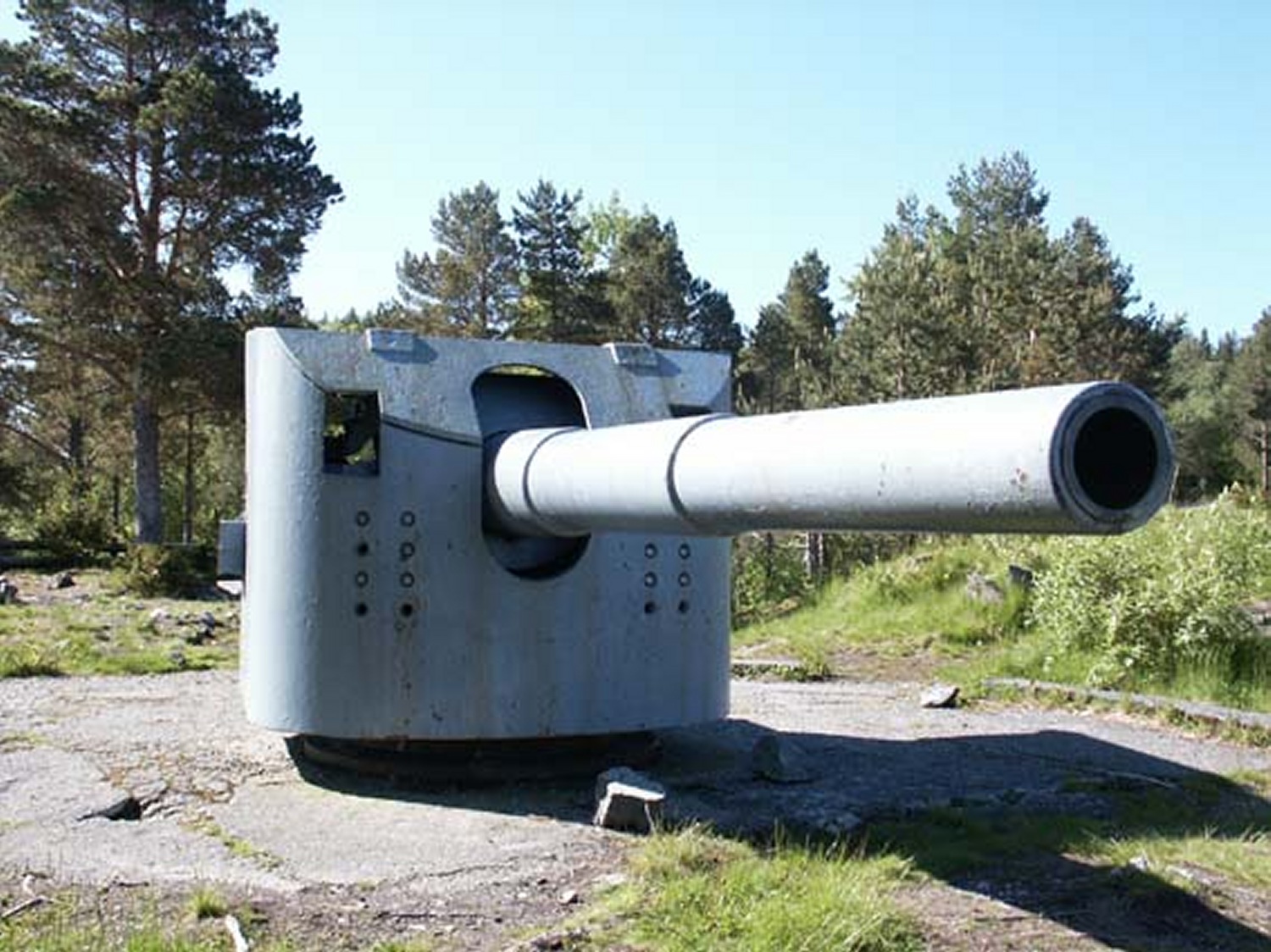

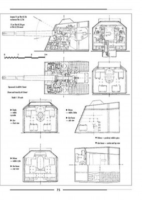

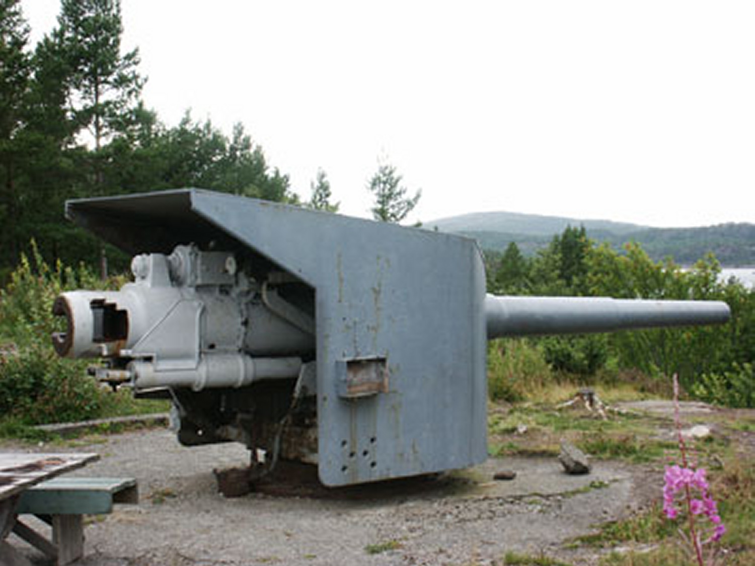

do you have drawings of the 15 cm guns?
JIM BAUMANN
Posts: 5689
Re: Regia Marina - 1/700 Ancona - (ex SMS Graudenz )
Post by JIM BAUMANN »
Only this drawing--though compared to the images it is the wrong Mk of gun house
( the roof profile is wrong
Ancona / Graudenz did not have the cut away side shields like this--but I think the remainder is the same ...?
As a result I think this is an image -part of a series of seemingly tempting renderings ...--are alas of dubious value in a variety of ways
maxim
Posts: 3993
Location: Bonn
Post by maxim »

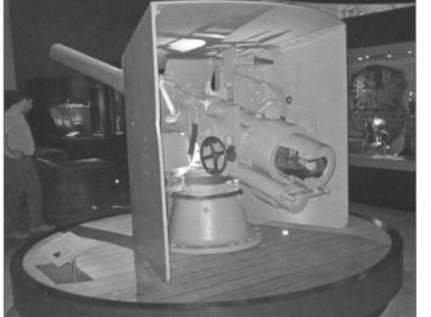

The drawing appears to show a World War Two mounting, the photo could be one of Emden's 10,5 cm guns.
Here is a drawing of the gun Graudenz had:
The shield was without this cutaway part, more similar to this one:
(but exactly this gun was only on Dresden II; there was a third type of 15 cm guns on German WW1 light cruisers, the C/1916, which was on L�beck, Kolberg and C�ln)
/edit:
The photos of the 15 cm guns are probably C/1914, the same ones as Graudenz had, but with a different shield.

Here one of Frankfurt's guns:

Interesting cut-away at the lower end of the turret--
but truly a clear and most helpful image of the innards !!
I shall try and make a fair representation thereof!
note that those cutaways seem to be absent on Graduenz / Ancona
luckily my model is in 1/700 and not 1/100 eh! :cool_2: :thumbs_up_1: :big_grin: :wave_1:

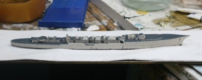

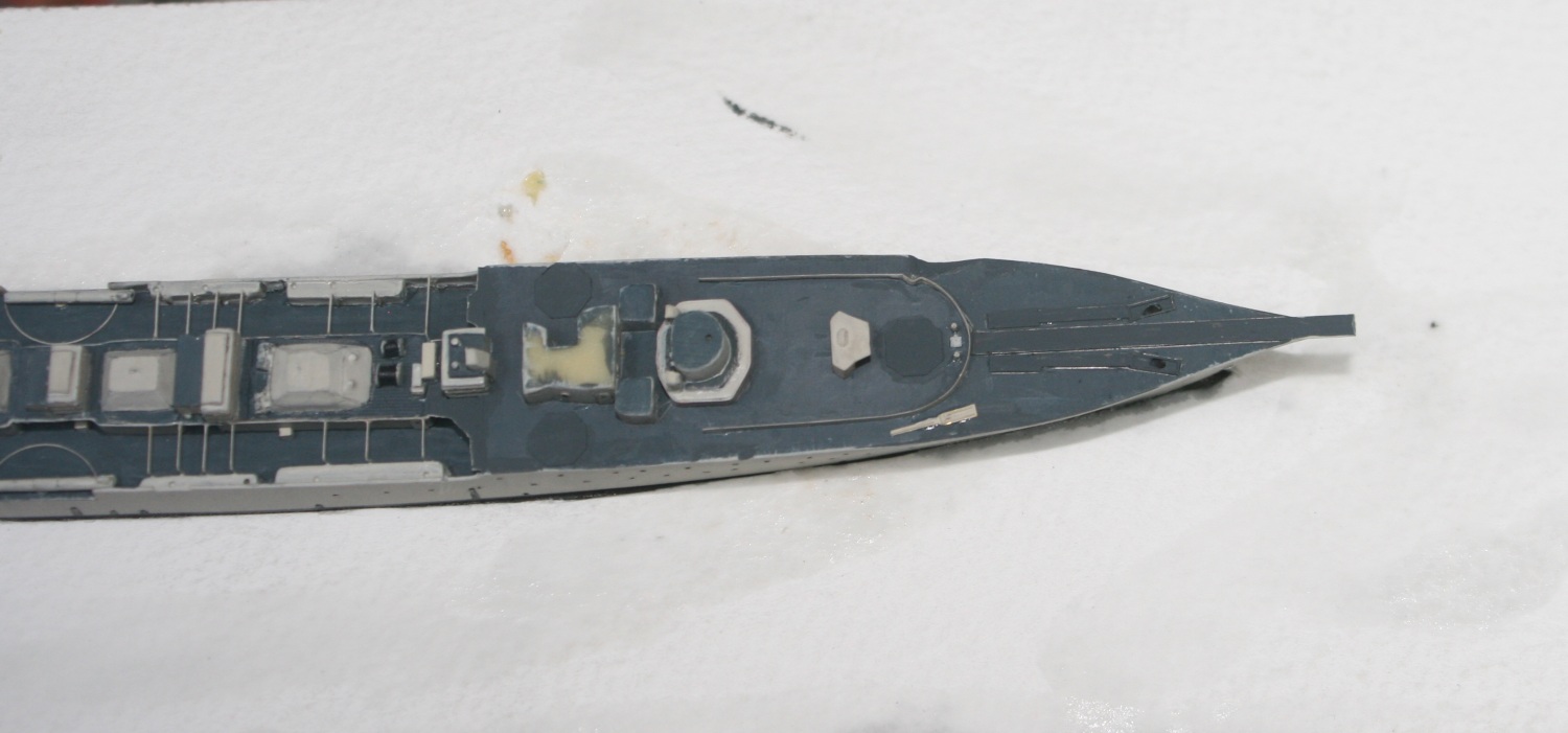

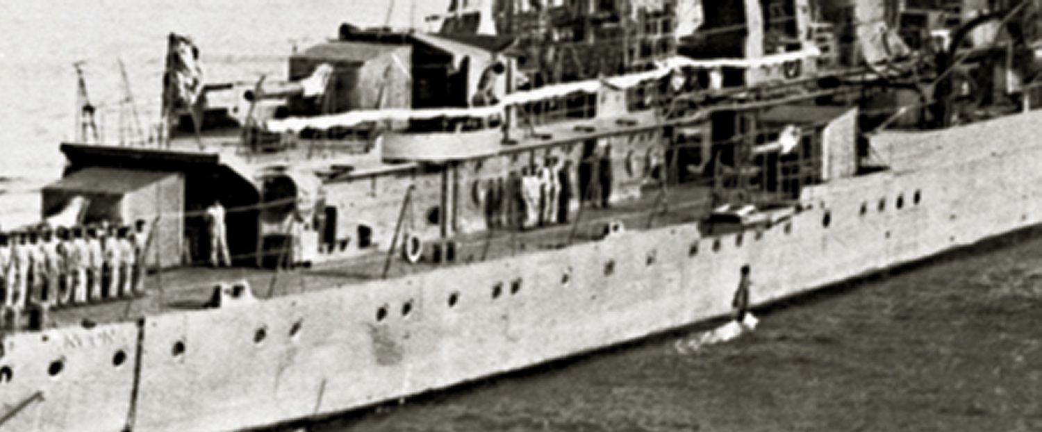

fuhrer small steps -- but giving tangible progress!

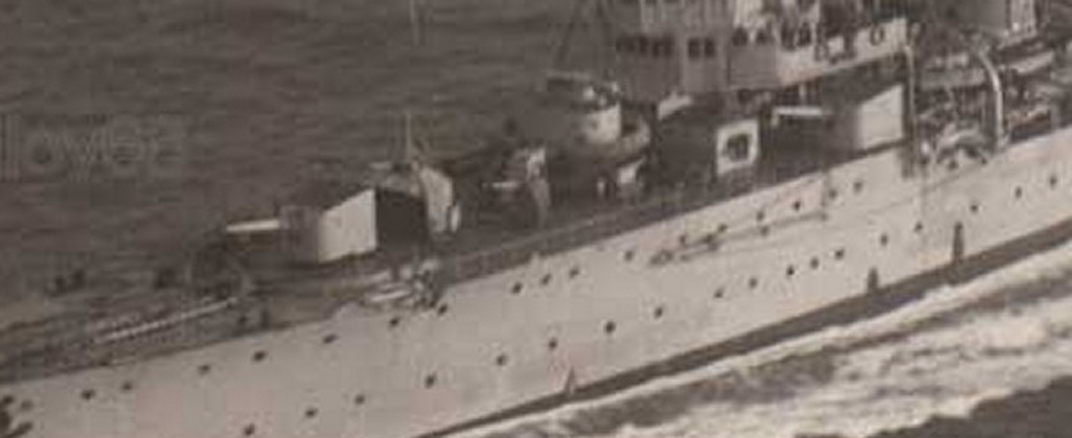

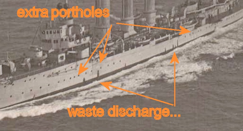

Painted the hull- then realised that it needed more portholes ( not shown on the plan !)
but are easily seen seen in the overhead photo--which gave me a fair chance of getting them in about the right place- :cool_2:
Also added the waste discharge apertures with their staining streaks
the real thing...
( were these areas painted black to disguise the staining --as on
the French battleship Bretagne ..?()
see my model from way back here--they actually made a feature of the area !! )

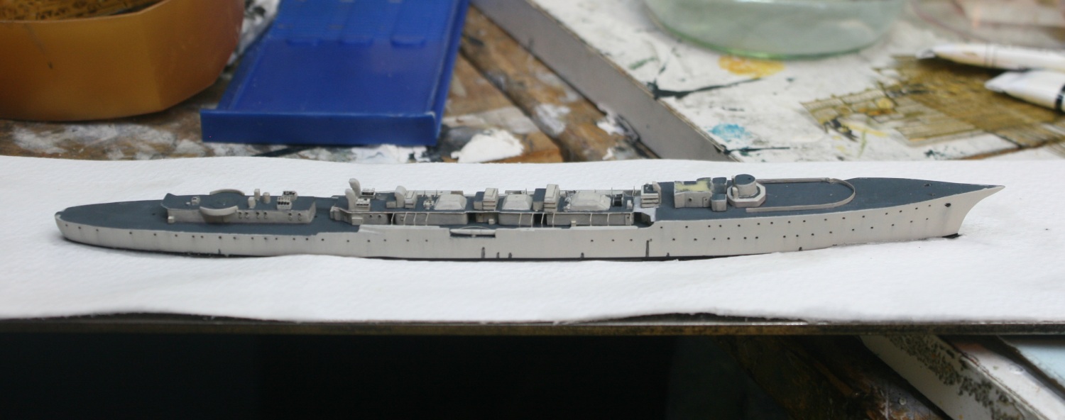

after a bit of very gentle streaking ,
the Boot-topping was applied using black decal strip
and at last... the ship was mounted in her sea...
Phew!!-- mile stone reached
this makes her a lot less delicate to handle and means I can now concentrate on outfitting the decks...

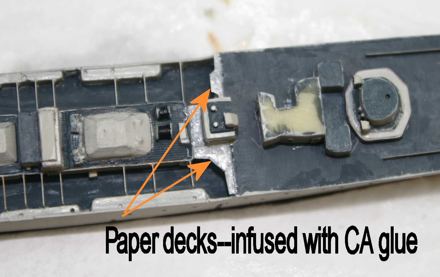

At the end of the foredeck step the decking was made of CA soaked Paper--thin and malleable!
The chainways and catapult base was made of strips of brass

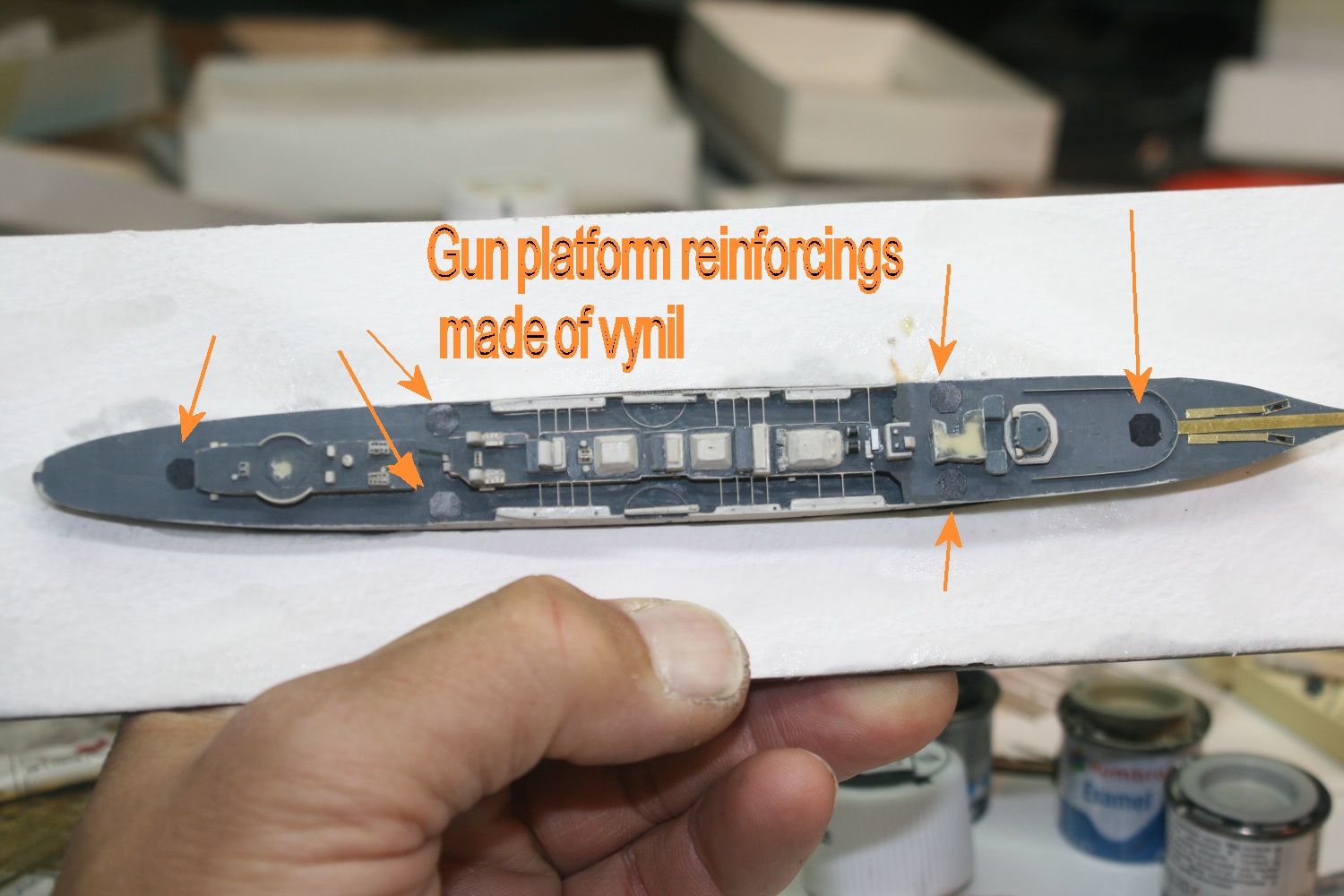

and a very bothersome aspect was dealt with--the gun reinforcing plates- which were horrible on the casting...
but were all chiselled off when I made the decks steel (!! )
These made of vinyl squares with the corners clipped
after paint it all looked rather less garish... :cool_2: :thumbs_up_1:

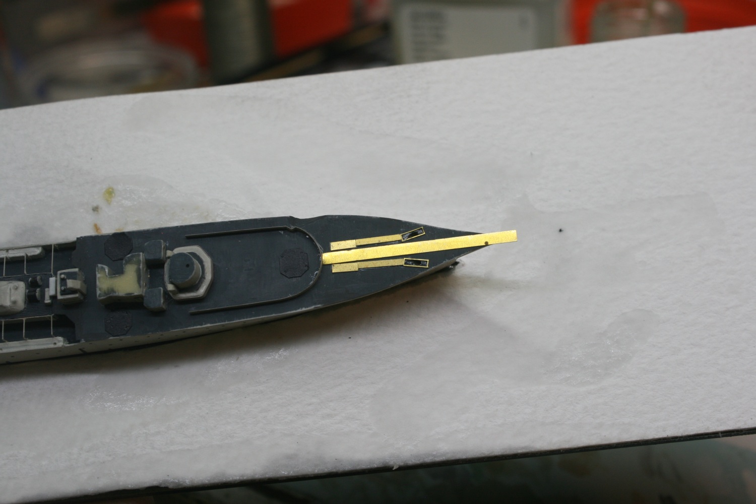

now onwards with the catapult rails...
:wave_1:

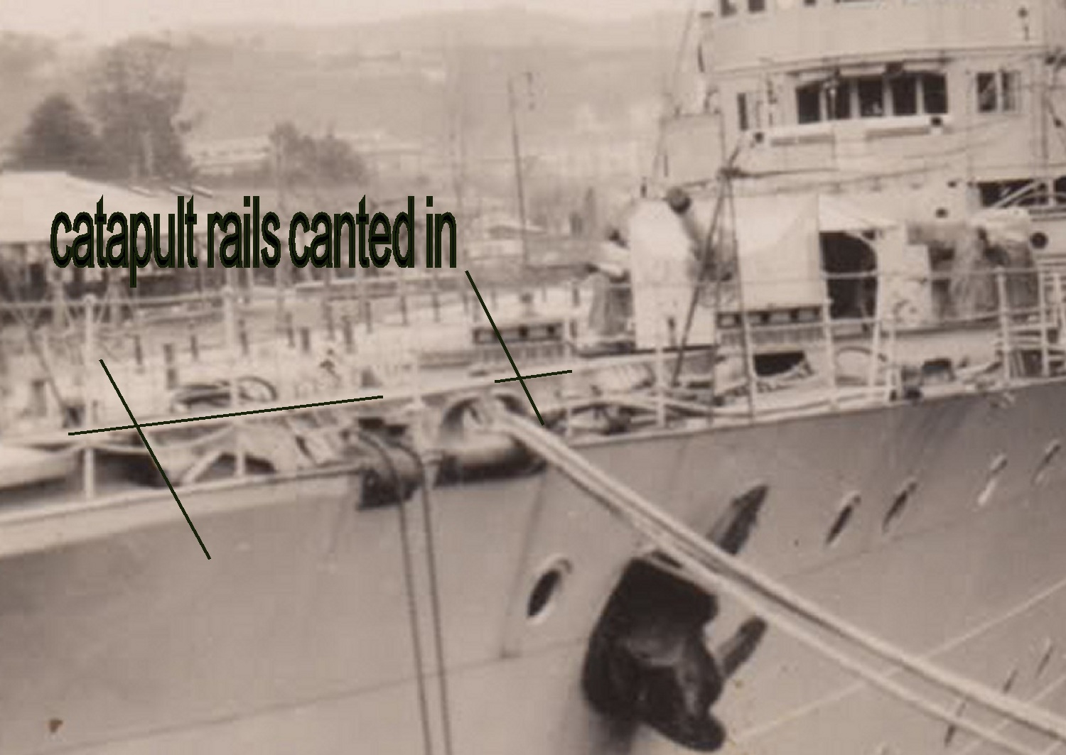

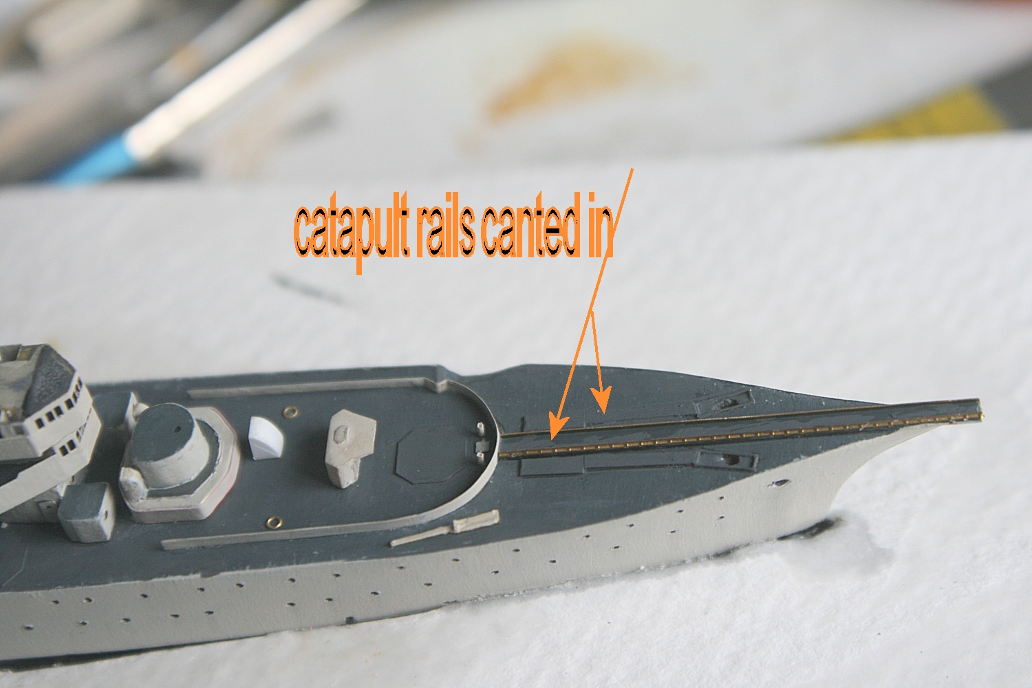

@ Marjinn Not yet sure about the float-plane--it was not often carried and makes the ship loom clumsy

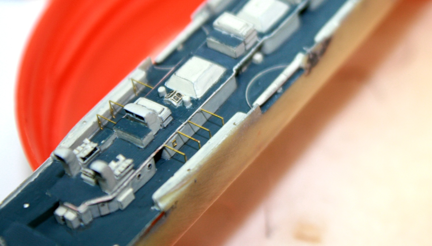

...meanwhile the catapult rails were presumably upright--and had sloping gussets to support
see below the only usable photo I have found of the catapult track
I decided I would not live long enough (! :heh: ! ) to replicate it accurately or indeed repeatable and consistently fine..
and in any case it only a bit of a guess-( anyone have a better photo..?
-but the track sides needed some texture
I used some WEM KGV 1/700 degaussing-cable PE-- suitably cut down with the brackets removed
the effect is quite pleasing (to my eye) and will looks quite delicate
I shall next install some fine styrene square strip in the inboard sides to fill the void

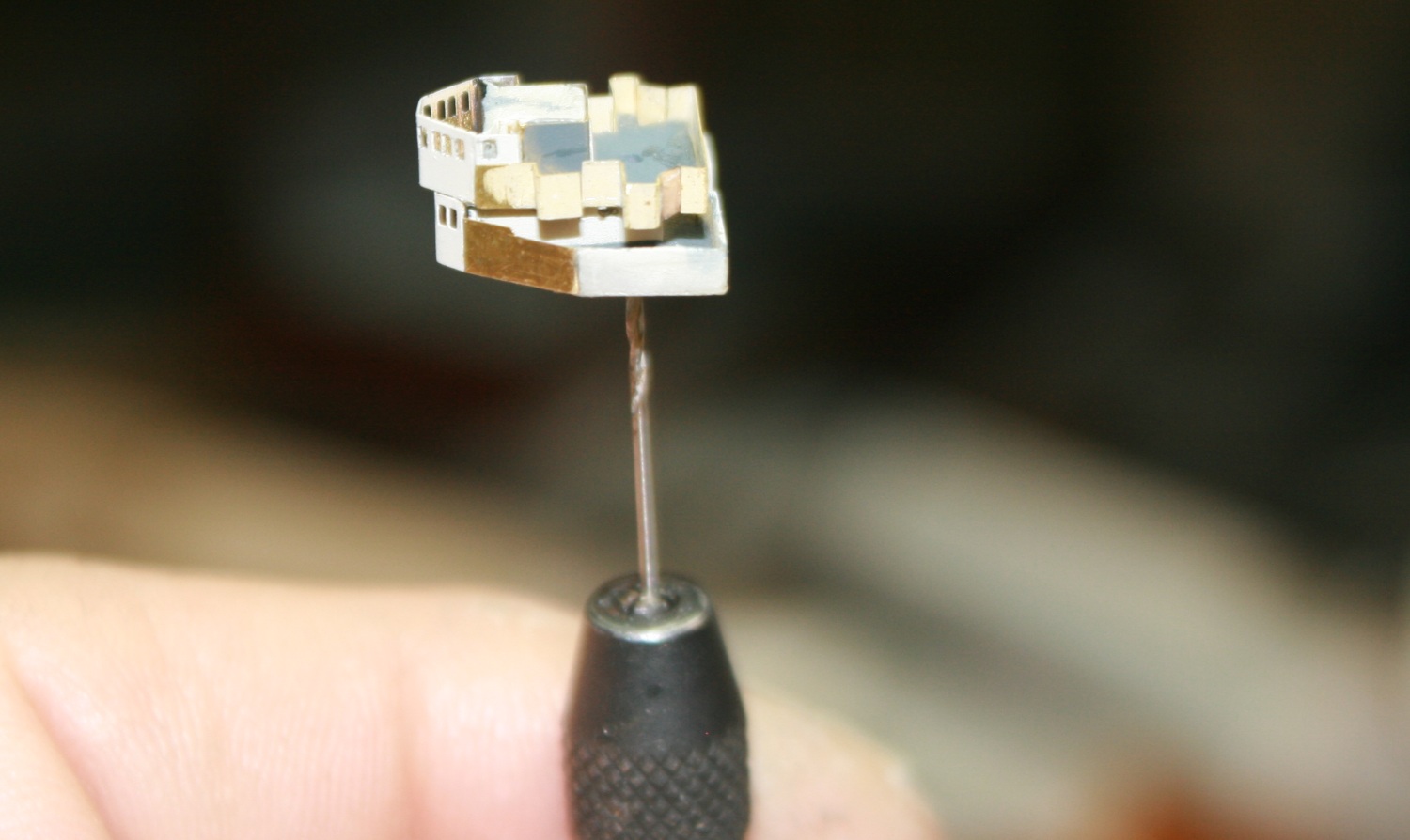

additional small progress as below--and at last fitted the cut and shut bridge structure-- she is starting to look like a ship ! :wave_1:

By the way, the assumption that the hull below the waste discharge apertures was locally painted black is not unreasonable, as the last photo you posted clearly shows other areas painted dark in a similar way.
Marijn
