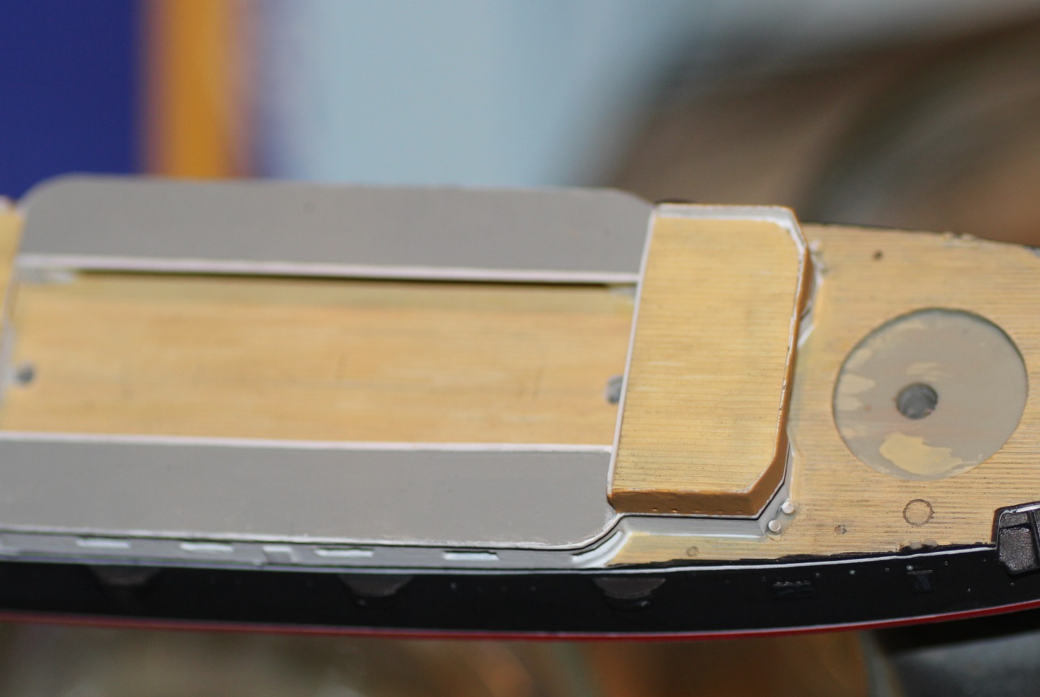

After I had ground away all the solid resin on the spar deck--including the solid fwd and aft decks ( as they should have been planked not flat )
I needed to replace the decks. However as the bulwarks were the correct height in relation to the rest of the ship, I could not simply 'plonk' evergreen styrene on top of the ledges remaining .... and I did not feel confident in my abilities to lower the existing deck ledge height without damaging or even scarring / breaking entirely the delicate bulwarks...
So I concocted a- I think- acceptable compromise. :wave_1:

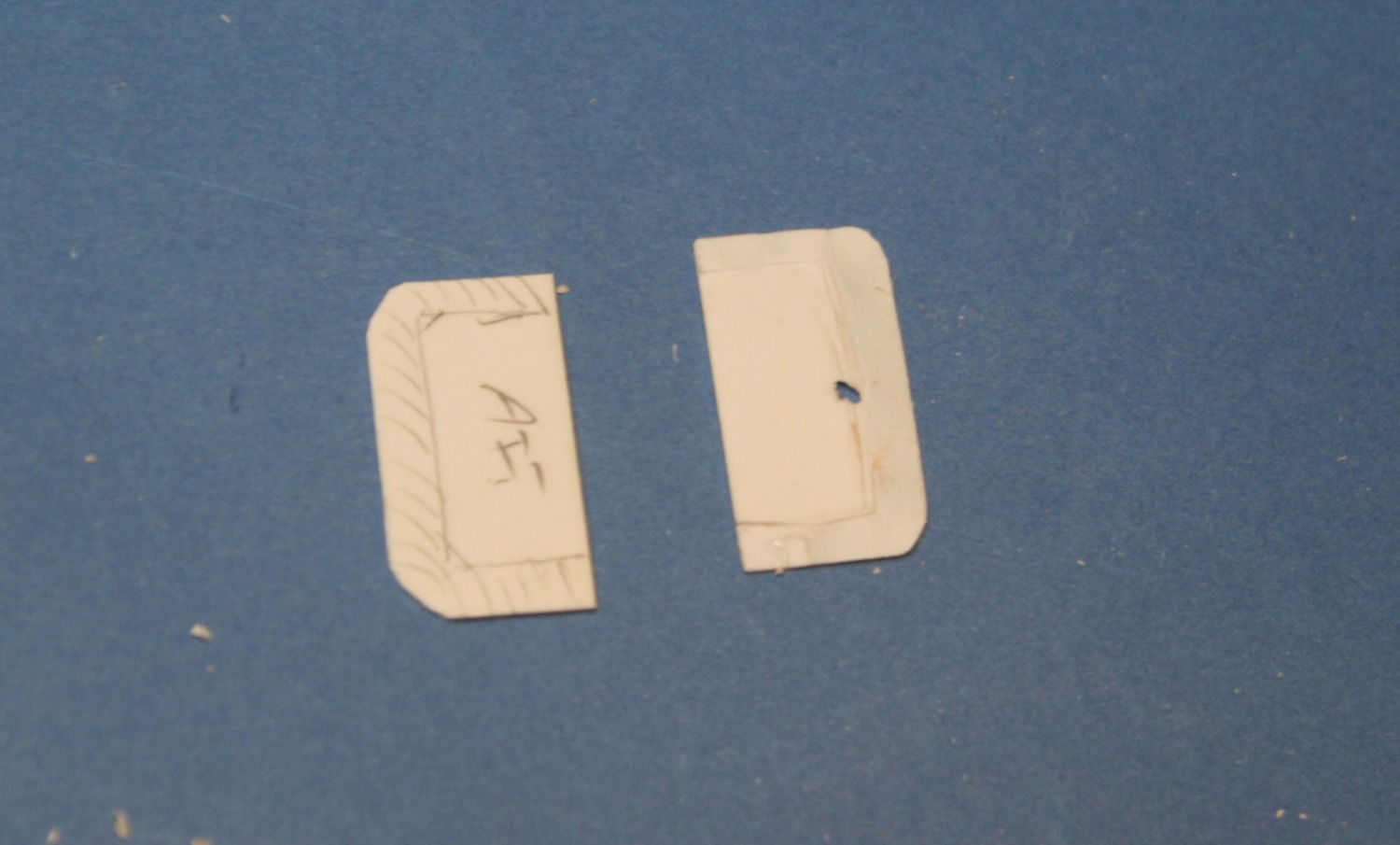

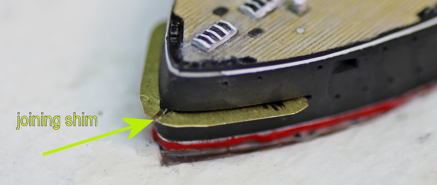

I cut some new decking of Evergreen planked styrene sheet and marked a line inboard of the landing surfaces of my somewhat freestyle cut ledges

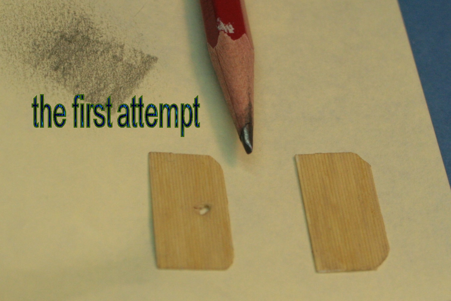

The paring with a blade was tortuous affair--as the styrene often failed at the planking grooves
so I had a practice at paring away to a wafer thinness before I cut a deck for real. ( successfully!)
Even this I managed to do twice though my own lack of observation... :doh_1: :Oops_1:
The upper bridge platforms were planked across the vessel rather than the usual fore-and-aft orientation
however these deck levels were still planked fore/aft...
My folly is pictured below :cool_2:
At least hereafter I was practised (!! ) and in a much shorter time than before ..
I was able to make two more decks with the planking running correctly.
When I added the decks and temporarily placed a 1/700 PE figure I reckoned that the deck should still be just under one millimetre lower...
( the resin deck was too high in the first place I think )
I decided to pare the deck ledge away --but at an angle inwards- very carefully indeed with tight lips and bated breath (!!) and successfully managed not to damage the bulwarks ( not noticeably so..-after a small repair! :big_grin: )
I then used some 1500 grit emery paper to add a chamfer to the underside of the already wafer-thin deck-edge to hopefully match the chamfered edge of the ledge...
It looks like it worked!

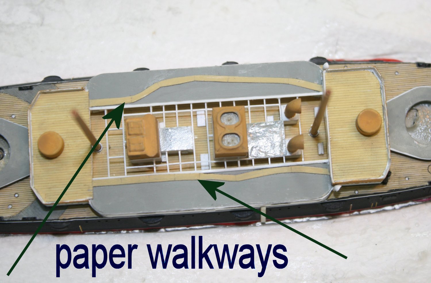

...whilst awaiting the drying of varnish and paint - I made and cut the walkways for the boat-decks; these were made of paper, painted and once dry pressed between many heavy books for two weeks.
I also added the white decal strip to the funnel-cowl housing and generator rooms etc

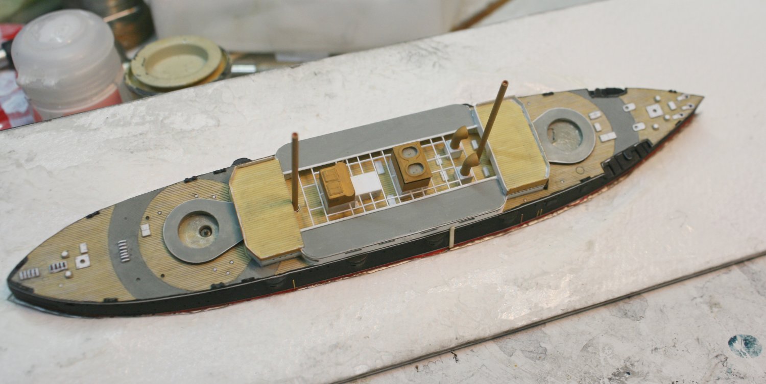

I mounted the ship so as to make it easier to hold and less susceptible to damage
Having detected a minute bit of warping fore and aft-- I used my usual methodology
(described in step-by-step in detail here )
viewtopic.php?f=4&t=37223&p=241196#p241196
and mounted the ship to a stainless steel plate to inhibit future movement--
there no point worrying about the fine details if the hull sheerline changes !!! :Mad_6:

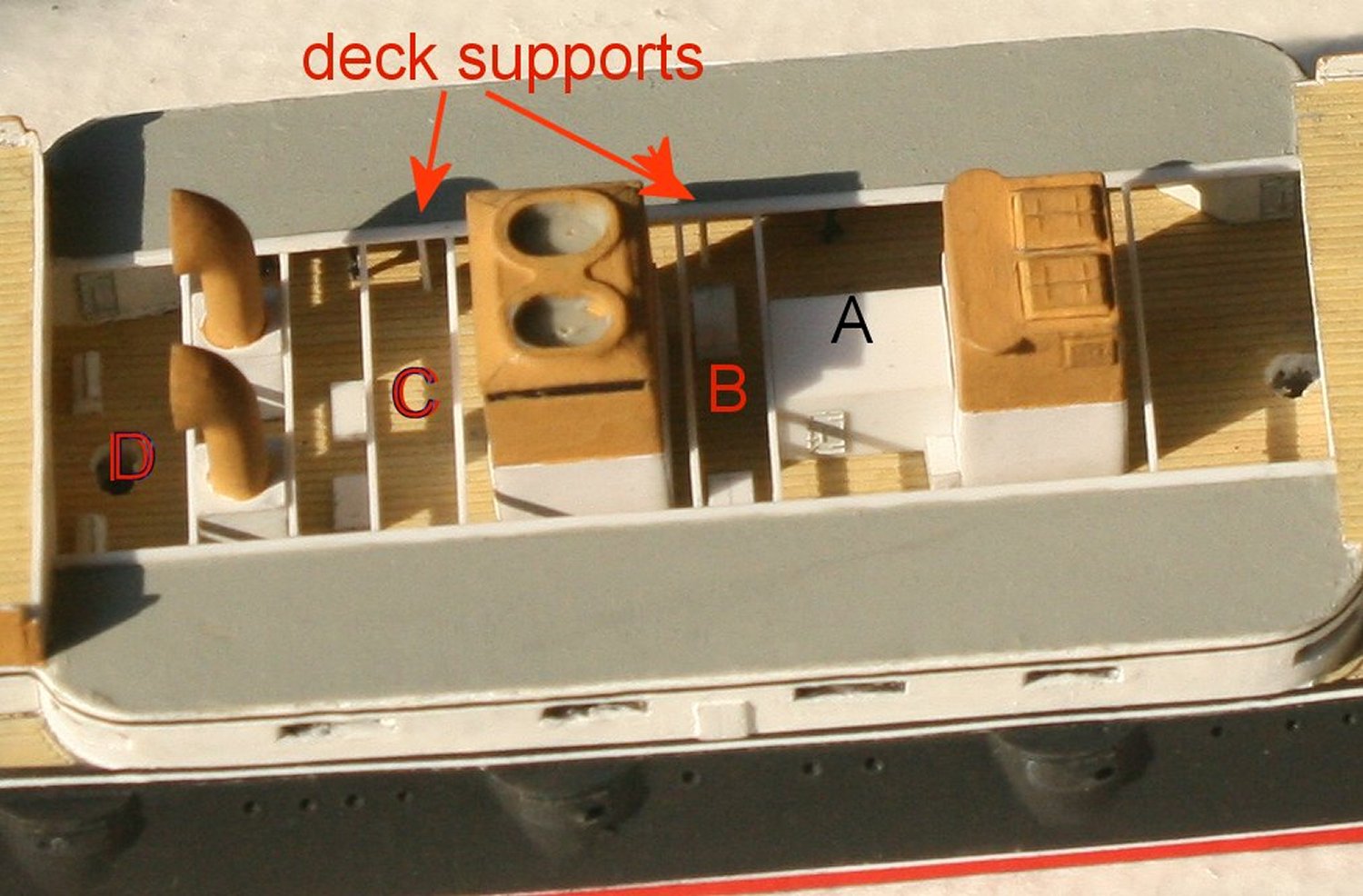

I made the water also in the my usual way using artists watercolour paper over cocktail sticks and then soaked in CA glue to make it rigid and impervious to moisture

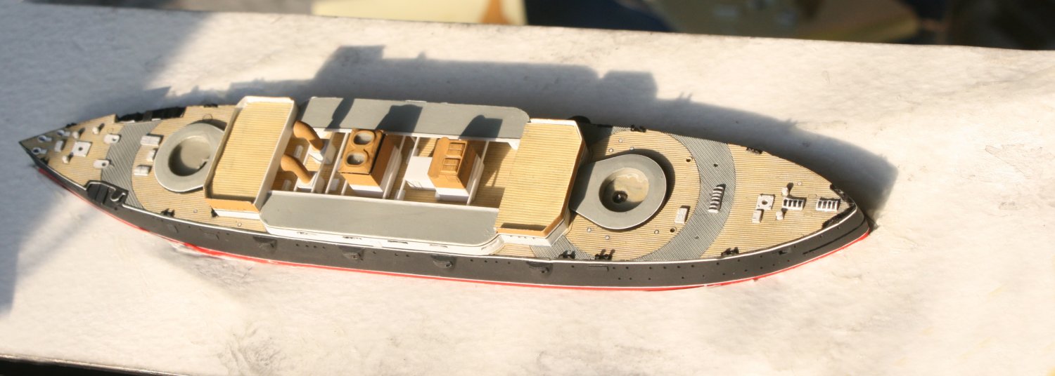

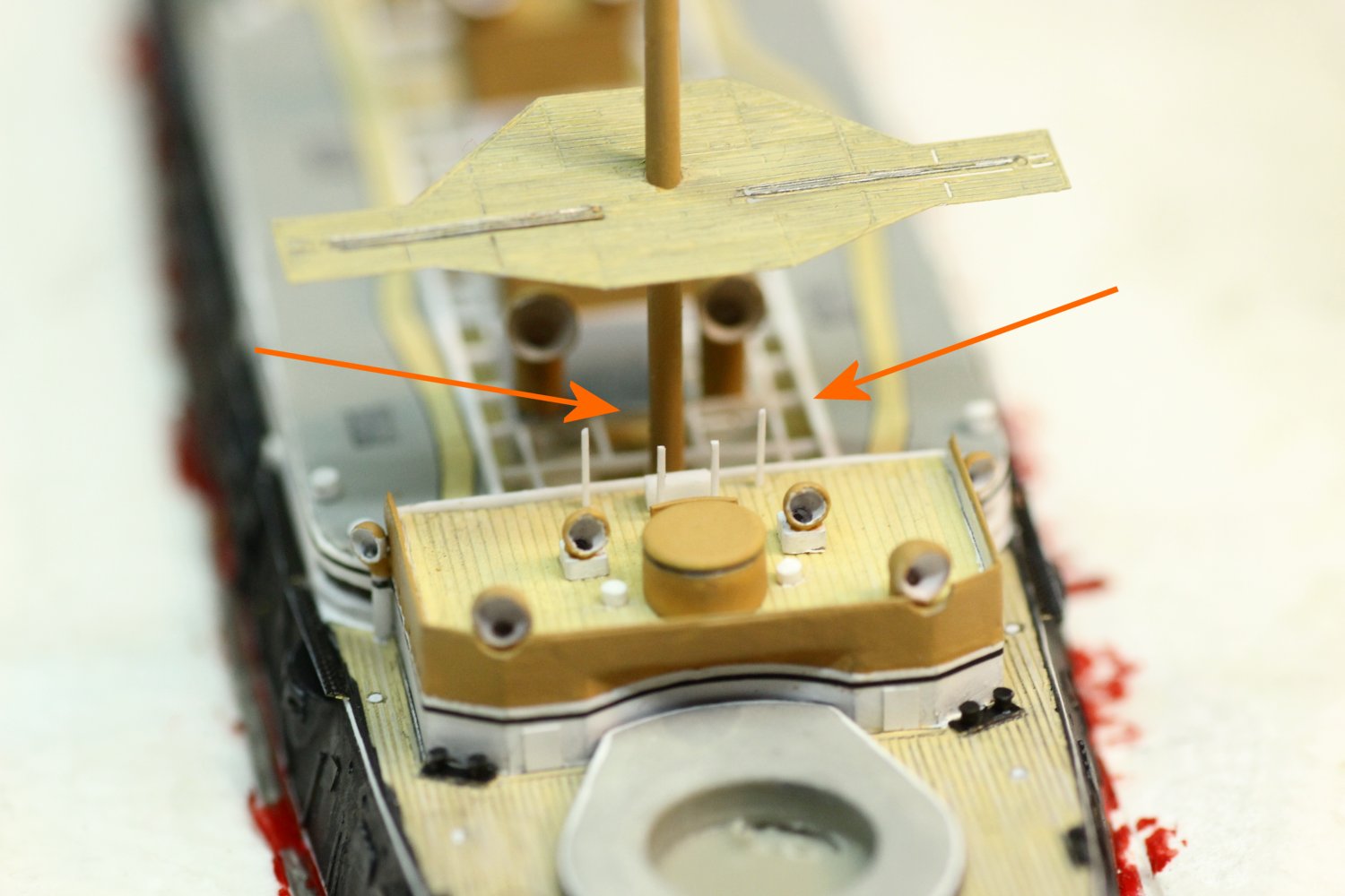

I placed the main structures( funnel base and generator room) onto the spar deck base and added the missing small hatches and skylights
( A B C D )

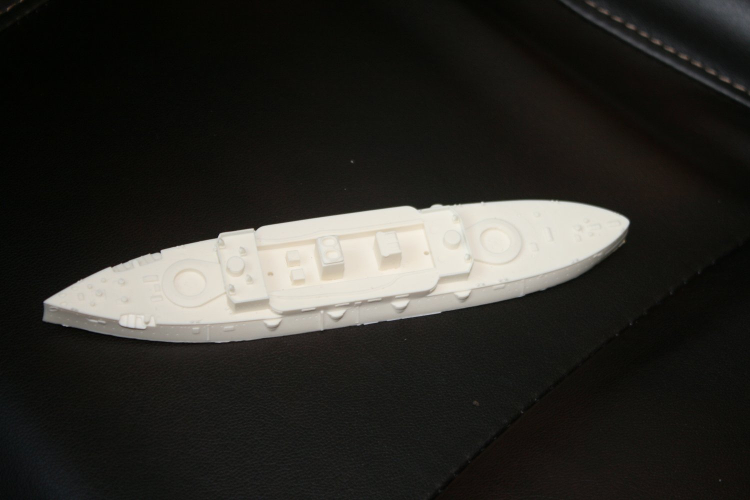

a while back I bought of e-bay a kit of HMS Mars (for the PE ) from a previously unknown-to-me manufacturer ( SS Models - China )
The PE whilst simple - appears to be partially usable--in particular the flying bridge decks and the pilot houses--the remainder I shall discard or scratchbuild
The hull and parts are a fairly obvious re-cast of the Combrig kit-with some parts assembled for the mould
- interestingly everything is about 5% smaller ( pointing to a cast of a kit = submaster etc.... )

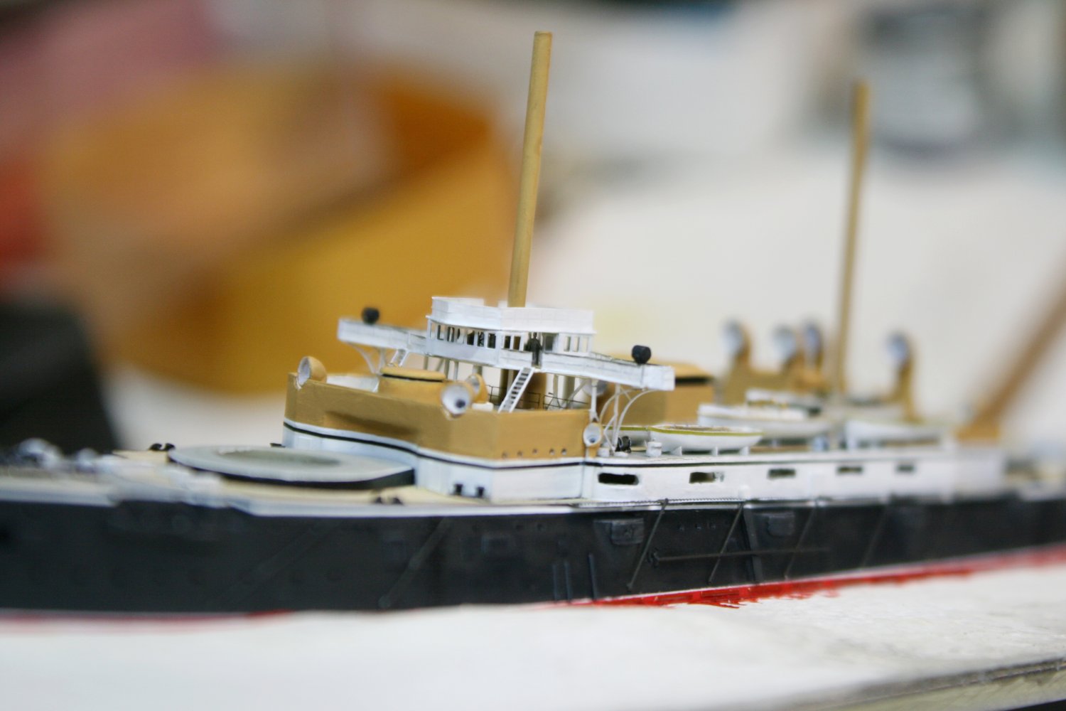

Now comes the more interesting part to me, small details...

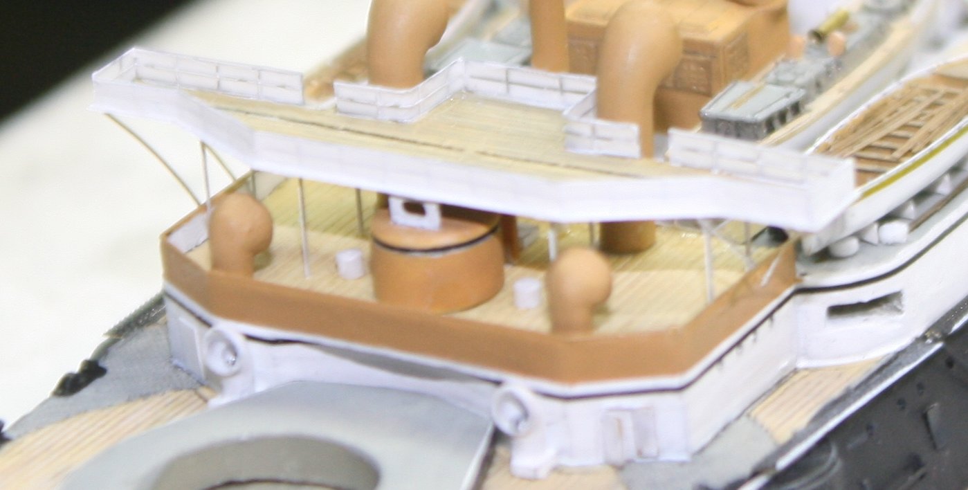

I installed the supporting posts under the boat decks, and have made a start on the very complex boast skid framework.
I am guided here partially by the drawings in the plans as well as some photos of the excellent large scale( 1:96 ) model by maestro Brian King
herewith some images of the staus quo

... really busy at midship :thumbs_up_1: , I like how you kept the sharp demarcation between the different colors

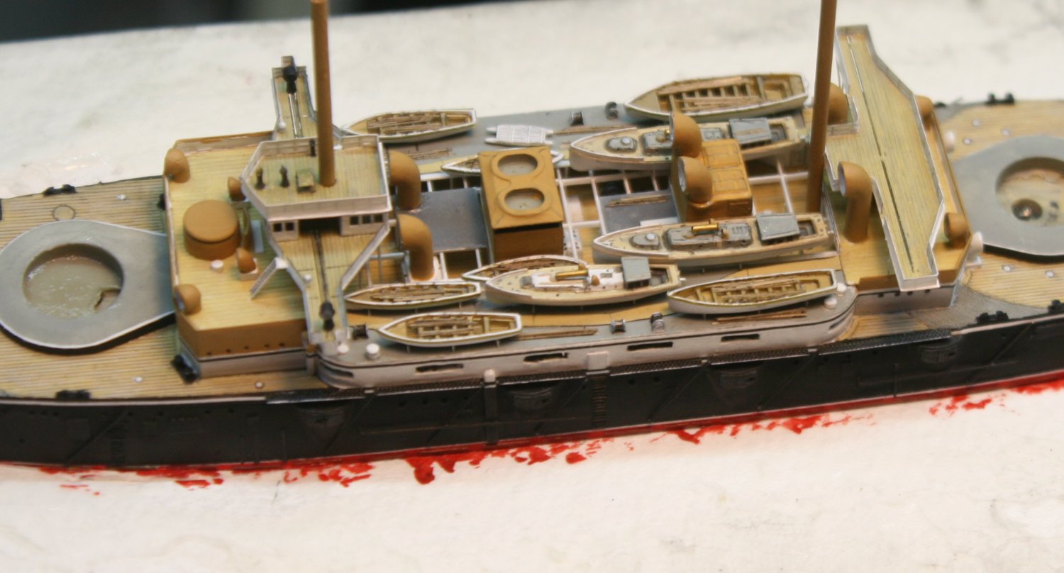

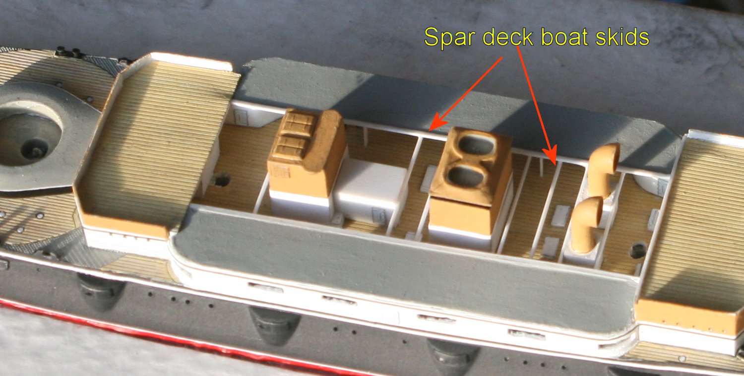

The well -deck boatskids were both more time consuming and fiddly than I thought
...the more I looked--the more there was to add !
here is about where I stopped--
on the real ship these skids were I section beams-
-but failing some custom double-sided photoetch....
.... styrene strip would suffice.
By the time it is all covered in boats the latticework of the boat supports will only be viable in vignetted glimpses
fortunately it also seems that the imperfections of my styrene construct will be --phew!-- obscured by the boats... :cool_2:

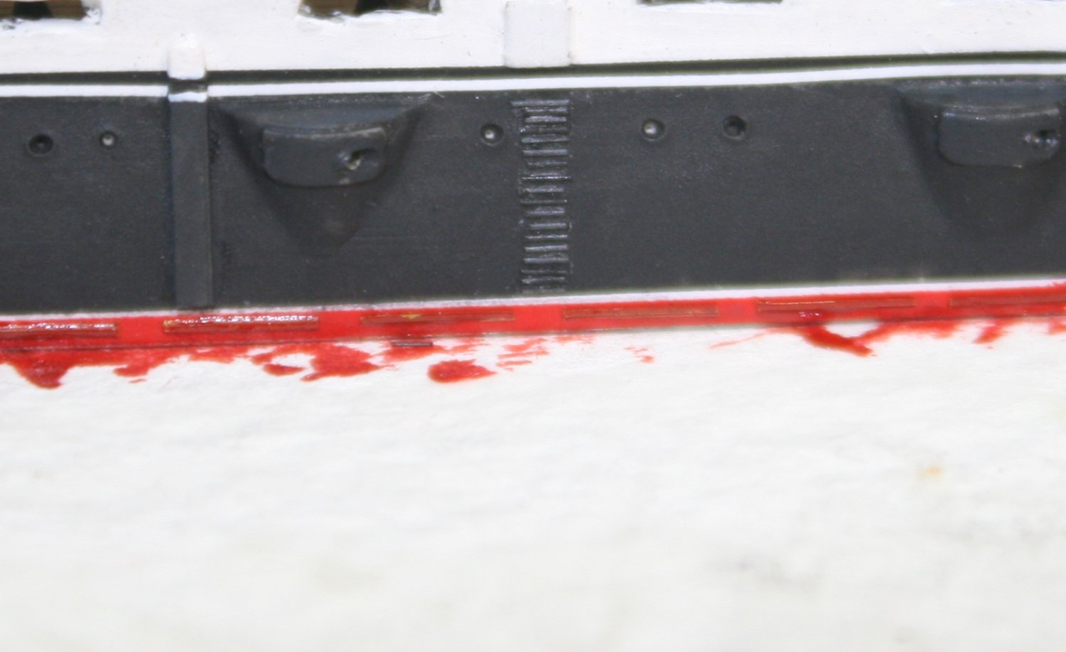

as a bit of light relief I added the 4 x overside discharge pipes and the midships gash chute
these were only slightly complicated by being curved at the lower edges to comply with tumblehome of the hull and a kink at weather deck level
I added the slightly raised boat deck walkways

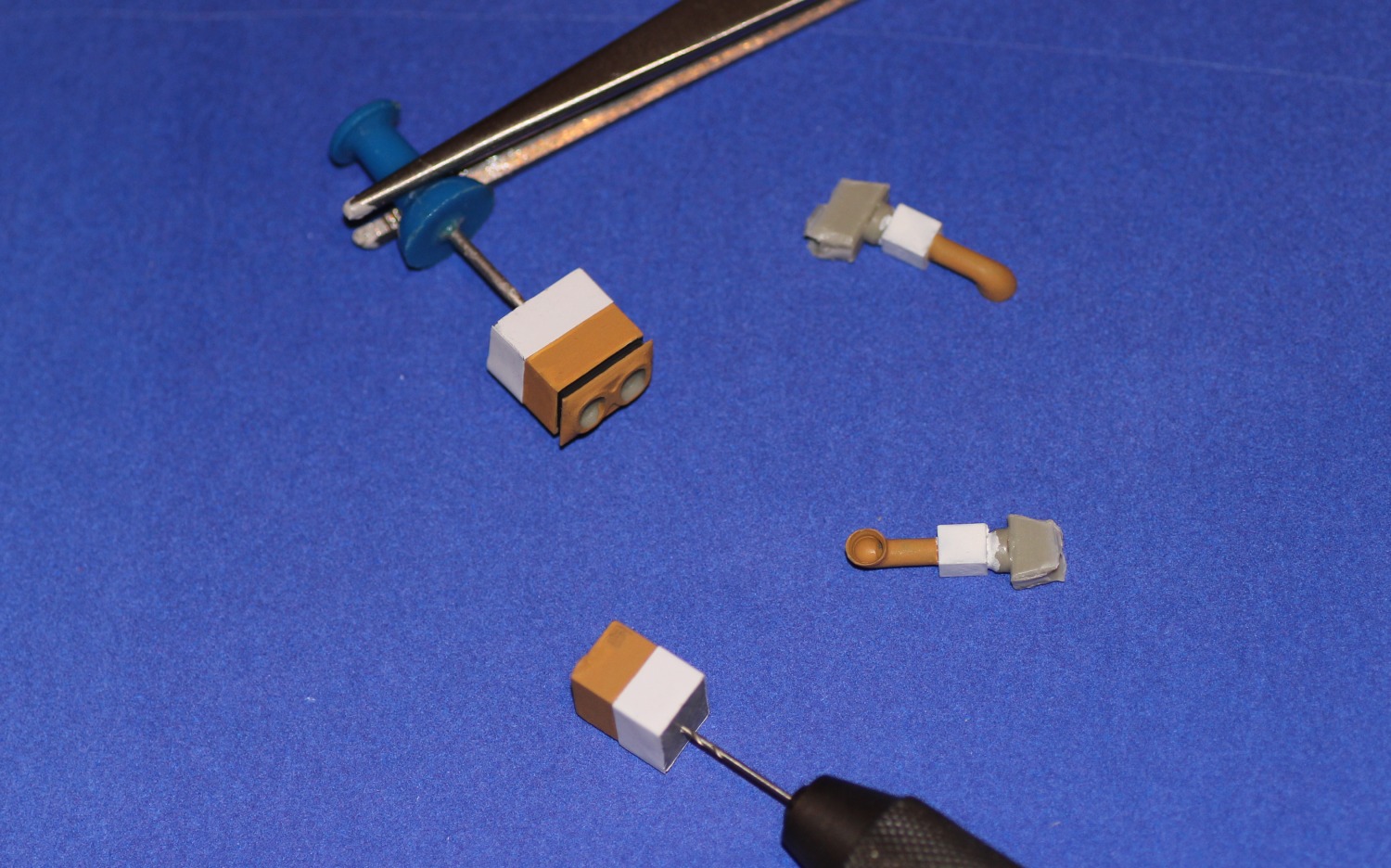

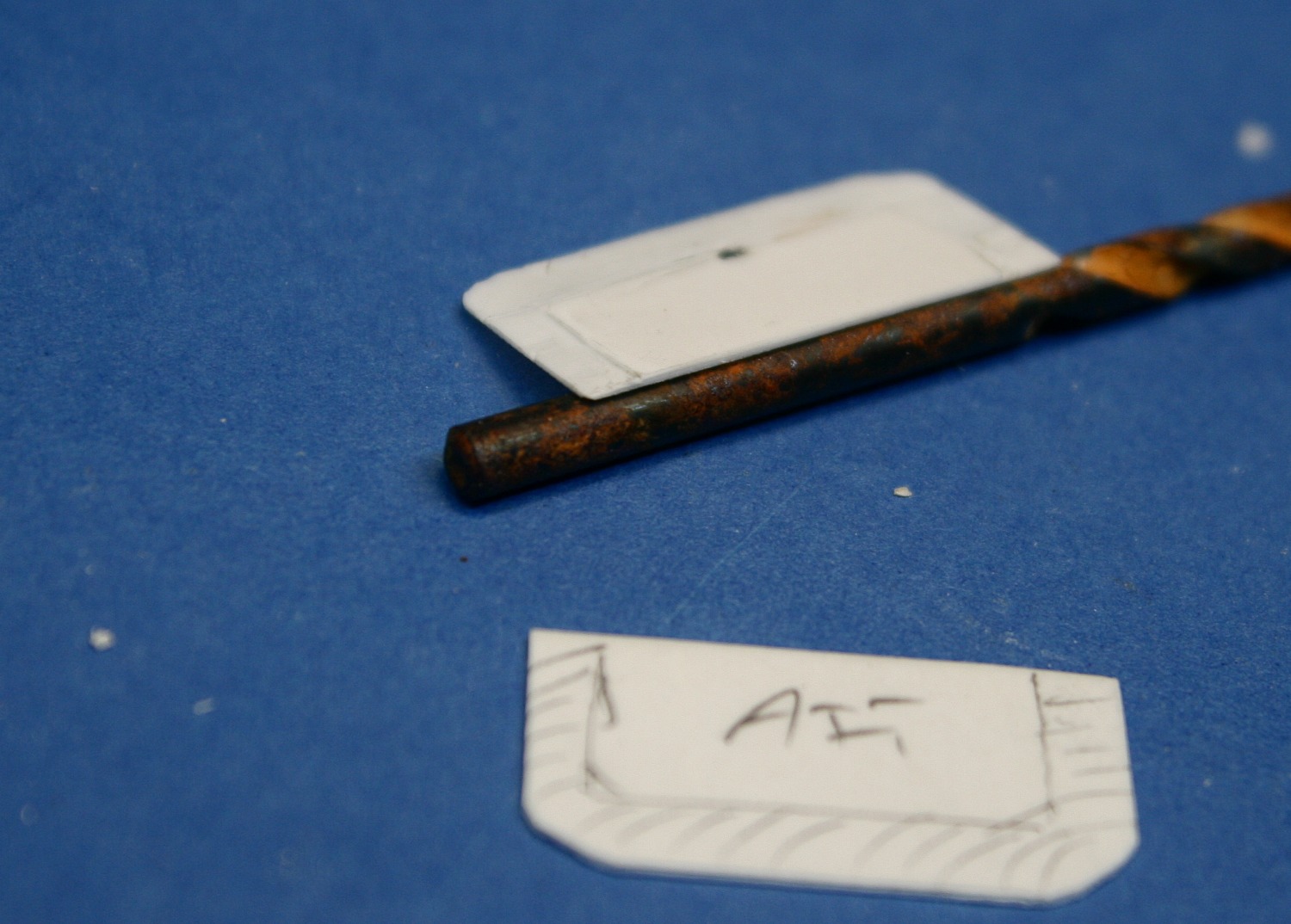

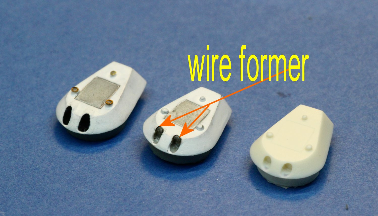

I started to REALLY look at the vents-- most of the kit items are usable--but some are distinctly undersized.
to remedy this I reshaped the back of some plastic vents from a spare sprue ( Seals models IJN cruiser )
and the hollowed them out.-( they were quite crude really)
these I think are dimensionally just about right for the lower fwd superstructure

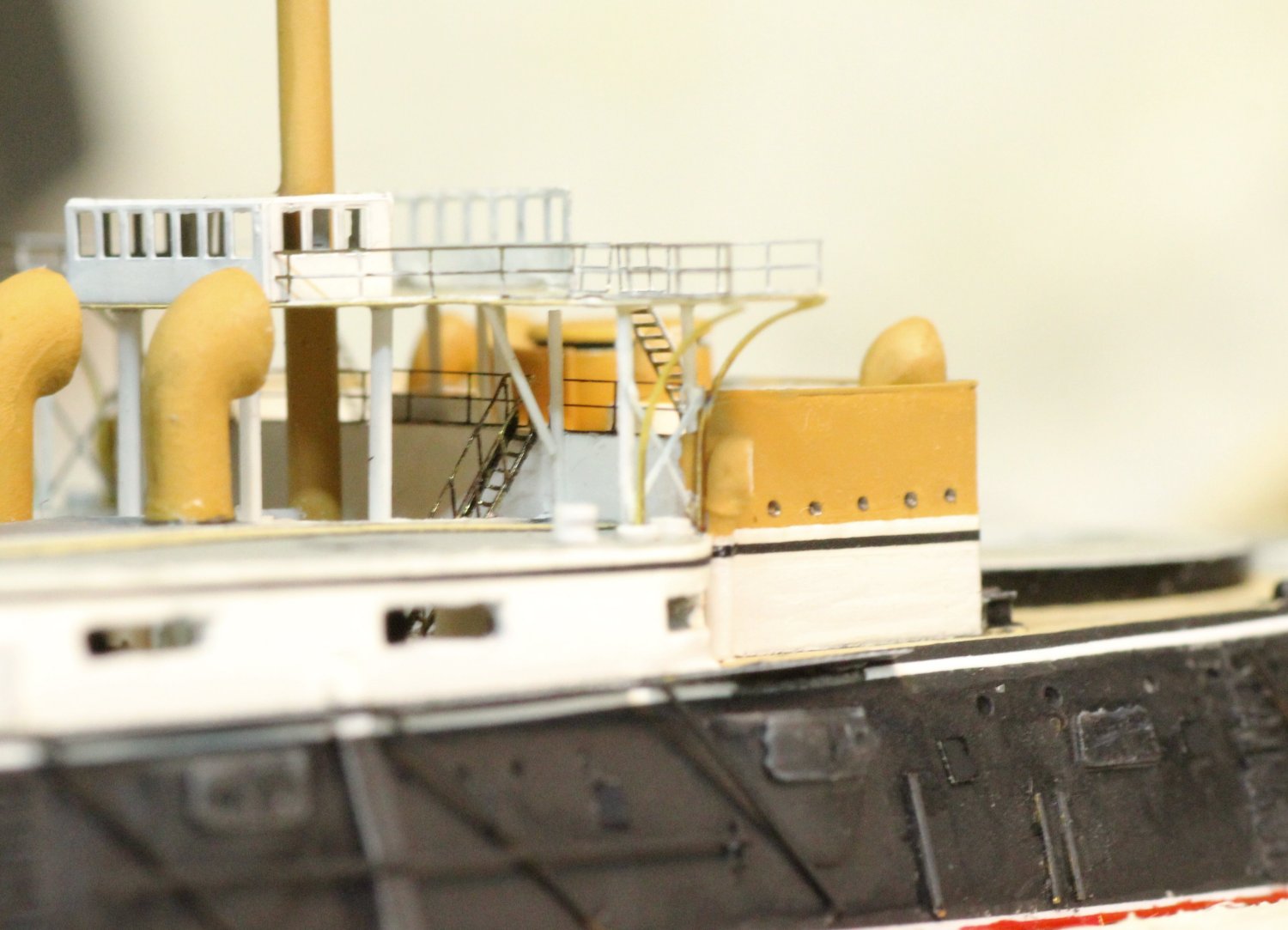

The aftt superstructure was also getting some attention...

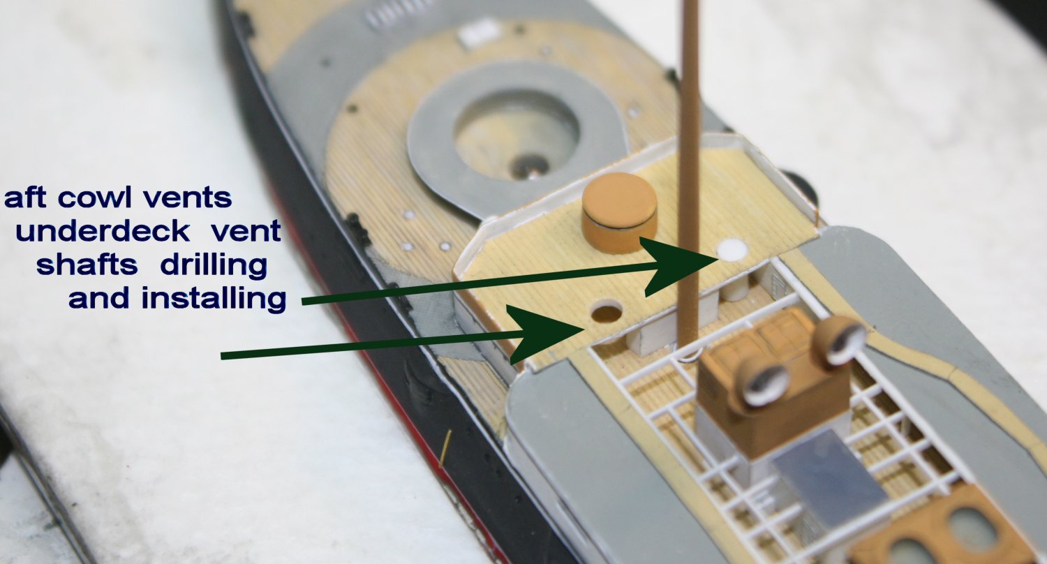

having hollowed out all the solid cast well deck-- the aft vent shafts bases of course would now be visible
of course the kits vents were far too short-( as they were intended to sit on the solid block)
-so I installed some appropriate size styrene rod

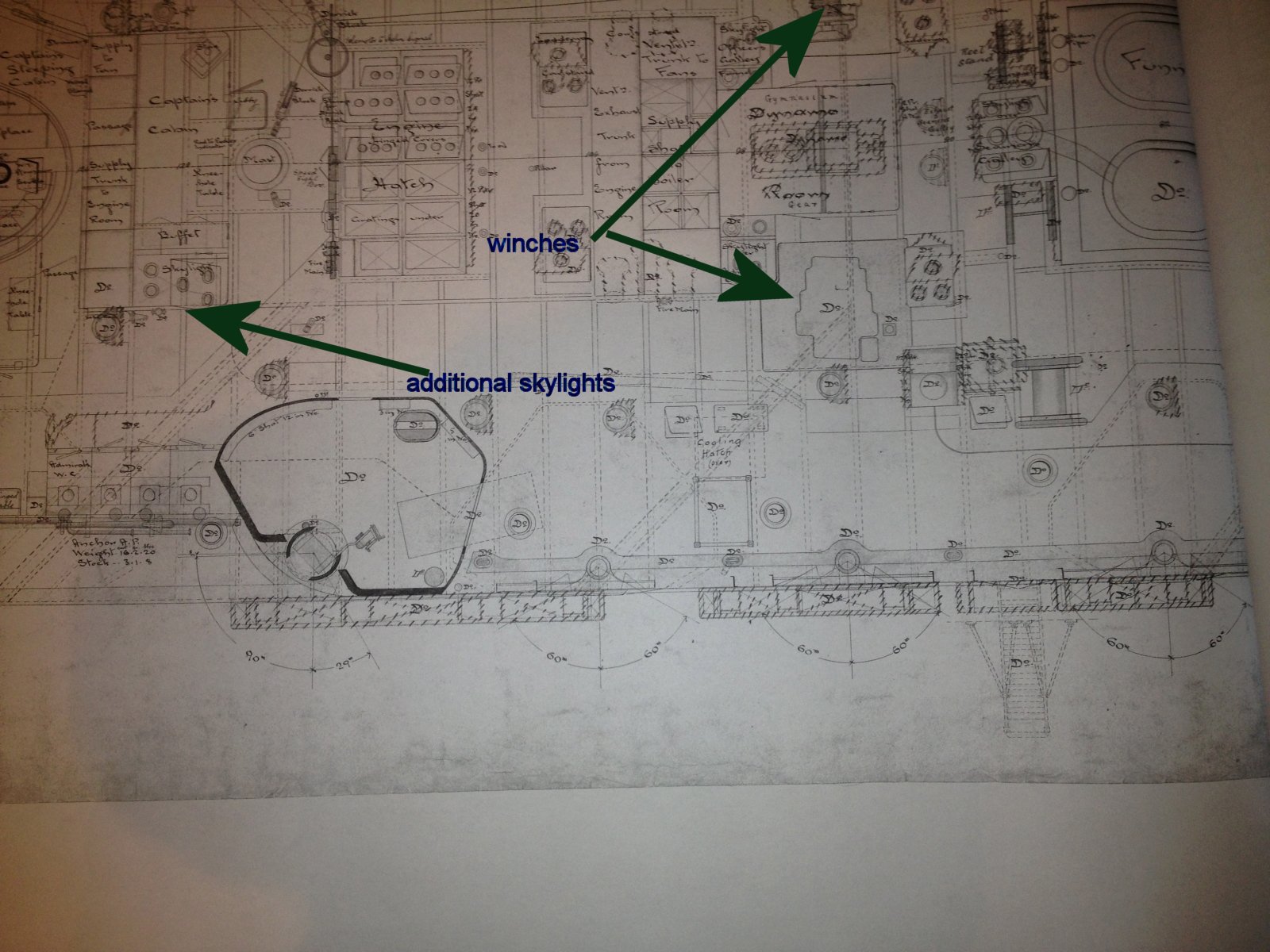

and now I noticed--on the NMM plan that I need to add some big winches as well as more skylights...
( under the boat skid beams ..)
ho hum...

after 'discovering' the winches and the skylight on the plan--they were duly made of styrene , drilled and painted.
The winches were cobbled together of small bits of brass and resin scraps--both were added with some degree of difficulty (!)
to the well-deck through the delicate lattice-work of the boats support structure

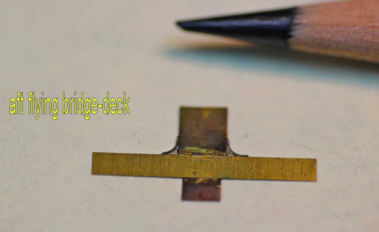

for some light relief (!) I made the aft flying deck of multiple pieces of brass and glue ( which will be mounted on the masts a few stages further down the build )
The resin supplied kit item was the right size in planview--but had solid resin ' railing' and was of course far too thick in every dimension

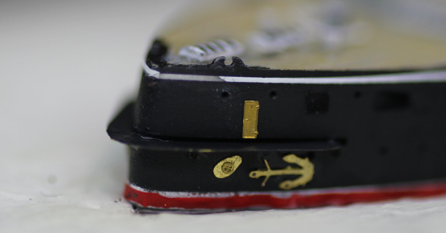

The giant slot in the hull ( intended for the insertion of the the rather thick resin sternwalk deck ) was too large for my thin brass deck.
after I attached the stern walk the gap was filled by running a black decal strip over the gap and blended in with paint
Under the sternwalk were 2 x hawsepipes ( sealed with lids ) and a horizontally stowed anchor each side.
The hawse pipe-lids were filed up our of brass with some small brass detail ( old gunsights)
I used some very old Toms anchors which before painting had some texture added
( not seen yet in photo )

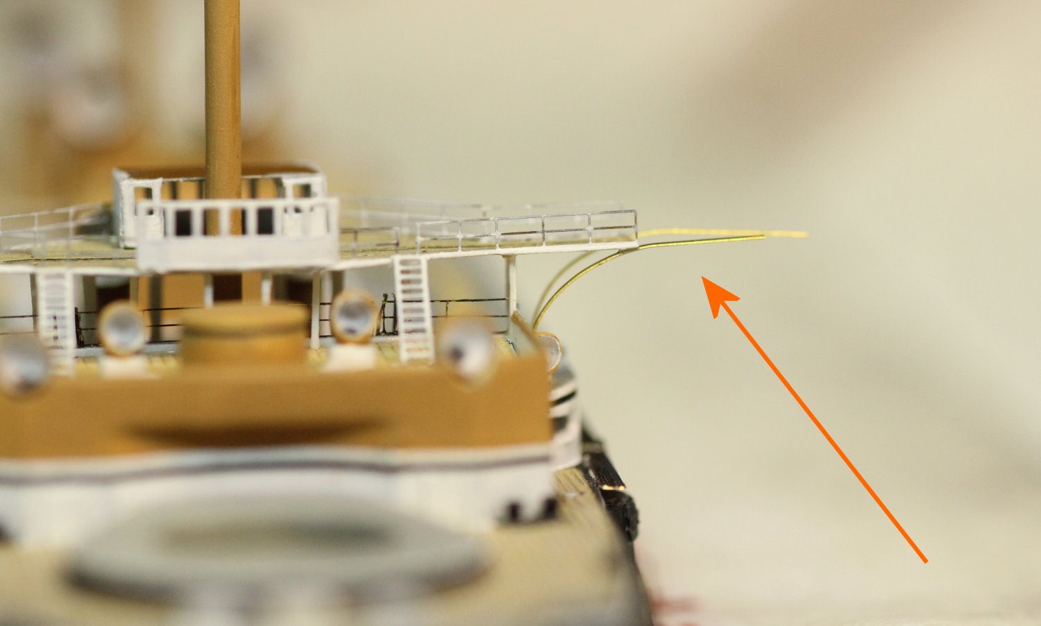

alas it is too short--fortunately after contacting Richard Harden ( Toms modelworks and the 'new' White Ensign Models ) 2 x new WEM Iron Duke frets are en-route from the USA to the UK...
( better to have tow of the same matching 'vintage' etch than mix my 10 plus year old with new--maybe minute differentials so would not be a perfect not a match when joining ...
with two new railing sections I can splice them together to give the required length-- phew!

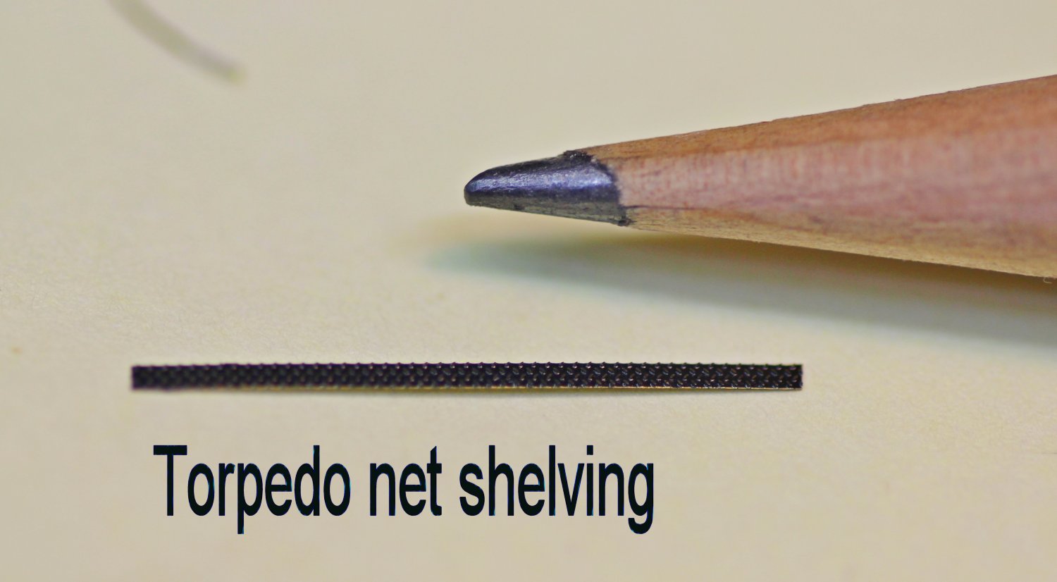

the torpedo net shelf on this vessel is not continuous..- it has gaps within to allow the net booms to stow... this took some working out as both of the plans I have are far from helpful or conclusive-- the spacing of the booms and a few oblique photos gave me some of the answers
the shelves themselves are not solid--but rather a lattice type construction ( water drain , strength etc )
I used some textured narrow strips of PE ( old l'Arsenal Liberty ship 1/350 PE ) cut up and installed - guided by the boom angles/ positions and photos
The net booms were made of drawn brass wire dipped in a small puddle of white glue when half set this was flattened to give the impression of the re-enforced mounting plates -- the stand-offs for the booms were small slivers of styrene

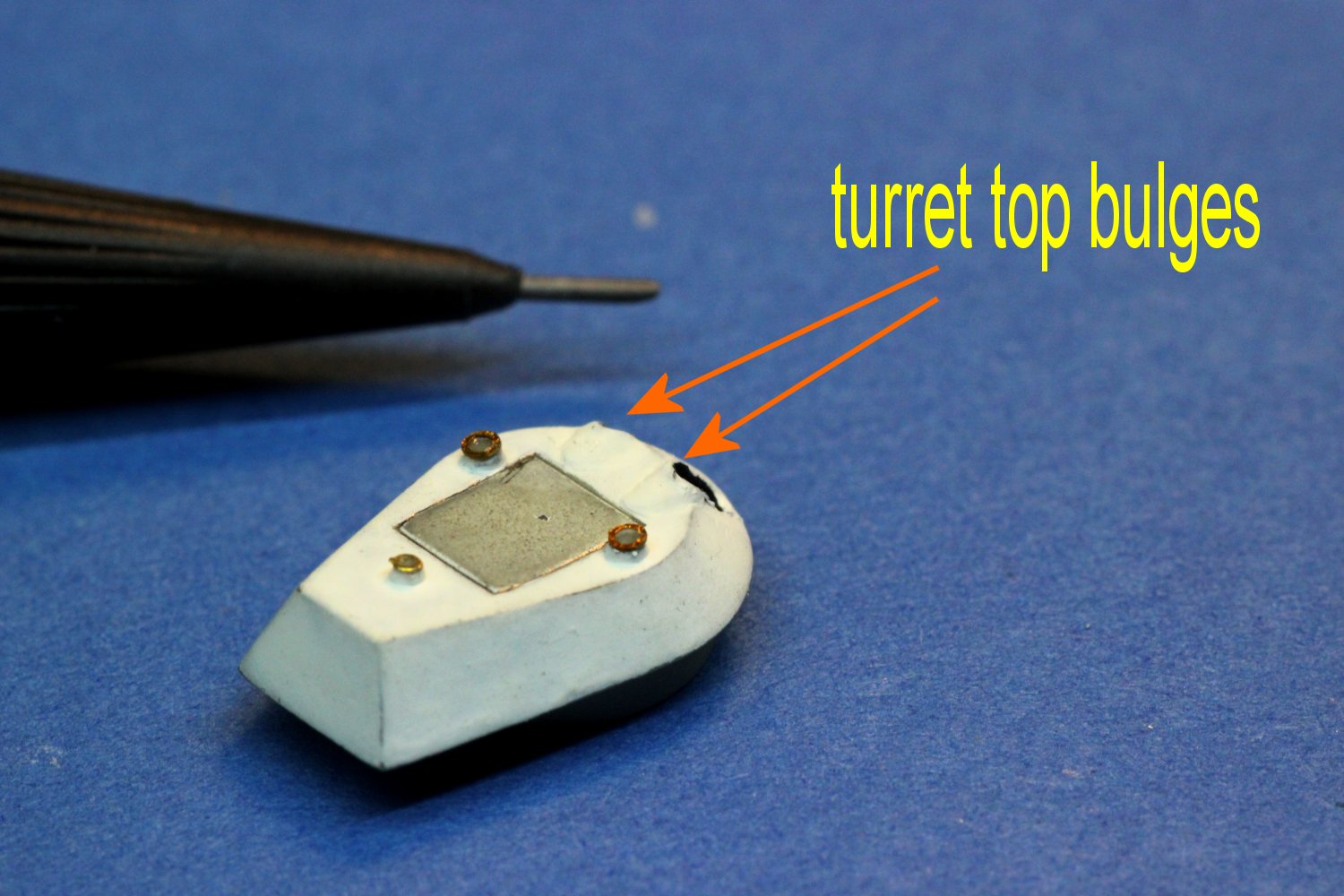

The turrets are pretty good in outline--however theywere missing the 'gun barrel housing aperture flare'
so as gain greater elevation the main turrets had an enlarged opening at the top edge line of the turret
I made this with a small wire former which was then backfilled with white glue to create the small 'bulge' on top of the turret
an odd thing I noticed was that within months it seems certain quite major features of the ship seemed to either change location--or the paintwork was altered-- even when the ship carried the same colour scheme layout--
case in point-the shoring strake ( a belt of I presum timber steel to prevent the wooden shoring posts--when vessel was drydocked to locate sideways and -from slipping upwards
in one photo this strake is above the white waterline--in another the strake is below...?!--
so what moved--the paint or the strake? :scratch:
I made a simulation on the model using small brass strips-below the white line--these will only really become apparent when I finished the sea as the edges of the strake will create a small amount of spray as the vessel moves through the water

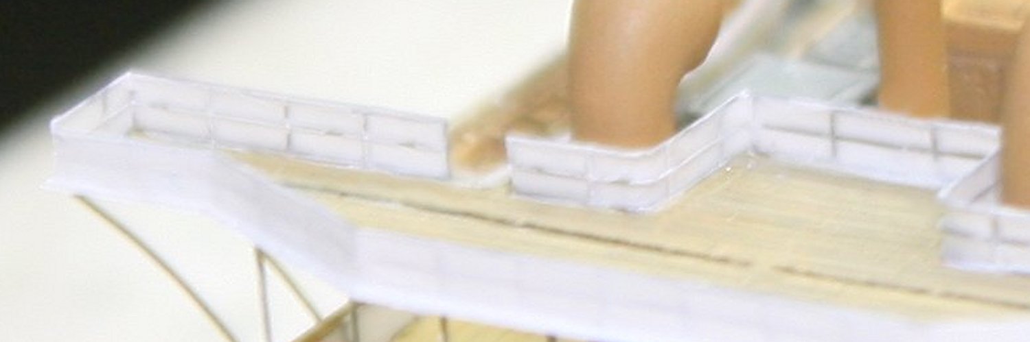

next I turned my attention to getting the bridge end underway
I used some of the PE set that came with the Chinese version of the Kombrig kit for the bridge house windows
I started by installing some of the supporting structure under the bridge deck --which was securely sitting halfway up the mast on a tiny blob of blue tack :cool_2:
small companionways were fiddled in place--as was some railing
the distinctive curved outer bridge wing supports were added from bent brass strip --as was the small cruciform between the outer uprights
the one piece handrails (no vertical intermediate supports) for the 2 x stairs on the fwd face

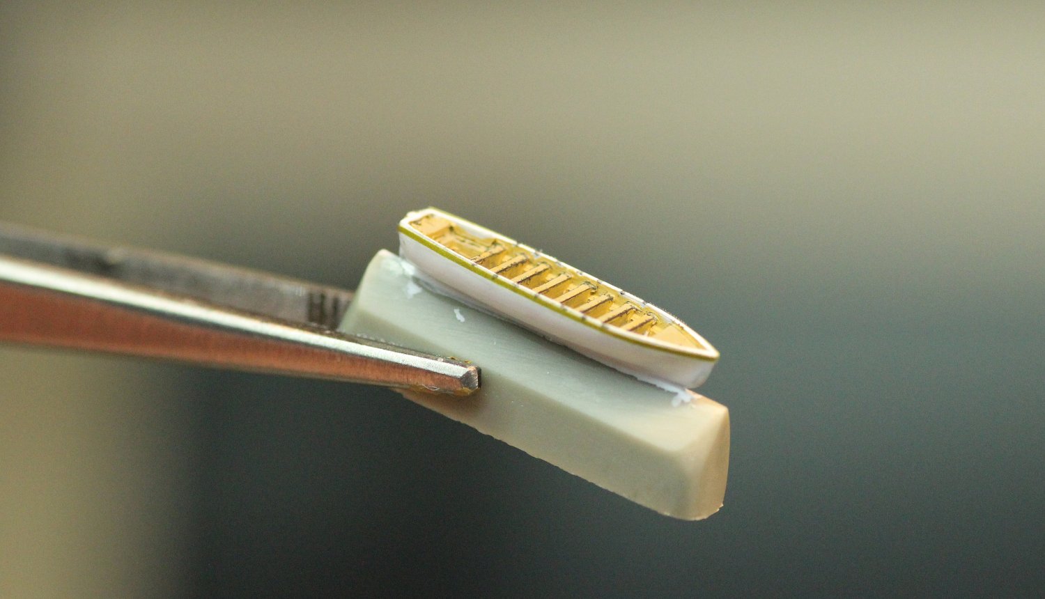

next in the firing line were some of the huge boat complement the ship carried...
the launches first had 'timber ' rubbing strakes added of stretched sprue
The pulling boats and whalers had the upper planks that were left varnished- represented by using a thin strip of decal striping
it looks sharper than I could manage to paint anyway!
I added a bit of contrast and depth to the benches by dragging a pencil along the edges of the thwarts
Once the oars are in place it does give the boats a bit more visual depth

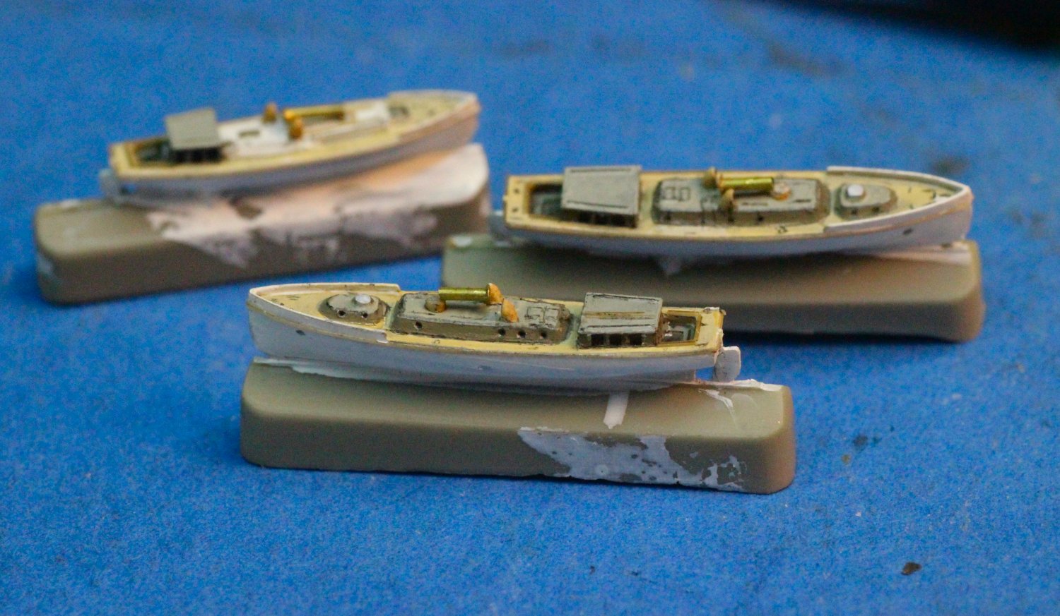

The launches of the RN in those decorative days had the distinctive polished brass funnels with flared tops
I used some brass micro tubing and flared the ends with the use of a pushpin in a pin-chuck and revolved at ever decreasing angles to obtain a subtle flare
I made the saloon windows with tiny chips of black decal stripe and used a pushpin to make the portlights
once installed it looked OK to my eyes-
alas these big enlargements always make small boats look too crude...
in 1/1 scale viewing it all looks pretty good !
still have seven more whalers to do... (!!)
arghh!

Truly a remarkable, informative build, Jim! :thumbs_up_1: :thumbs_up_1: You are a heckuva teacher! :cool_2:
Bob Pink. :wave_1:
marijn van gils
Posts: 2738
Re: Build HMS Majestic ? Magnificent ? Mars ? 1896/7/8 => 1
Post by marijn van gils »
Amazing work Jim! :worship_1:
That bridge looks fantastic, as do the boats.
Good to see you make good progress, and thanks for the detailed SBS. Always very educational!
Marijn

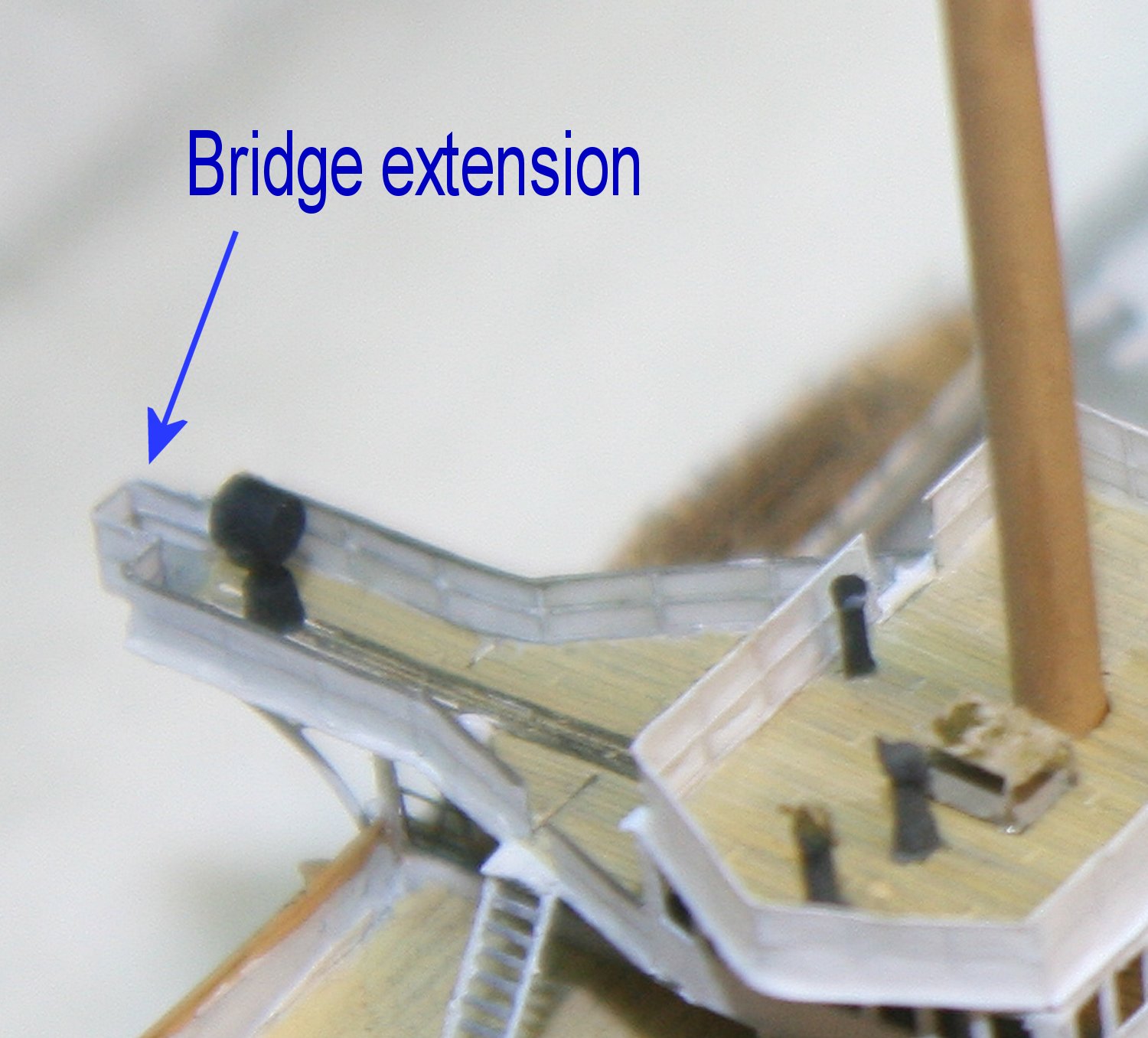

The fwd bridge platform has the bridge extensions added as rail only--and the 'floor' spanned from underneath with CA glue ( hard and stiff )
The fwd bride-deck was furnished with helmsman at the wheel, binnacle, crew , voice pipes etc etc
alas I neglected to photograph it all BEFORE the wheelhouse roof/ deck went on .. and now it is virtually invisible without a ( very small! ) endoscope....(!!)
but it does man that the wheelhouse does not look empty....
hmnnn!
meanwhile I made a start on the aft lower flying bridge-- carefully applying rails( cut and shut symmetrically)
so as to ensure I always had stanchions on the corners.
then I painted and thereafter applied the 'canvas' dodgers
with the white glue drying clear a pleasing effect is obtained when paint is applied on the outside of the glue dodgers--the inner rails have a bit of contrast.
meanwhile I had prepared some of the supports for the aft bridge deck-- the plate metal upright with the oval hole - as on real ship below
was gleaned from an older stainless-steel GMM IJN PE set
installed it looked ok....
after installation the remaining uprights ( cut from brass 1/350 longitudinal handrails) were installed- white glue at base and when upright at last CA at both ends applied with a (discarded) cat whisker--stiff but very soft springy...
the curved supports at the outer ends were made in a similar fashion
--with very much checking for symmetry and upright beforehand!
the ship is starting to look "shippier..."
more soon !

Very impressive, elegant bridges! Especially the supports of the bridge wings!
Posts: 8589
JIM BAUMANN wrote:meanwhile I had prepared some of the supports for the aft bridge deck-- the plate metal upright with the oval hole -
Brilliant work (as always). Very clever solution!
