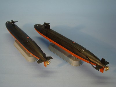

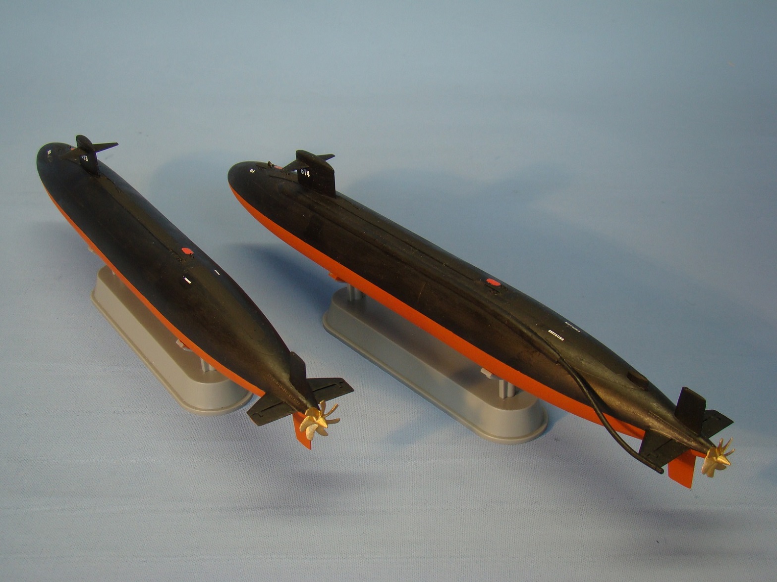

Hi
Your discussion worries me. I am based on the Navsource data and I hope I did not make a mistake in my 1/350 Sturgeon build.
USS Sturgeon with a short hull
USS Archerfish with a long hull
USS Richard.B.Russell with a long hull base
All kits from Mikromir
Best regards
Pierre
Best regards
Pierre

Superb!

Nice collection - and always good to see the RBR (Aka: "The Moneymaker") being recognized. Her stint in DEVGROUPONE was short but productive. Great weathering too!
My only critique is one I see repeated ad nauseum, and that's the railroad tie "keel blocks" which are anything but. Keel blocks are square and built from concrete and wood, spaced at prescribed intervals for each class of boat and arranged in the drydock basin prior to flood-down. Google "Submarine drydock keel blocks" for a look that will sexy these boats up even more!
CCC
CCC

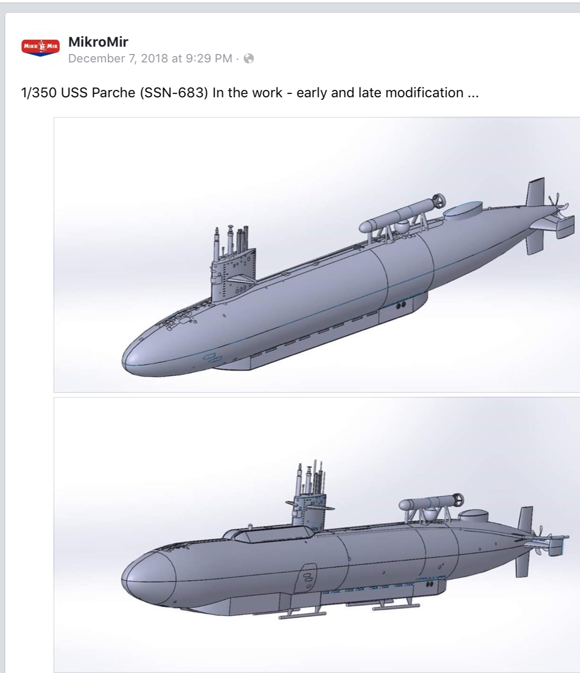

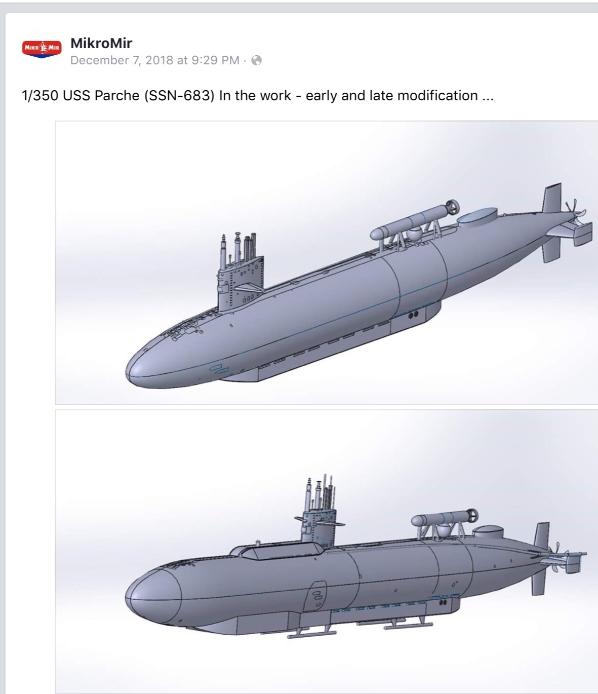

While scrolling on the MikroMir Fa(r)cebook site to check out their upcoming Albacore kit, I found this much further down the page. The posting date is the end of last year, so I don�t know whether this is still planned as a kit or is vapourwear. If they release it, I�ll take 4, please. It would be an extremely popular kit, given the subject, probably a top 10 best seller.
They clearly studied Hal Sutton�s drawings of Parche at Covert Shores. I guess they were unaware that the later hull extension version did not have the external saturation diving chamber at the stern.
Of some interest to Sturgeon fans. Anyone else think it is ironic that a Russian company is modeling a Special Projects sub?

Nice work! Make sure you add the support struts to the towed array tube before you paint.maccrage wrote:Rereading The Hunt For Red October for the 87th time, so I decided to do Pogy, and need a towed array. Cut a long hull upper down to match the short hull lower.

Indeed. Don't see how they missed them in the kit. They're pretty prominent.Vepr157 wrote:Nice work! Make sure you add the support struts to the towed array tube before you paint.maccrage wrote:Rereading The Hunt For Red October for the 87th time, so I decided to do Pogy, and need a towed array. Cut a long hull upper down to match the short hull lower.
Oh, always make sure the model is out of the toddler's reach.

Maybe I can interest you in getting a more realistic prop for your Sturgeon: These screws are available from https://www.navalmodels.com/winkel/prop ... eon-class/maccrage wrote:Oh, always make sure the model is out of the toddler's reach.![]()
(And I see I need to add those braces on my model too - thanks for the update!)
