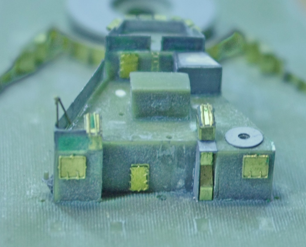

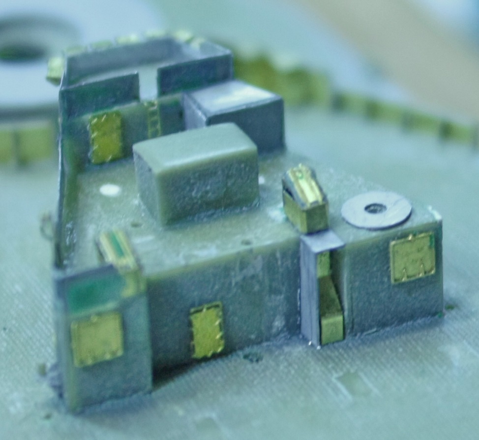

Anyway, there is some - if not much - progress to report...
I started to detail the superstructure �aft-and-fore� and that means that the bridge will come last. However there was one flaw of the kit which I had to correct upon recognising in order not to damage tiny details to be added later. When I temporarily put turrets A and B on their barbettes just to see how they look it became apparent that the top of barbette B had a slope towards the back � this was the second barbette of the kit with an inherent flaw!
I chose to correct this by glueing a thin strip of aluminium sheet to the circumference, but only to the after half, then applying a generous amount of green putty followed by careful sanding which led me to an acceptable result.
I went on to detail the funnel base. First I had to remove a block from its starboard side by cutting it away piecemeal.
The boiler room vents on the side of the funnel base presented a problem as they did not protrude from the surrounding surface. After some deliberation I decided to glue strips of aluminium sheet to the sides of the base and mate them to pieces of PE containing mesh of appropriate size cut out FlyHawk�s Hood upgrade set (this I bought just to be cannibalised so I could do the barbarian act described above without feeling any remorse). I carved a shallow recess to the locations where the actual mesh would go and coloured it black before adding the PE pieces thus preventing them from being clogged with paint during the subsequent painting process.
There is a small deckhouse with an oblique roof situated between the two funnel apertures � this was too small and its walls were not perfectly vertical. I cured this by adding layers of styrene sheet to the deckhouse until the desired size and shape was obtained. Later I added some detail to this deckhouse.
