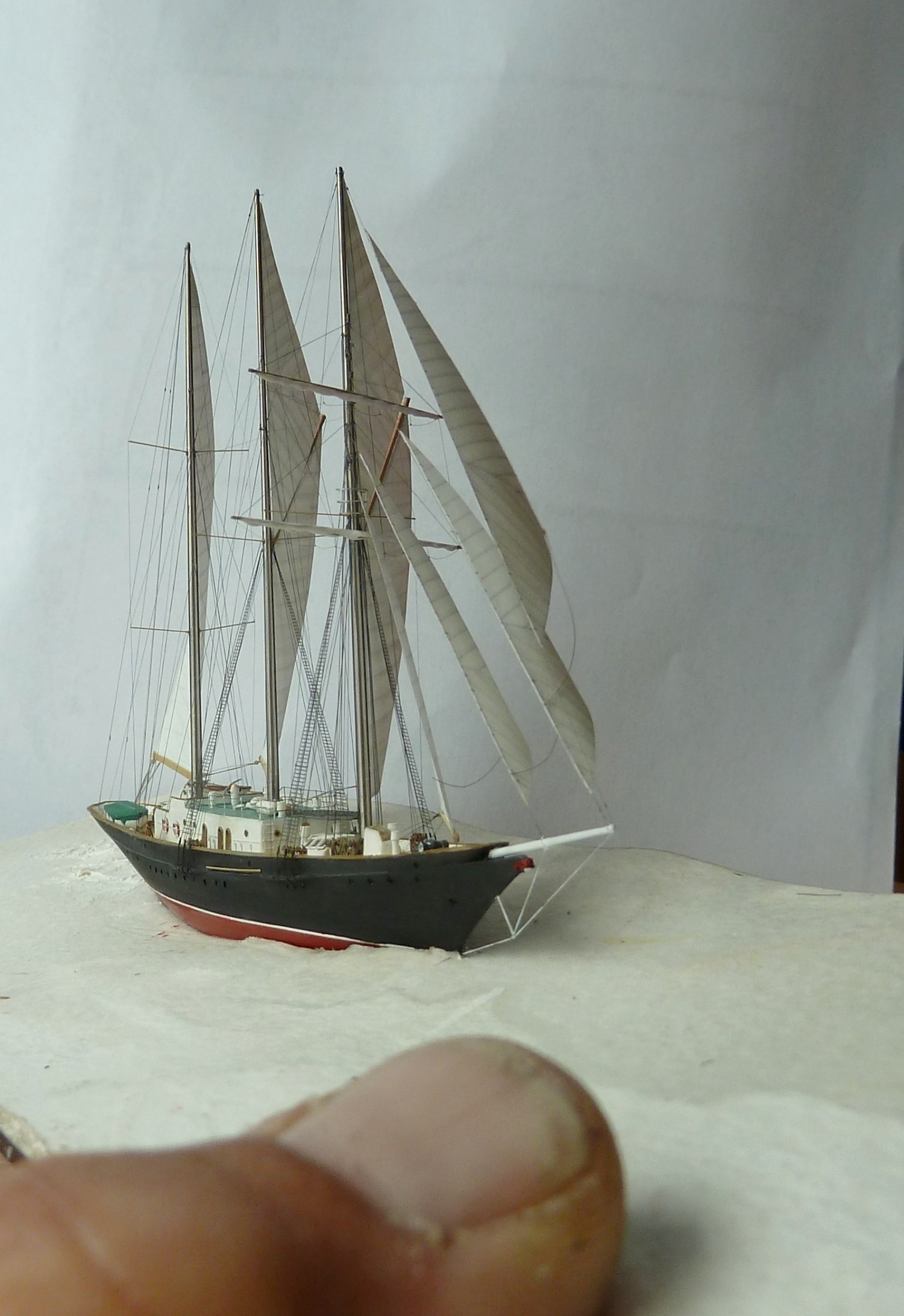

To this end I decided to overcoat the sails and their seaming with layers of thinned white paint.
I tried airbrush but it gave a ghostly, overly homogeneous ' dead'; feel- (alas probably more correct...)
- so I resorted to brushed washes.
Its an inexact art/ science and I feel I can hopefully improve vastly on this in every direction in the future
after a number of layered washes the effect I sought was appearing

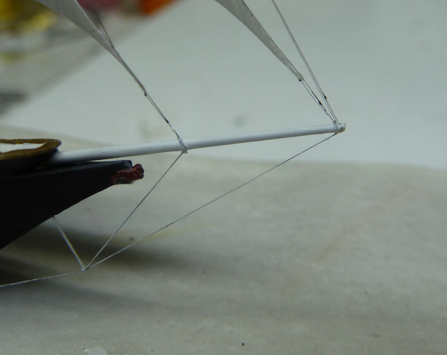

The brass bow sprit was also braced as per the real thing
The sails were tacked onto the stays using thinned white glue ( Hi-Grab) an then thin CA dabbed on at intervals.
The only problem I had was getting the sails to set at the correct angle, as the stays were free to ' rotate '
and the relative torsional loads of the weight of the sails is considerable.
Fortunately I hit upon the idea of using the slack windward sheets--if made of wire--to support the sails in their 'set' position
I plan to make the( in model-form non-load-bearing) leeward sheets and much of the non structural rigging, halyards etc
with stretched sprue a per my usual methods.

and am now around about the time I enjoy most--the Rigging--though this tie I found myself challenged...
despite its relatively simple rig, the amount of rope on this small vessel is quite startling!
Working from midships outwards I first installed all the ( feasible to me ) halyards , hoists and tackles I could discern
using the Uschi .001Thread , in the main for its resilience and inability to get damaged by to knocking and kinking accidentally
The dark grey is not offensive; against the sky or any light surface all rigging on the real thing looks a dark colour,
though... I have started washing some of the halyards with a tan wash... :cool_2:

after much fiddling, many attempts I managed to get the bow sprit netting in place to my liking

.... :cool_2: and so the model has reached completion...
Painting the sea was a pleasure--as the model really came to life !
Despite being a ' modern ' sailing ship( launched 1966) , I've learnt much and quite enjoyed the research--
often from Pathe news reels, but also from private video footage that has been uploaded to youtube
There is much that I would have tried harder on were I to repat the build,
- I have gained valuable experience in small sailing ship modelling which I shall put to use
in a future 3-masted sailing ship project that is germinating as we speak... :big_grin:
....but in the meantime I shall build a couple of small ship models that do not have sails !!
...-though they will have ratlines... :cool_1: :big_grin:
Some " proper" photos will be taken soon and appear in the gallery in due course
--meanwhile a couple of point-and-shoot camera images from today see below:

Herewith today's snapshots of the finished model
Jim Baumann :wave_1:

Thank you gentlemen !
I was not displeased myself-- :cool_2:
The overall effect is quite convincing-- and after spending 6 months looking at it through my x 5 magnification Optivisor...
I have to remind myself the ships is only 4 inches loa! and on the whole is quite nice!
