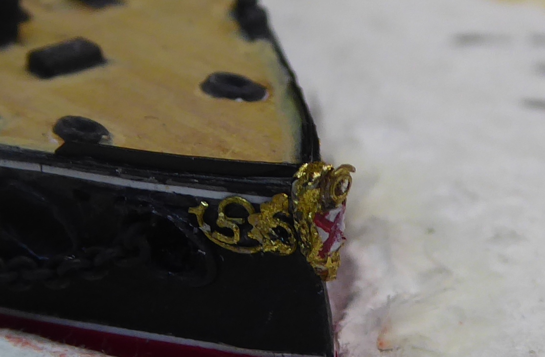

Very fine work you have done! The bow crest is especially spectacular! :thumbs_up_1: :thumbs_up_1: :thumbs_up_1:

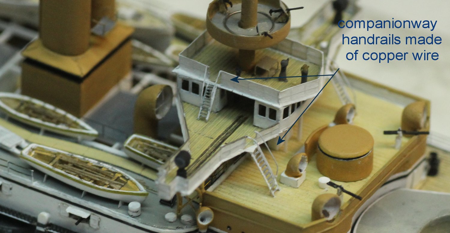

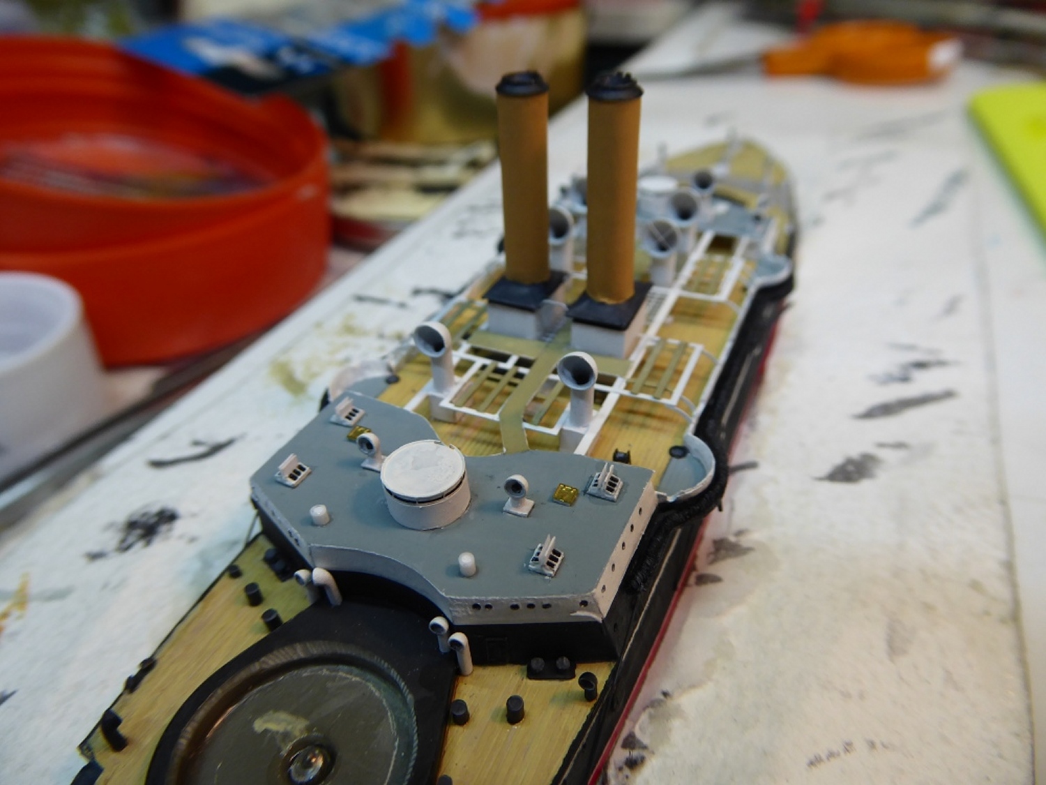

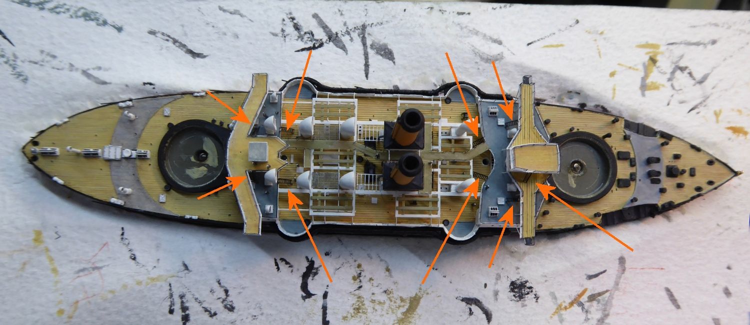

still small steps- compounded by being self-employed-- 1/1 scale work has interfered with my modelmaking !
but here are a few images of recent works

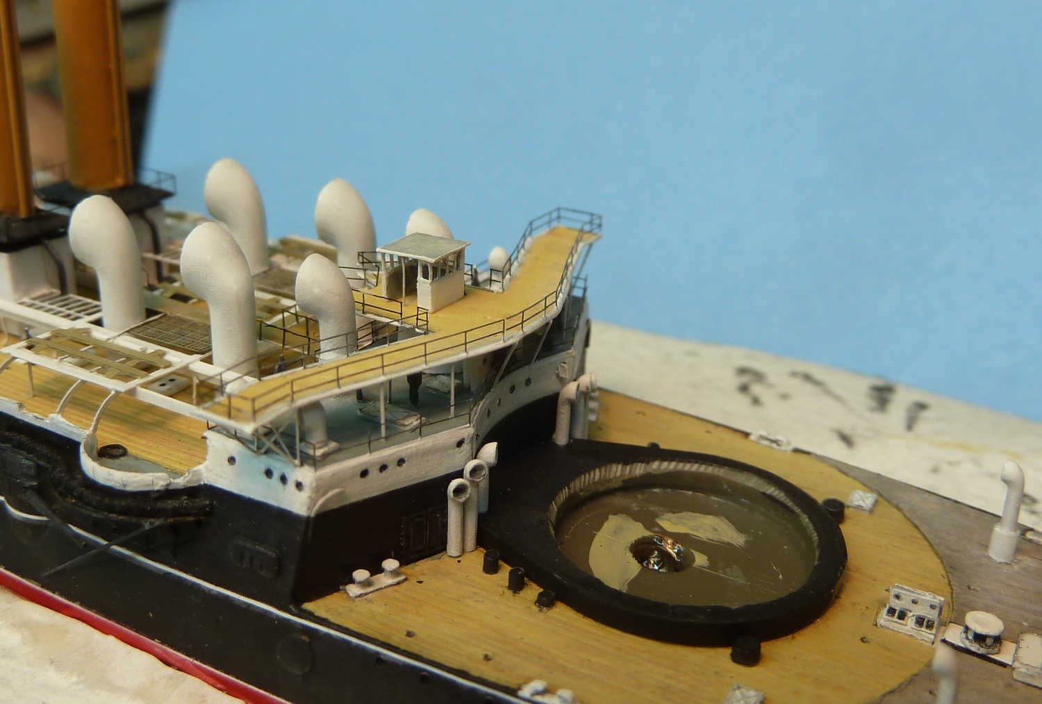

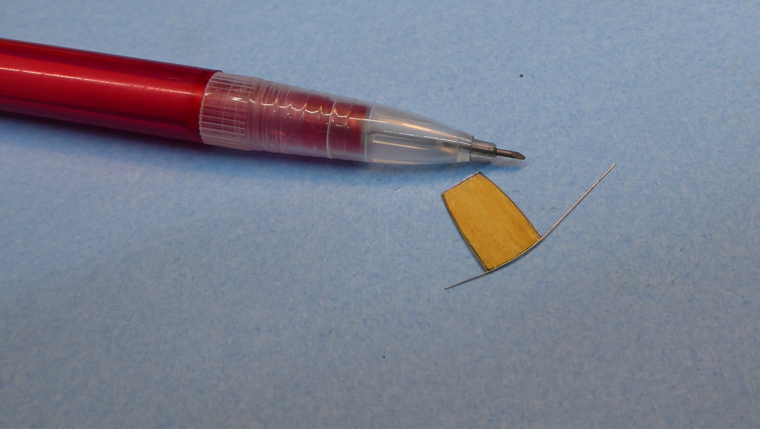

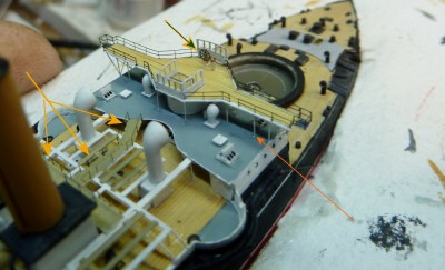

The fwd superstructure had --as I gleaned from the as fitted plans of the spar deck and a few glimpse in photos...
some 'lidded' skylights --similar- but smaller than those at the stern
I made these of styrene strip, very small ladderstock and paper lids...
The vast bland-ness of this deck is at last being mitigated as the skylights , hatches and vent stubs are added

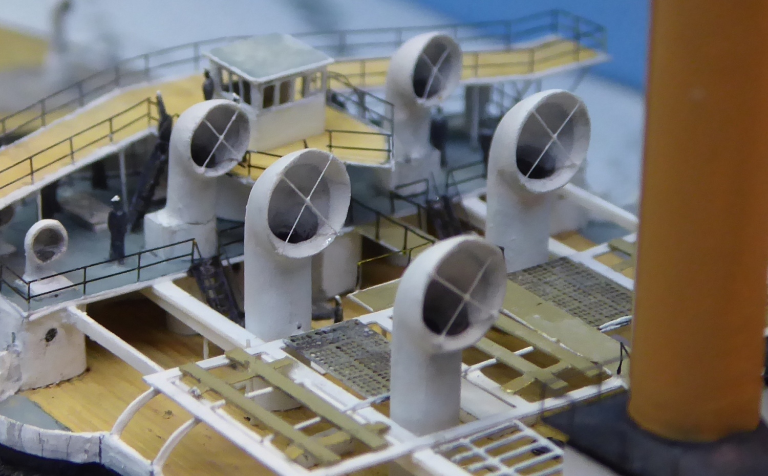

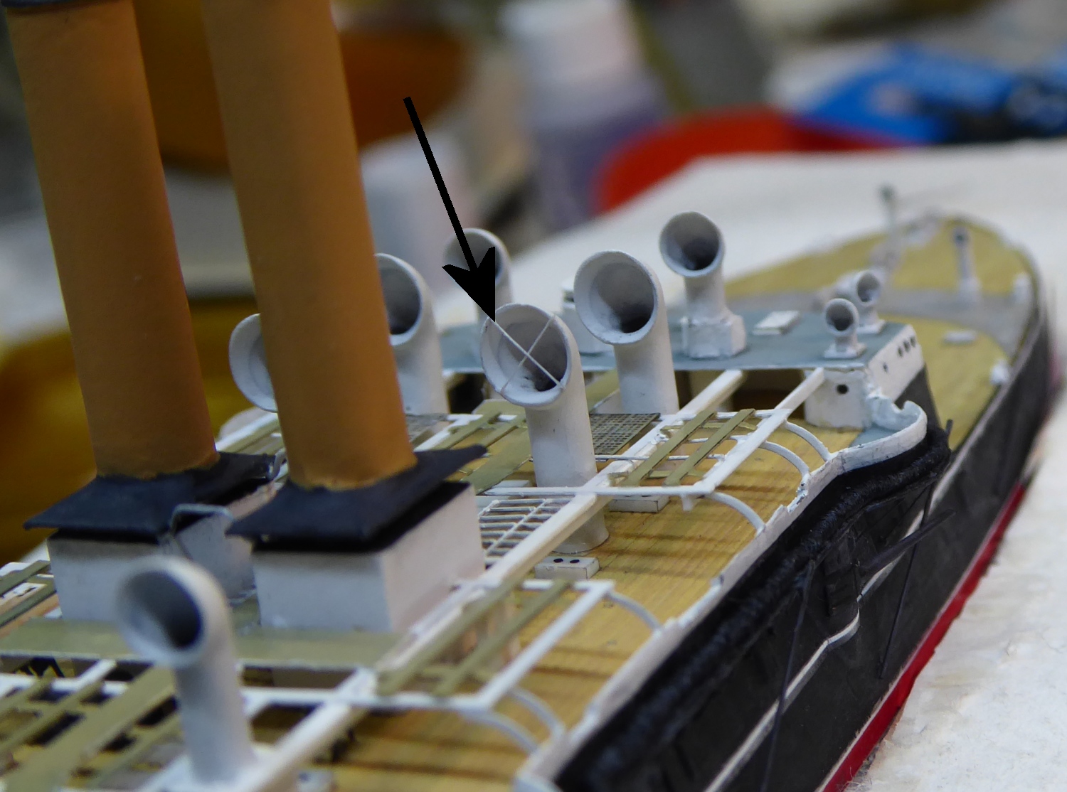

I have been practising make the cowl vent diagonal bracing ( of white stretched sprue )
here is number one... only another nine or so to do !

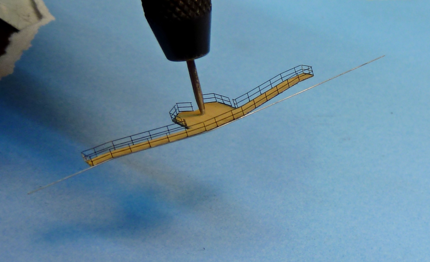

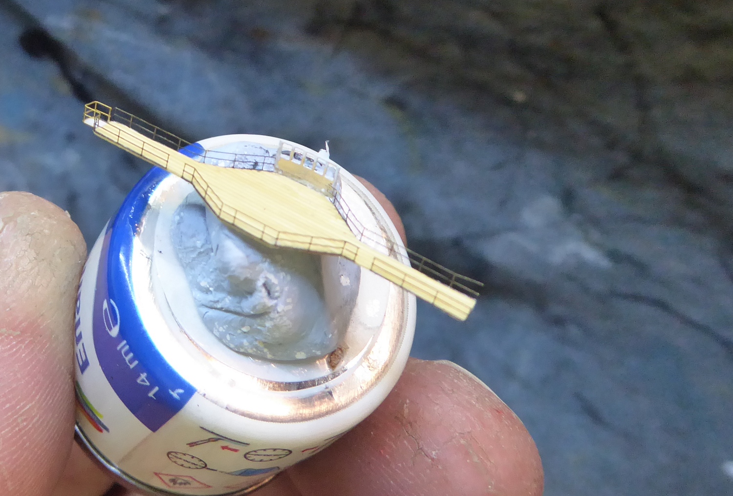

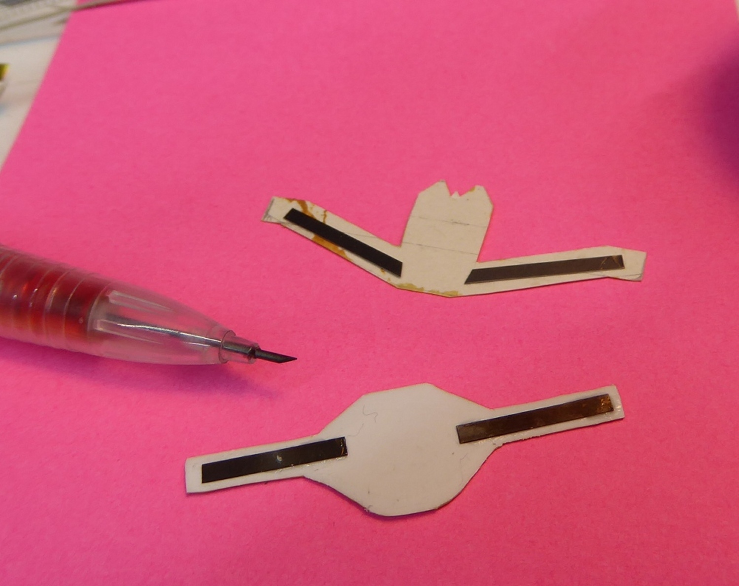

The flimsy styrene and paper flying decks were braced on the underside with PE stainless steel strip for " strength "
Holding and manipulating these flimsy decks and the very fine GMM gold plus ( and WEM ultrafine ) railings
-- which are cut and shut for symmetry and stanchions-on-corners,
===> was at times a challenge to both language and temper !! :Mad_5: :Mad_6: :mad_2:
The above photo shows the ' beading ' ( actually the capping strip on the edge of the deck ) being adde of thin wire
this also absorbs and disguises the lower part of the PE hand railing.
The roof of the wheelhouse also has the capping added of wire.

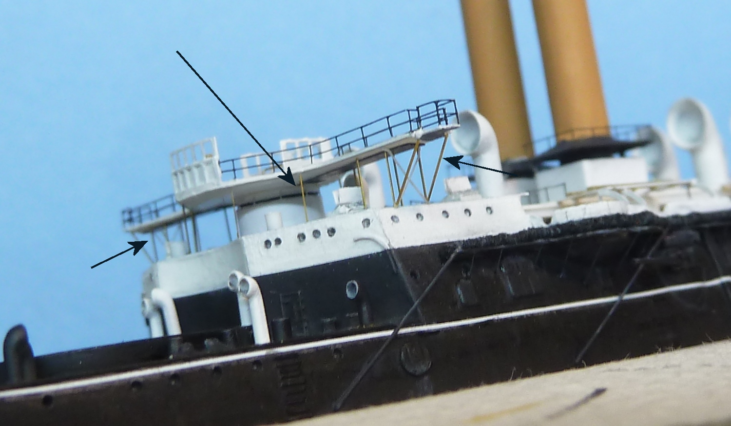

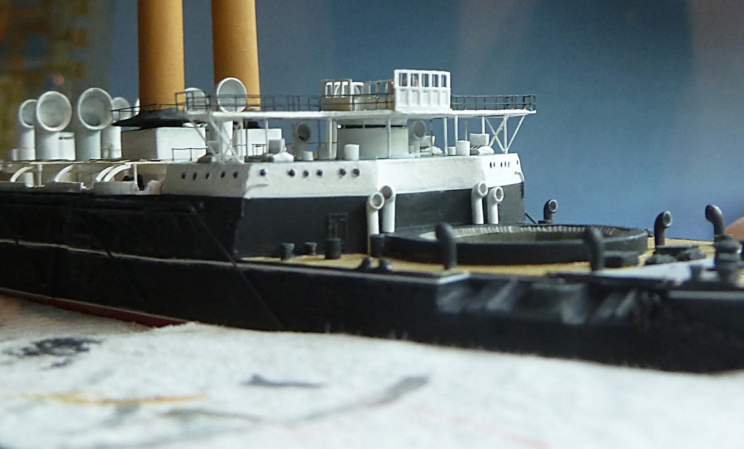

ah yes....

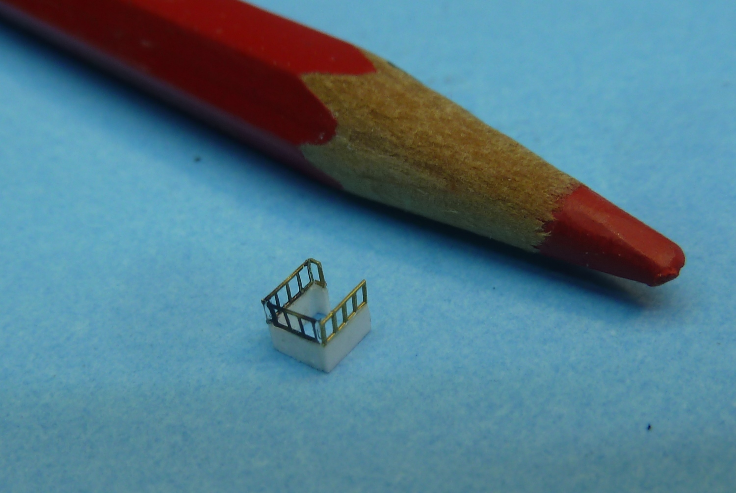

I was working on the wheel house roof....
and then I added the rails allowing for the stb side stairs
The aft flying bridge had a tricky shape with a lot of cutting and shutting of rails
I then added the deck edge beading of thin wire

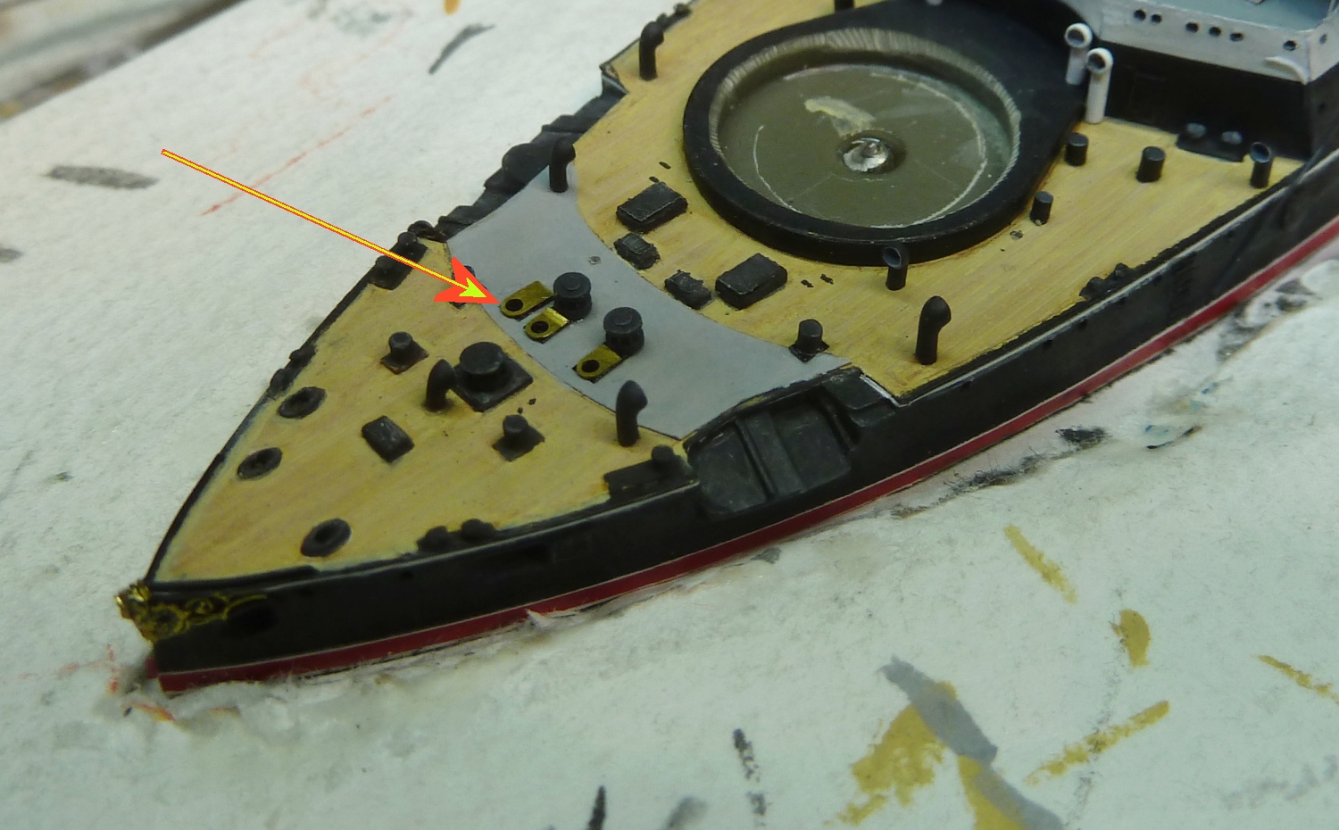

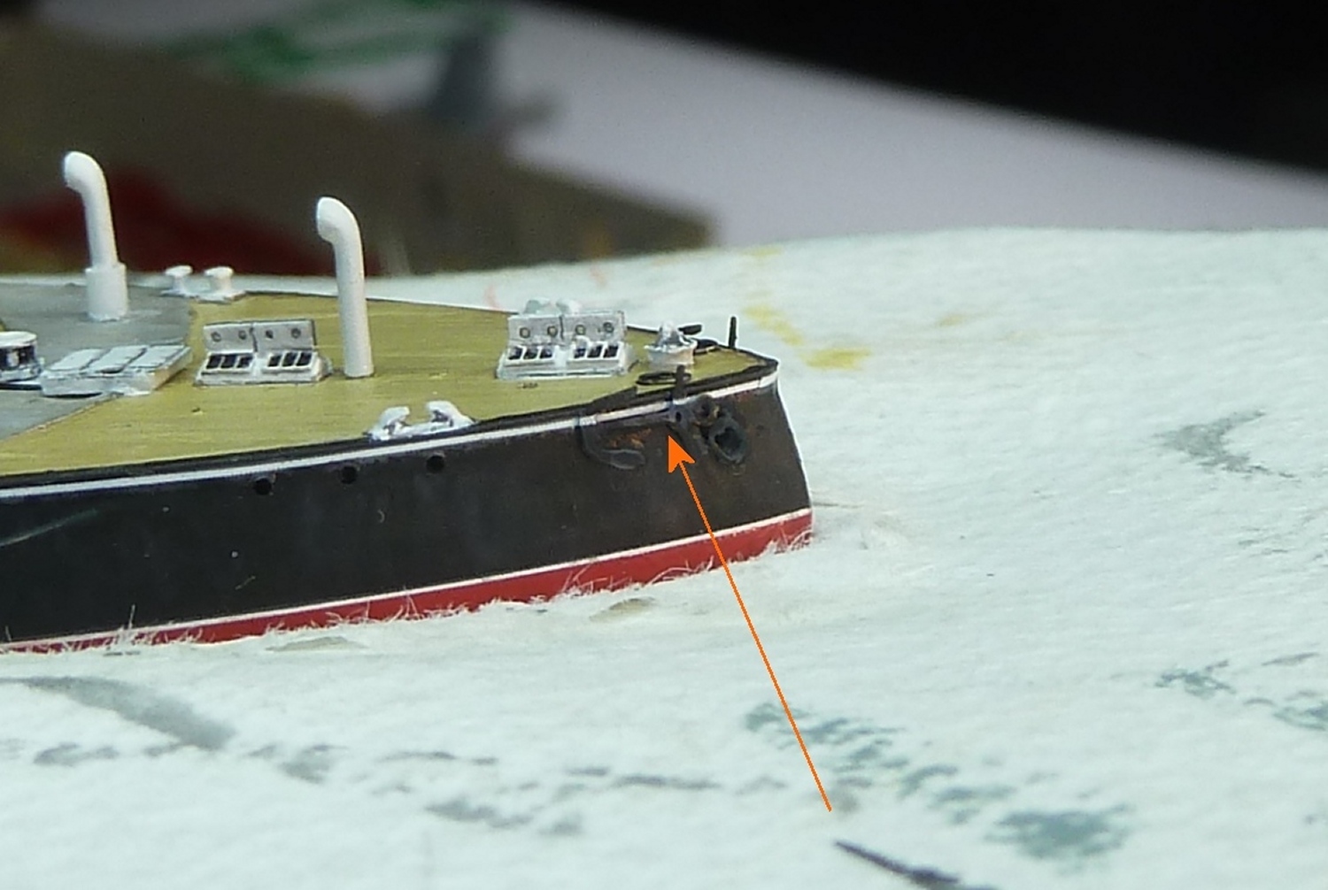

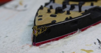

On the foredeck the chainway was made using some old spare PE pieces adapted
for light relief I added some hawse hole surrounds and cut to suitable shape some PE anchors
amusingly-- on the real thing nothing must be allowed stop the clean white lines....

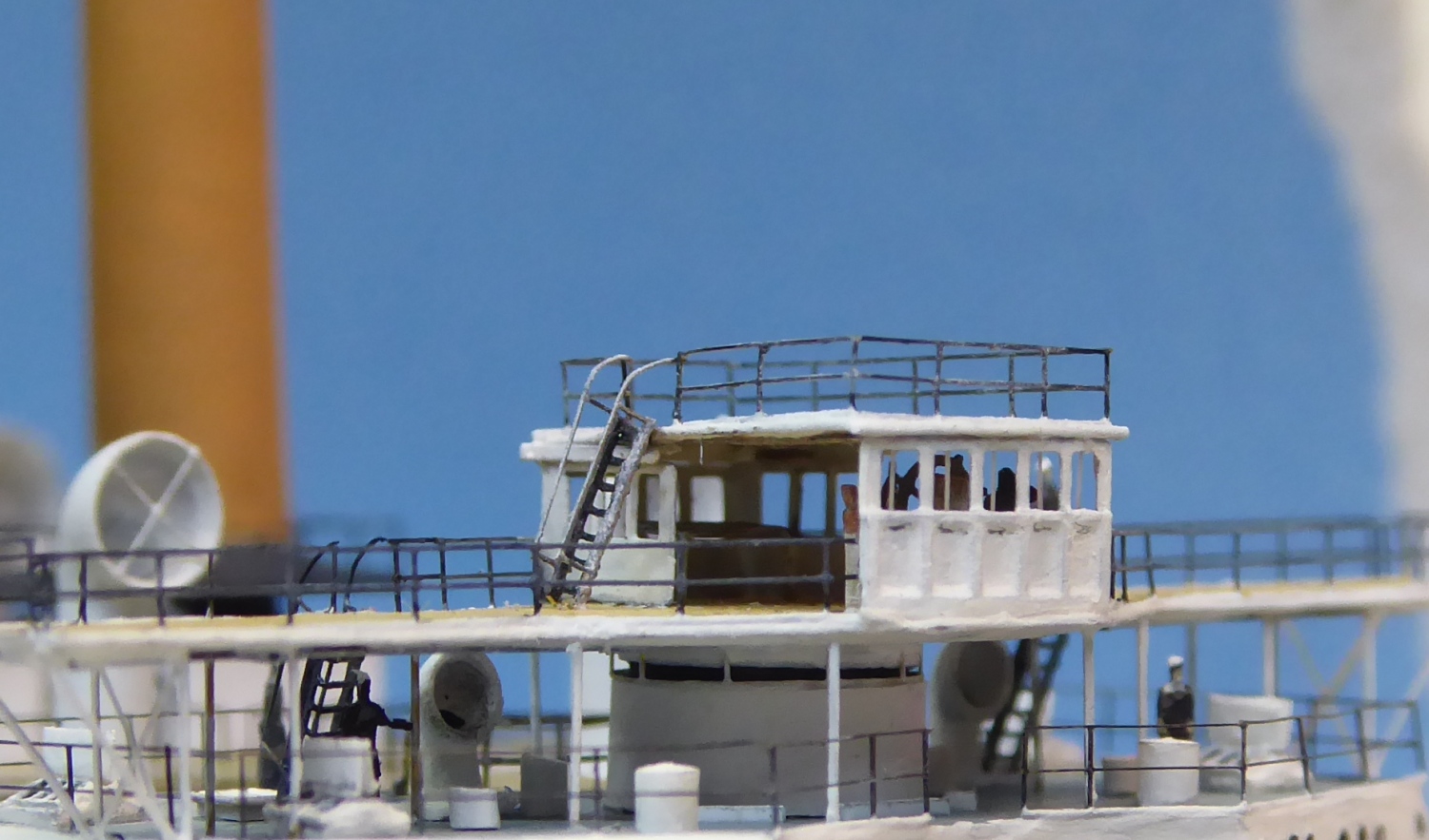

I was making myself unhappy about the aft pilothouse; trying to find a solution, as it had tall narrow windows and the Combrig item being rather too small in my view
as well as being solid,==|> when the port side was actually open on the real thing.
I eventually found some suitable donor material in the form of some old Stairway PE ( unknown fret )
this was applied on the edge of some thin styrene and the corner solids being made by gap-filling with CA
Once installed it resembled the real thing reasonably ( for 1/700- !! :cool_2:

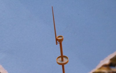

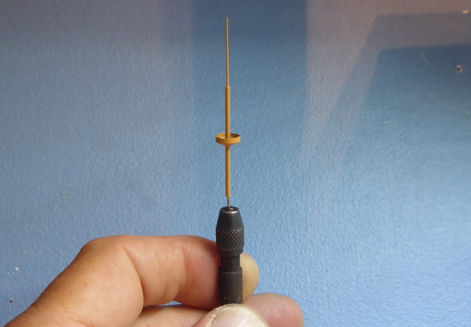

I started making the masts in readiness for imminent masting
using some suitable diameter copper tubing that had stainless steel rod installed within and then filled by dribbling in runny CA glue
thereby making a rigid sandwich laminate to resist mast bending when rigging.
The heel of the mast goes all the way through in-to the the base of the hull
The fore upper top mast was supports by a V shape bracket--made of 1/350 PE handrail longitudinal material
The lower fighting tops that had been made some time earlier, adding brass splinter-shield on drilled out resin cups
as opposed to the far too shallow resin versions
These were now also installed
The upper aft mast was concentric to the lower mast
for the upper masts I used some 1/350 Master Models of Poland sailing ship Yard arms cut in half--
these make finer masts and have a nicer progressive taper than many commercially available masts
that are usually to thick at the base relative to their length ( in my opinion! )

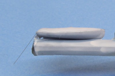

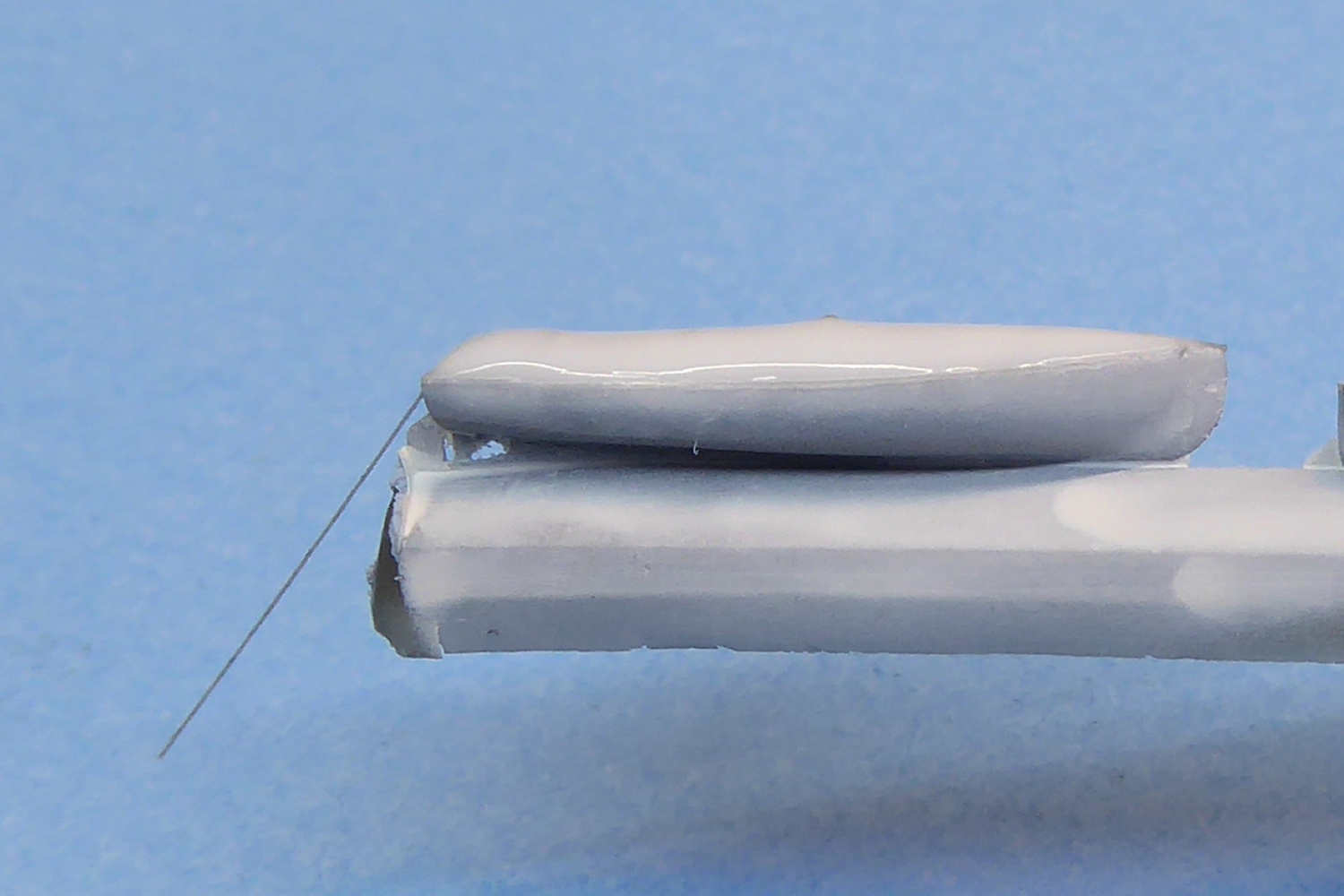

i decided to make these using white glue as its a medium I am happy with and can control the appearance and shape of.
To give a believable outline of a canvas covers spanning the high points, I made a ridge of stretched sprue
This is the first coat of glue going on ( 4 coats were needed in the end--more of this later )

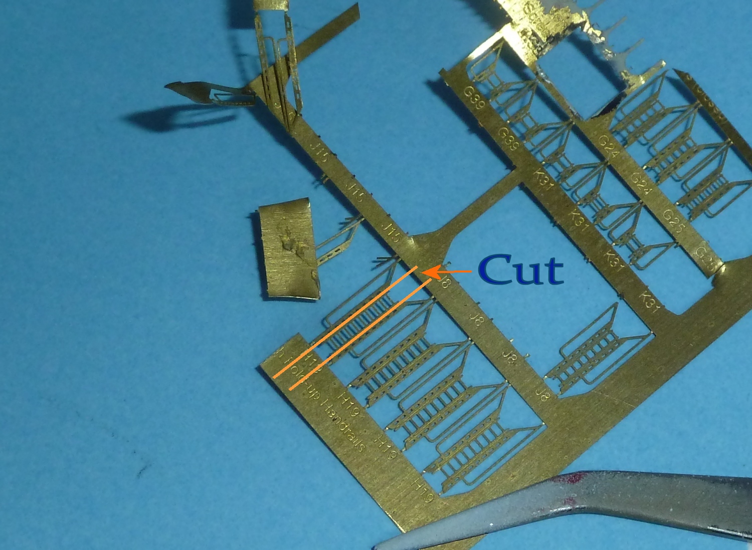

allowing for drying times ( dull!) I started to add the stairs

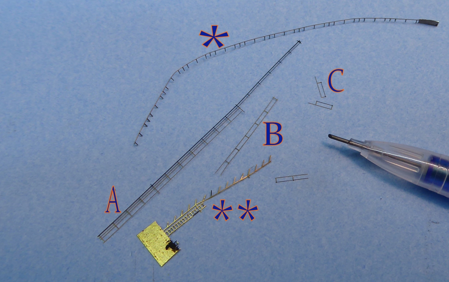

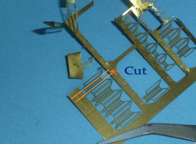

Commercially made handrails on PE stairs in 1/700 are almost always faaar to thick
so as to keep the light and flimsy look I took a different approach.
Cutting WEM ultrafine 1/700 asymmetric destroyer(?) rails down I was able to glean some suitable material
A B C illustrating the stages, single asterisk being GMM stair hand rail and double asterisk being the old ' normal ' WEM stair variant
( it all tok quite a while to do--the fail rate was very high! )
WARNING-- Excessively zoomed large closeup of 1/700 stairs shows my sloppy paintwork alas... :big_grin:

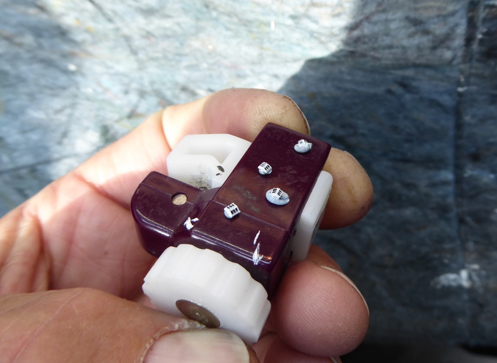

whilst engaged in small brass bits I decided to add to the fun using smaller still sized stretched sprue
and made the Cowl vent braces

Thansk you gents --from all you renowned and much respected modellers! ==> praise indeed !
marjinn wrote; ........ first time I have anyone seen making separate stair hand rails to get a finer result......
I have done this for years in 1/350 --as most commercial generic stair handrails start too low down to deck
and are --in my view--to thick
but also the last 10 or so 1/700 models of mine also had handmade stair rails
here is an image from the build thread of 1/700 HMS Majestic
these were made of thin copper wire-- this time I sought easy repeatability of pattern and thinner materiel still ! :smallsmile:
Return to “Completed Models”
