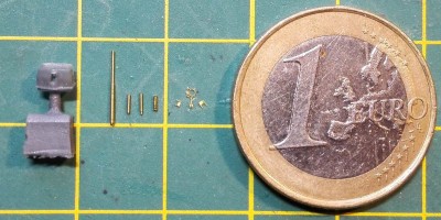

It was mentioned several times in the CASF thread that the default Pit-Road 12cm gun mounts were oversize and incorrectly shaped. So even before I decided to go for the complex Rainbow set I bought the Five Star 1/700 IJN 3rd Year Type 12cm/42 Gun (Type G Shield). These are more detailed than those by Rainbow, and also more precise, but also far more complicated to assemble � each gun mount consists of 9 parts incl. a deck mounting!
8 parts displayed, the ninth is a circular mounting base

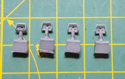

All three options are however incorrect in one aspect: they depict the gun shield as if it had a bottom while in fact it was a very simply shaped partial splinter shield only. I solved this by carefully (remembering the bridge disaster!) milling out the exposed bottom parts as well as making the shield sides thinner. I also sanded down the back and bottom sides of the shield slightly according to the Asanagi broadside photo.
The original part before modification to the left, others already modified
This is how the completed Five Star gun mount looks like compared to Pit-Road (left) and Rainbow (right) � it definitely comes out much closer to what can be seen on Yunagi/Asanagi photos.
