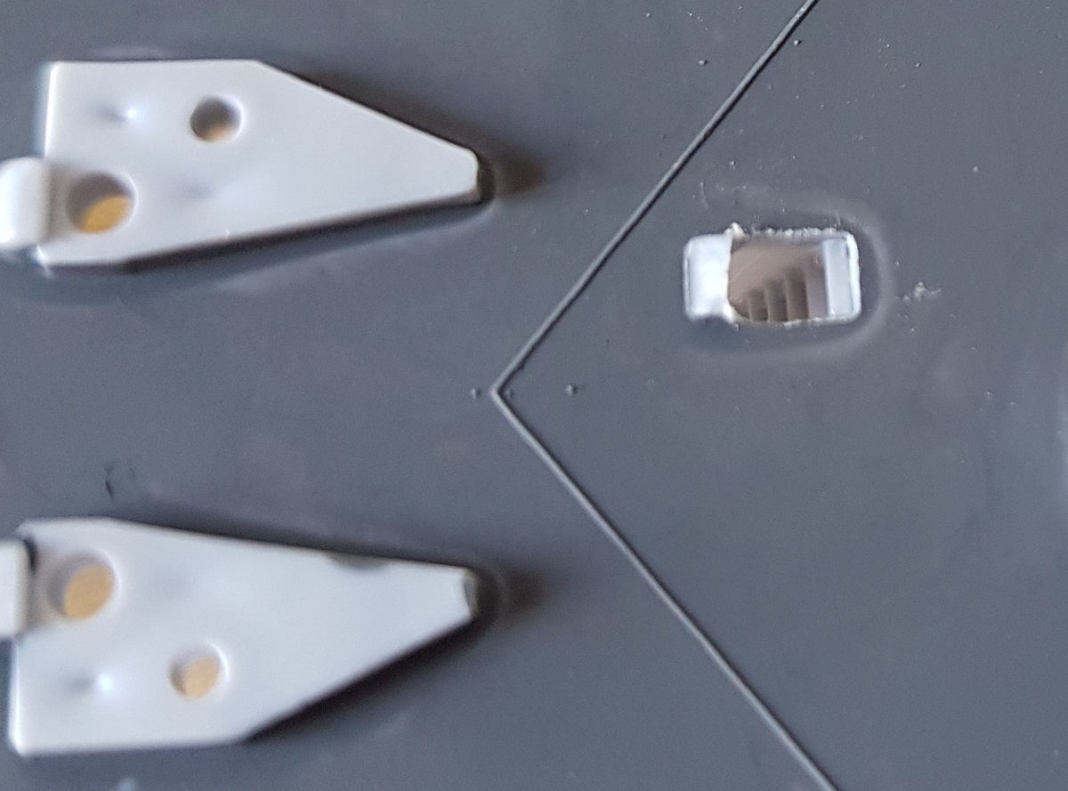

Post by Triumph68 »
and from above ..it looks like this...yes some fine tuning to be done...
next is a new top part...one that is 2/3 open so you can see the stairs

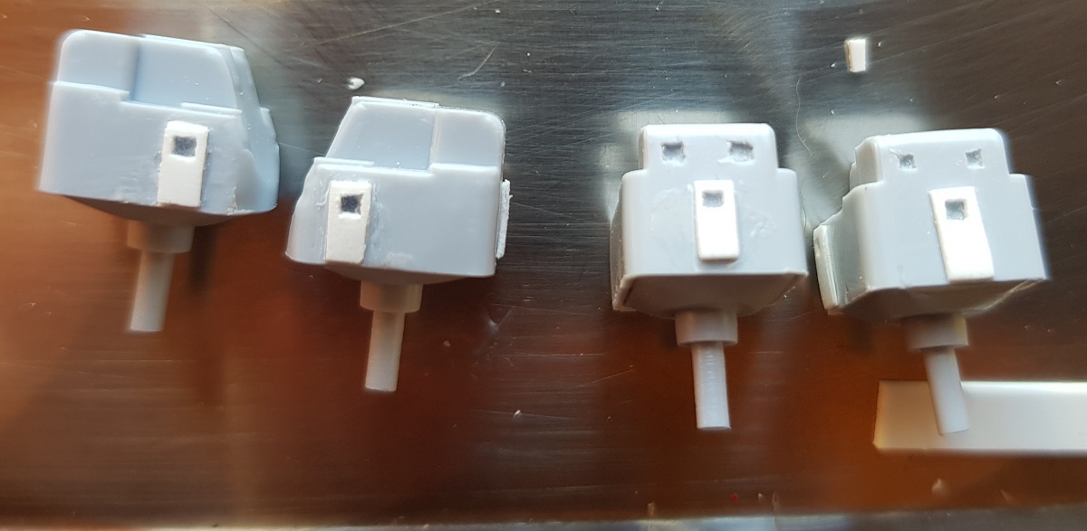

worked a bit on the 127mm gun directors
Triumph68
Posts: 1125
Re: De Grasse Heller 1/400
Post by Triumph68 »

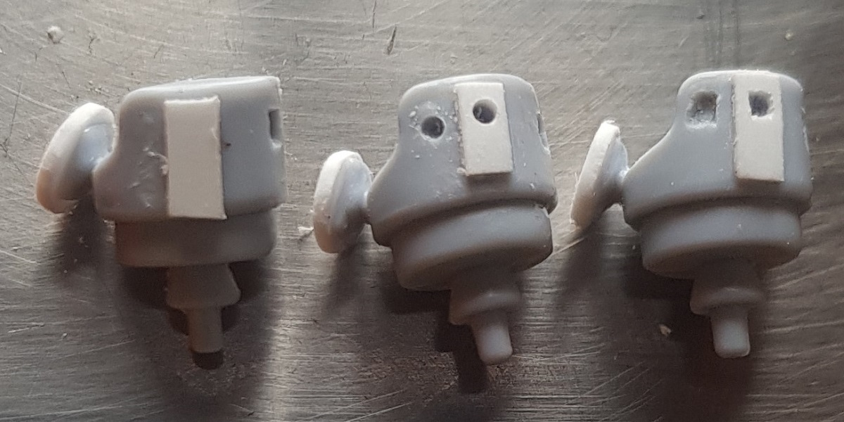

DavidP wrote:the doors on the left & right sides of the directors are not there. what thickness of plastic are you using for the doors as seems to be a bit to thick? where the windows on the back of the directors already there or did you make them as the right window should be on the director centerline above the back door?
actualy...I think there is .. a gliding door, probably to have access to the radar on that side.
You clearly see a line above the window on capture 2 giving top side of door....well...anyway..thats how I interpreted it
I only did a side door on radar side...so 2 have it on the left side...and 2 on the right side
the plastic used is as thin as I have....ones glue hard..then limed off to min ...there must be hardly 0.2mm left
these pictures are what I used as refference
I made the windows on all...No such details in the kit

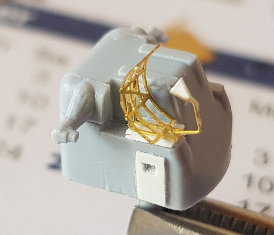

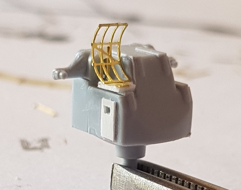

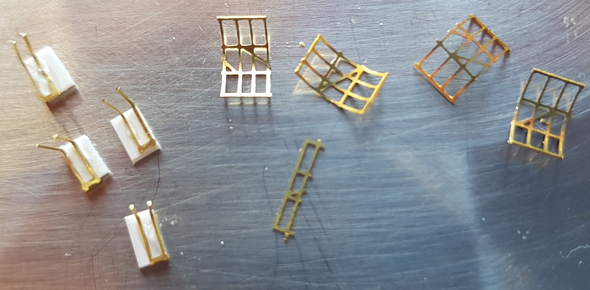

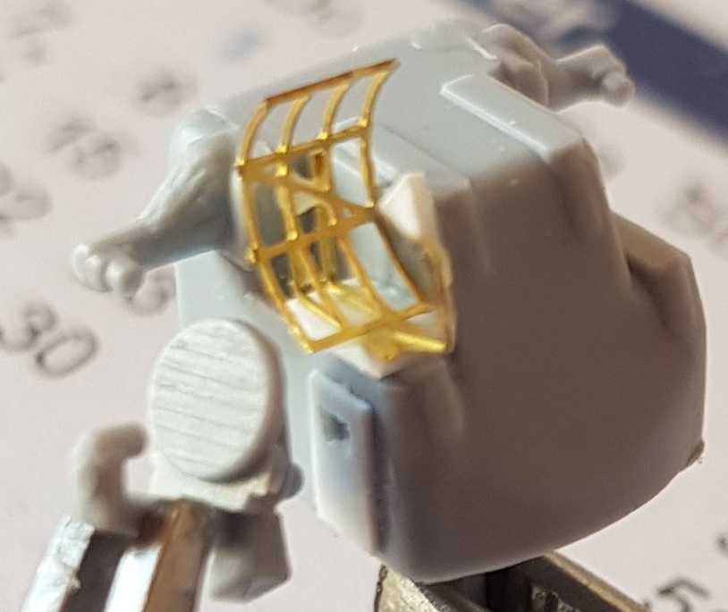

continued on my gun directors....the radar...heller kit radars for these gun directors are...awefull...not only wrong form (heller are round as real ones are rectangular) but also...well....hellers
so I deceided to make my own...had a radar grill left over from the Adm.Scheer PE ug kit...cut it in 4 equal parts...took 2bars from a 4 bar railing and a piece of plastic as base....
Triumph68
Posts: 1125
Post by Triumph68 »
looked to my view ok....but something missing...took 1 bar of a railing...bend it twice...added a fine cut plastic triangle....will place it better once glue is dry

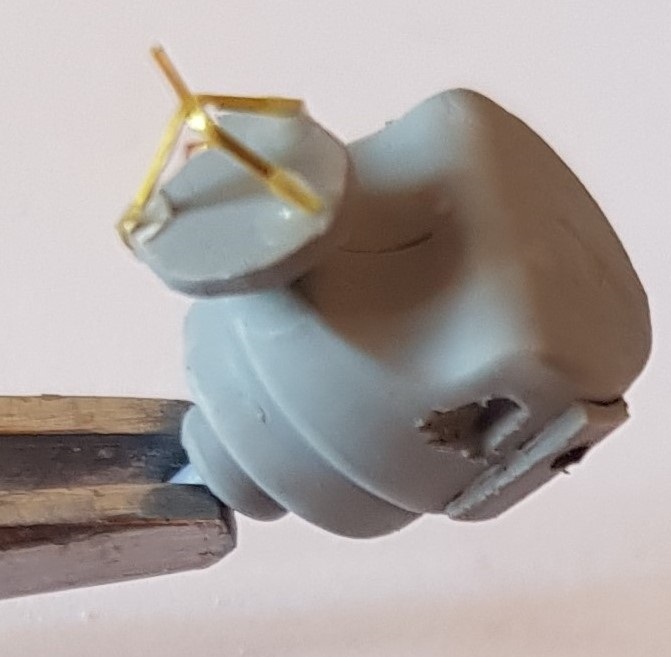

lets get serious...somebody working at heller realy wasn't very....perceptive....
the radars for the 127mm guns they made round...they where in reality rectangular
the radars for the 57mm guns they made...rectangular....and they where ...ROUND.....pfff
so gonna modify all 4

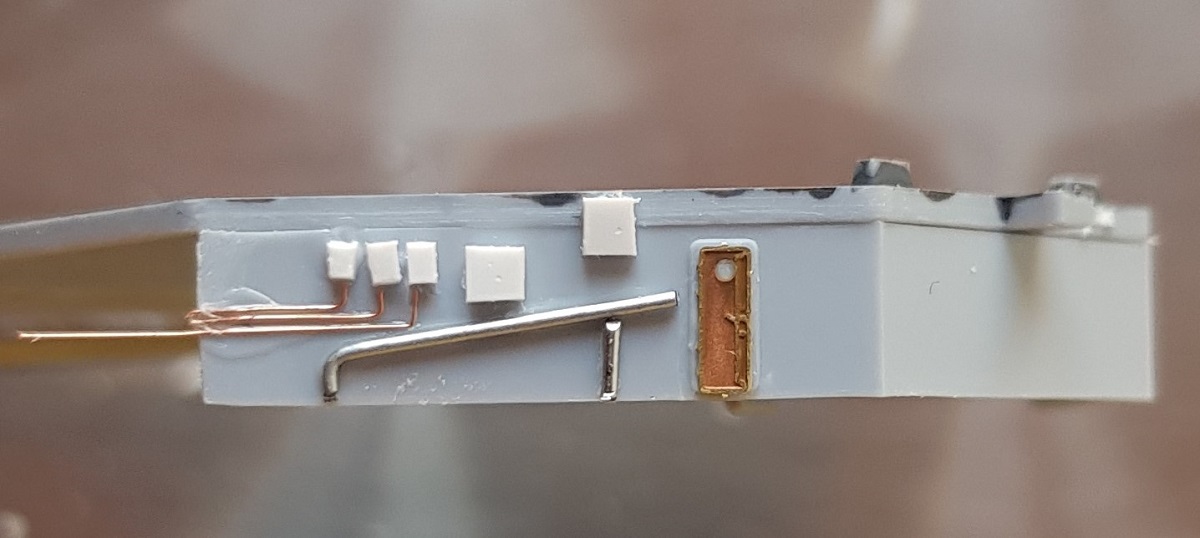

Post by Triumph68 »

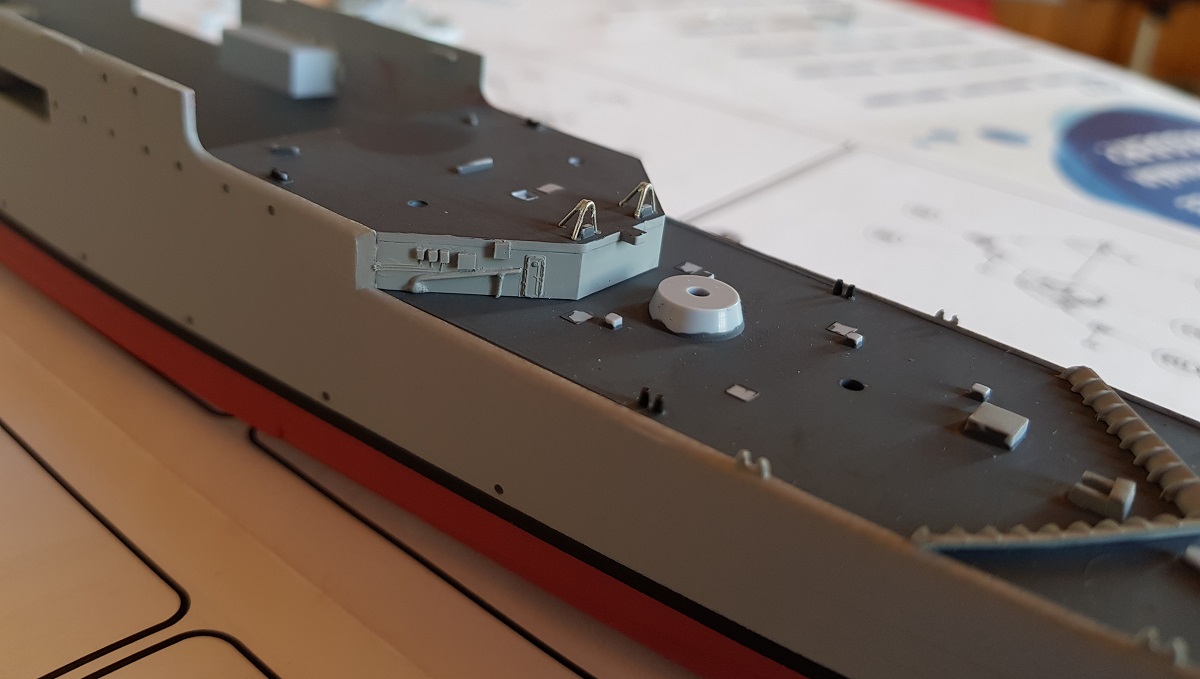

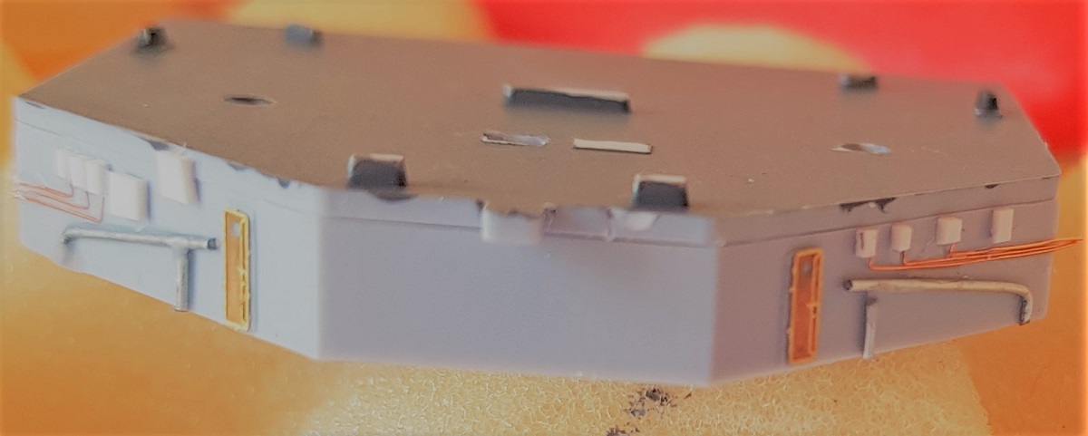

added some stuff on the wall from the front main deck up to next level...mind the fine copper wire is 0.1mm....once all painted grey...it will look better...but wanted you to see how I did it

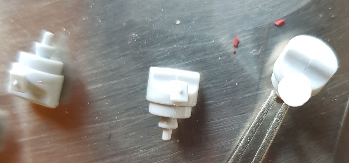

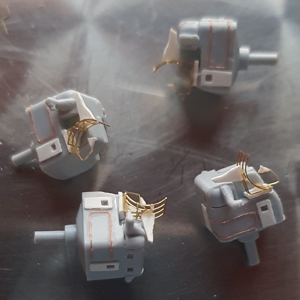

the 57mm directors are taking shape...3 steps shown
Triumph68
Posts: 1125
Post by Triumph68 »

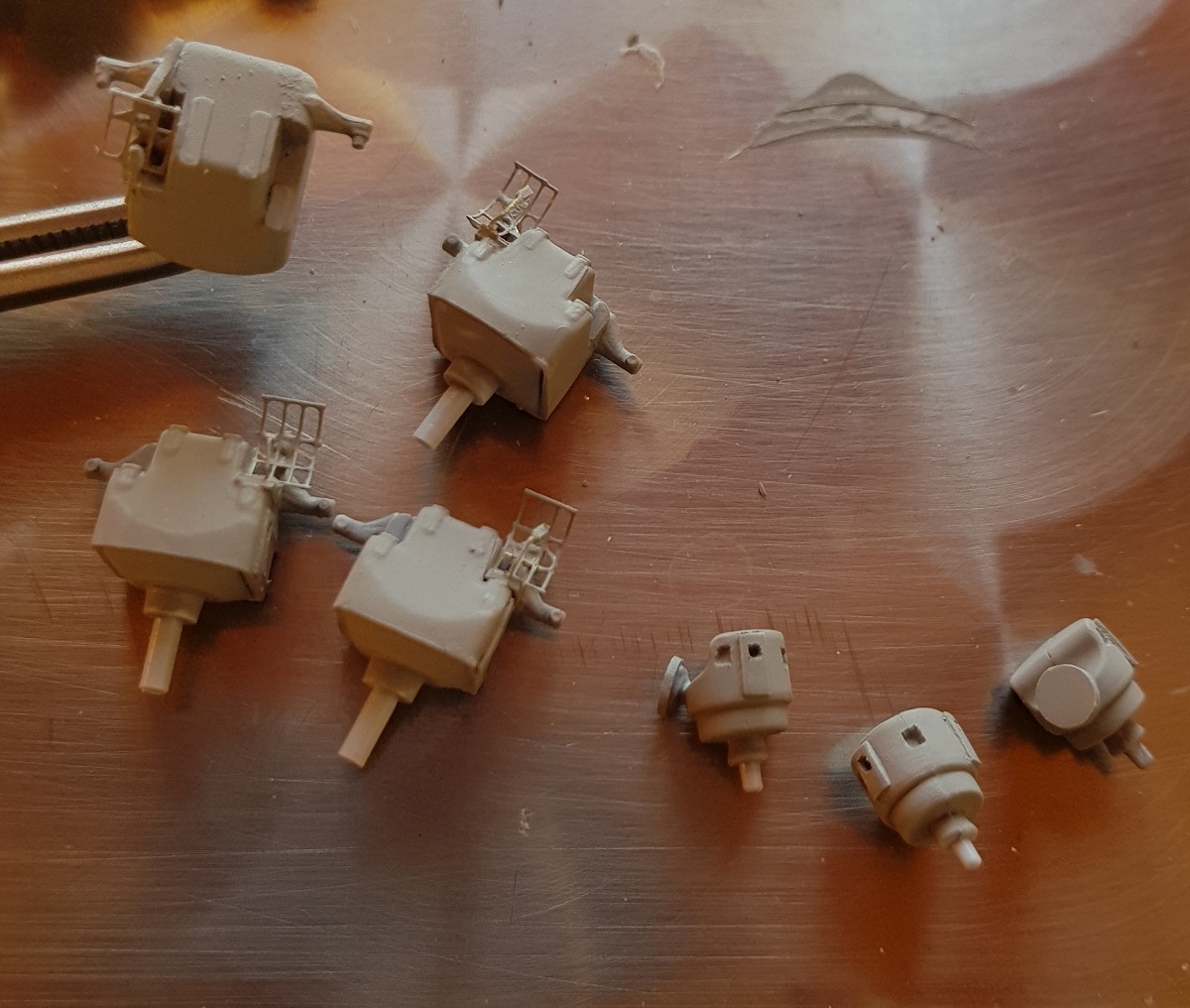

all directors are now almost done...a few fine tunings here and there to do
and btw...I now know for sure the 127mm had that gliding door...even one on each side

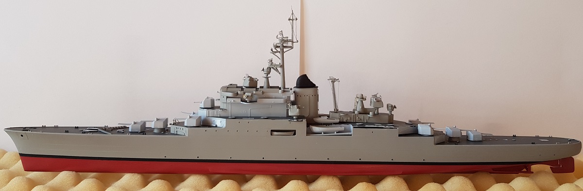

couldn't resist dry fitting all I have...
