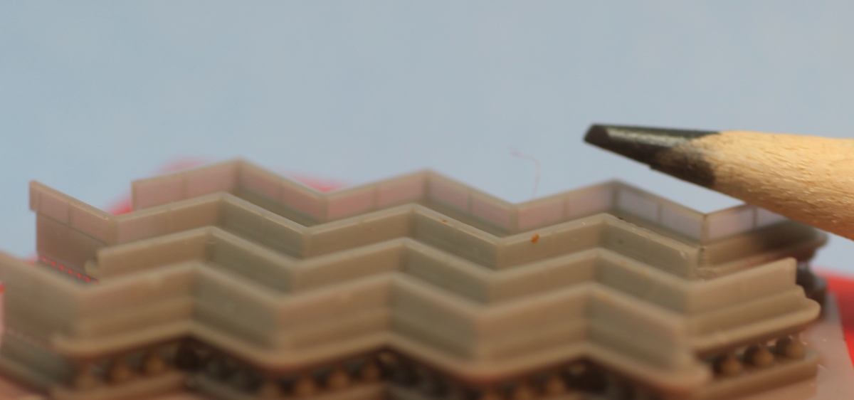

...The early version of the ship--with the "zig zag " seating ( and the above mentioned lamps)
My casting of this deck was not all that flat , bathing in hot water and heating made it flatter, but still not that good.
I also did still not much like the seating, as the casting on the undercuts was a bit lumpy
and in any case the seating would make the fitting of the paper deck rather more challenging (!!)
hence off they came...
I planned to re-mount the seating on the new deck coverings on styrene strip plinths to regain some sharpness
but cut around and clean up as I wanted--they did not look quite sharp enough .
( more precisely I could not get them sharp enough
Most models of this ship in this fit , even in in much larger scales, always seem to depict the seating in too lumpy a fashion
So I had some replacements 3_D printed! :cool_2:

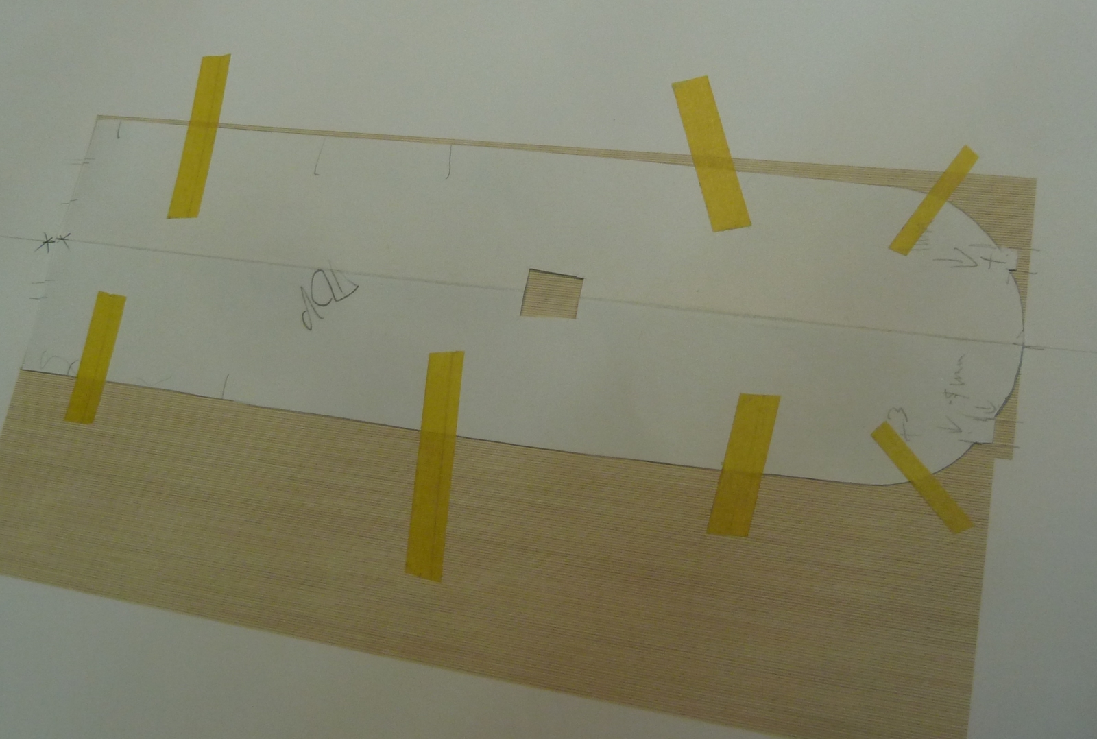

I turned my attention - for light relief (?!) to making the deck-templates
There are a a lot of decks!
and...
more fiddly and tricky then expected again-- no quick build here for me alas it seems !
The fwd well deck had a quite a convulated process to get 1 x end result template
others were simpler
some need a lot of fiddling to get right...
But all of them needed careful alignment to get squared with the planking runs
( often with a repeat cut needed --easy to be sightly out of alignemet !! )
or equally frustrating - a small bit of pulling to the upper layer of paper... !
all these decks were printed on 100 g dead flat high quality non-grained paper on my home ink-jet ( canon MG 3600)
using the best quality print it had.
I did try a commercial laser printer ( horrid result) along with other printers-with no significantly noticeable improvement over my own home efforts
BUT... once marked and cut
I varnished the undersides with Humbrol matt-kote first
and then turned them over and varnished the tops also
so as to make the paper decks impervious to moisture or dis-colouration when gluing...
which will be a imminent in-near-future report!
More soon
JIM B

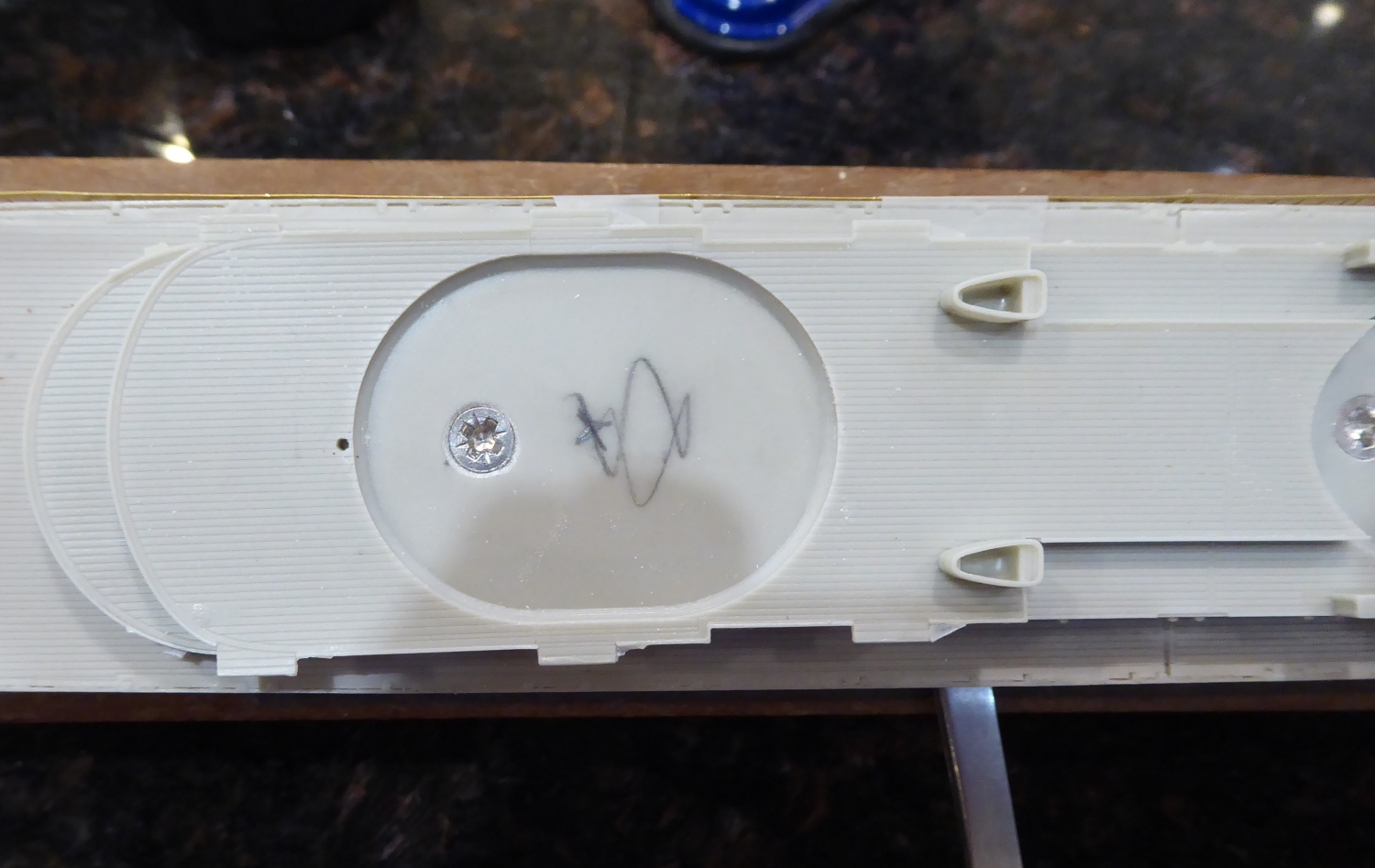

anyhow-- onwards-- still removing more than adding it seems.
so as to allow the PE and the paper deck to sit 'down'--in addition to having pared the decks down to accomodate the paper.
I have been digging out at the base at the superstructure verticals.
The resin is quite a soft variety-- so the digging is not terribly elegant or " engineery " in appearance
but it is results that count ... ( I hope! :wave_1: )

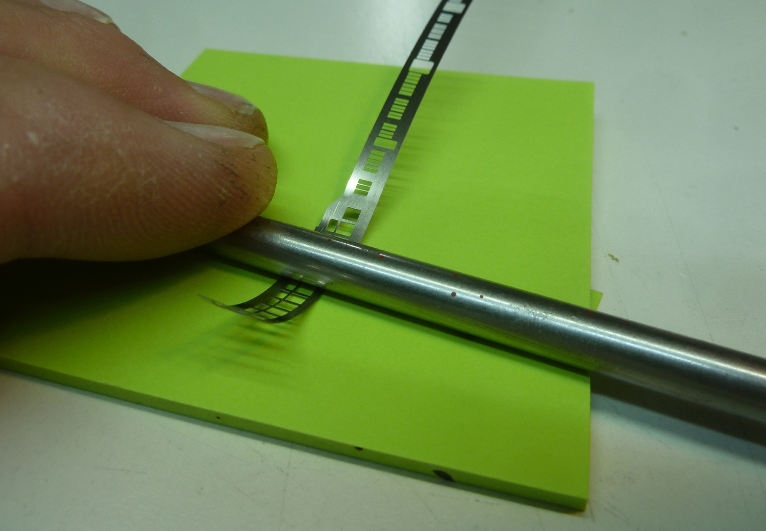

I have now pre-bent the superstructure sides in stainless steel
a rather more demanding task than in brass... (!)
with considerable downward pressure being used when rolling the shafts across the PE
( on a post-it note block--which has very slight 'give' in it...)

My original hull casting had a rather dished life=boat deck deck, which runs from fwd to right aft.
==> which was alas noticeable to the naked eye
The deck superstructure that sits atop that , tediously had a warp in its horizontal plane,
that I failed to straighten with heat , oven and hot water
