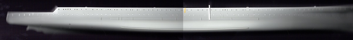

My next issue with the Trumpeter kit: the portholes (scuttles) in the hull.
It seems the designer had no idea about the frame locations, only the five most forward scuttles behind the anchor hawse pipes happen to be correct, the rest is useless. I had to fill them all and drill new ones, port and starboard are different as with most ships. Note in particular the series of small scuttles on port, where the seamans' heads are located.
Also the lower row of scuttles with blanking plates sit incorrectly, and the plates are too large and too thick, so I replaced them all with discs of 1.2 mm diameter. A few will need to be opened up again though, based on photos.

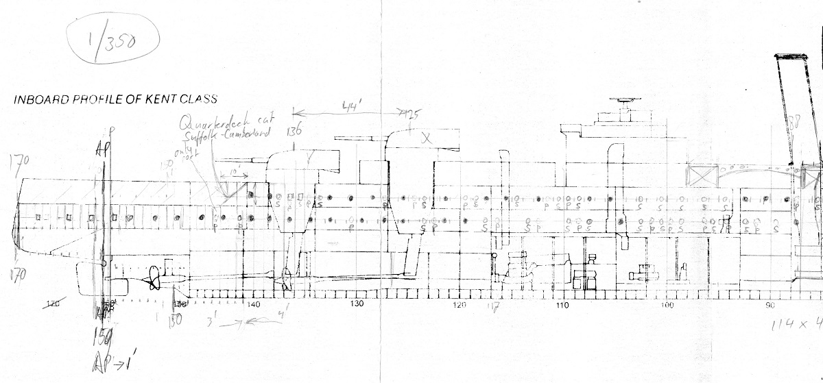

To get everything right for the Suffolk I used the inboard profile plan from 'Man o' War 1 - County class cruisers' as a basis, rescaled it to 1:350, and checking carefully with photos. This layout differs slightly from ship to ship, but is generally usable for the Kents. The Londons and Norfolks are again different though.
