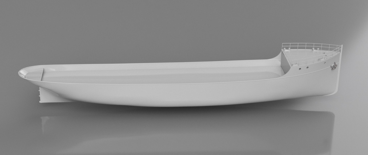

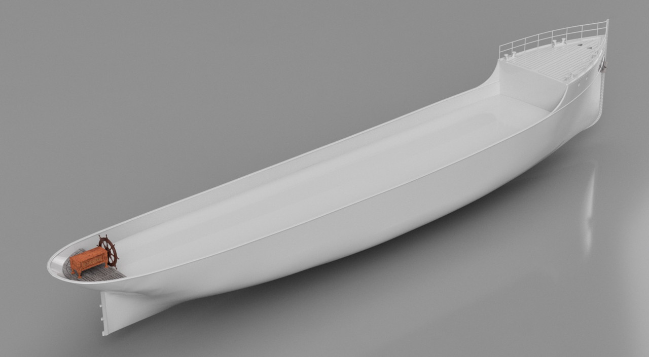

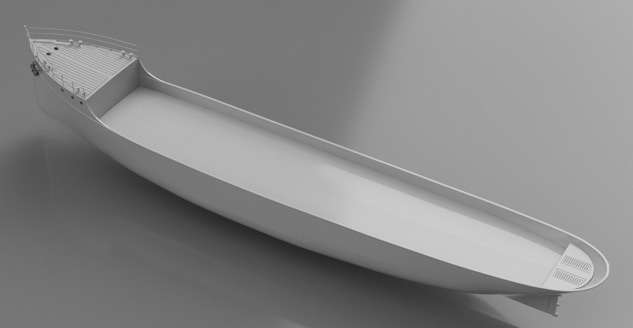

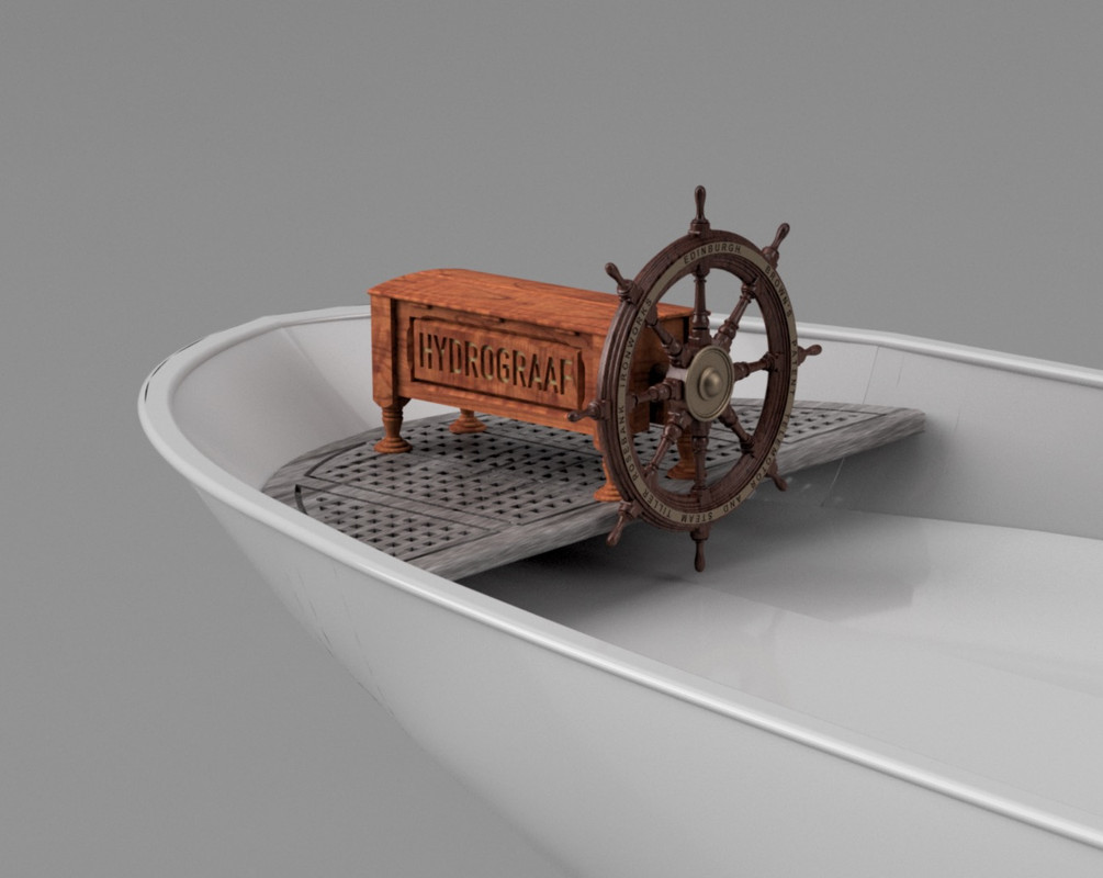

End of hull hollowing. Started the rear grating where the steering wheel and gear are located.
Pascal

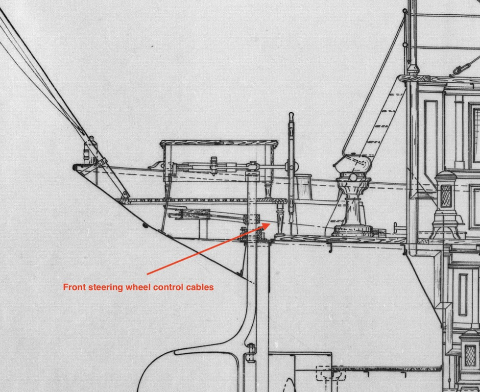

Re: SS Hydrograaf, 1/100 3D, hydrographic ship, Royal Dutch
The grating covers the rudder quadrant that itself is connected to the bridge via steel rods and chains. In the back there is only the emergency steering apparatus.
Eberhard
Small progress on the emergency steering wheel system. It's not finished yet.
I did not remake a wheel, it is in my 3D drawing stock that I made and was intended for the Nomadic.
I would just delete the English language markings on the wheel.
From the rudder shaft below, the stern wheel will rotate along with inputs from the pilothouse?
This was the standard arrangement until hydraulic systems came into use, I gather after WW2. On bigger vessels the steering apparatus on the bridge was steam assissted.
It is not clear from the pictures, but it looks as if on the real ship the emergency steering apparatus is not connected anymore.

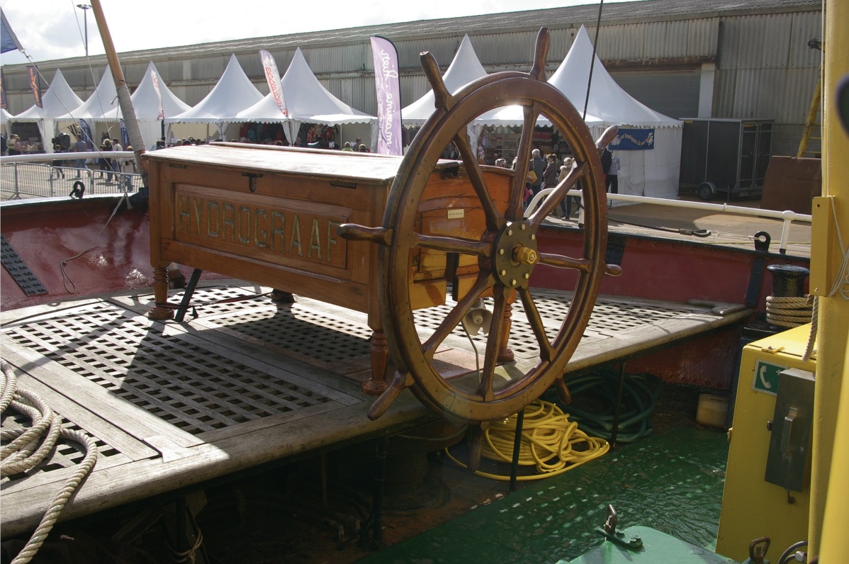

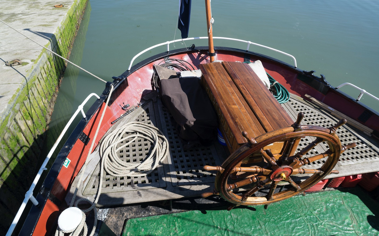

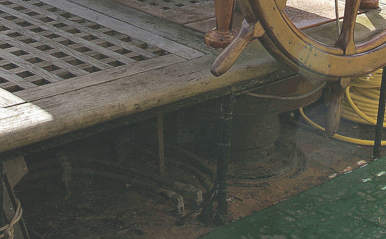

The cables were replaced by hydraulic cylinders probably later. This is safer and more powerful and less of a strain on the steering wheel, it also allows an autopilot to be connected, especially as the rudder has been extended aft to make the ship more manoeuvrable in port.
You can see the hydraulic hoses going down below deck to the 2 jacks.
You can also see the rudder stock and its stuffing box to the right of the hoses.

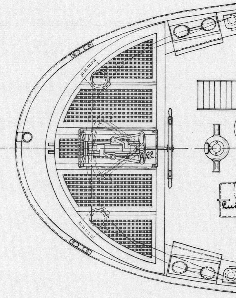

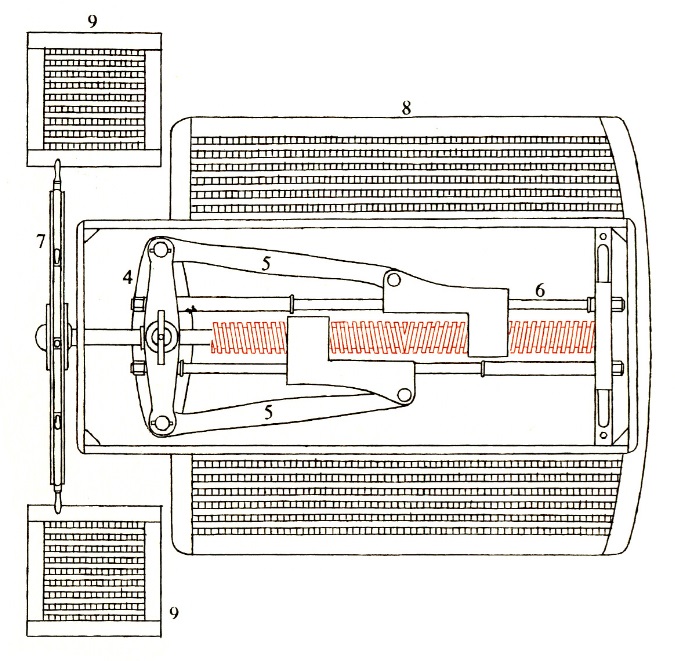

Hi Tom,Fliger747 wrote:From the rudder shaft below, the stern wheel will rotate along with inputs from the pilothouse?
Most interesting historical documentation!
Regards: Tom

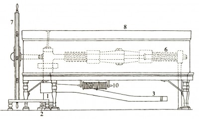

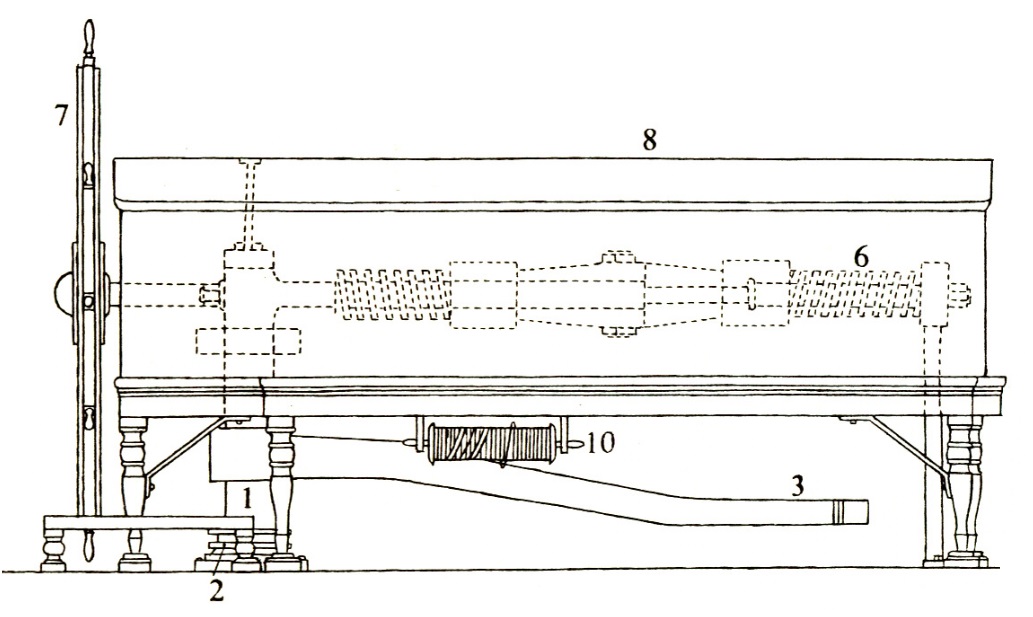

I don't think so: the emergency steering apparatus is probably using a screw spindle, to act on the rudder stock via a linkage. The side view indicate something like this: As you know, it is impossible (due to friction) to make the spindle turn by the rudder pressure through the linkage. This is also made for safety, that the steering wheel cannot be sent spinning (with great danger to the crew) by an incoming wave. So the transmission is not reversible. Therefore there must be a clutch to connect the emergency steering mechanism to the rudder stock.
(Image from this Dutch site: http://zienenweten.blogspot.com/2015/04 ... s-dat.html)
Actually here the corresponding top view from the Hydrograaf itself, from the Dutch archives drawings:
Roger Whittaker +9/13/2023
- wefalck
- Posts: 2124
- Location: Paris
Thanks, Maarten, I just had been looking for an illustration of a screw streering apparatus to show this. A screw with a certain maximum pitch is self-locking, meaning that you cannot turn the spindle by pushing on the nut(s).
Eberhard
Thank you! An interesting explanation of the mechanism. My small airplane uses a jackscrew for the stabilizer trim and likewise air loads on the stabilizer will not spin the handle in the cockpit. A breaking of the nut on the screw will allow the surface (such as the stabilizer on a jet aircraft) to move without control such as happened to an Alaska Airlines jet off Los Angeles quite a few years ago.
What I was originally thinking of was the rather old time use of ropes, drums and pulleys from the age of sail. When we know how and why a system works we can better model it!
Again Thanks!
Again Thanks!
"When we know how and why a system works we can better model it!" ... Exactly, I actually have difficulties to model something, when I don't understand it.

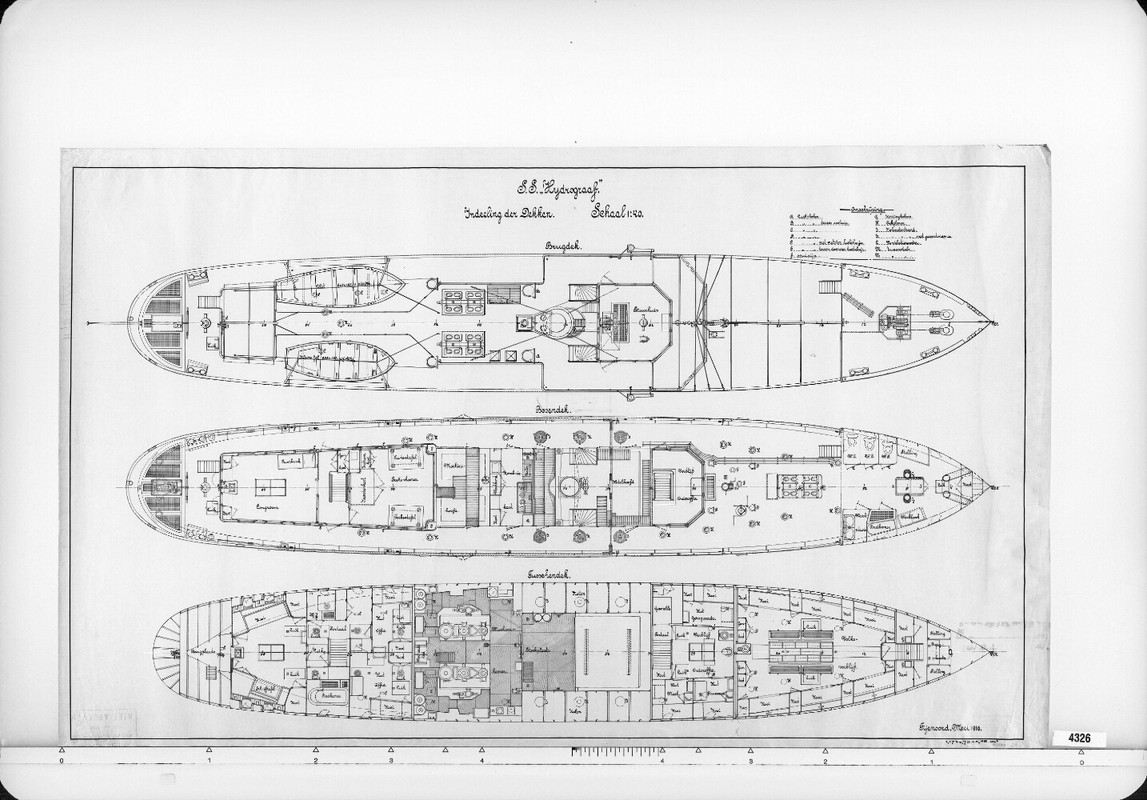

@ Maarten, thank for the documentation.
I'm missing this top plan which handicaps me a bit to continue the drawing of this ship. I'm afraid of drawing nonsense, that would be a shame.
If you have the link to the archives, I'm interested, thanks!

I've found the missing plan in HD ans some others, very usefull !
https://www.nationaalarchief.nl/onderzo ... ~4322-4323
https://www.nationaalarchief.nl/onderzo ... b=download

Pascal,
https://www.nationaalarchief.nl/onderzo ... ~4324-4340
Enjoy!
