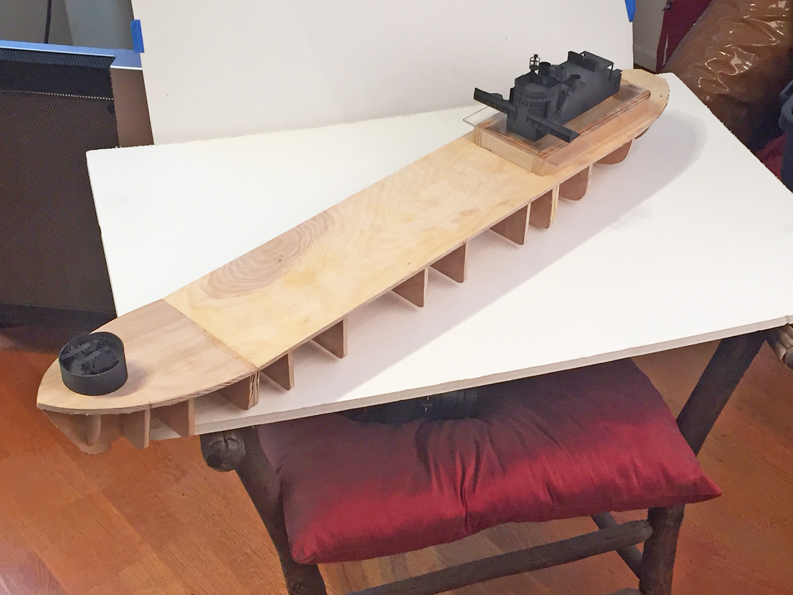

Since my inland shipyard is using unusual construction methods I laid the deck instead of the keel for the hull. Building upside down at this point. Ribs for frames 13-31 in place at the moment (that's the straight part). The hard part is reducing the radiuses to allow for the 5mm skin thickness. That the hull bottom is sloped adds some complication, requiring a different height for every frame. To get a straight deck and bottom requires great precision here.

John C Nidermair of USN BuShips, sketched out the basic design of what became the thousand or so LST's of WWII, in a couple of days. Of course refinement took a while longer, but the basic form is seen to this day, without the hull profile for beaching, in about every tanker built since the 70's.
Here she sits today with the hull waiting for skinning.

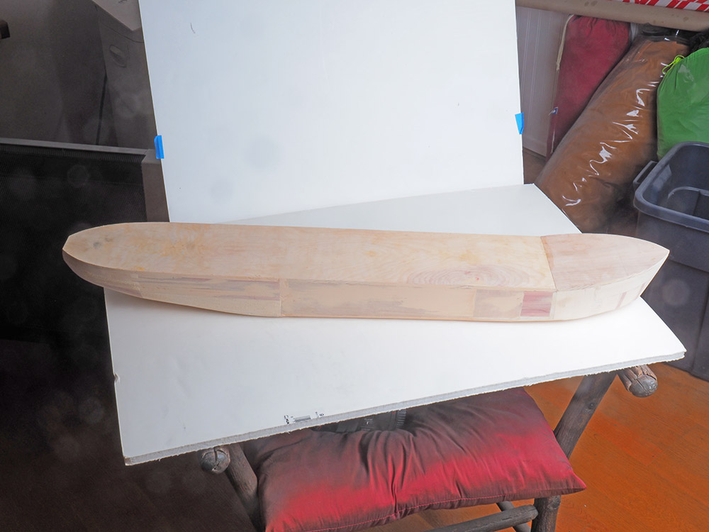

Post by Fliger747 »
The hull is closed in and awaiting wood filler to dry fully before I can do some contour sanding. After the contours are successfully achieved I will skin coat it with auto body filler (Bondo) with adheres well to the wood and provides a smooth, durable surface for final finished painting.
Today's progress on the hull. A little more sanding to get then bow and stern contours correct then I can skim with Auto body Filler (Bondo). In my experience such hulls have survived transport and temperature conditions for over 50 years without issue. Having a uniform color assists in gauging form and any defects. There are two knuckles aft which will need to be precisely gauged.
Overall hull length just under 33" with a 5" beam (1:120 scale).

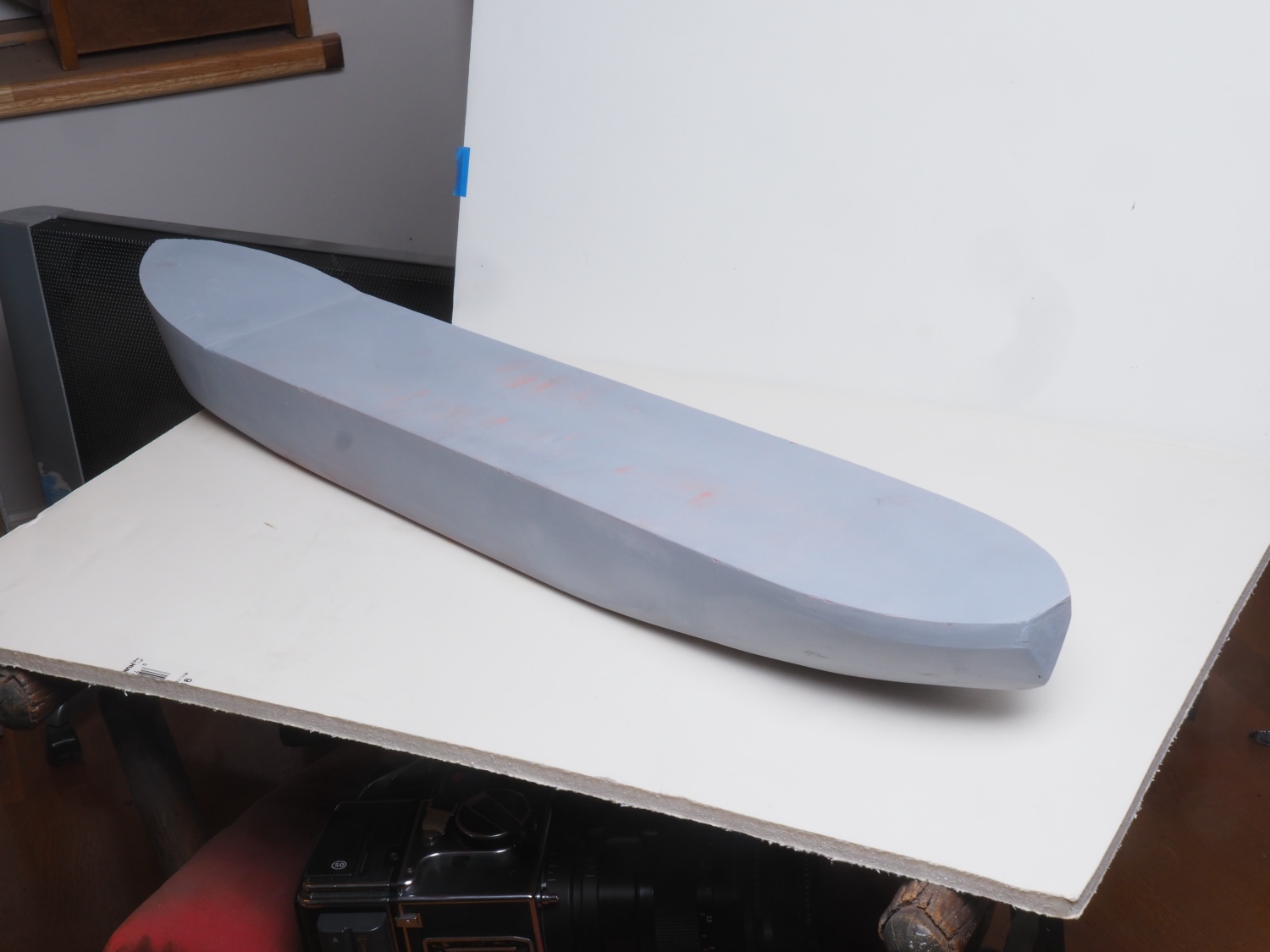

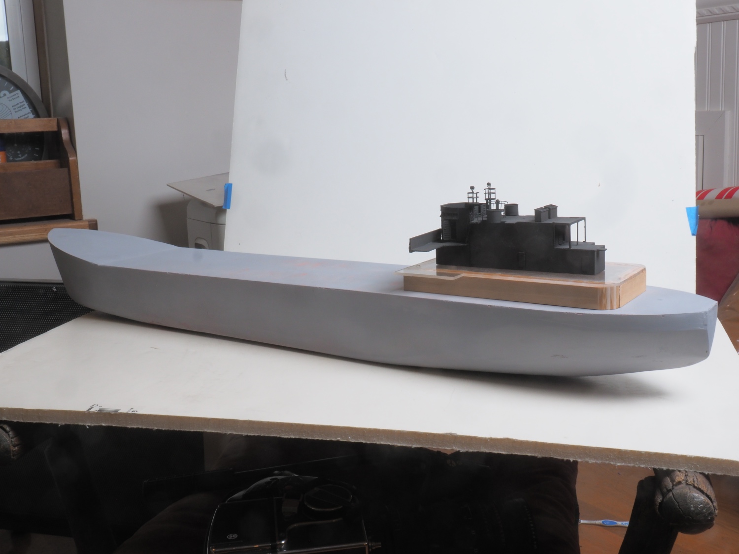

Current hull progress. I have shifted to a fillable sand able primer. The application of primer helps show surface defects and issues with hull form. More putty, sanding etc to tweak the hull contours. The most difficult is obtaining sharp and accurate double hull knuckles aft. Perhaps a sop to speedy shipyard construction.

BB62vet
