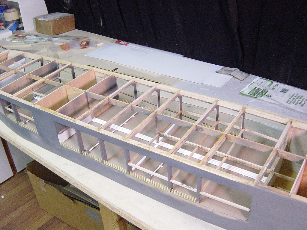

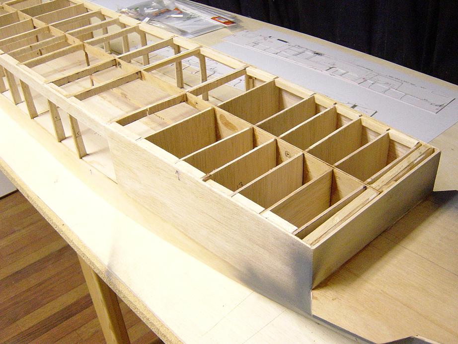

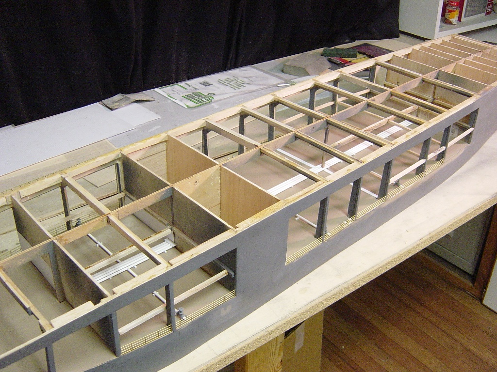

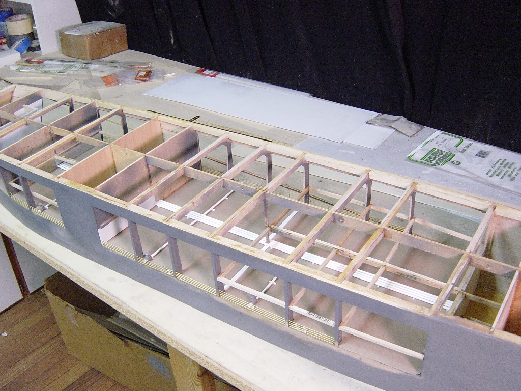

Here's a shot of the internal bracing for the model. Lot's of stiffeners have been added for strength, many of which you can't see. Since this is a Museum model, longevity is important. I got it pretty strong now.

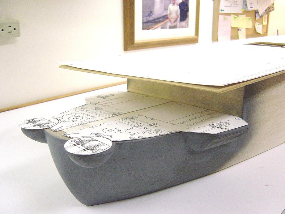

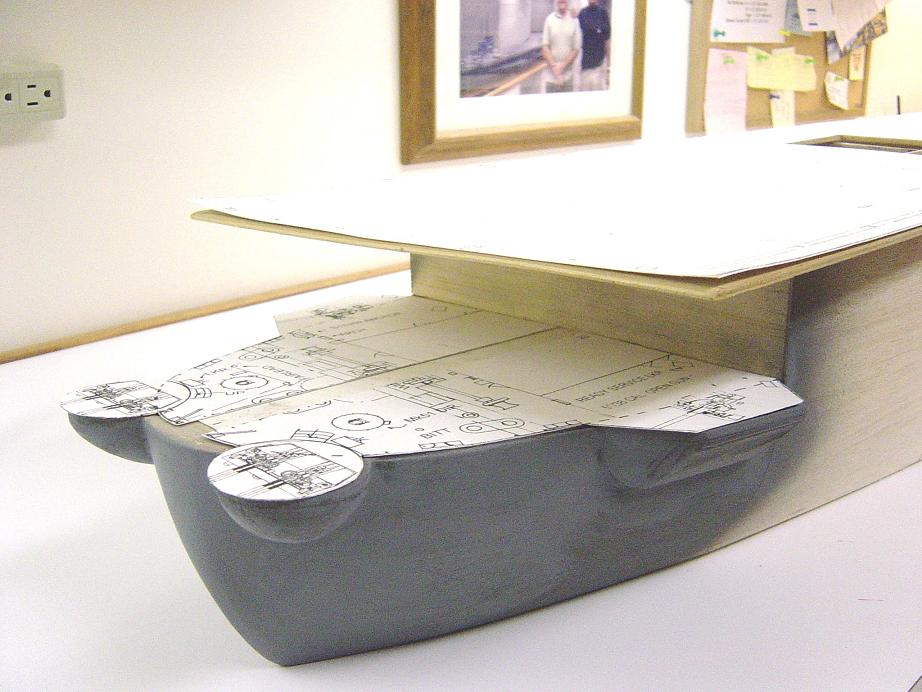

Stern view here. A bit rough yet, but you get the idea. Note the support sponsons for the 40mm aft quads. Made from air dry clay. Much to be done yet. Stern was formed in with autobody filler. Again, this is just the rough in, I'll fine tune things soon.

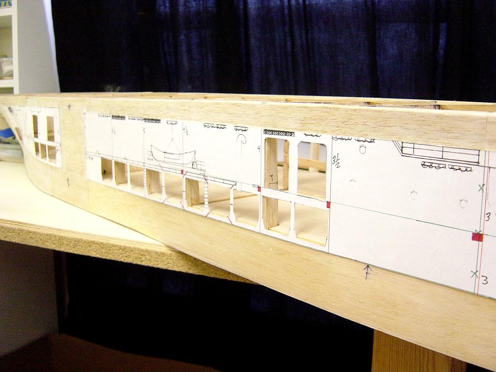

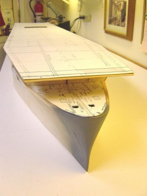

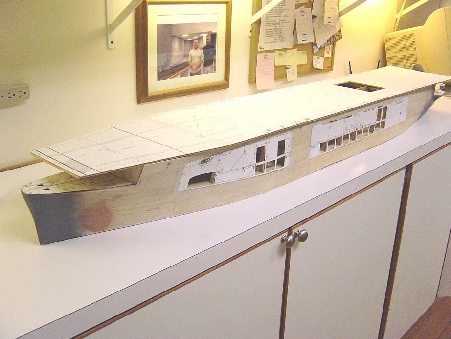

Port side here. Note the white material which is a paper pattern for the sides of the hull where there are openings. Sangamons were coverted from oilers, and the lowest openings you see were the main deck of the tanker. These are different slighly on port and stb. side. The openings above these are the hanger deck. I plan to detail out these areas as you can see them somewhat. These paper patterns will be transferred to styrene sheet and then attached to the hull after all balsa sheeting is sealed with epoxy resin, which has not been done yet.
Stb. side view here. Note I have formed in the bow with the autobody filler. Should look pretty good as a waterline model. Hope I can do as good as some I've seen here!

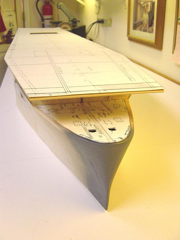

Another shot of the bow, Stb. side.Note the hawse pipe openings. All decks will be styrene. I've got to add the bulwark here yet and the anchor openings.

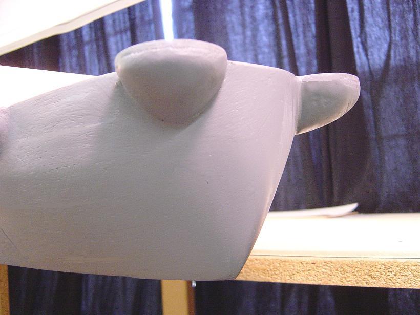

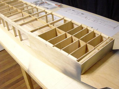

Stb. side view of the stern here. Again note the paper patterns. 5" gun sponsons made from solid pine. A bit of a trick to cut and shape! Much to be done yet but things are coming together.

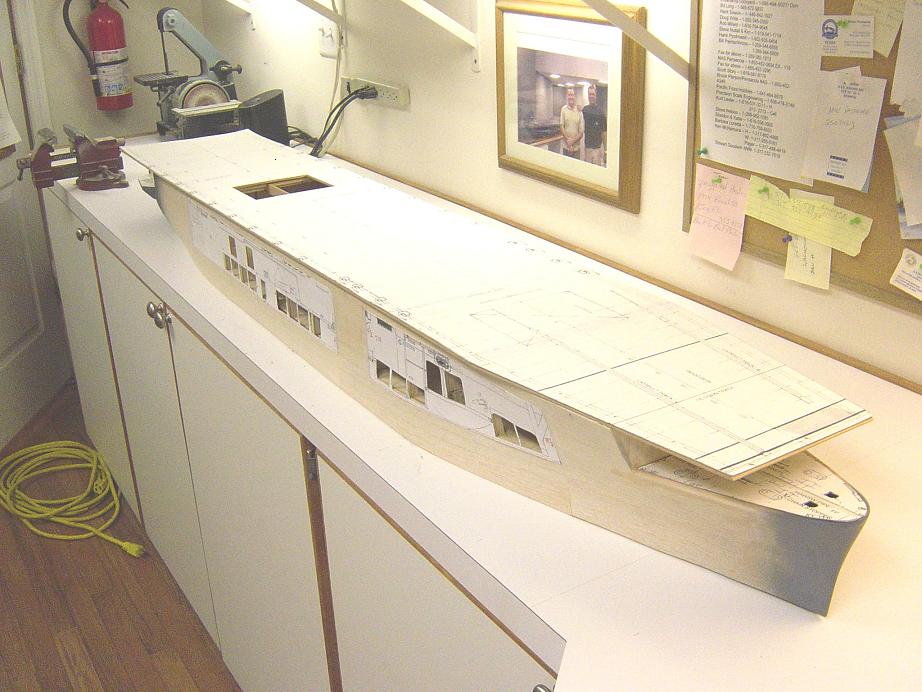

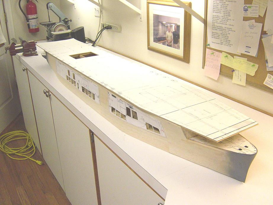

Port side view here. The photo on the wall is of me and Steve Nuttall. Remember him???? A great loss. I still grieve over that one.
Well, that's it for now. Next step is to seal the hull then sand, fill ,prime, etc. till it gets right. Should be another couple weeks before paintwork. Lot's to do, and not lot's of time. I'm plugging away as best I can. Hope you enjoy. I continue on................................Best to all :wave_1: :smallsmile: :thumbs_up_1: Bill W.

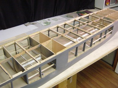

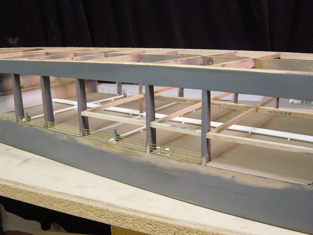

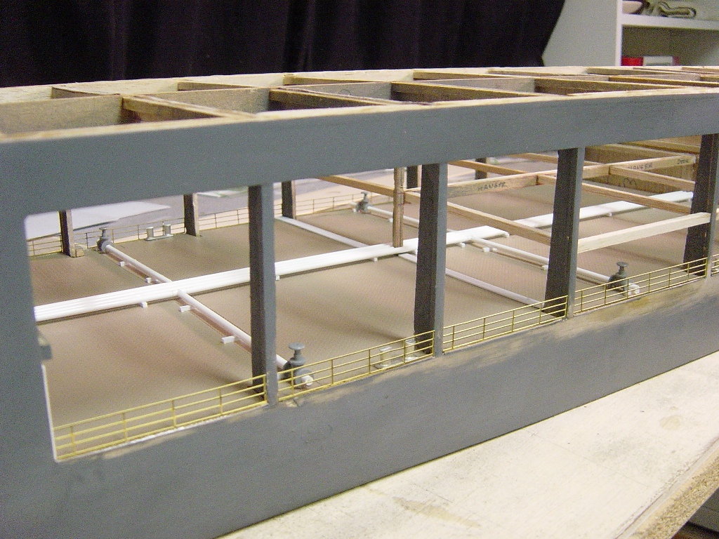

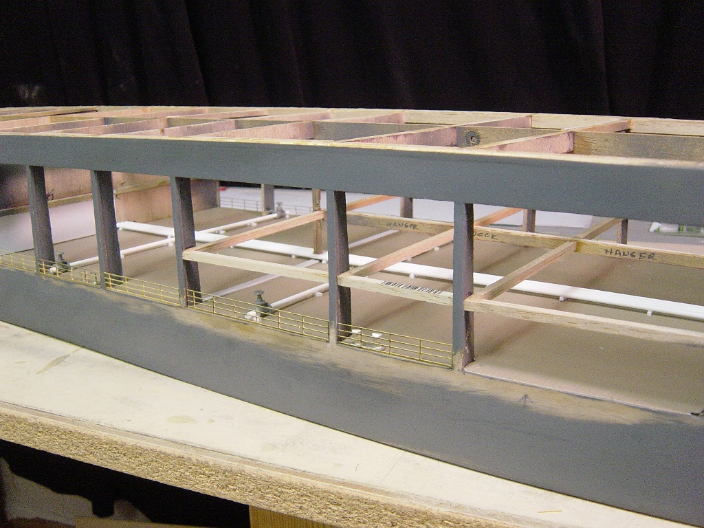

Heres an overall view from portside. Note the piping I have added as well as other details. This was rather difficult as I had to work inside the framework of the model. Not much room for hands!! Note I have beefed up the framework since my last post.

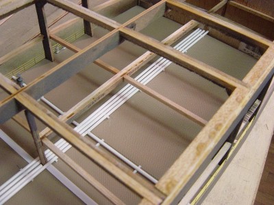

Here's another view,portside looking fwd.Note the main piping runs down the centerline of the ship while refueling lines run perpendicular to those. The Sangamons retained their ability to carry lots of fuel and to perform refuling at seas operations.

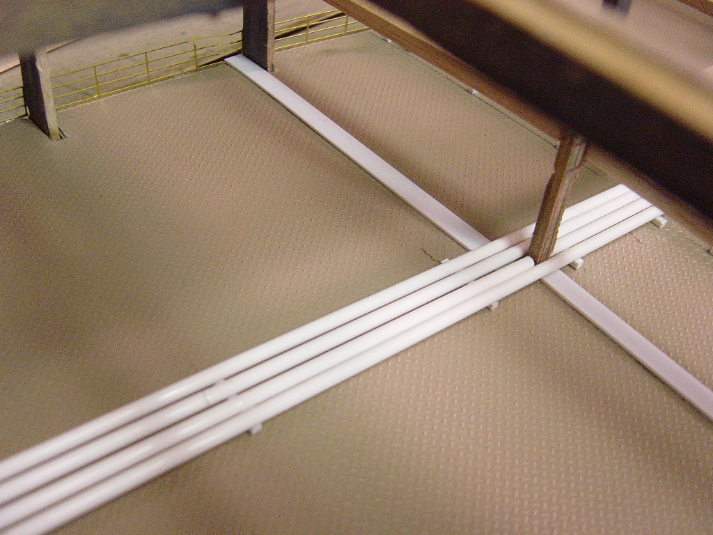

Here's a closer view of the diamond plating. Altough probably not totally accurate, I felt it was interesting nevertheless. Piping is 1/8" styrene tube. Note the expansion joint plating also.

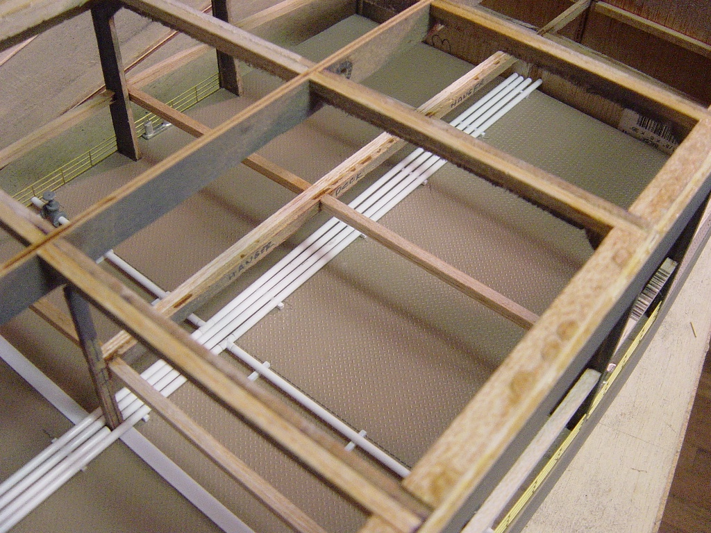

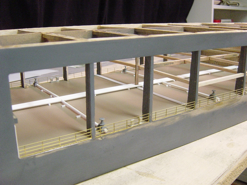

In this photo you can see the overall arrangement a little better. I have added the gate valves on the pipes the go outward to the sides of the hull. Again note the framework for the hanger deck floor, 3/16" balsa stick. Railings are p/e brass, other fittings are cast metal.
The hanger deck support can be seen clearly here. Once the main deck is painted I'll install the hanger deck floor and then add some aircraft which will be visible thru those hull openings. I may lite up these areas with some small 12V bulbs......any thoughts??

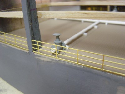

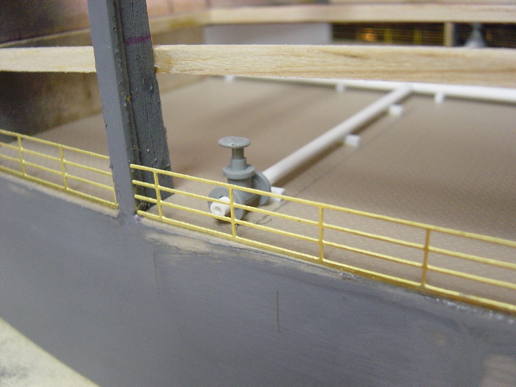

Heres a close-up of one of the six gate valves. Control wheel is a bit off center....oooop's!! I'll fix that. Valves are also from Plastruct Co. out of California.

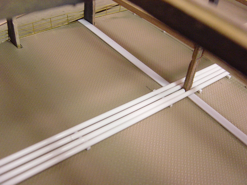

Here's a close up view. Note the diamond plating I have added for the main deck. Embossed styrene sheet from Plastruct. If you look close, you can see I have added the framework to support the hanger deck floor just above the main deck of the original tanker. Hanger deck does not run the full length of the model, but rather only where it will be seen thru the openings on the sides of the hull.
