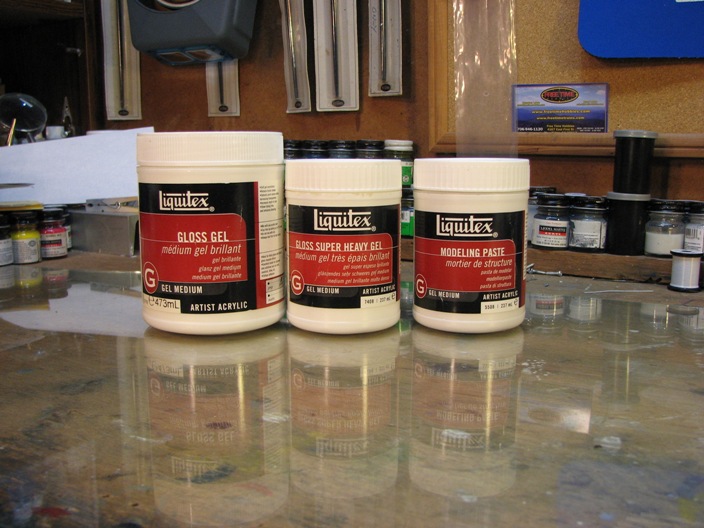

Cliffy,
Here are the three that I use.
Gloss Gel for flat seas.
Gloss Super Heavy Gel for larger waves and wakes.
Modeling Paste for larger waves and wakes. These are made by adding more thin layers.
