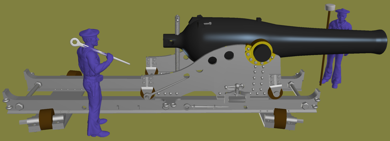

Finally, I "finished" the XI Dahlgren on the wrought-iron pivot carriage and slide. I may have to comer back to this one, but it's got all I can give it for now.
As it's one of the guns in my Guns of Constellation project, it's the one I actually need to print, though my first try at this failed because of a hole in the FEP and resin leakage to clean up.
XI inch on iron pivot
3D model of XI on iron pivot

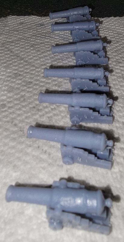

I loaded the gun into the slicer and scaled it from 1:36 to 1:100 and printed 7 of them. It took three tries, but using fatter supports on the last try did the trick.
1:100 scale 3D prints
