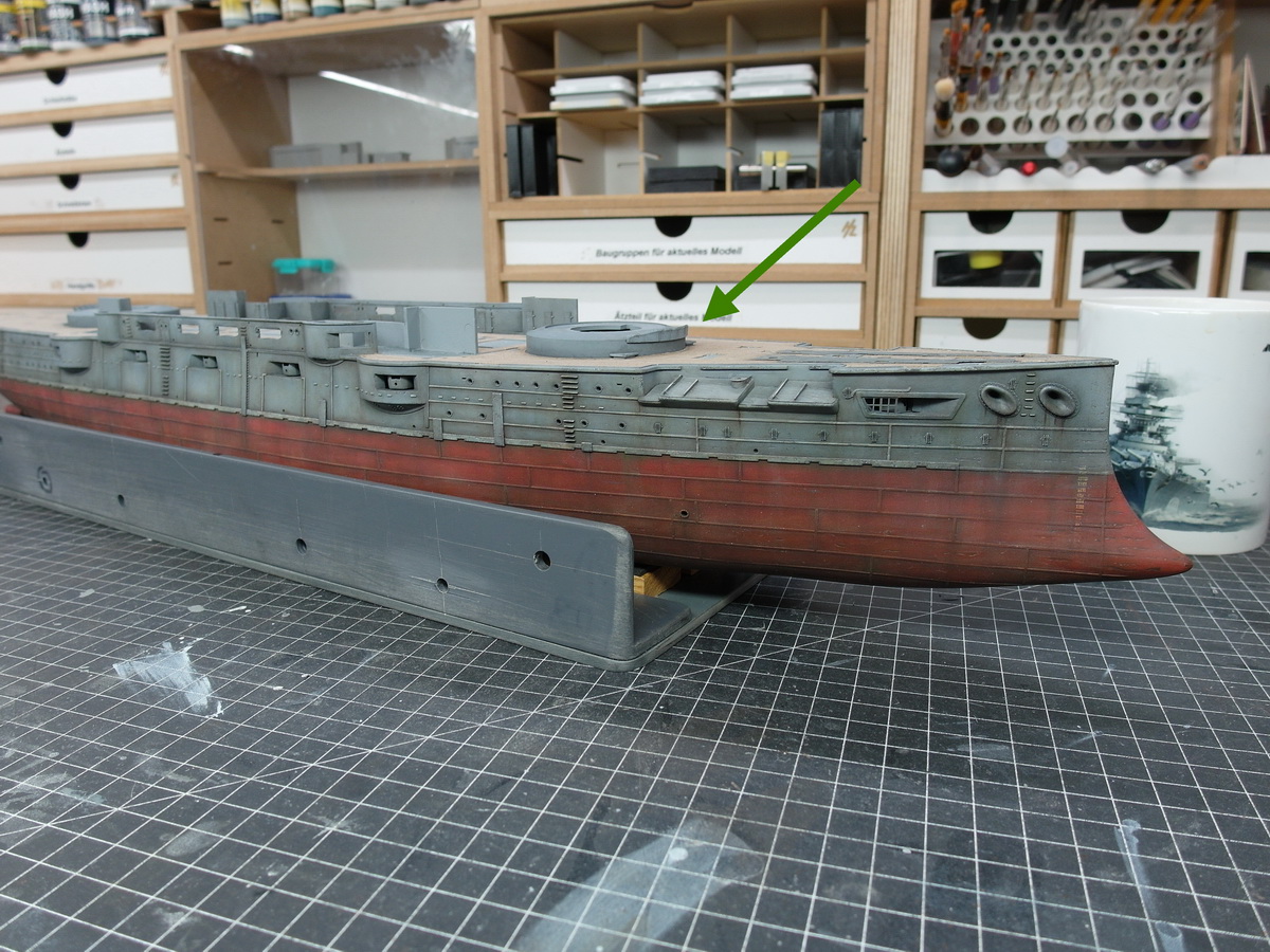

Re: 1/200 Pre dreadnought battleship IJN Mikasa after 1905

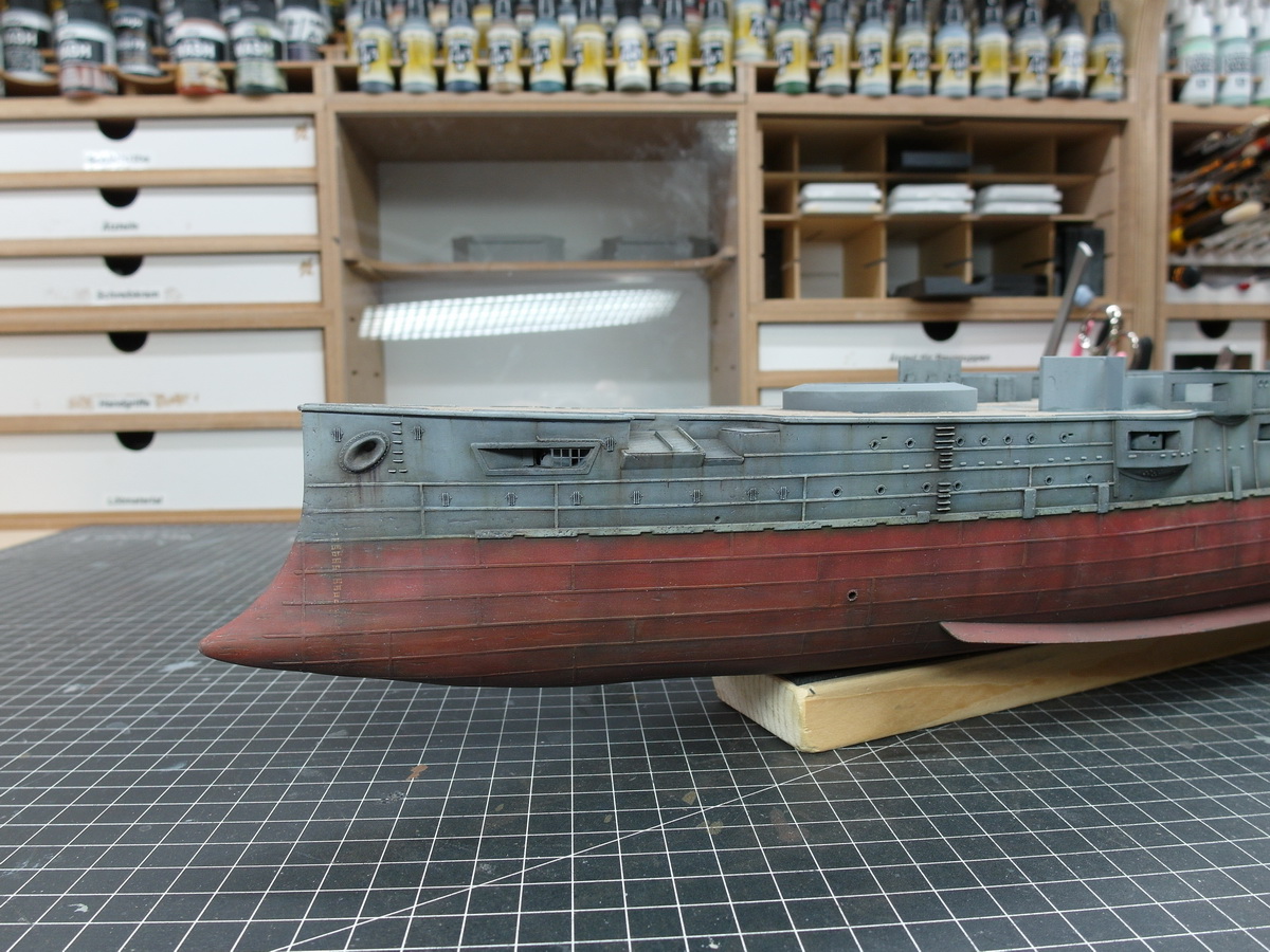

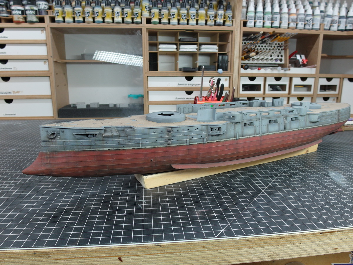

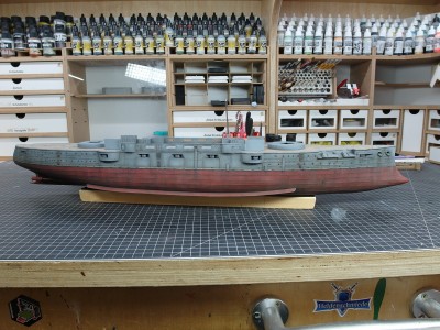

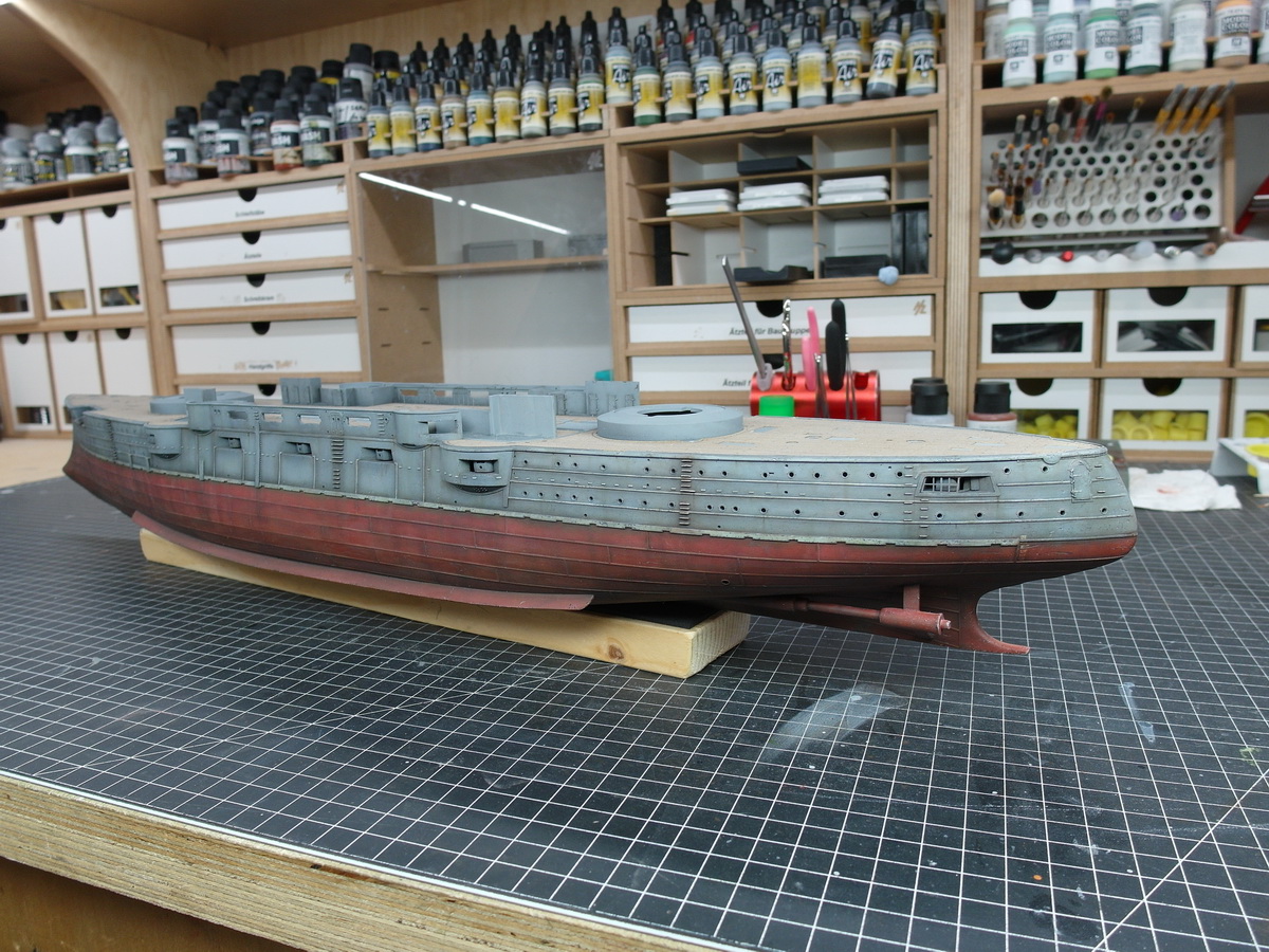

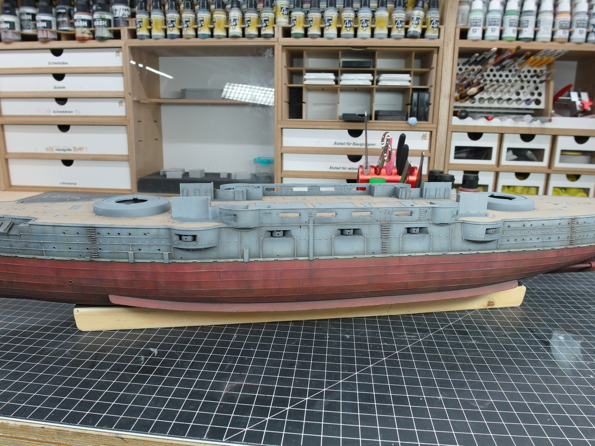

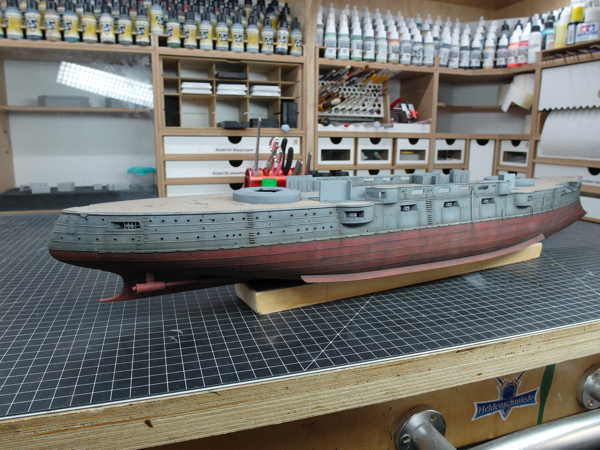

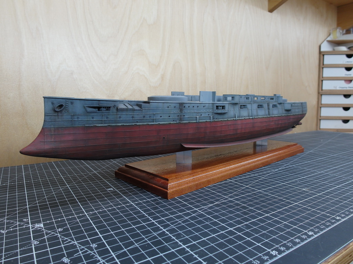

Ahoy dear model building friends and thank you Daniel K.
At the moment I don�t find much time for model building, but nevertheless it�s slowly progressing.

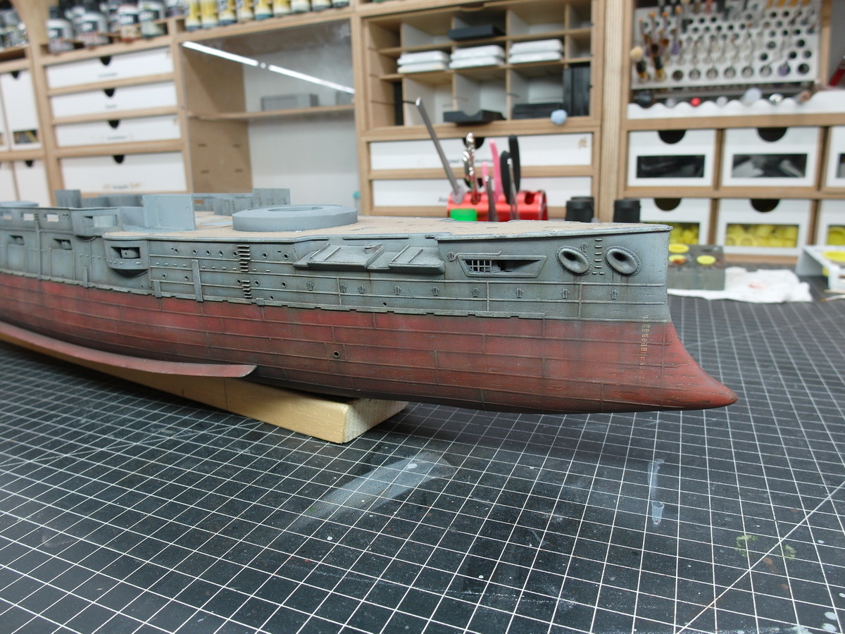

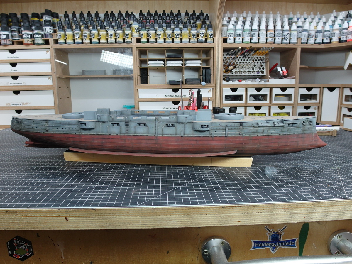

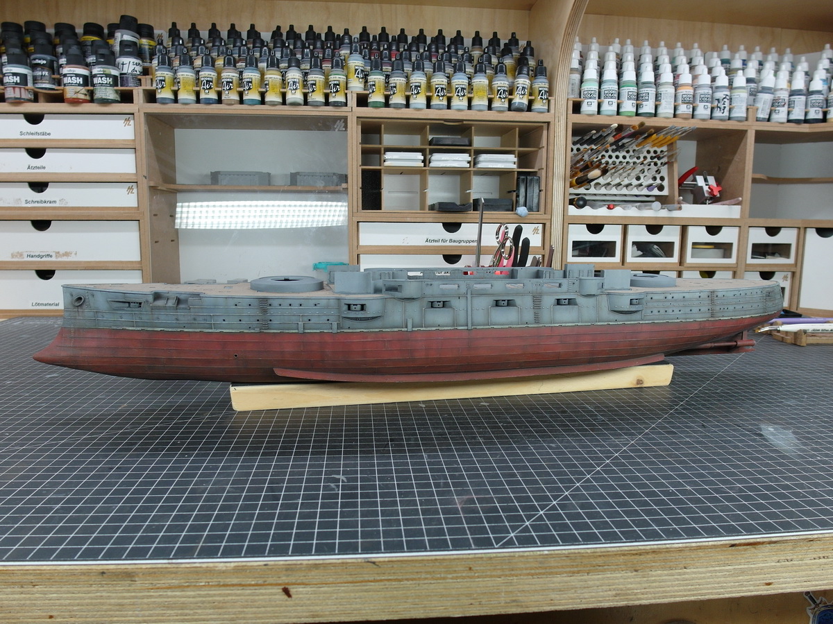

I have finished aging the hull for now and turned a new ship into an old veteran.
I particularly aged the anchor hawse and the area below the anchor berths, as a lot of dirt is likely to accumulate here.
And port side.
The chipping is also strongest here, as the anchors are likely to leave clear marks.
Amidships I aged more subtly.
And a little more at the rear.

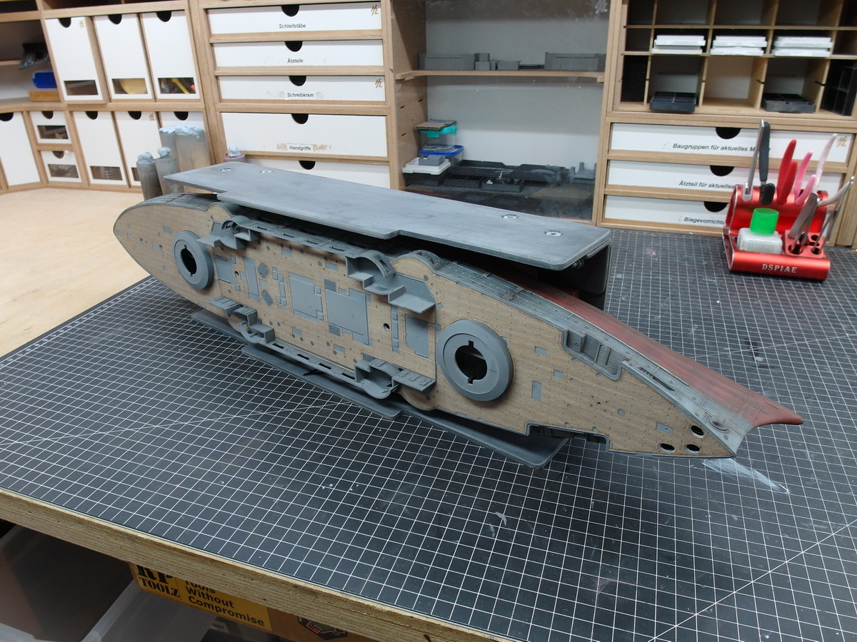

The painting of the fuselage only continues when the missing parts are attached to the outside, i.e. pretty much at the end.
The wooden deck was also glazed and applied.
Now I can start equipping the deck, which I�m looking forward to.
And port side.

I love the attention to hull weathering, especially lower hull. Well done! Sometimes I lament why we dont have a Duncan version of this because one would imagine it would be a fairly small tool adjustment for the manufacturer and make us british era pre-dreadnought go out and buy one in an instant.

Great weathering! The desaturated lower hull colour works vey well with the upper hull greys.

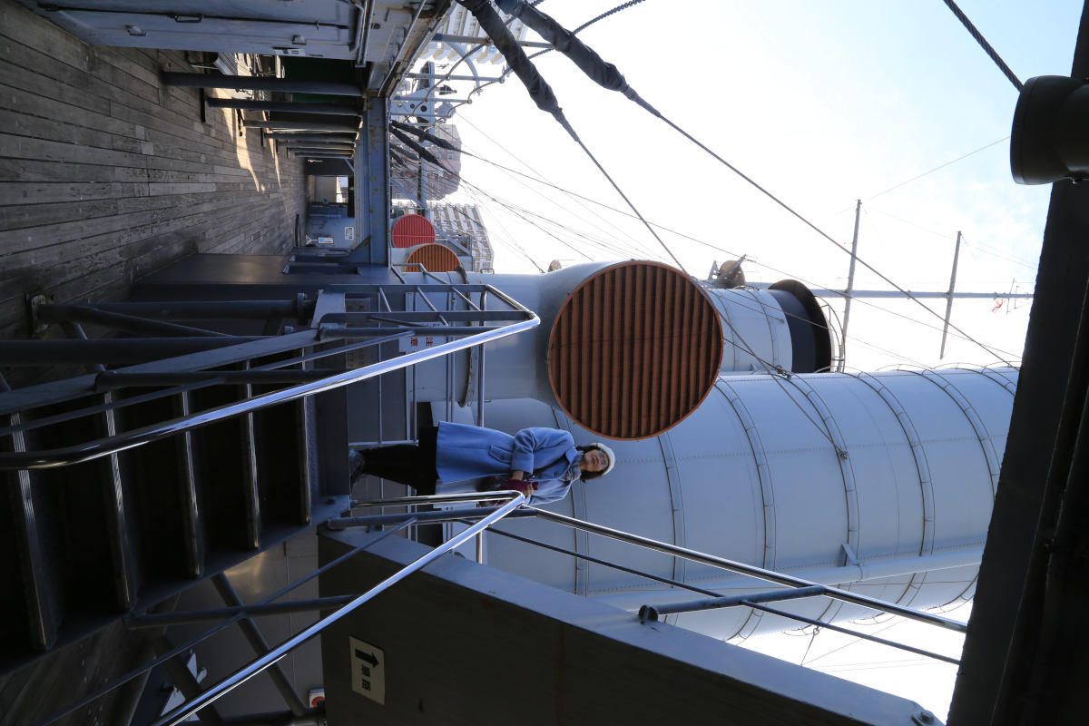

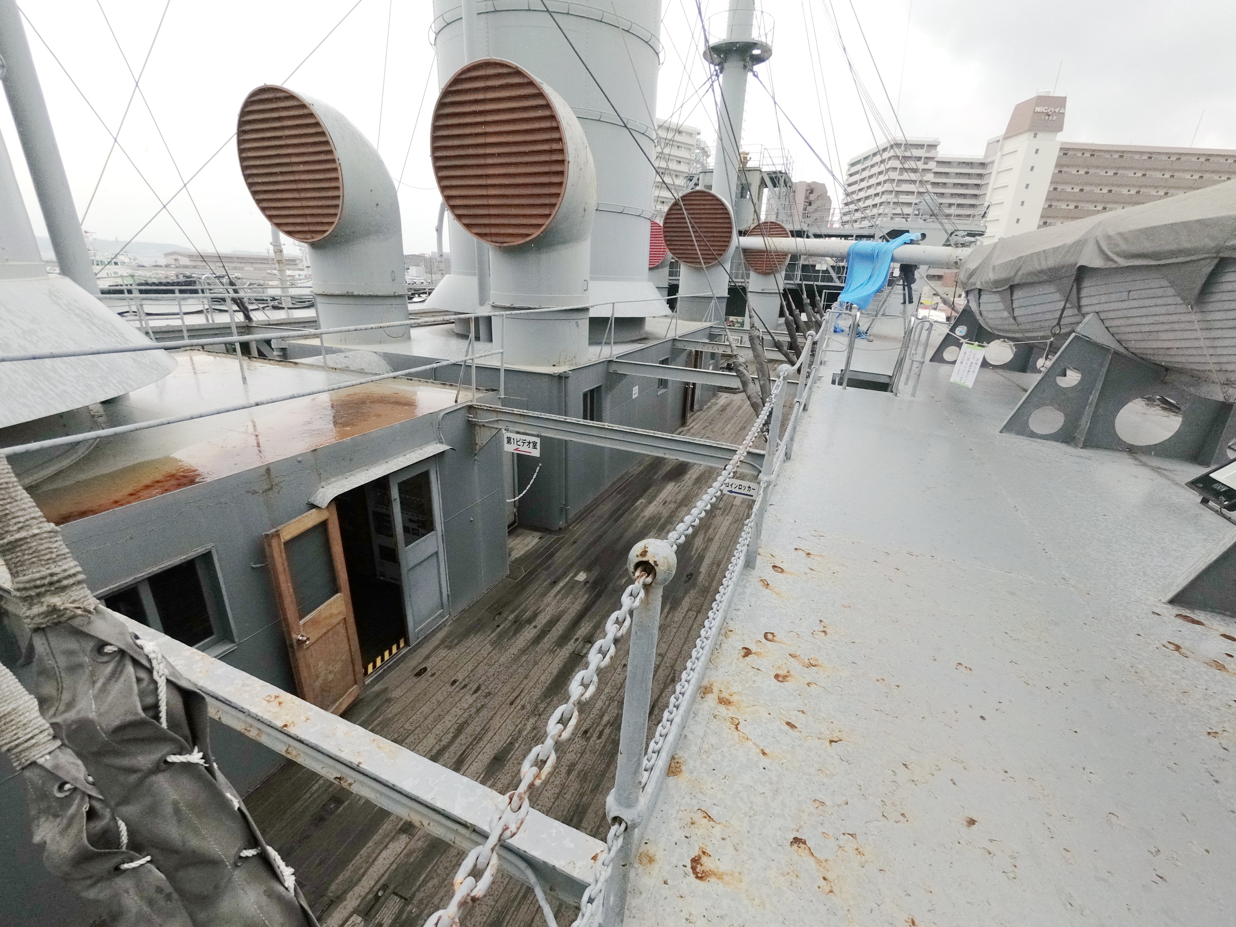

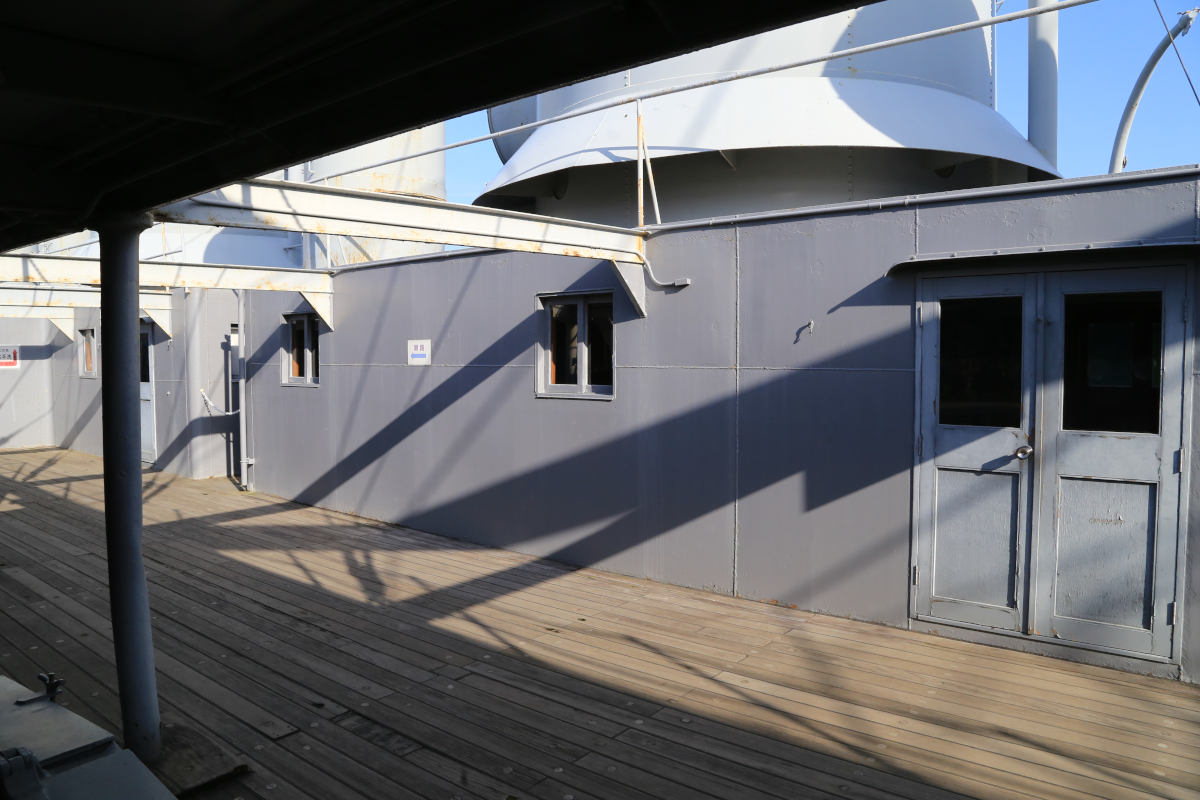

I also think that more such old pre-dreadnought ships of this scale should be on the market. For example, the ships of the Deutschland class of the Imperial German Navy were beautiful.

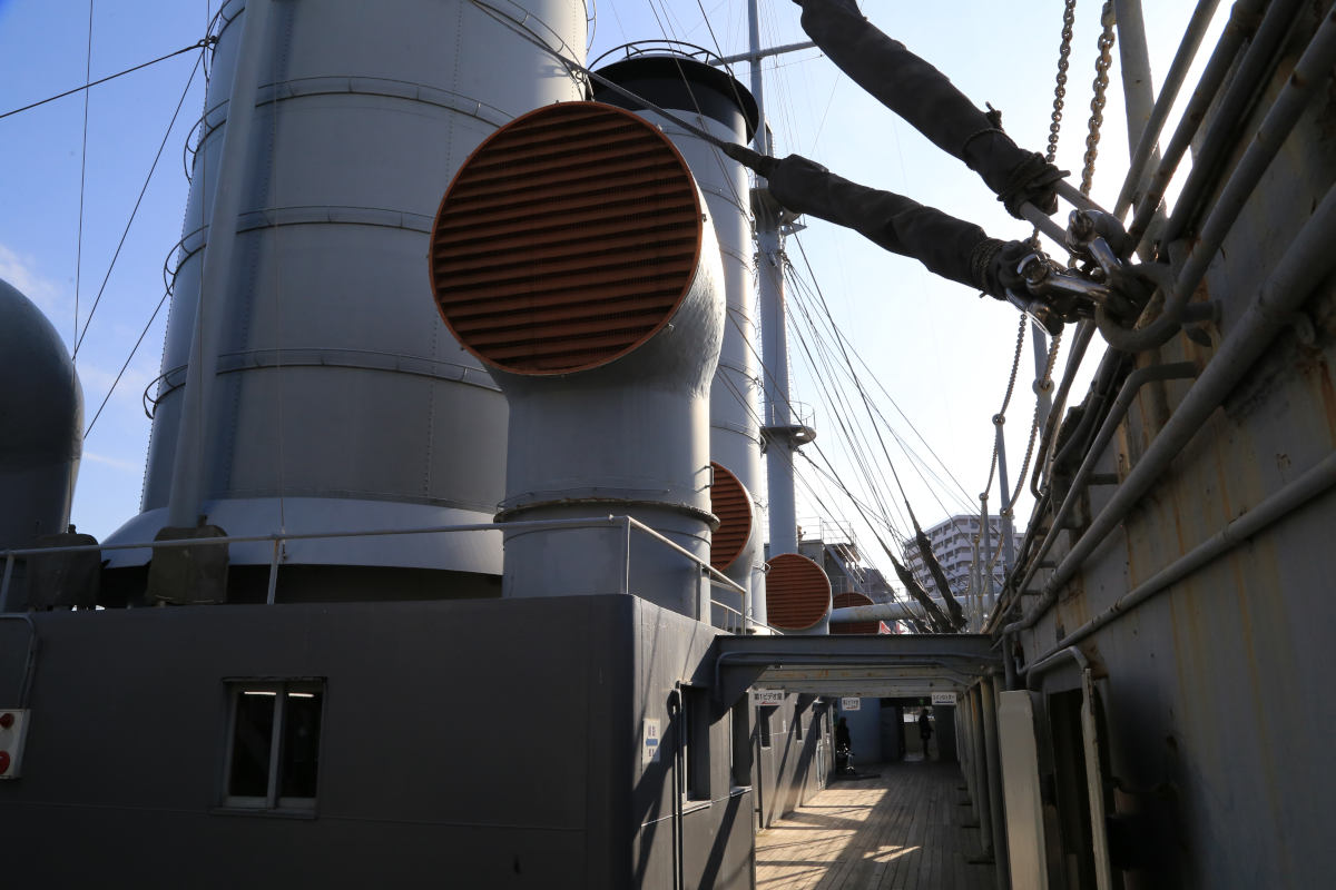

Now a question for the users �mconnelley� and �drdoom1337�.
Do you have any pictures of the rooms under the ship's chimney? They are probably no longer original and I don't know whether there were actually rooms underneath.
I mean this place here.
Or are these simply rooms that were added later for tourists?

mconnelley
- Posts: 252
- Joined: Sun Feb 07, 2010 8:13 pm
Hello:

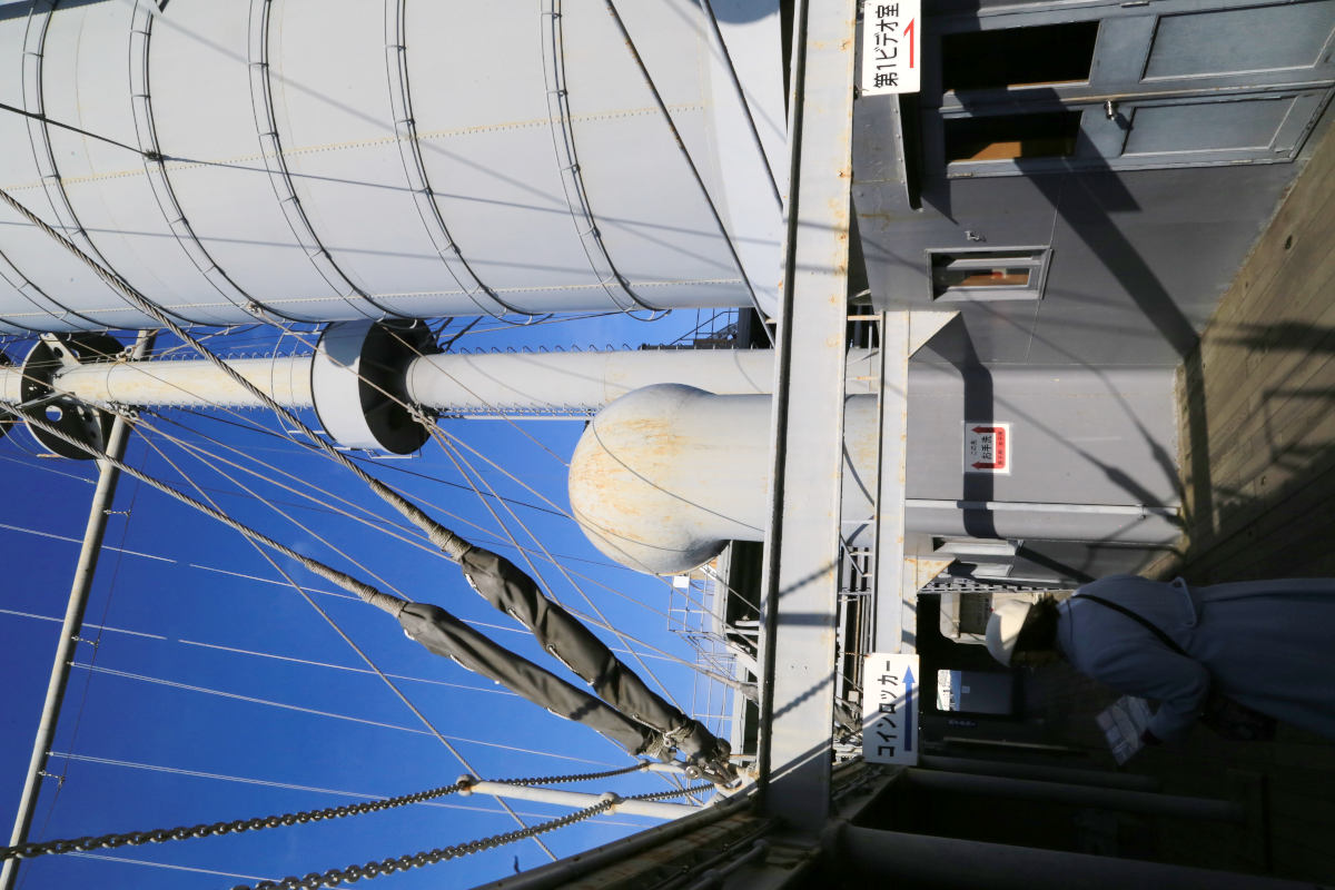

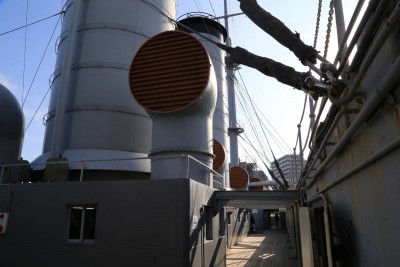

I don't know if I took any photos inside of those rooms. Here's what that area of the ship looks like:

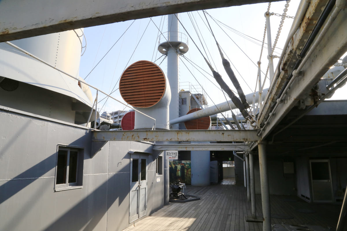

mconnelley
- Posts: 252
Hello:
Two more pictures.

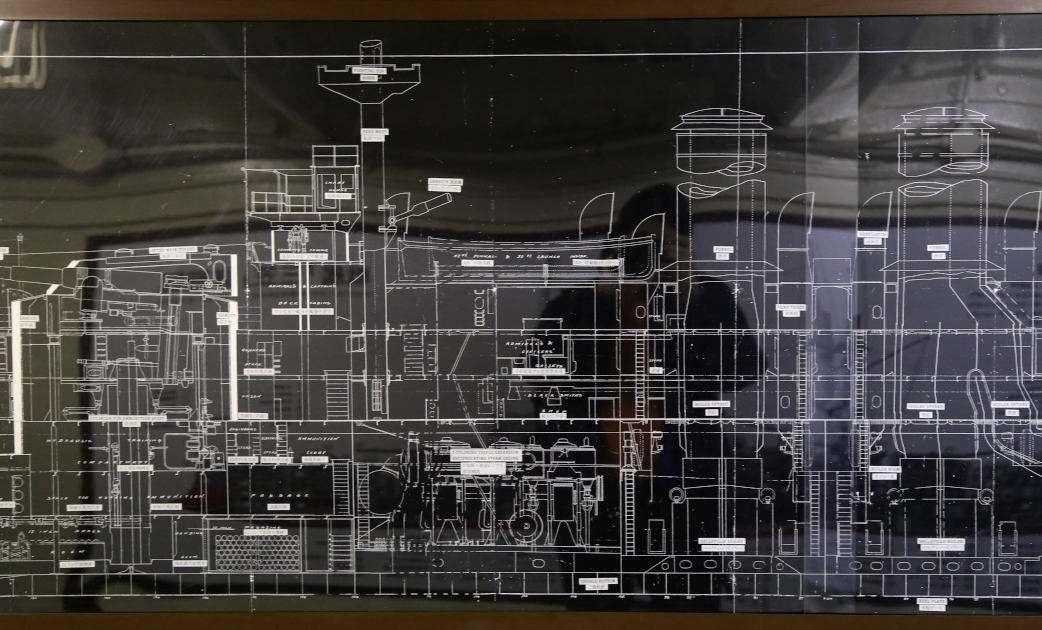

mconnelley
- Posts: 252
Hello:
Here's part of a drawing they had inside the ship, that shows the internal layout. You might be able to better judge what was original from this drawing.

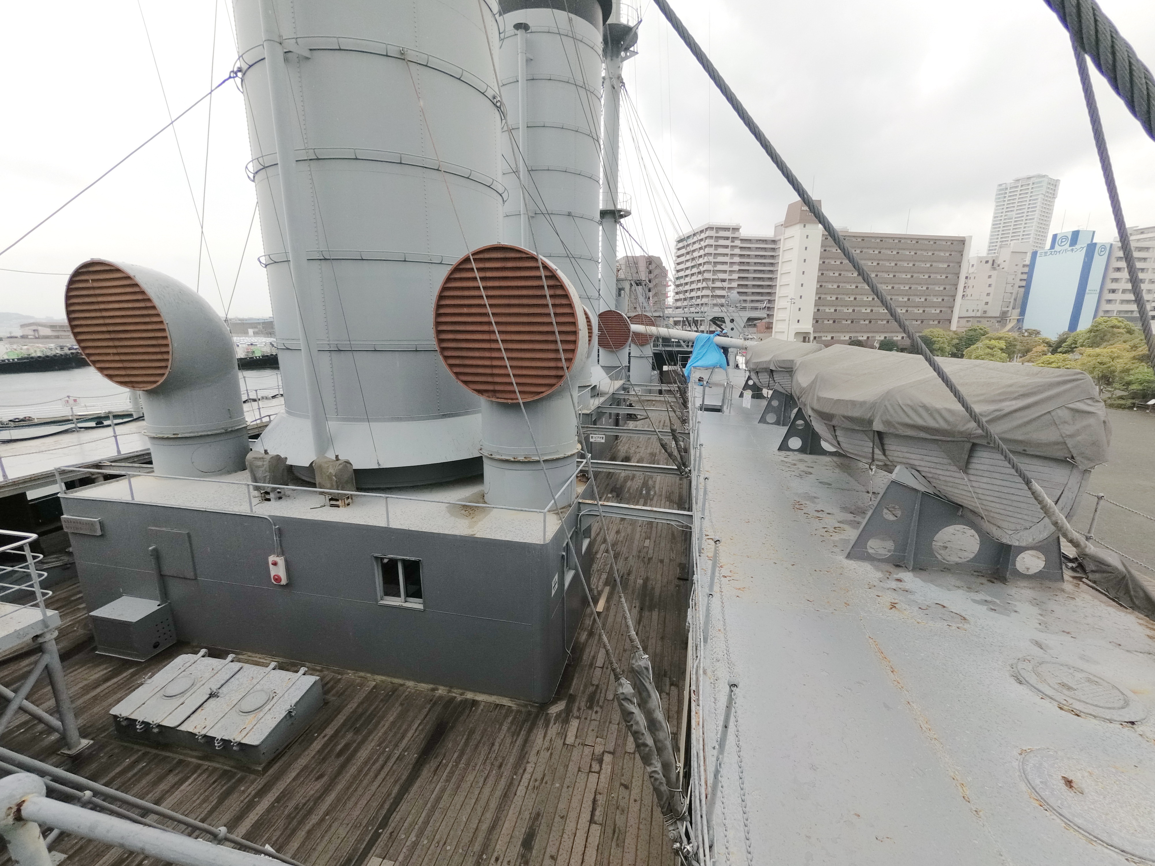

man, just the ventilators - they are all wrong on every kit. how about that!
mconnelley
- Posts: 252
Hello:
The ventilators seem to have changed during her service time. Earlier on, in pictures with the hull was black and the superstructure white, we see lots of what I call 'horn' ventilators (since the top looks like a tuba). In later pictures, where the ship is all gray, they're mostly gone, with only a few 'horn' ventilators aft. I'm guessing that the 1/50 model aboard Mikasa depicts her as-built.
A quick glance at the Hasegawa 1/350 scale instructions looks like they got it mostly right for her 1905 fit. The 1/200 scale kit instructions are more 'interesting'. Steps 13-14 show the ventilators going on at all sorts of odd angles, with no 'horn' hoods. Then they magically appear in step 18 only, and are never seen again.
Mike

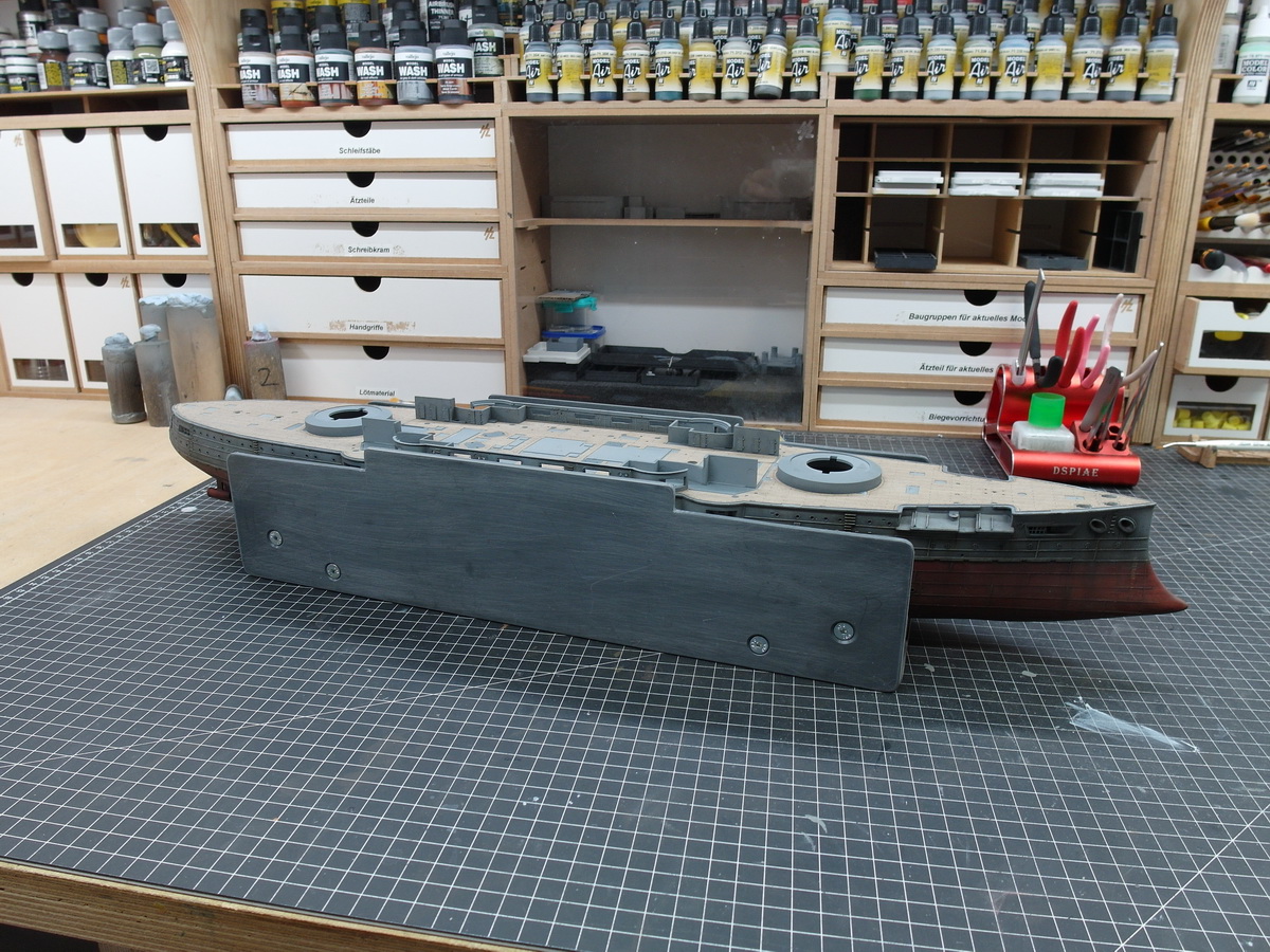

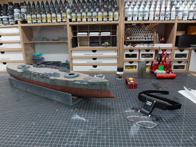

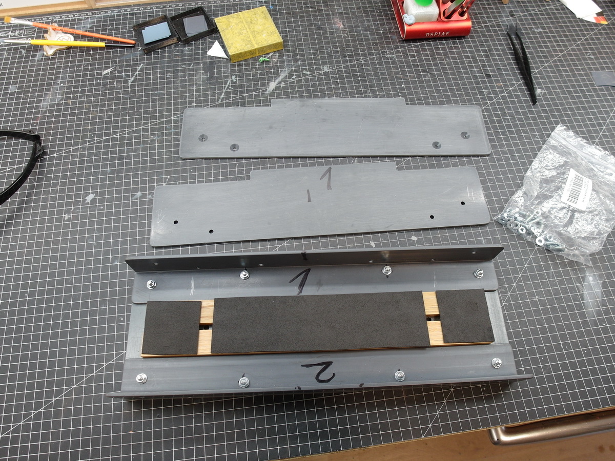

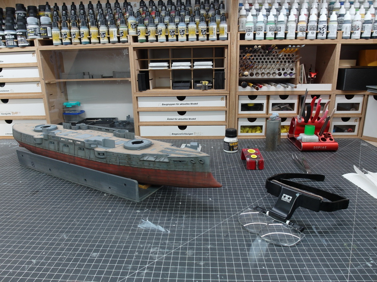

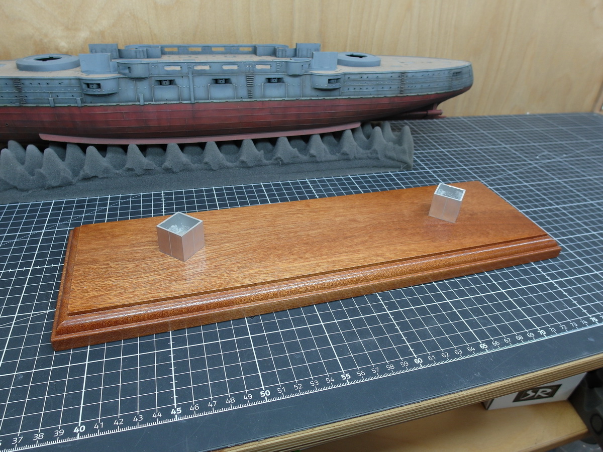

Unfortunately, I rarely get the chance to make anything at the moment. My wife is very sick and is currently receiving chemotherapy. I very rarely have a free head to do crafts. I would probably ruin more than move forward.
But what I have done is prepare the final stand.
This is easier to adjust if there is nothing on deck yet.
I no longer liked the Pontos holder because it holds the ship very high.
I prefer it this flat.
In addition, the dry dock was expanded to include a slightly higher sheet pile wall.
The cannons that look out of the casemates above cannot get their barrels later because they are one with the cannon body.
And that�s why they have to be protected separately from my scatterbrainedness.

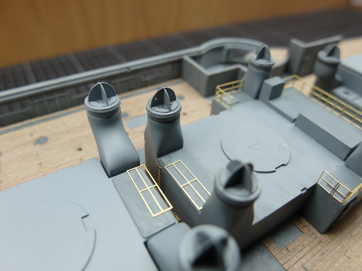

And so my Mikasa appeared on my workbench again.

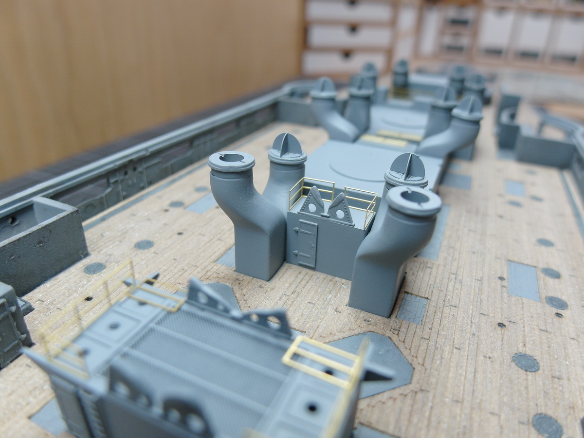

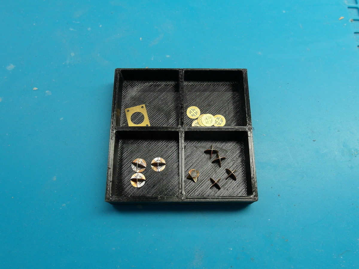

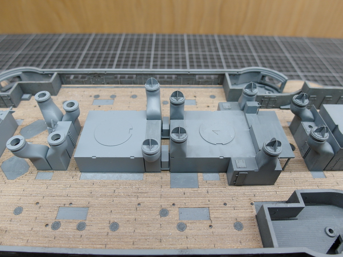

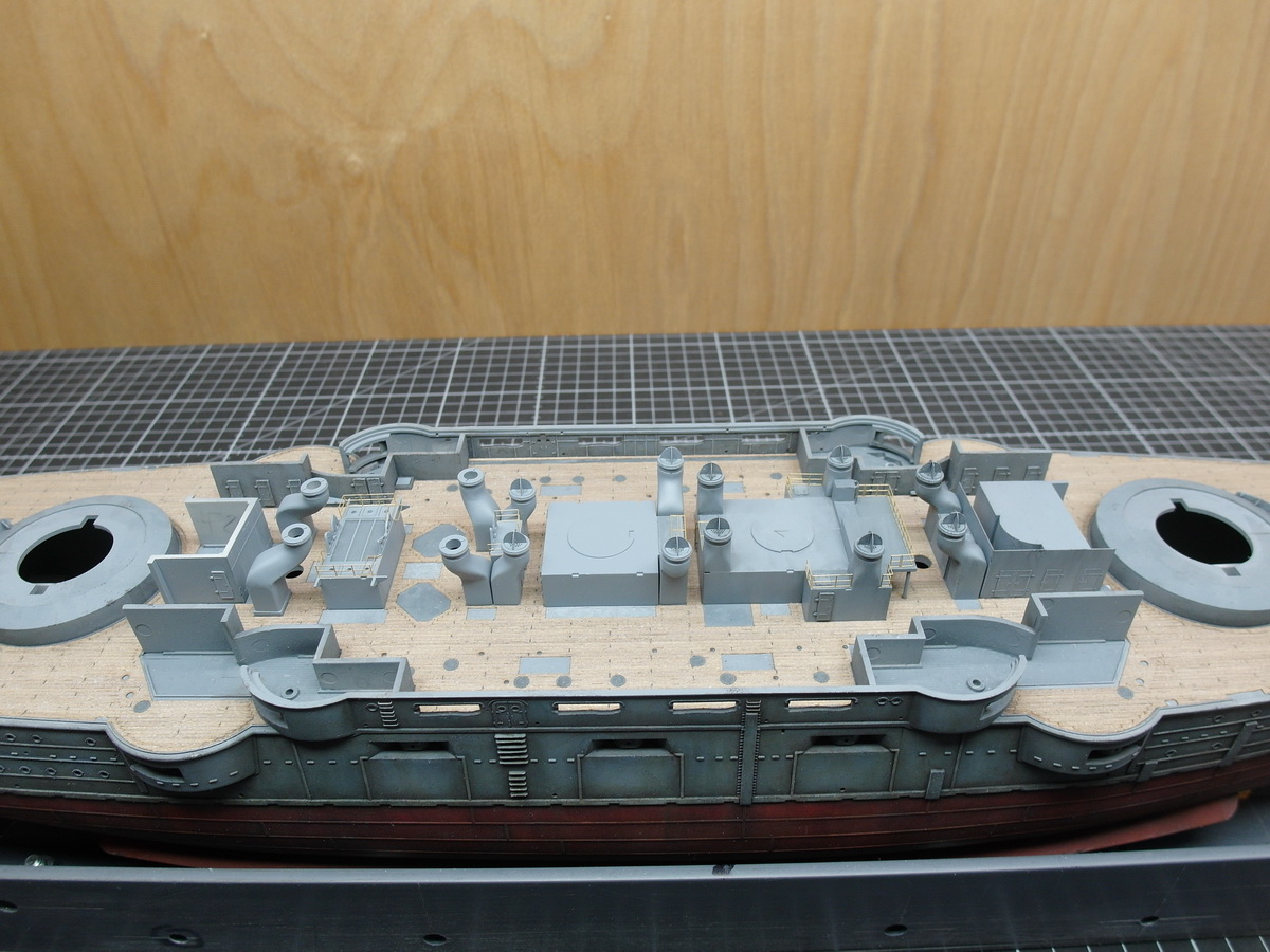

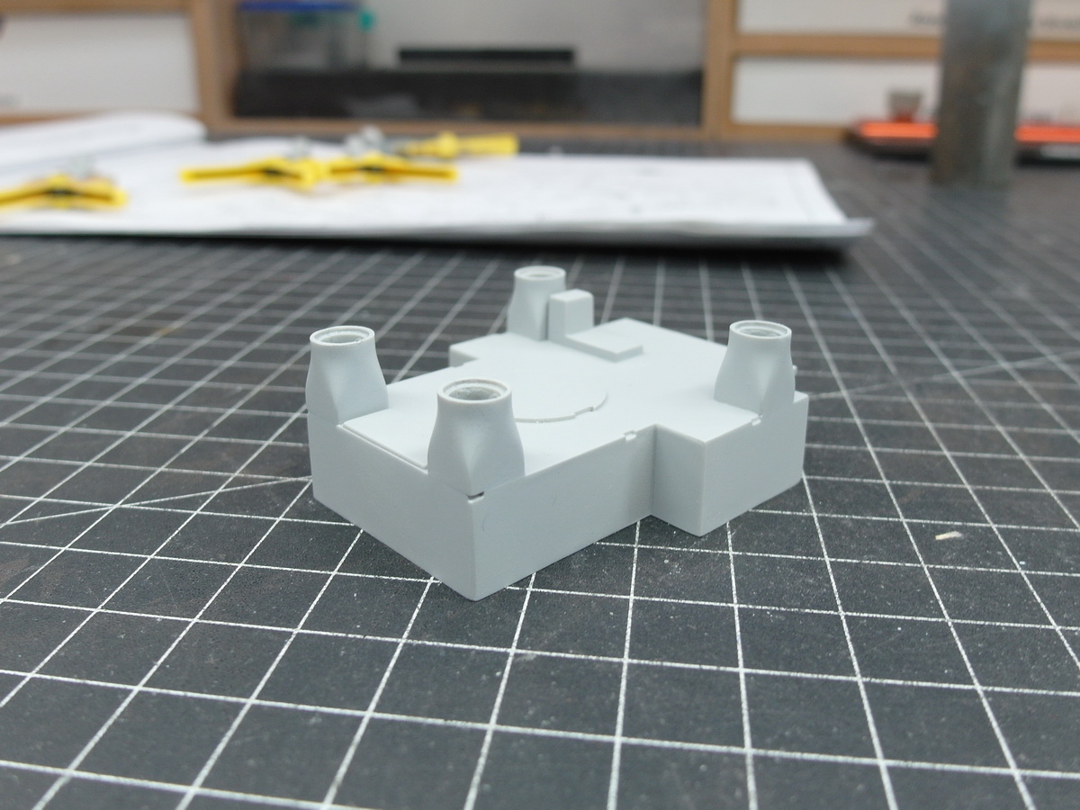

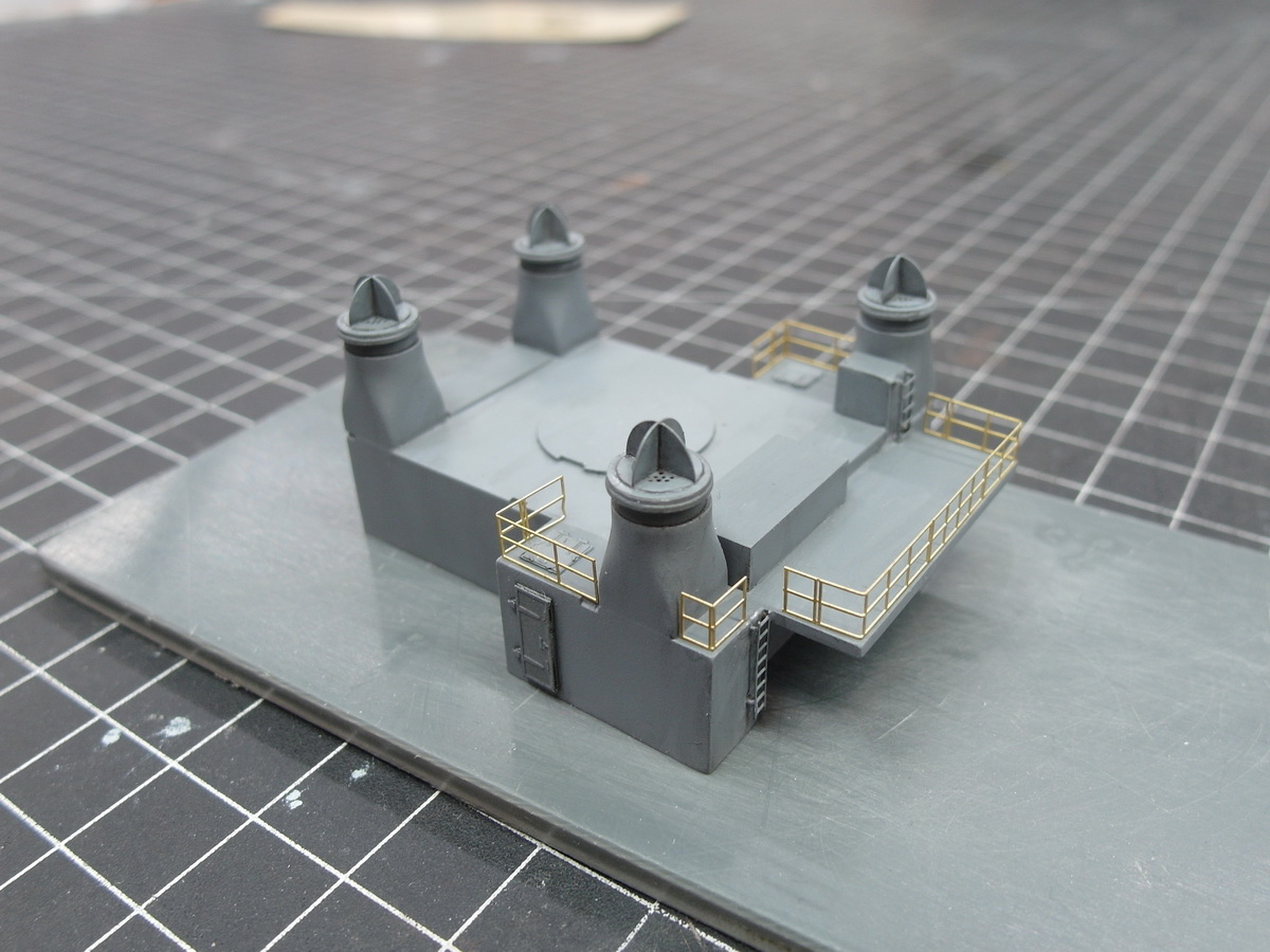

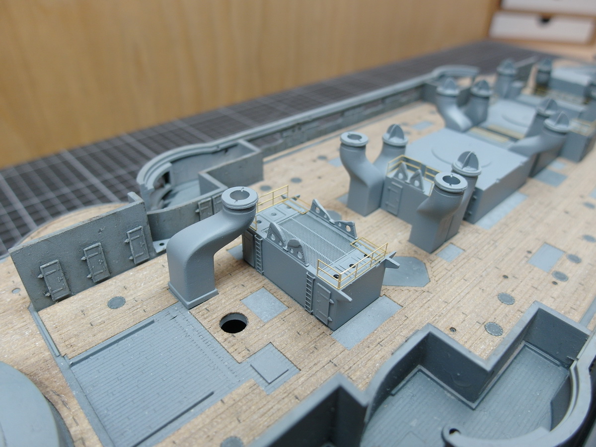

First start with something small to warm up again. The barbettes were still missing splinter protection.
Then I soldered the internal parts of the fans. In 1905, not all of the fan scoops were there anymore and that�s how you saw them. But I don�t know why they were removed.
I researched the orientation of these internal parts as they were attached differently on different models and finally found this picture online where they are parallel to the direction of travel.
And that�s how I installed them on the deck during the first superstructures.
So a small start has been made and I think that I will now regularly report to you about my construction progress.
So, read again�

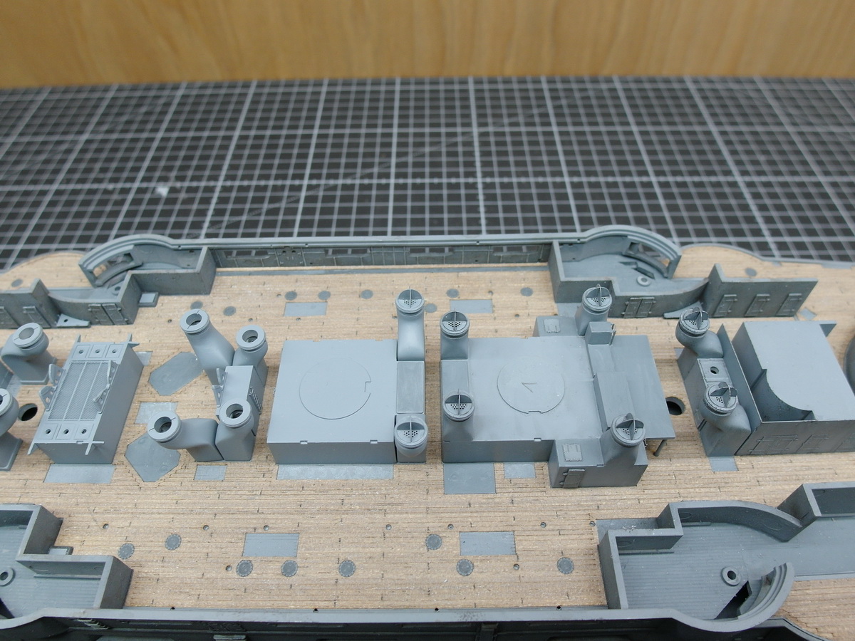

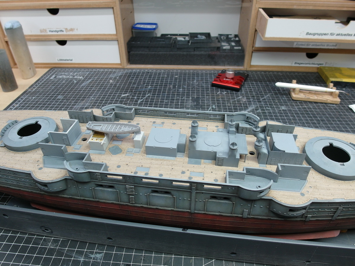

Then we want to follow our words with actions and continue building.
Let�s get to the internal structures.
All relatively simple, geometric structures. Neatly sanded and primed.
Added a few doors and hatches to make the monotonous surface more interesting.
However, I am entering into an area of historically unprovable assumptions. Only the pictures of the museum ship show the inner deck of the Mikasa. But that certainly doesn�t have much to do with the original ship.
So I allow myself some artistic freedom here, such as the railing, which is only placed here for customization. It is not documented historically. But it made sense to me, as you could get to the platform at the funnel via the gallery.
And a ladder should also be attached to the component, otherwise how would you get up to the front gallery!?
And that�s how this came about.

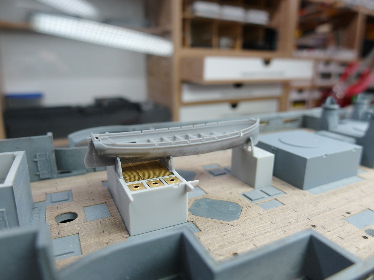

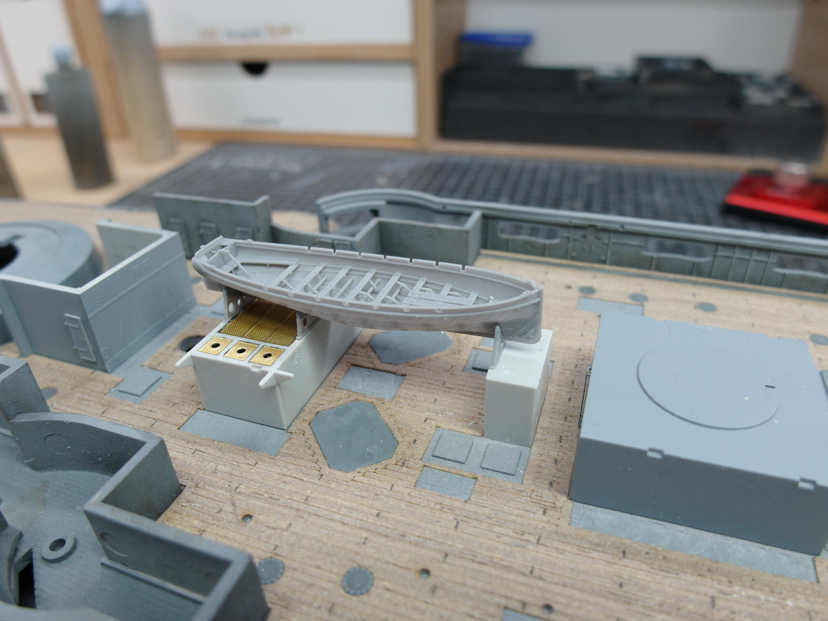

We continue with the first 32-foot rescue cutter. A dream detail.
However, there is a small problem with the cradles. They are usually not in the places where they come onto the superstructure. That�s why you can see an unsightly gap between the cradle and the cutter, see arrow.
Nothing that couldn�t be corrected with thin Styrene strips.
Now the boat is lying neatly in its cradles again.
And so the inner deck is slowly taking shape.

Let�s move on to the internal structures and fans. The deck is slowly filling up.
One thing bothered me. Two box-shaped structures were squeezed between the two main houses.
Seems completely illogical to me and cannot be seen on many models, including those from museums. And that�s why I don�t use it, the corridor remains open.
Especially since a small platform can be seen on both deckhouses. Probably to get to the funnels.
That�s why I won�t install the boxes, but will attach a ladder and a railing here.
I further refined the superstructure that accommodates the rescue cutter.
The doors are from the MK1 set, the railings are from the model�s original etched parts set.
And the ladders come from the leftover box.
I�m starting to like it that way
