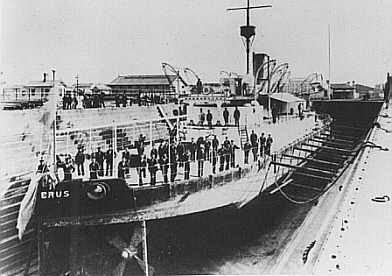

Post by RickF »

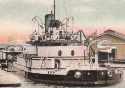

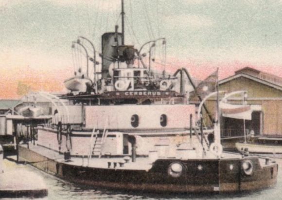

Dirk,
Ref your request on where the name should be, this is the only picture I can find of a similar vessel.
As you can see, the name is in the same position as was used on Cerberus after the flying deck was shortened. No pictures appear to exist of Cerberus with a name anywhere before the installation of the military mast.
Rick
Black, white and buff - not grey!

Post by Bill1957 »
hi
the cerberus name is on the stern and top deck forward
hope this helps
bill

Hi Rick,
thanks for your reply. Then it seems that there will be no name plate on my Cerberus. BTW: I fixed the "wheel-problem" yesterday. She now has four wheels to close the watertight doors. Report and pictures will follow soon.
@ Bill Addley: The name on the stern and the back (the picture shows the Cerberus from the back - unfortunately pictures of her from the front are very rare - as you can recognize by the two skylights; but that fault has happend two me also more than one time. The ship is just quite "palindromatic") of the hurricane deck don't seem to be there before the addition of the fighting mast:
But nevertheless thanks.

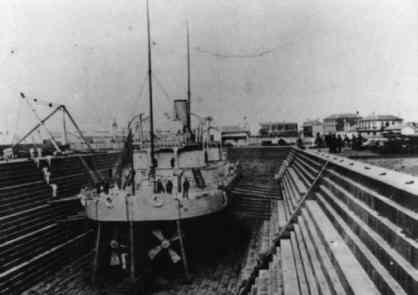

Post by Bill1957 »
hi
heres an ealy stern no name on it
perhaps the save the cerberus group could help
bill
