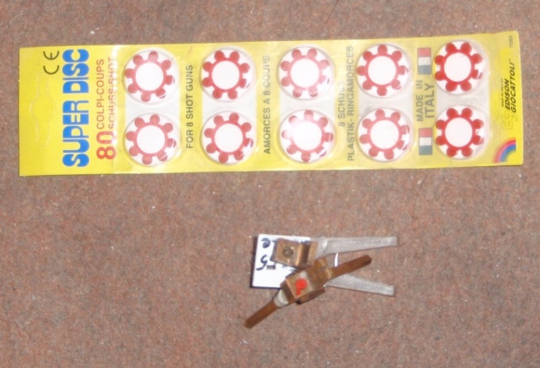

And at now main cannons.
It's shooting good. Satisfactory flame, smoke and smash. But with my camera I can't taken picture at shooting moment. And need little more work for electric shooting operating inventing and creation.
Here is ammo what I used for my cannons.
