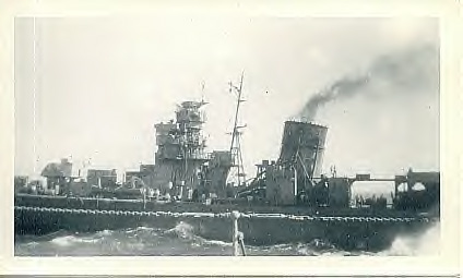

Post by Dan K »
The aircraft handling deck was a solid platform for the first two class members, Agano & Noshiro. The reason behind the reduction of the deck area is not clear but probably related to material shortages and the determination that this was a non critical area. So, it was relegated to storage for damage control lumber, and could be coverd by tarps as well.. The last member of the class, Sakawa, has almost no overhead in this area, save for a central walkway. (credit (via A. McGivern collection)

Post by Dick J »
As the AA and electronics aloft increased, there was also a need to reduce the high weights to keep the stability within bounds. This was probably also a part of the reason for the reduction in the material of the platforms.

I found this image of SAKAWA at NARA dated July 1946. I think I have seen this photo before, but this copy was pretty sharp and was by its self in the folder, no others views anywhere else in the box. If one really messes up on one of the new AGANO class kits, you could always finish to post Bikini Test. :cool_1:

Good point by Dick and great version of that photo. THx for posting.
