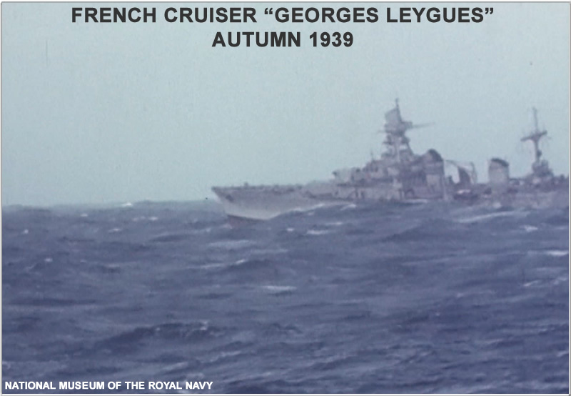

This response is a few years late (and I'm not sure that it really helps at all) but I present it nonetheless: Shown here are two colour views of "Gorgeous Legs" (Georges Leygues) as she appeared during a joint British/French patrol under the command of VAdm Marcel Gensoul in late November/early December 1939. Dunkerque and Montcalm were also present (but in the film from which these views were captured, there's only a brief view of Dunkerque from astern and no shots of Montcalm). Nasty weather!moomoon wrote:I don't have my litterature about the La Galissonniere cruisers class here but I remember that decks and roofs were dark grey (either natural metal or paint?), linolem or wood (some ships had linoleum, others wood deck at the stern).
I personally can't see much detail of the deck, but she was definitely light grey (and had a red bottom).

Thanks for those pictures. Very helpfull, not least because that is contemporary footage of a ship that should be painted in Gris Clair No 1. Given previously what shade of grey that colour was was mainly guesswork that is quite a find. Just one question. Does that film include any RN ships painted in 507c? 507c is a known colour so a picture from the same film would help greatly in putting Gris Clair in context i.e. lighter, darker or with more blue say than 507c.

507C? Yes, I believe it does: At the top left of the image below (which should not be reposted elsewhere), we see H.M.S. "Amphion" (soon to be "Perth"). She seems to be in 507C (though it is patchy-looking, or perhaps its part of her transition to the RAN). Below her on the left is "Dunkerque." The righthand side of the image shows "Gorgeous Legs" being tossed around by very large waves. Please note that the image of D was taken in conditions of direct sun whereas the shots of GL are all on a very nasty day.Gcj wrote:Frank
