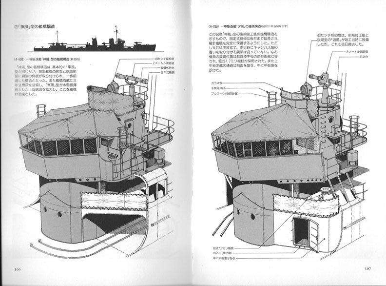

I'll look for a line drawing. In the meantime, from the Gran Prix Shuppan DD volume, two bridge views, as built (Kamikaze on left), and modernized (as represented by Yunagi on the right).
The colorized Yunagi photo above is representative of her appearance in 1942. Almost nothing changes.

Re: Calling All IJN Minekaze, Kamikaze, Mutsuki class fans
Hello Dan, many thanks for your reply and the drawing, it is really very helpful! That means that I can get any of the kits.

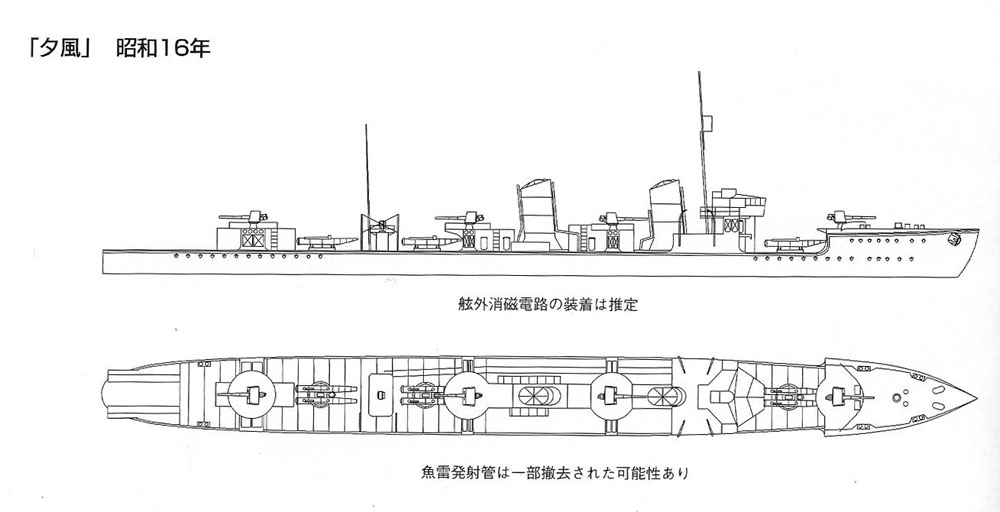

- Posts: 9049
-Line drawing of Yunagi, 1941 from the MASMS #17. My only nitpick with the PitRoad Minekaze/Kamikaze/Mutsuki class kits in that the main 10cm armament is overscale. In this one regard, the Hasegawa Mutsuki kit guns are better. I would suggest thinning down the shields and lowering the mount on it's base, maybe by sanding down the bottom of the base. Otherwise, these are some very nice kits.

- Posts: 9049
A long time lurker has corrected me on the "Yunagi" illustration (sure wish he would chime in....). It is Yukaze (Minekaze type), not Yunagi. Sorry about that. I'll have to see what else is around. Or, someone else....?

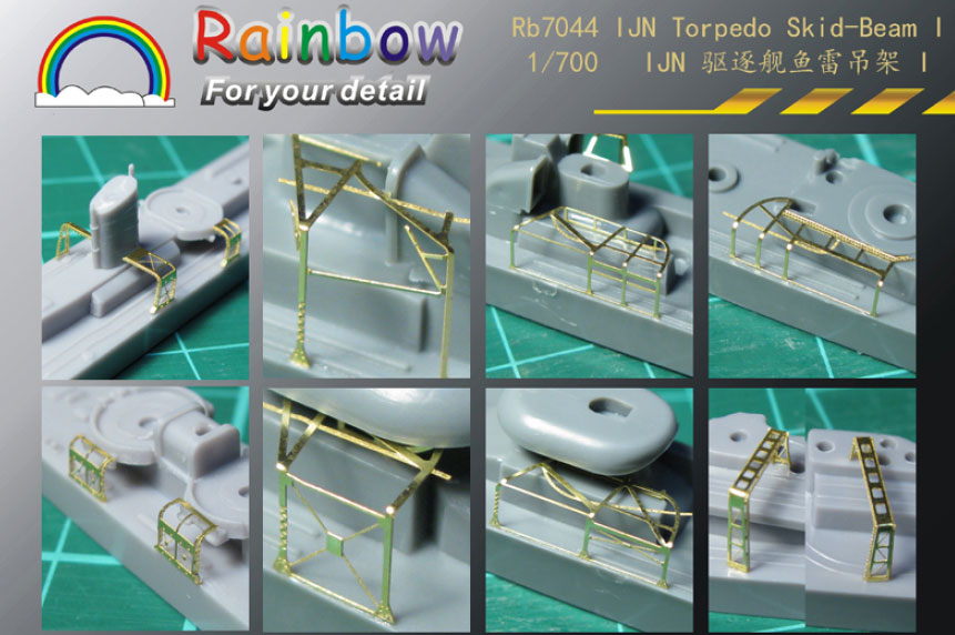

Tom's was the only source for years, and thankfully so. Despite my fondness for them, new items from Rainbow carry great detail and depth. My recommendation:
Dan, thanks a lot! It is sometimes hard to find out which ships the Rainbow sets relate to (e.g. their nice funnel hood sets - don't you have a key to them BTW?)
The RB frets come with specific instructions, Vladi. The reload gantries for these classes are nearly identical.

- Location: Czech Republic
Thanks, Dan!
One more question re the image "Kamikaze bridge as built vs Yunagi 1936" you posted above. Apparently, Yunagi had her rails moved to the opposite side of the bridge (in which case the other drawing "Yunagi illustration, 1941, MA#17crop" would be incorrect in this respect). Do you have any picture showing how the rails went along the ship?
